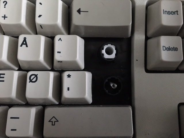

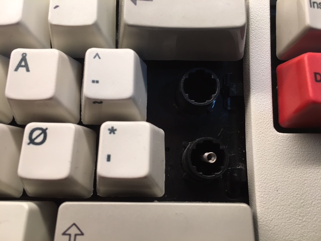

- POTV
- Location: Denmark
- Main keyboard: IBM Model M SSK
- Main mouse: Logitech Performance Mouse MX
Old ISO enter without insert
New ISO enter with white insert
- Old ISO.JPG (75.61 KiB) Viewed 6190 times
- New ISO.JPG (79.75 KiB) Viewed 6190 times
