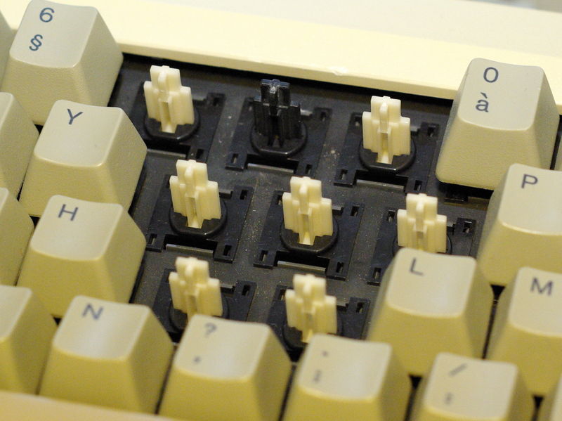

I have found a calculator (Monroe 2125) with what appears to be SKCC Black switches and pseudo-DSA caps. Further investigation will occur, with pictures, later tonight, but for now: Does anyone know anything about SKCC Blck? The page on the wiki is blank, though it shows up on the list of SKCC switches.
07 Mar 2017, 23:33
We don't know much, oddly enough there is one black SKCC switch in my Apple M0110. It feels a little heavier than the cream switches:
wiki/Apple_M0110
Looking foreward to your pictures!
atrere
08 Mar 2017, 00:02
https://imgur.com/a/nk7g0
Here's an album, prior to cleaning and disassembly.
With some switch-against-switch testing, I can confirm that SKCC Black does appear to be heavier than the Tall Cream in the M0110a.
Tentatively I'd call yours "grey" and seebart's "black", but it may be just a matter of pigmentation:
