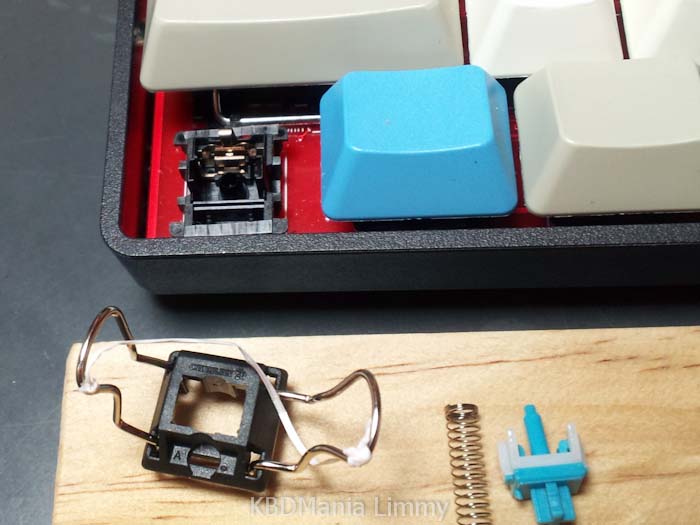

Limmy wrote:1. I created files for each combination so that you could see the effect by arranging the files in a certain way.
2. Tab key
I tried to depress the key with similar force before and after the lube. Without lube the switch bottomed out hard sometimes because of sudden movements.
3. Stickers
I used 3M filament tape(897) as a substitute for the sticker specifically designed for the purpose.

off wrote:So did you cut the holes in the tape manually or punch them with something? Or did you just put slices of tape on all sides?
I have not tried the stickers designed to fit MX switches, but I thought two strips of tape would have identical effects. I cut the tapes about 1mm wide. Putting the piece of thick tape in between bottom and upper housing of a Cherry switch locks the binding of the two pieces more securely hence eliminates rattling sound when a switch is depressed. I think MP3 files(in a zip file) and the images in the following link( http://www.kbdmania.net/xe/3681762 ) would be helpful to you. I visualized the rattling sound by opening the recordings on a sound editing software. In the image files the top part is without stickers and the bottom part is with stickers. There are two images one with key cap and one without.
I heard from one member that vintage switches do not rattle as much as the new ones, but I didn't get to experience that myself yet. To see if your switch rattles, push the slider all the way without key cap and see if the upper housing of the switch moves when you move around your fingers. I also have plate mounted switches and they rattle too, so I think the problem is both seen in PCB and plate mounted switches.

Limmy wrote:thought two strips of tape would have identical effects. I cut the tapes about 1mm wide.
To see if your switch rattles...
I don't even have to check, I know exactly that/how the tops move about.
Cheers!
Now subjectively, do you *like* what that diy stickermod did to the board (and would you do that again)?
Limmy's pic+mod, from http://www.kbdmania.net/xe/3681762
Limmy's diy cherry switch sticker mod and binderclip-keycap-puller 2012-02-26 02.40.30.jpg (79.93 KiB) Viewed 6697 times
And good to refind that binderpuller, was that your 'invention'?
*sheesh, reading the topic title again... this is pretty far off-topic. oh well, good info nonetheless :D

Yes, I would do the sticker mod again, if a board is PCB mounted(less work obviously). I like the sound of it after the mod so much better which is entirely subjective. By the way, some like the sound of switches with some rattling noise because without such audible feedback they think typing is not so interesting. However, deafening rattling sound made other noises more pronounced. Spring scratching against sliders is the one that I noticed after the sticker mod. So, when I do it, I would at least lube the springs so that it doesn't make unwanted noise.
off wrote:And good to refind that binderpuller, was that your 'invention'?
No, I just reintroduced the tool. It has been used way back in 2006 probably before. See http://www.kbdmania.net/xe/119861 Among the comments in the post, one member mentioned two of the tools can be used in the way I introduced in the other post. You can see more ideas on the opening tool here on DT in here: http://deskthority.net/workshop-f7/how- ... t2130.html

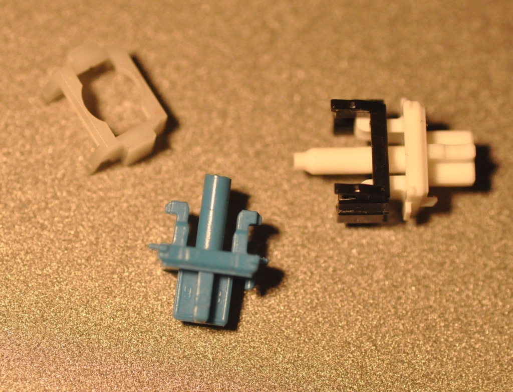

Blues are a close second... but I always wish I could chop off that loose first 1mm of travel. Still trying to figure out a tidy and reliable way to do that.

Well, how about an O-ring? (on the blue shaft, above the white plunger)
*don't have blues, so going by animations only.
Soarer
08 Jun 2012, 21:35
Soarer wrote:Blues are a close second... but I always wish I could chop off that loose first 1mm of travel. Still trying to figure out a tidy and reliable way to do that.
off wrote:Well, how about an O-ring? (on the blue shaft, above the white plunger)
Hmm, I don't think that would work - the clicky part is captive on the stem and only has that 1mm or so to move, so it wouldn't click any more. It would still be interesting though - a bit like a brown, but lighter, and with the activation point moved up 1mm.
I think it would have to be something fitted inside the shell, that stops the whole slider coming up to the top. But there's very little room in there, and anything like an o-ring or washer wouldn't fit. It's just two tiny little tabs that stop the slider from being pulled out of the shell - it's surprising we don't see more cases of that happening when changing keycaps!
This is what I'd be after - a hair trigger... but quite likely it wouldn't reset properly or something :(
Perhaps you misunderstood, I meant above the white plunger, blocking that from ever touching the wider blue part; being free to click down while blocking the first (to you annoying) first mm of wiggle, locking it in place on that spot ready to plunge.
Soarer
08 Jun 2012, 22:59
off wrote:Perhaps you misunderstood, I meant above the white plunger, blocking that from ever touching the wider blue part; being free to click down while blocking the first (to you annoying) first mm of wiggle, locking it in place on that spot ready to plunge.
No... I understood that :) But the white bit can only move about 1mm away from the blue part - there's little tabs that stop it moving further, and which pull it back up on release.

Anyway, this is what I mean by the tabs that hold the white part on...

I don't see a scale on that pic, but judging from here it appears to me that that split is a bit more than a mm; perhaps enough to slide a tiny elastic band (o-ring) in between; ofcourse how much remains of the click is to be seen in testing.
Seeing that pic does make it clear that the band should not be on the round stem in the middle but over the two outer parts ('arms') that hold the white clicker. Curious! Do try if you have any available and let us know/hear!
ripster
09 Jun 2012, 18:11
This might help. Click might NOT go away with an O-ring. It's the tabs slamming against the white piece that make the Click.
http://park16.wakwak.com/~ex4/kb/tech/c ... _click.swf
But given that it goes away even with a drop of oil I bet it would.

Anyhow, as I said the only references I have *are* those animations, and this one does only reinforce what I just said..
Afaiu the click comes from the popping down of the white clicker, hence a stop above the clicker shouldn't kill any click, only the clickback that presumably occurs when you bottom out a blue.
Honestly I'm looking forward to the results of anyone testing this. I will, but only once 7bit's switches arrive, and seeing how that might take a while (and my camera/setup/photoskills are not quite HQ) I'd love to hear/see what the result is from anyone else!

off wrote:
7bit wrote:Did anybodey successfully remove the rub-rub feature of the reds and other modern Cherry switches (without the need to type the switches in)?
ripster wrote: tim tyler did
And it probably wasn't clear, but I've seen his site some time ago; guy went nuts with switches then nothing afaik.
So I was asking about this specific mod he did to fix cherry reds, does it exist (and how much of the red is left :lol: )?
Ah yes, the question wasn't specifically of reds; and though i do remember faintly that tyler tried reds but didn't find that just now, he did indeed (forgot that part) cut springs and stems up a bit. According to his numbers reducing from around 65 to 20cN force required for the switch. The challenge is ofcourse once again uniformity (apart from if you'd even like to type on such light switches; he did, hence continued on to microswitches; ofc old news for most).
