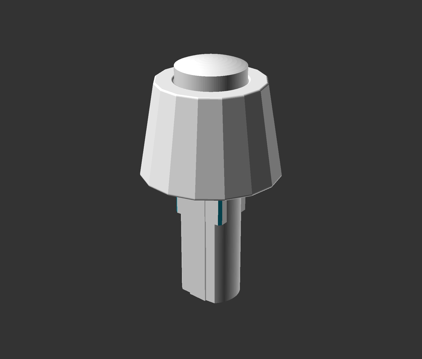

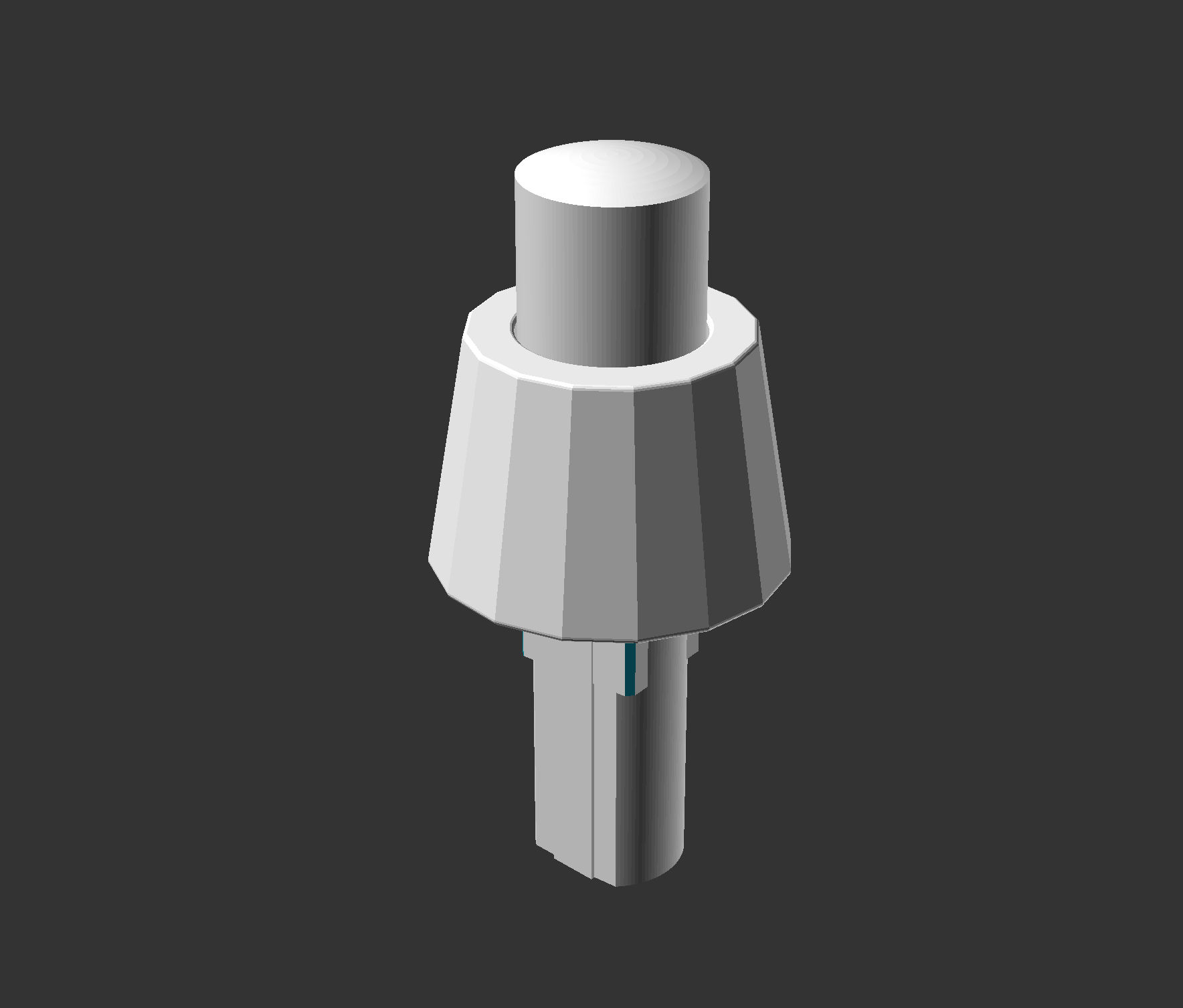

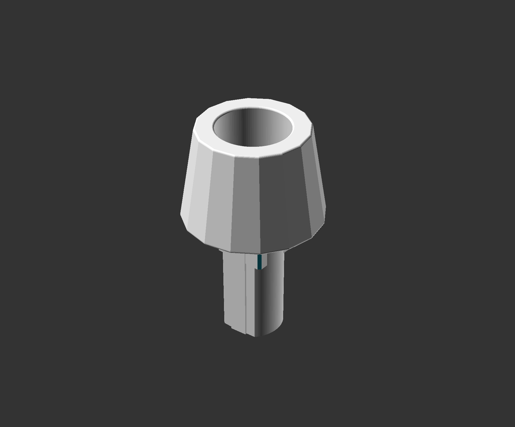

lot_lizard
31 Jan 2017, 19:19
I'll have to play with the throw length of the plunger when I get home and have parts to test with, but the general idea. Should enable you to use one hand to hold the guide base steady, and with the other... load the spring, load the plunger, and press down with your finger or thumb.

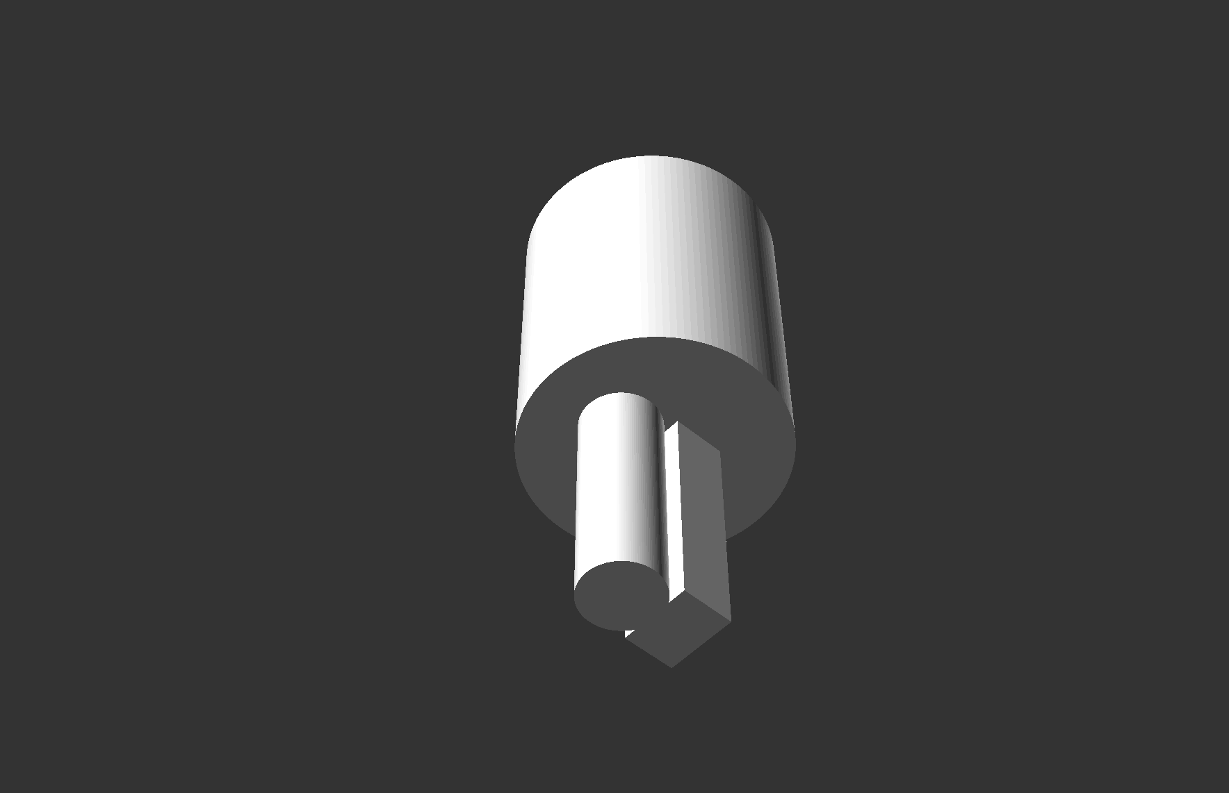

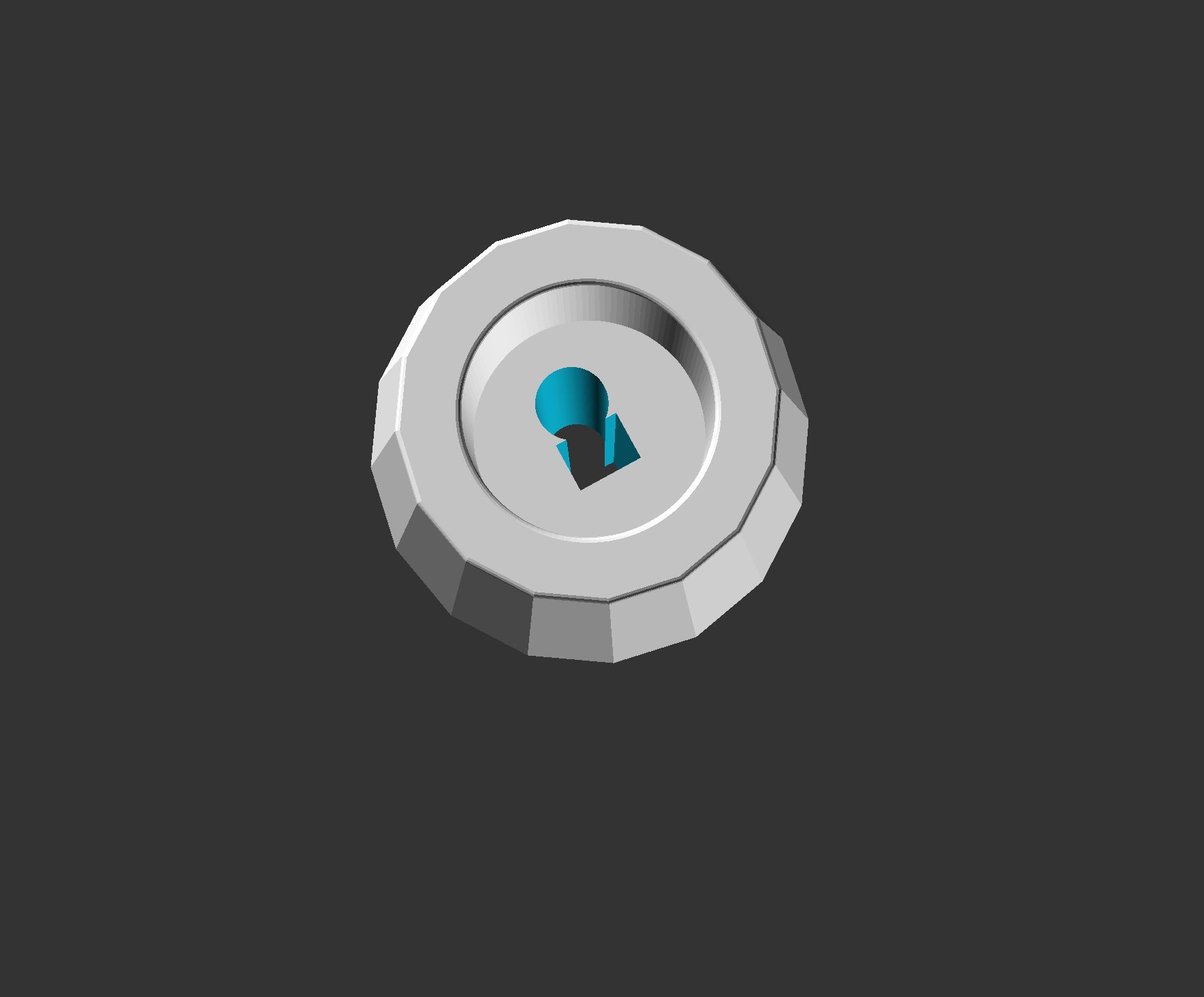

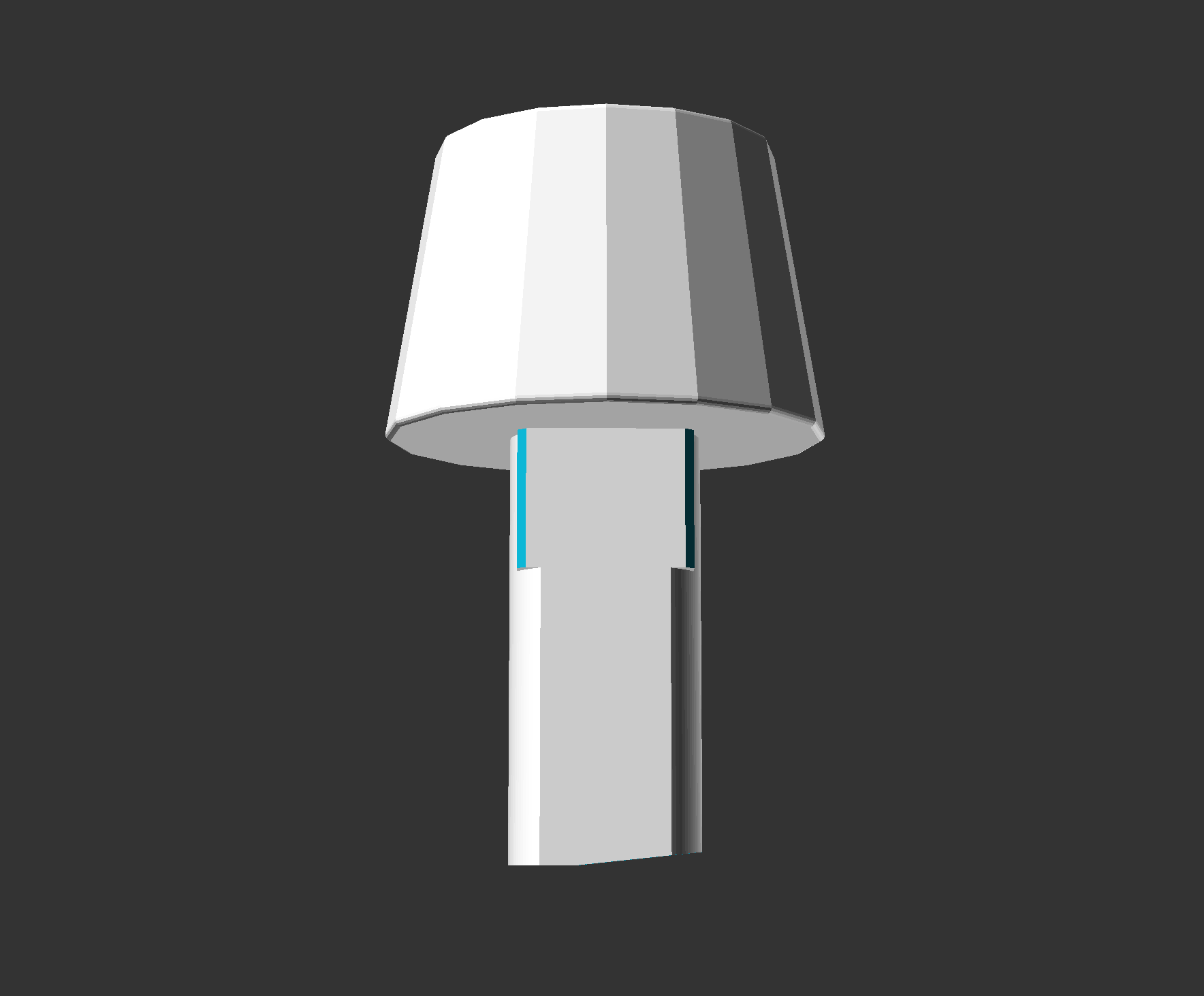

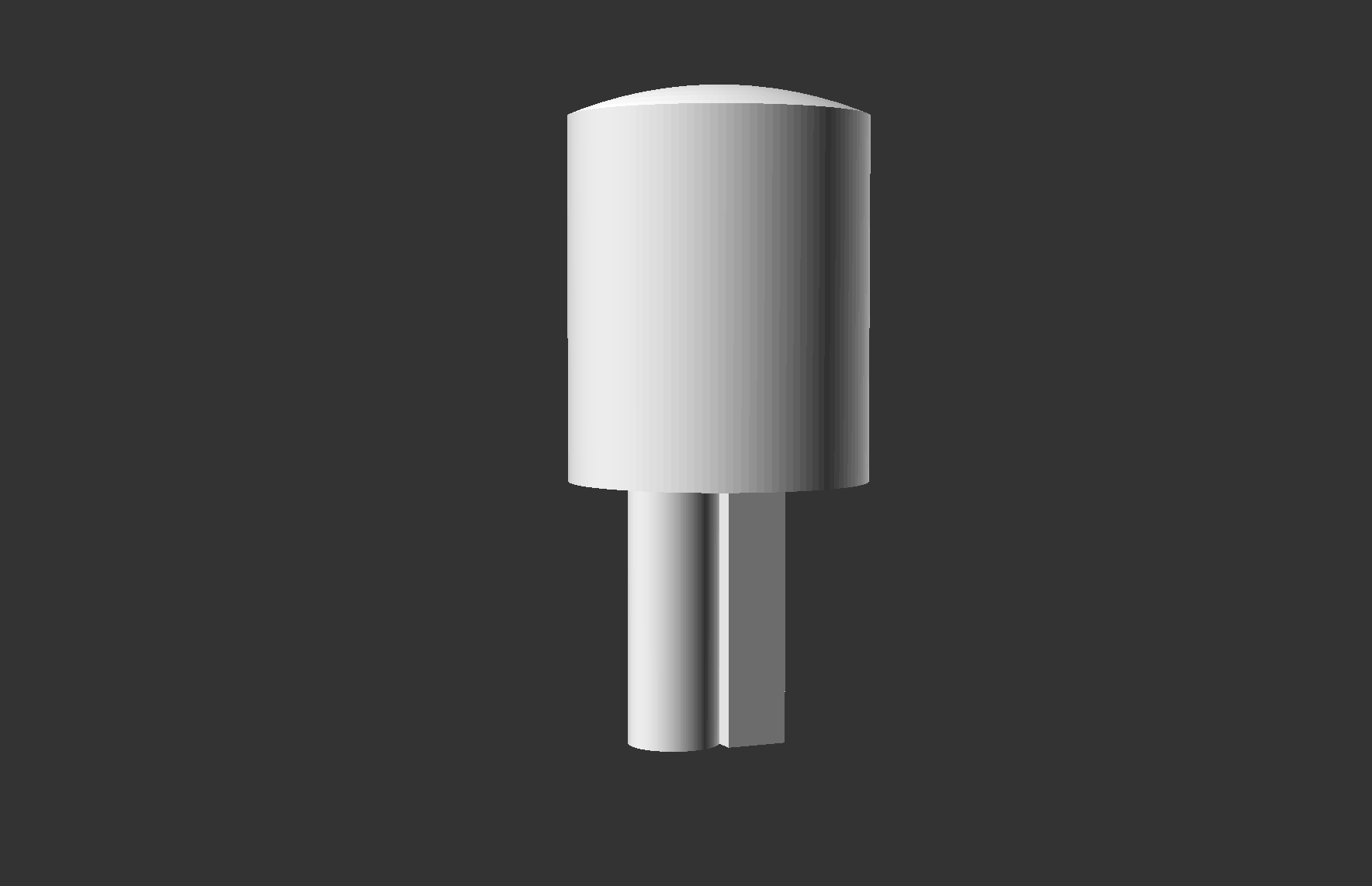

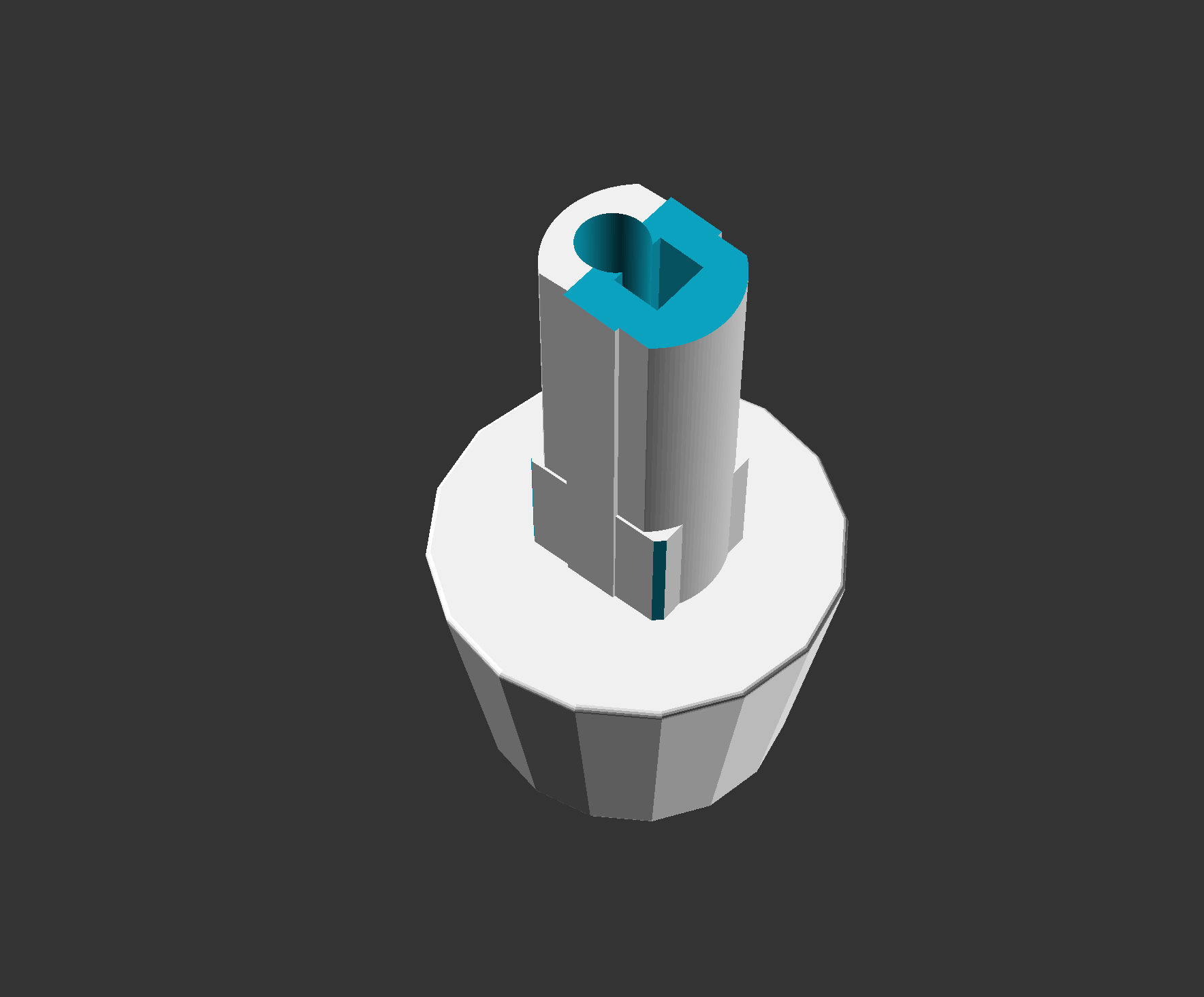

Base guide.  This will make sure the spring is dropped and aligned vertically over the top of the flipper paddle saddle
The bottom is angled to match the pitch of the flipper paddle in the up position (key unpressed).  The round guide is for the spring.  The square slot acts as a key to make sure the spring press remains straight from incidental bumps, and also acts as an additional guide
View from the side to see the bottom pitch better
Base Guide from above to see the keyed slot
The plunger
The plunger
The plunger key
The plunger key
Tool assembled.  This would be the resting position if loaded with a spring (not yet compressed or seated on the flipper)
Tool once pressure is applied (bottomed out)
E TwentyNine
31 Jan 2017, 20:08
Would you want the square guide to be set back a little so the tip of the round key can engage with the spring? Maybe an "setback" on the round part (think of a peg from an old Battleship board game)?
E TwentyNine
31 Jan 2017, 20:13
Pardon my maiming of your image, something like this:
Maybe a shorter length, but that idea.
lot_lizard
01 Feb 2017, 16:53
E TwentyNine wrote: Would you want the square guide to be set back a little so the tip of the round key can engage with the spring? Maybe an "setback" on the round part (think of a peg from an old Battleship board game)?
I have a feeling I will have to test a couple of different scenarios in the end, and we will alter a bit to have something that is "ideal". The unfortunate part about printing moving parts is that we are rarely smooth enough, and with tiny parts it is difficult to get the resolution we might need for things like protrusions. I like the idea of the "nub" you mentioned if I can get that kind of detail. As you say shorter, and I would think rounded on the end.
I would like the idea of creating it as an interlocking (assembled) piece to make it easier to keep up with, but that proves a little difficult unless we create it quite a bit larger with a side slide design (think chamber of a gun). Not that there is any real expense there, but the bigger it is, the longer is takes to print and I don't want to delay shipments for silly stuff

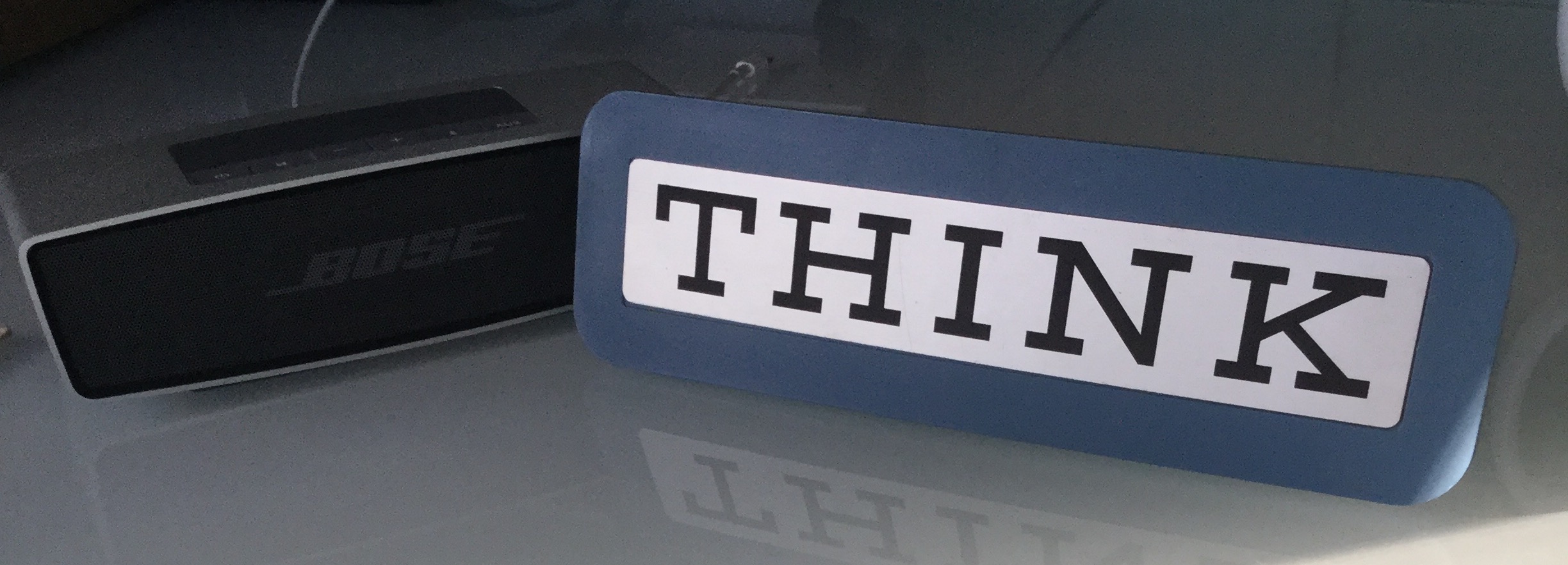

lot_lizard
05 Feb 2017, 22:58
Hey font studs... Little help on what this is a variant of. I could Google my evening away, but figured you guys might know instantly.
05 Feb 2017, 23:07
It's a slab serif or "Egyptian" typeface:
https://en.wikipedia.org/wiki/Slab_serif
Something like Geometric Slabserif or Rockwell, but wider than those are normally.
lot_lizard
05 Feb 2017, 23:14
Daniel Beardsmore wrote: It's a slab serif or "Egyptian" typeface:
Tighter is actually better for my need. Courier it is. Looks excellent on the word OBJECTIVE in the space I need. Thanks Daniel, Kudos...
05 Feb 2017, 23:20
Courier is a monospace typeface, and it has rounded serifs, while yours is proportionally spaced with right-angled serifs. I find Courier/Courier New to be the second most cheesy font after Comic Sans, spindly and tacky. It's my fallback font when sending monospace text in an e-mail to a Mac user (I don't have any Mac monospace fonts) or to a person of unknown OS, but I way prefer Consolas for monospace: it's so much more elegant at smaller sizes although not as nice at large sizes. Basically anything but Courier! Monaco was the Mac standard monospace font in days gone by, but now it's Andale Mono or some such, and Microsoft seem to prefer Lucida Console (not bad, but no Consolas).
lot_lizard
05 Feb 2017, 23:27
I am using all caps, so the monospace is less of a hangup in the word "OBJECTIVE", with the exception of the "I" and maybe the "J". Like our DT use of Melbourne, I think I would have to tighten up letter by letter anyway. I'll check out Consolas as well.
05 Feb 2017, 23:29
Consolas isn't slabserif, it's just an alternative to Courier/Courier New when using the Windows console, PuTTY etc. I just despise Courier and always have done :P
E TwentyNine
05 Feb 2017, 23:31
I believe Choplin matches the THINK font if stretched a bit.
http://www.myfonts.com/fonts/rene-bieder/choplin/
lot_lizard
05 Feb 2017, 23:44
Daniel Beardsmore wrote: Consolas isn't slabserif, it's just an alternative to Courier/Courier New when using the Windows console, PuTTY etc. I just despise Courier and always have done :P
Copy... read from the phone initially. I re-read and follow the order of "liking". Again... appreciate the suggestions. Not a font guy but certainly have worked in everything you mentioned and can relate. I'll check it out this evening in detail
micrex22
06 Feb 2017, 07:56
Wow... I'm not sure which font is copying which. I've always assumed ITC Lubalin Graph was the first. That's the problem with a lot of typefaces, it can be hard to track down the original version with so many with minor tweaks (sometimes none!) and rebranded under a new font.
E TwentyNine wrote: I believe Choplin matches the THINK font if stretched a bit.
Yeah Choplin is probably the closest, unless there's another variant of Choplin (actually considering Rene Bieder ripped it off in 2014, it would be based on something else from the early half of the 1900's):
(top ITC Lubalin Graph, bottom Choplin. Make note of the asymetical 'K' which ITC Lubalin Graph, Rockwell and Geometric Slabserif lack)
EDIT:
With that said... the sans serif modification looks pretty cool:
lot_lizard
06 Feb 2017, 17:42
To give some context on what this is actually even about, we have some projects in the works that will be announced over the coming months (well after MF phase 1 is in your hands). For these projects, we will be using proper eCommerce to handle the "group buy". The spreadsheet added to the novelty of everything we were doing, but it is certainly more difficult to administer. We are going to create a site at mfObjective.com (also .net and .org) to facilitate our buys. We are going to utilize MF as the team brand, and any buys we do will operate with the same objective (community collaboration with a break even target). By "team", it will be anyone that wants to contribute on any given project. All brainstorming, development, opinions, and collaboration will be conducted on DT. This new site is just to handle the buys themselves when those times roll around.
Appreciate everyone's feedback about the font. This the free version of Bieder's Choplin Extra Light. I actually planned on liking the Medium (not Medium Demo), but the light is growing on me given the 9 letters vs. 5 in THINK
06 Feb 2017, 18:43
Looks good in general, but, as my old design professor used to say: "Take 3 steps back and squint your eyes, then see what you think."
