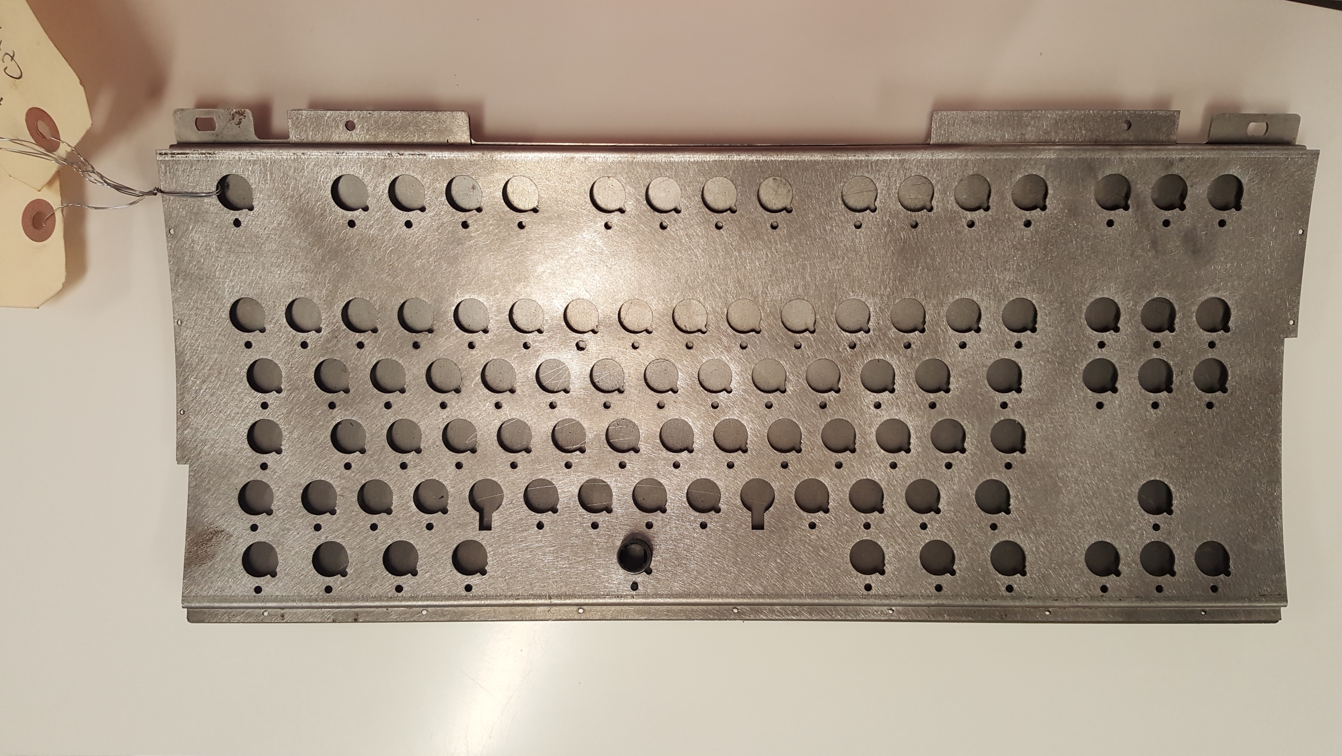

Status Update:
I stopped by the machine shop today to check on the plates, and I have good and bad news.
Good news - The bends (curve) turned out perfect on all four plates (2 top/2 bottom). The bottom plates fit both the SSK and full-size cases perfectly
Bad news - Somehow these yahoos managed to brake (90 degree offset bend) the top plates at the wrong location on the back. I explained the front offset brake had to be EXACTLY as I had it in the printed prototype (which they did perfectly), but then told them tolerance was available for the back offset. Somehow, they managed to fubar the easy part. I should have been more specific, but you would think a printed prototype and verbal announcement of "make it look like this" would have been enough :)
Upside, they are going to recut the top plates and process, which gives me the chance to sneak-in the winkeys and the universal cutout to support both XT and AT barrel locks (so a silver lining). So our prototypes will now be a reflection of the end result (as of now). I should know something within a week.

UPDATE: I am traveling this week, but did get a call from the machine shop that the new top plates are ready. So we should have some progress this long 4th of July weekend. Again, these will have cutouts for the winkeys, and additional 4704/AT barrel fitting. Assuming there weren't mistakes, it would be the end deliverable to date.

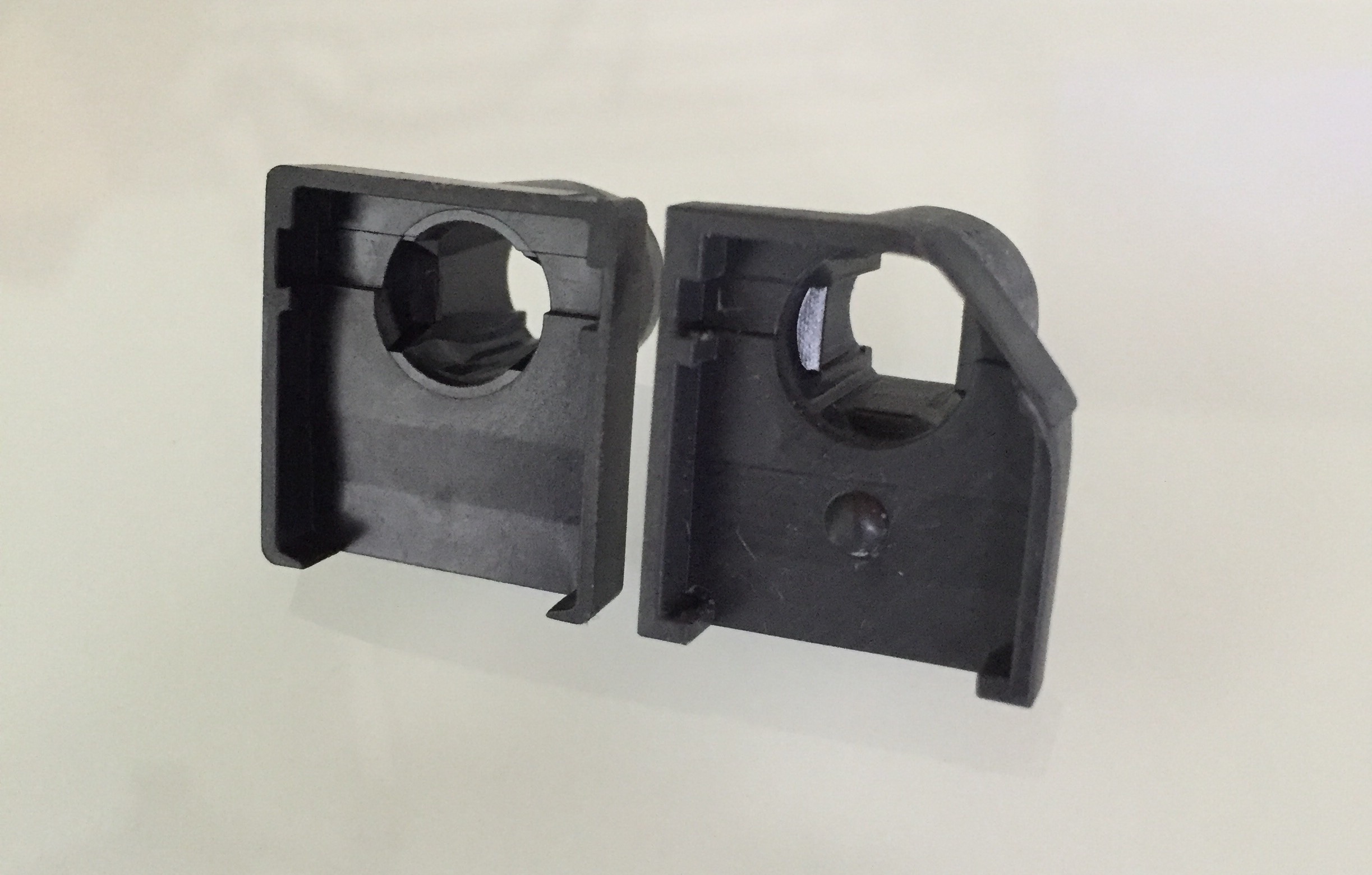

And before I left, I opened up my Shapeways order, and they COMPLETELY shit the bed on these prints. The tolerances were off by as much as .4mm on the keystems (making them useless), and I attached a picture of the deformed mess the barrel turned out to be. Very disappointing, but they are currently reprinting and will send out "ASAP". I have always been very pleased with their accuracy, but there was obviously something wrong with the printing and quality control

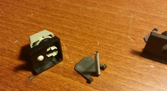

I tried myself a little bit on the sound dampening and so far not so encouraging things:
- trying to glue some vinilic dot on the same place you did on the barrel the sound does not really change at all.. so probably that's not the place where to work on..
- also trying to dampen somewhere else I noticed that the main point seems to be decoupling the barrel from the plate (probably that's also why there is always some strange foam-thing on ibm bucklesprings).. but if I take it to extremes and heavily decouple the barrel then I obtain actually a similar sound of that of a model m with a lot of usage and wear (!)
so to be honest I'd admit I think I'd actually then prefer to have the characteristic sound of model f and live with it since otherwise it seems it will kind of lose it's characteristics: what do you think?
What still is effective and I personally instead continue to do is reduce/attenuate the ring with dental floss (anybody tried or had ideas on alternatives?) because while the flipper noise is loud I find it nice but the spring ring is annoying to me because of the pitch more than because of the volume per se.

Excellent... Appreciate the help. When you say the following...
tentator wrote: trying to glue some vinilic dot on the same place you did on the barrel the sound does not really change at all.. so probably that's not the place where to work on..
Is this in reference to when the flipper returns to the barrel ("couples" using your terms), or on the decouple? I would have expected a slightly muted flipper sound when the key is released and returns from the PCB (though slight). It's good to know if you are not experiencing though.
Another method would be thicken the flipper paddle itself, but then we get into weight and spring actuation concerns.
tentator wrote: so to be honest I'd admit I think I'd actually then prefer to have the characteristic sound of model f and live with it since otherwise it seems it will kind of lose it's characteristics: what do you think?
Absolutely zero objections there... Just trying a few things to see if we bumble our way into an improvement. The more people taking a stab at it the better. Again... appreciate

you're welcome and actually the test with the vinilic glue is that white dot you see in the picture indeed that should attenuate the return of the flipper.. so far i could spot only a really tiny difference in sound but it might also be that the material I used and the positioning of that dot is not the best..
but the above has nothing to do with what I mentioned as a second test later on about decoupling the whole barrel (rectangle section of it at the bottom) from the pcb actually below it (and this is actually very difficult to test for me) and/or from the plate it is inserted in (there usually ibm put already some black foam that degrates badly with age.. ;))
so this above operation seems to mute the whole "click" of the switch a lot such as kind of muting it.. could you maybe try as well with some thin layer of something between pcb and barrel and experiment?
I'll try something again tomorrow..

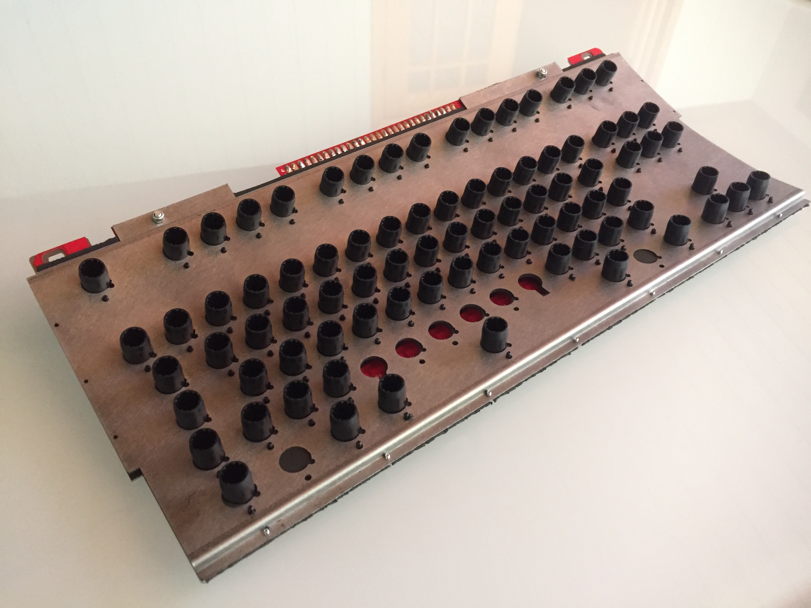

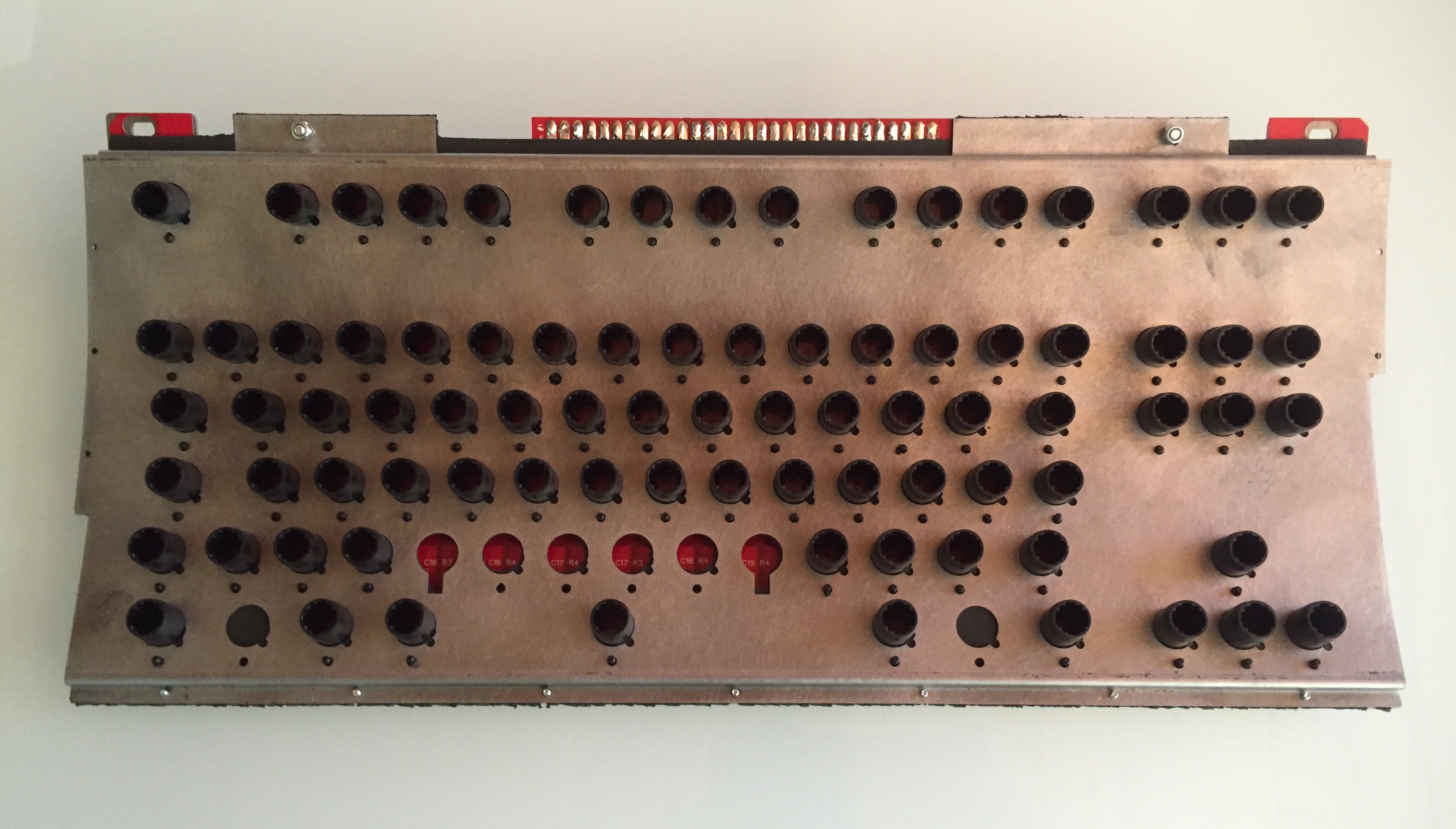

So I picked up the metal plates from the machine shop, and they look spot on for dimensions. They cut the replacement top plates out of 20 gauge steel (thinner than the original 18), but for the purposes of testing... They will suffice. Our run later will be back to 18.
I did go ahead and tap the m2 screws for the bottom seal, and test fit everything. Included a couple pics below to wet your whistle. I will go dark for a few days until I have everything finished (sometime this weekend), with several pics of the steps along the way. The moral... I can confirm it works
