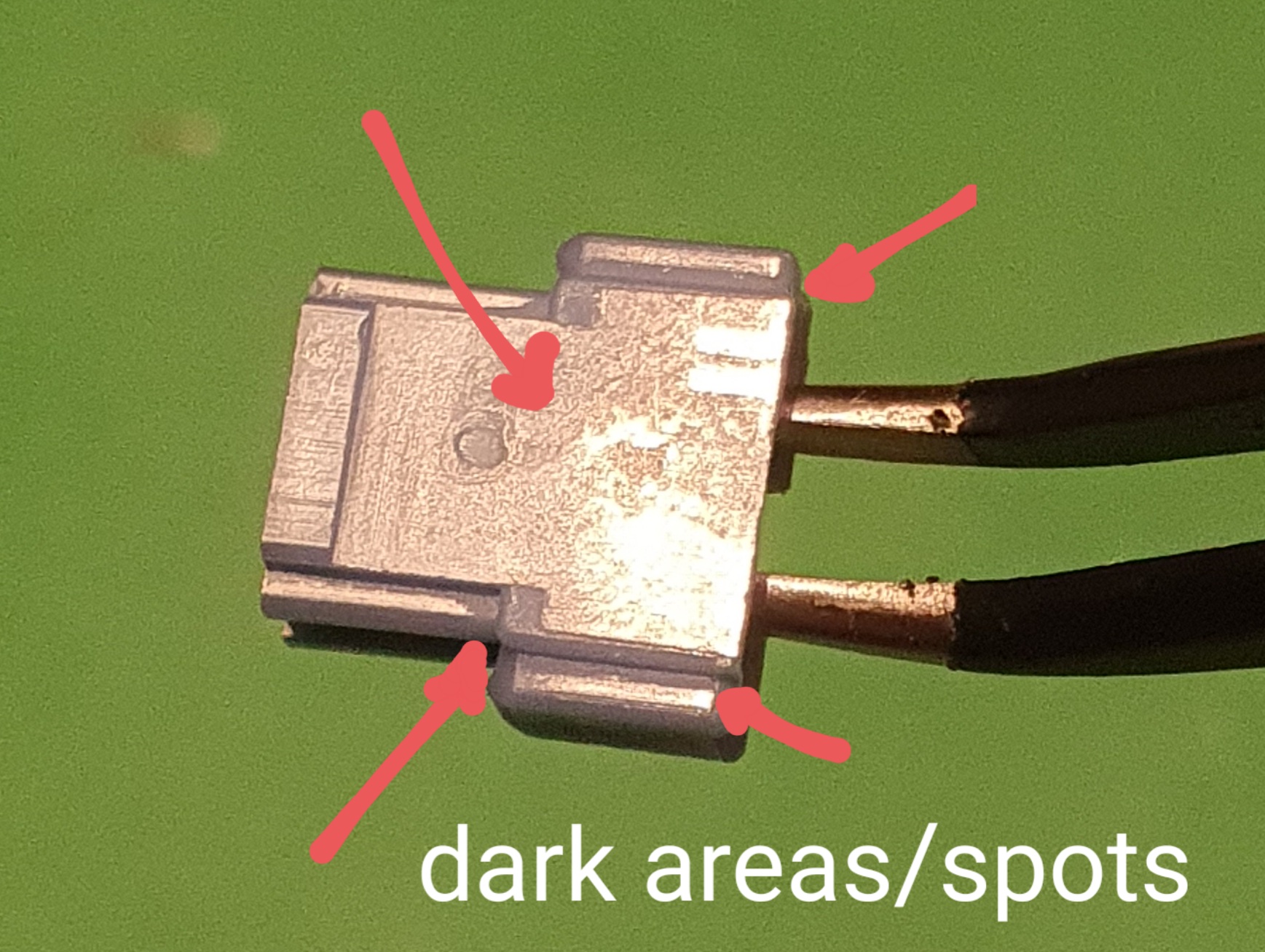

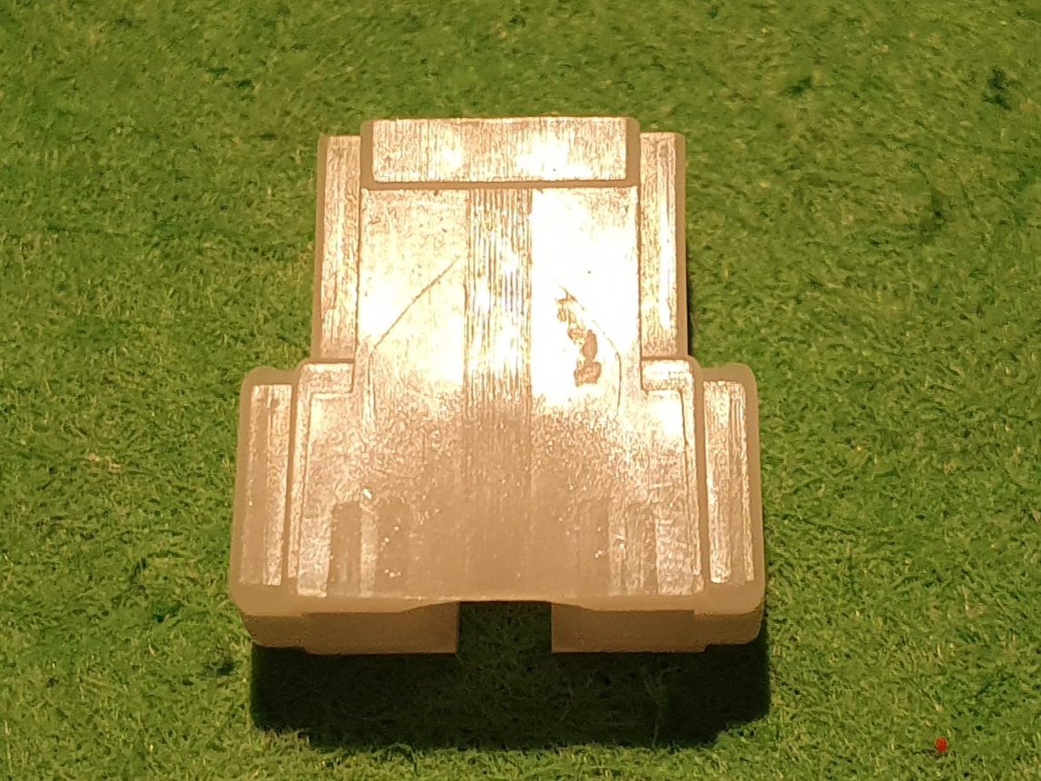

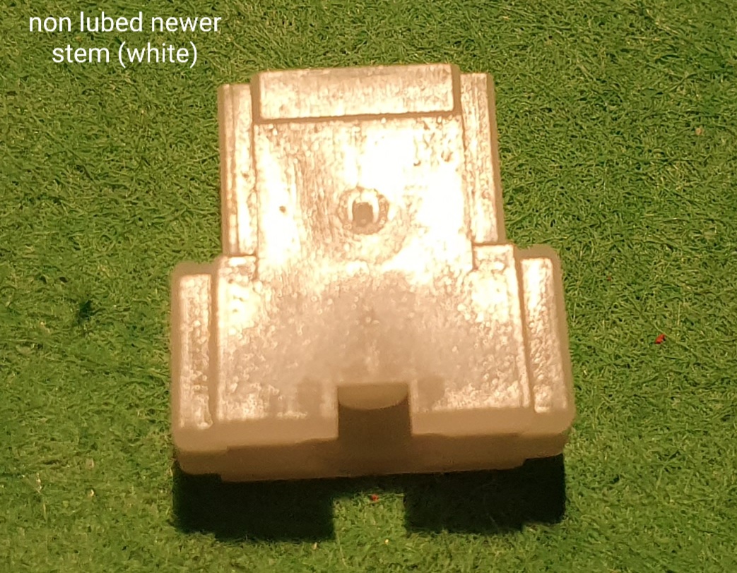

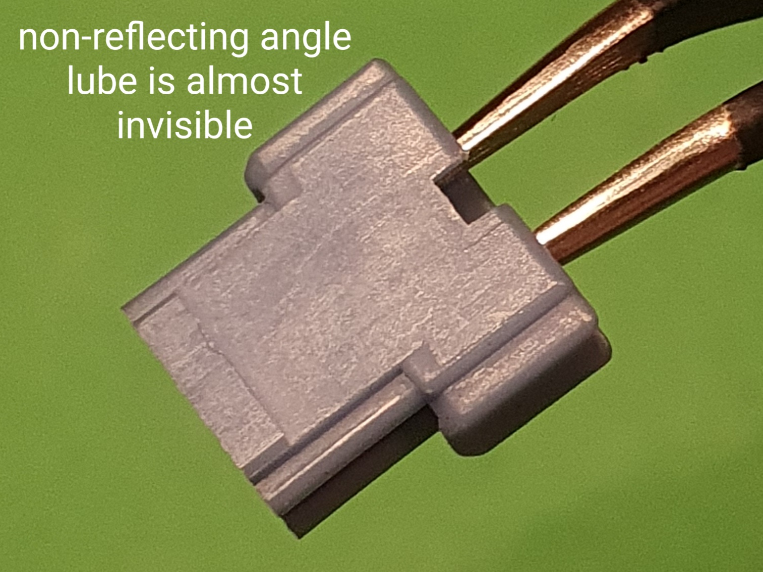

've noticed a significant difference between two of my White Alps keyboards. One of them is from ~1989, and the other one is probably from 1992/1993. The 1989 keyboard's White Alps feel much different and they definitely used dry lubricant at some point because there is grey residue on the slider.
viewtopic.php?f=2&t=12915&start=420#p299646
This is the picture from that post
Keycap, the author of that post, points out that the "old" (early) white stem has lube on it and that the newer doesn't based on the dark stain on the bottom of the stem seen in the picture. However, I am not convinced because
1. the dark residue on the bottom is just stain, as others have pointed out on previous posts, formed from the years of contact with the metal leaf (oxidation? I don't know), and not a lubricant. If they were actually pre-lubed, then the lube would be visible as darker coating all over the switch, especially seeing it against a bright light.
2. the plastic materials of "old" and "new" on that picture are the same, they look exactly as the all other instances I have seen of the newer material stems. You can tell that just by how shiny they are and how smooth they appear. The earlier material on the other hand, is not that shiny and with close viewing, it is visible that it has some tiny texture to it (i.e. not perfectly smooth).
Of course, please correct me if I am wrong in any of these. So here we have a comparison of early and later pine Whites, where both of them, as far as I can tell, are made of the newer material. And, apart from the - disputed - stain in the bottom where the metal leafs contact, there is no evidence that the "old" had any lubricant. Again, please correct me on this, and if keycap is reading this, please, if you still have them, would it be a trouble for you to take some more pictures of the old and new stems again? That would be very helpful.

Here is a photo of how a prelubed stem looks. it can only be seen against a light source, in an angle that is reflecting the light directly. (in non reflecting angles, it simply cannot be seen at all.)
The darker areas, are the lube that has never been in contact and has dried up and darkened. Thus implying, that the shiny (non dark) areas, are where the sliding contact took place and the lube there has been smeared. To verify that those darker spots are actually lube, you can use a pin/tweezer and gently touch a dark area and move it around, it will smear the lube and leave a visible "clean" trace on it.
And here is the newer material stem of a White pine SKCM
Notice how there are no dark spots anywhere (no lube). And especially notice how the areas of contact are appearing actually a bit darker, giving the opposite result than that of the blue SKCM above.
Again to verify that there is no lube, use a pin and try to smear the "darker" areas around, nothing will happen or change.
Also notice how shiny and smoother the material is. And look that weird vertical stripe in the middle, that is not present on the Blue SKCM stem, as far as I recall.
Hope this helps.

Yeap, that stem is definitely lubed. Can you also tell what kind of material is the plastic? If it is the old or the newer one? I also think that I have the same switches in an AEK, I will checked them out too.
