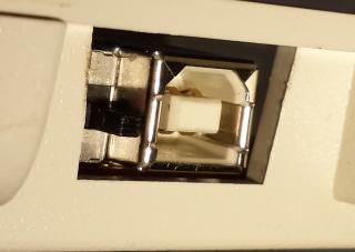

Thanks for the encouragement everyone! I was getting a little bummed out about the Micro B. The only issue I was having with using USB-B on bluetooth applications was the power switch... but then I stepped away and got to thinking about some clever mounting techniques I've seen in vintage electronics. Solder the switch case to the USB connector! Plenty of space and it's a perfect fit.
Ideally it should be moved out about 2mm, but at the moment it's pretty easy to actuate.

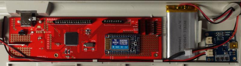

General layout, everything fits perfectly with clearance between steel plate and the EZKey:
2015-04-04 10.56.24.jpg (41.02 KiB) Viewed 6956 times
A happy coincidence is the wire routing. I was worried about it looking sloppy, but they fit just right between the mounting feet. Rockin'.

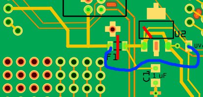

Next matter of importance:
Hooked up the 3.3V voltage regulator.
Cut trace to UVcc/VBus.
Reset button to get into DFU mode doesn't work.
Jumper wire between USB 5V and the UVcc/Vbus pad.
Reset to DFU mode works again.
Flashing a hex file throws error.
Bypass voltage regulator to run everything at 5V again and it succeeds in flashing.
So, umm... I'm guessing flashing at 3.3V doesn't work? Or am I missing something?

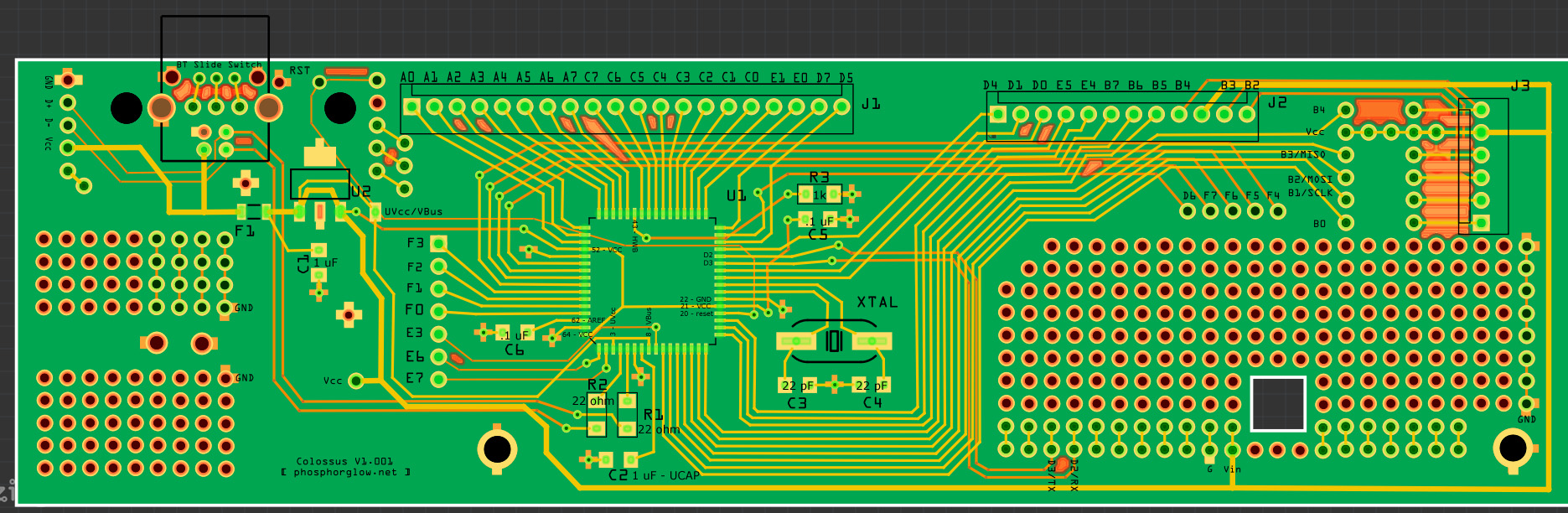

And can you post schematic so that we can check easily? The pic of PCB traces is low resolution and not easy to read :(

Bah. Can't upload it to my site at the moment so I have to be a bandwidth hog. I'll move it later. Here's the updated layout. I actually don't have Ucap connected like it was previously.

How do you cut trace(or jumper) in fact when you install the voltage regulator?
phosphorglow
09 Apr 2015, 06:07
Correct. Actually, bootloader enumerates and I can erase but not flash on 3.3V.
Cut the two traces near the regulator, remove fuse, jumper between UVcc/Vbus and USB 5V.

Just wild guess, no capacitor on output of regulator may cause kind of power problem. I imagine that flashing needs more current, output voltage comes down and MCU is brown out reset finally...
What if you add output capacitor on regulator?
phosphorglow
09 Apr 2015, 07:15
Sounds like a reasonable theory - I'll give it a shot. I just watched the voltage while attempting to flash and it stayed steady at 3.29 the whole time. I'll see what the current draw looks like and try a capacitor.
phosphorglow
09 Apr 2015, 07:21
Nope. :/
Tried a 1uF 50V electrolytic. Same thing.
