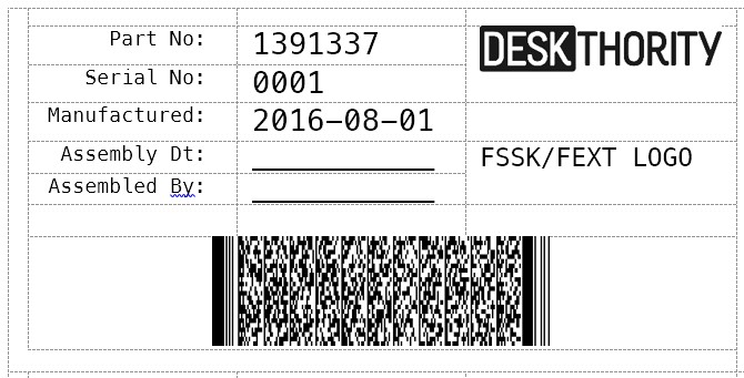

Hi, everyone. I've got a first try at the inner assembly label. I wanted to use the size of the original IBM external labels (right around 4 1/2" by 2 1/8"). Because there aren't any pre-cut laser/inkjet labels that size, I designed this as a table, so that we can print them on a full sheet label and cut the individual labels from it. The barcode is in PDF417 format. I think it looks really cool, and it packs an incredible amount of text into a small space. This particular graphic encodes:
FSSK/FEXT Project from http://www.deskthority.net. Thanks to idollar, lot_lizard, xwhatsit, wcass, and everyone else who worked to make this happen. Special thanks to Richard Hunter Harris of IBM for inventing the buckling spring switch (U.S. patent 4118611, filed on 30 August, 1977), and the IBM engineers who later created the capacitive buckling spring keyboard.
Feedback?
Feedback?

I really like it. I think the use of PDF417 provides some nice symmetry, and the message in the code is very nice. The location of the DT (full version is ideal) is in a nice spot. The suggestions would be the label size, format, and font.
The size... 4.5x2.125 is SO close to the mass produced 4x2 label that I would probably lean towards the generic size because it makes the process of producing these easier (rounded corners and print label templates = minimal effort later).
The format (not layout) is in reference to the date. If ISO-8601 format would have been widely adopted at the time, it would have been used (IBM adopted in the 2k's in force). For clarity, ISO layout would be 2016-08-01 in your example.
For the font, I like full words in labels versus abbreviations (but I am verbose in nature). If you are using full words (part number, date, etc), then the labels will have to be smaller than the actual value if you keep the same dimensions. I also prefer mixed case for labels (Part No vs PART NO). As for the actual font used, I like what you have, but will leave feedback there to those pickier than I
Again... Love multiple things about what you have. Just mild tweaking in my opinion. But I am by no stretch a dictator to this process. Hopefully others chime in as well.
EDIT: one thing... This label is where I$ should be able to PROUDLY display the FSSK/FEXT logo (since it is tied to the model in the "line") if he wanted to. If he did have ideas about a logo for his project, I would like him to be able to add it. Ideally, it would be either FSSK or FEXT (not both in generic fashion) pending on the assembly to match his original desires. Techno, if you could reach out to him directly to make sure he sees this label activity'? We can all have say about how it is incorporated, but want him picking the logo (he's earned it).

I really like the label as well. Font is great, and the barcode is a cool idea. I would definitely agree with Lizard, though that mixed case full words would be nice to experiment with. At the very least some bolding and a colon would be nice to seperate things out a bit. I might also recommend raising the part number to be aligned to the top of the Deskthority logo, as well as maybe reducing the amount of characters in the serial number, and aligning the Assembeled date on that same line right below the DT logo. Then we could probably have space for an FSSK/FEXT logo in the bottom left or right. When I get home I can try to make a mockup.

The assembly date aspect of the label brings up an interesting point about a group buy that needs some discussion. The eventual group buy I was planning on doing more "a la carte" than dictating that everything was fully assembled (assembly option as well). Ultimately it could be cheaper for folks with parts on hand, and let you do as much as you wanted yourself. Also, if you wanted alternative colors, etc, we could just leave portions out of some processing, and you could customize yourself after delivery. We might get more participation that way, which ultimately drives down costs even more for everyone. This is the beautiful "downward spiral" of the non-profit group buy. I haven't committed to this yet because of the increased difficulty of juggling orders and pricing, but it is my initial thought
Having said that, back to the label... maybe it makes more sense to have "Assembled:" with an underscore to the right to have the person putting it all together sign and date?!? Makes it a little more personal I think

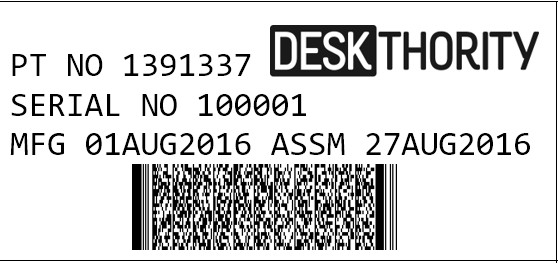

Okay, I have a DM in to idollar to ask about an FSSK/FEXT logo we might be able to use with this. Here's a new revision. I changed the font from Consolas, which is Windows-only, to Meslo LG, which is Apache licensed and should be usable everywhere. The outer dotted line is the placeholder for the label border (4" x 2" label sheet), and the inner dotted lines are just the alignment table (they aren't present in the printed output--see PDF for what a label sheet should look like).
- InnerLabel_v2.pdf
- (56.13 KiB) Downloaded 225 times

Huge fan of the changes

Awesome, I'm glad you guys like it. It's good to be able to contribute to this fantastic project! I'll do a final revision once I hear back from idollar, then I'll post the label sheet in a couple of formats, so anyone can make use of them.

One last request... I would like you to add yourself in the list of people to thank. Also, if you could add titles and full URL links to the projects for xWhatsit, XTant, and I$'s FEXT/FSSK, and ours here to the scan code... Then it is cherry. I would need to Google, but I think PDF417 still has plenty of space. I feel those stories combined really paint the picture of underground effort
The only remaining bit would be the size and layout of the DT and i$ logos, but we will need to see his before we can say for sure. If someone wants to take on the logo for i$ (using his input), I'm sure he would appreciate.
EDIT: please add Phosphorglow as well. He was a big help for cutting the foam. I have a logo already created for Phase 2 (decent graphics designer), and plan on laser etching into the floating case backplate... but that is Phase 2 down the road
