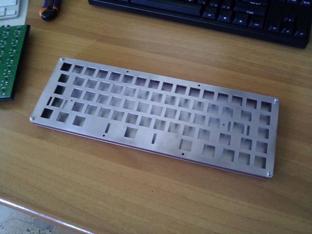

It arrived! my preciooouuussss!
this is so freaking awesome I'm gonna cry :mrgreen:
25 Jun 2013, 13:06
She's a fox, in the waiting…
-[°_°]-

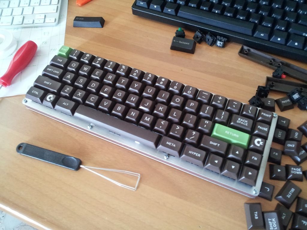

25 Jun 2013, 15:42
And here it is the brownfox in all its splendor :)
Compared to the steel version it's very light and the overall typing experience is completely different (keys are not yet wired). I think that the best combo would be steel bottom and aluminum plate. Anyway now a long wiring session awaits me.
