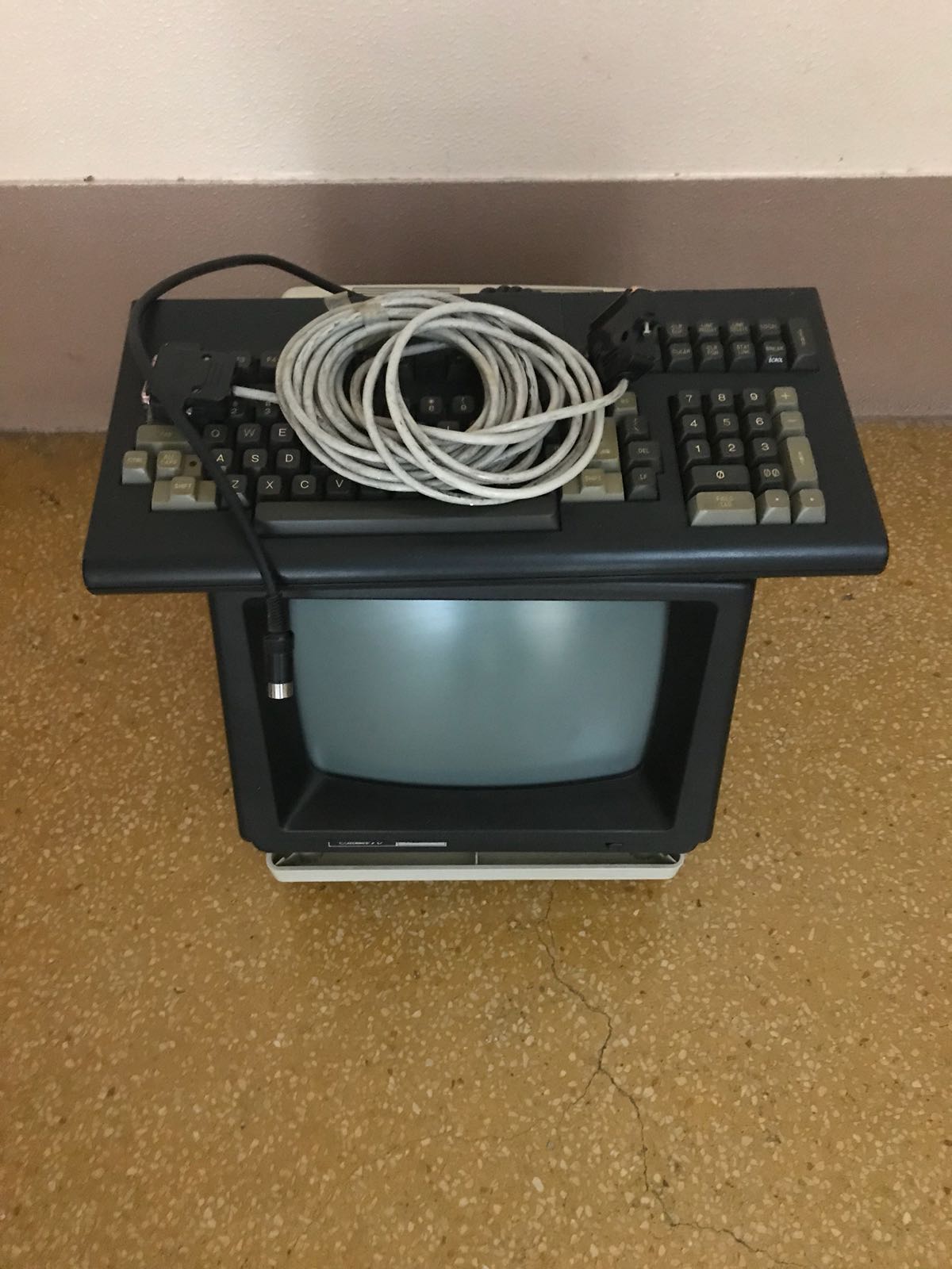

Anyone know what model this keyboard is? It's part of a Hazeltine Exetuive 10 terminal , but I can't find any information related to this product.
Thanks.

19 Mar 2018, 17:52
mannoso wrote: Anyone know what model this keyboard is? It's part of a Hazeltine Exetuive 10 terminal , but I can't find any information related to this product.
Thanks.
This appears to be the same keyboard as in this thread, so Futaba MD.

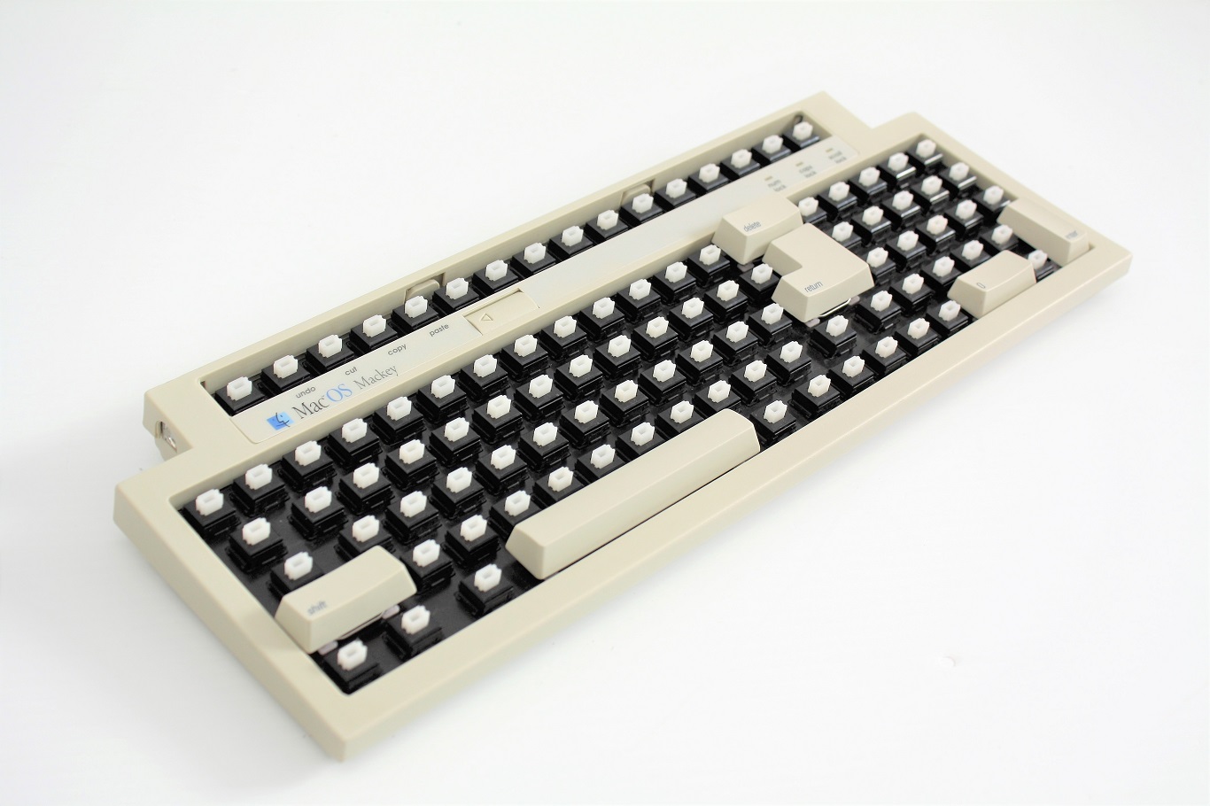

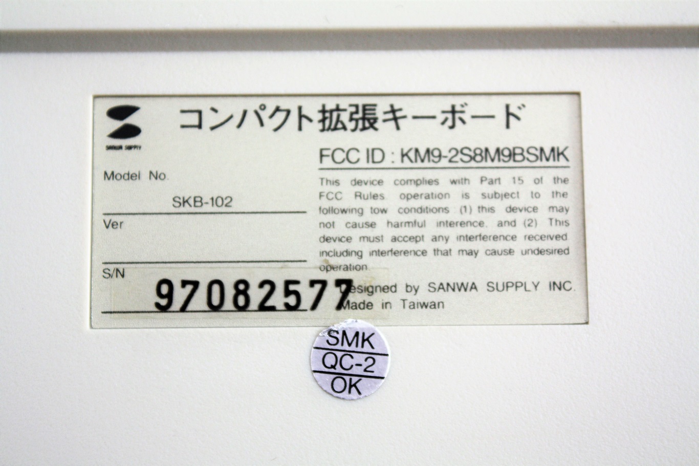

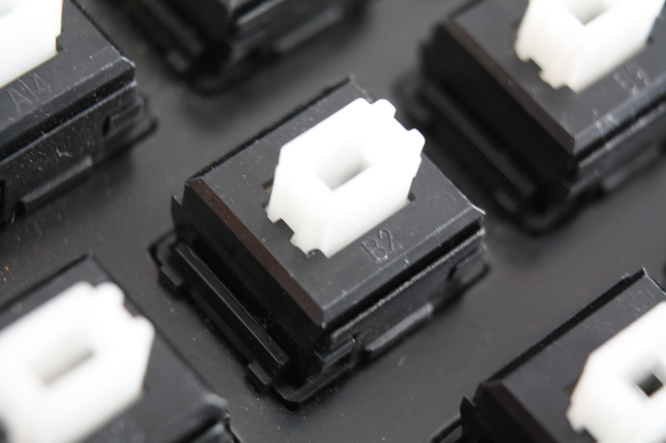

Anyone know the key switch type? Looks like Alps but not marked. White key clicky switches. Keyboard has SMK quality control markings and Strongman keyboard controller. Similar to http://park10.wakwak.com/~jpspace/key/k ... 102mj.html
White clicky key switches
Strongman keyboard designed by Sanwa Supply Inc.

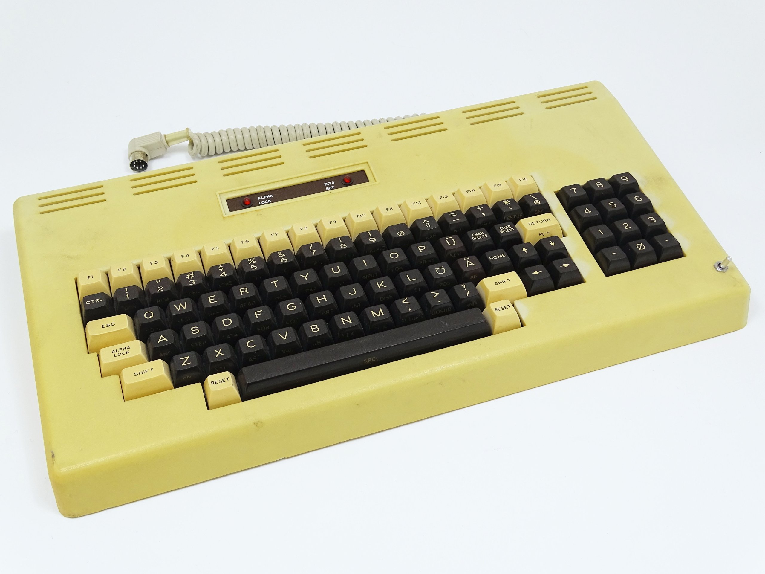

Had a friend send me this board recently, no badges/labels that I've seen. I'm assuming a G80-04XX but I am not sure.

Pwner wrote: Had a friend send me this board recently, no badges/labels that I've seen. I'm assuming a G80-04XX but I am not sure.
LOL this used to be mine... the grime on the caps is literally the same
funny how this stuff changes hands
I would love to know what it is as well, I could never figure it out. it's certainly not a g80 as it has no markings on it anywhere.

snuci wrote: Anyone know the key switch type? Looks like Alps but not marked. White key clicky switches. Keyboard has SMK quality control markings and Strongman keyboard controller. Similar to http://park10.wakwak.com/~jpspace/key/k ... 102mj.html
four tab alps clones, beardsmore would know more about exactly which brand.

Myoth
24 Mar 2018, 00:27
it's not a Cherry board for sure though, for having a 0414 the pcb should be green on both sides :
photos-f62/g80-0414h-09-t17972.html
They are [wiki]four-tab clone[/wiki] switches, and the mould cavity numbers are Himake-like. The cheaper types (alps.tw Type T5 and T8) have small notches in the slider aperture, which if present in yours would not be visible from that angle (they are to the rear of the slider).
There's a whole variety of those four-tab clones, of which none are conclusively identified with any Himake series. The most you can do is see if they match any of the known types by way of examining the internal parts.
Ortek (one of the companies most known for using four-tab clones) are still around, but we need a Chinese person to try to extract answers from them. Strong Man are long gone. The other company was Focus, whose website is still up but who seem to be dead.
