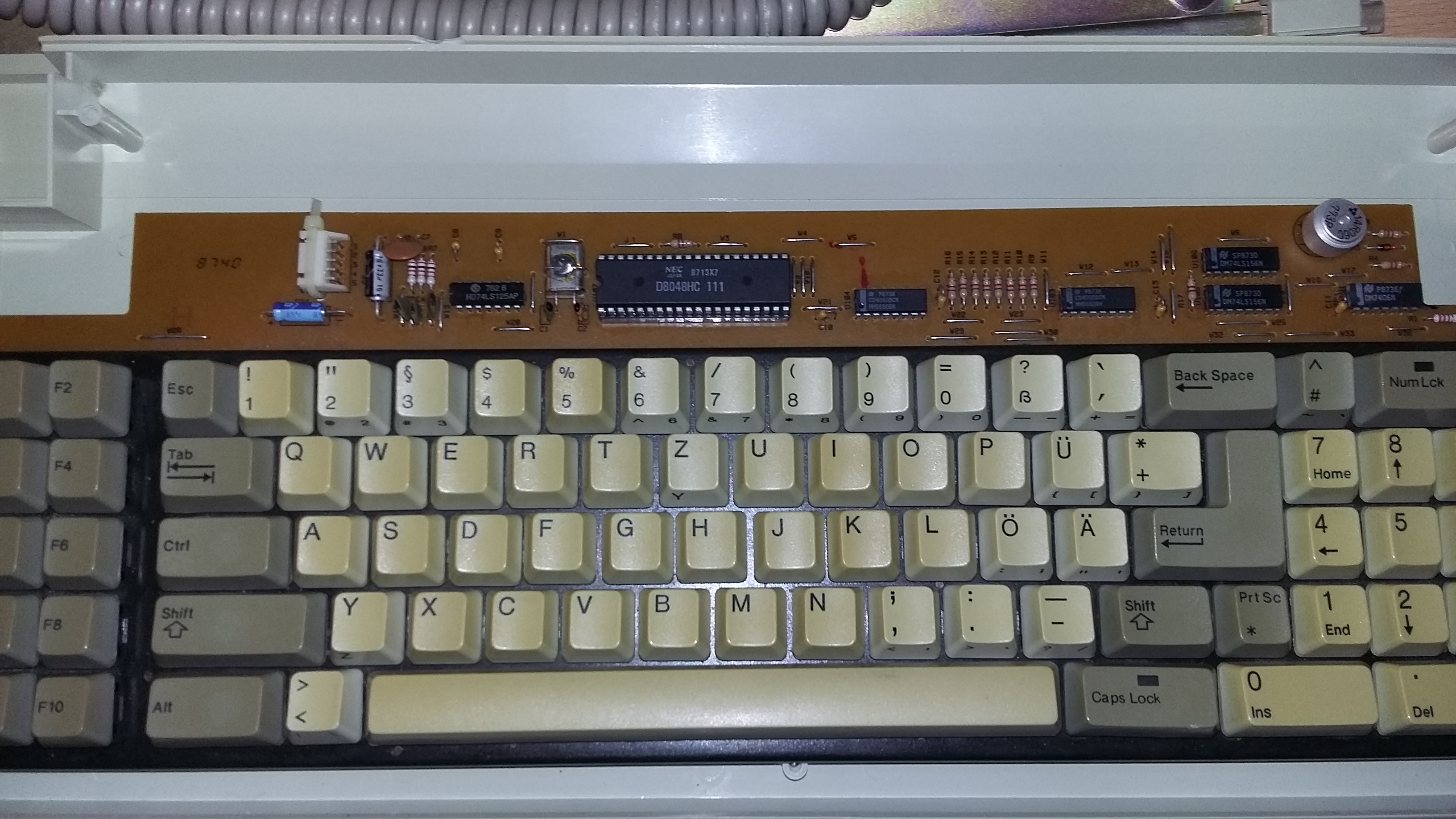

These cables do not work with any of my Z150. Ask orihalcon, be prepared with a picture of the pcb, he might be able to help you. He is a use here, maybe you can get a discount.

Here it is
- 2018-02-21 21.42.08.jpg (1.72 MiB) Viewed 7446 times

What is the CHEAPEST and easiest way to convert this to PS/2 or USB?
- //gainsborough
- ALPSの日常
- DT Pro Member: 0188
Assuming it's like the protocol on the z150 - I don't know of but a few cases where anyone was successful at converting them in the first place. I could be entirely wrong though. If anyone actually does know of a working converter for the z150 or this zkb-7 I would love to know where to get one as well!

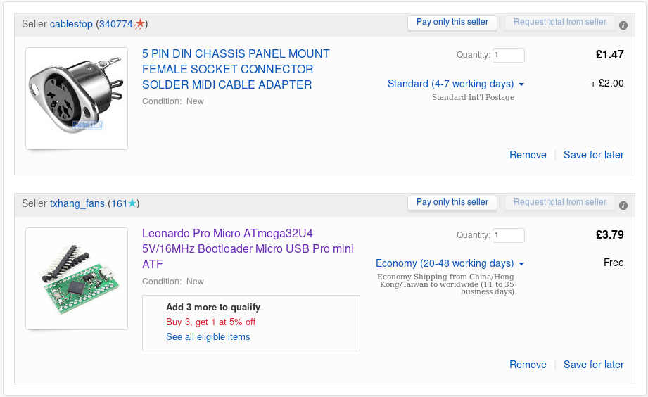

looked into it and it looks easy as 1 2 3. There is a significant chance I am going to do it.
Will these parts work, ohaimark?
