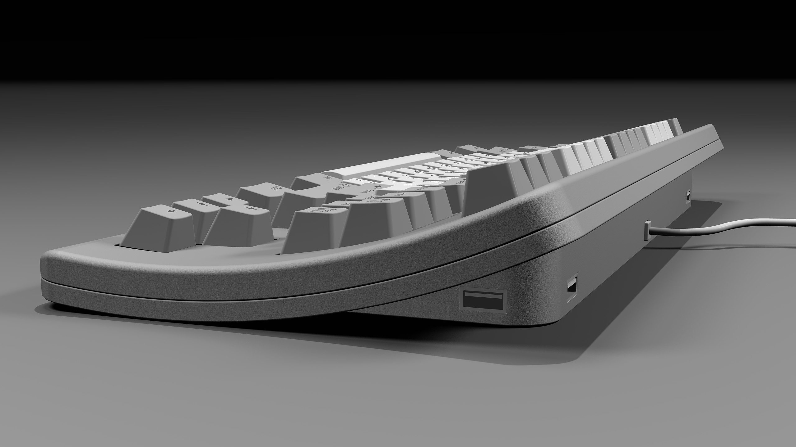

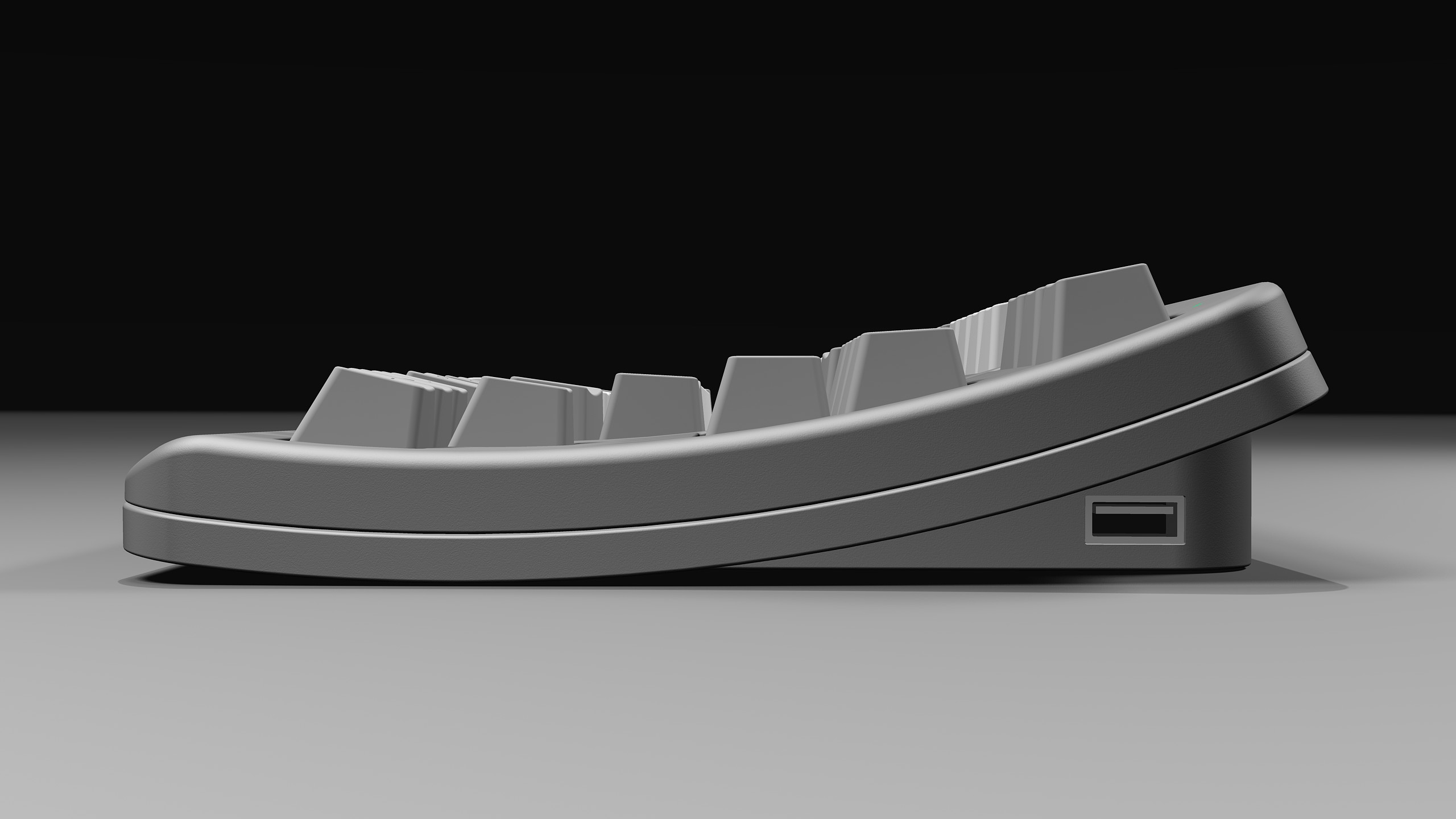

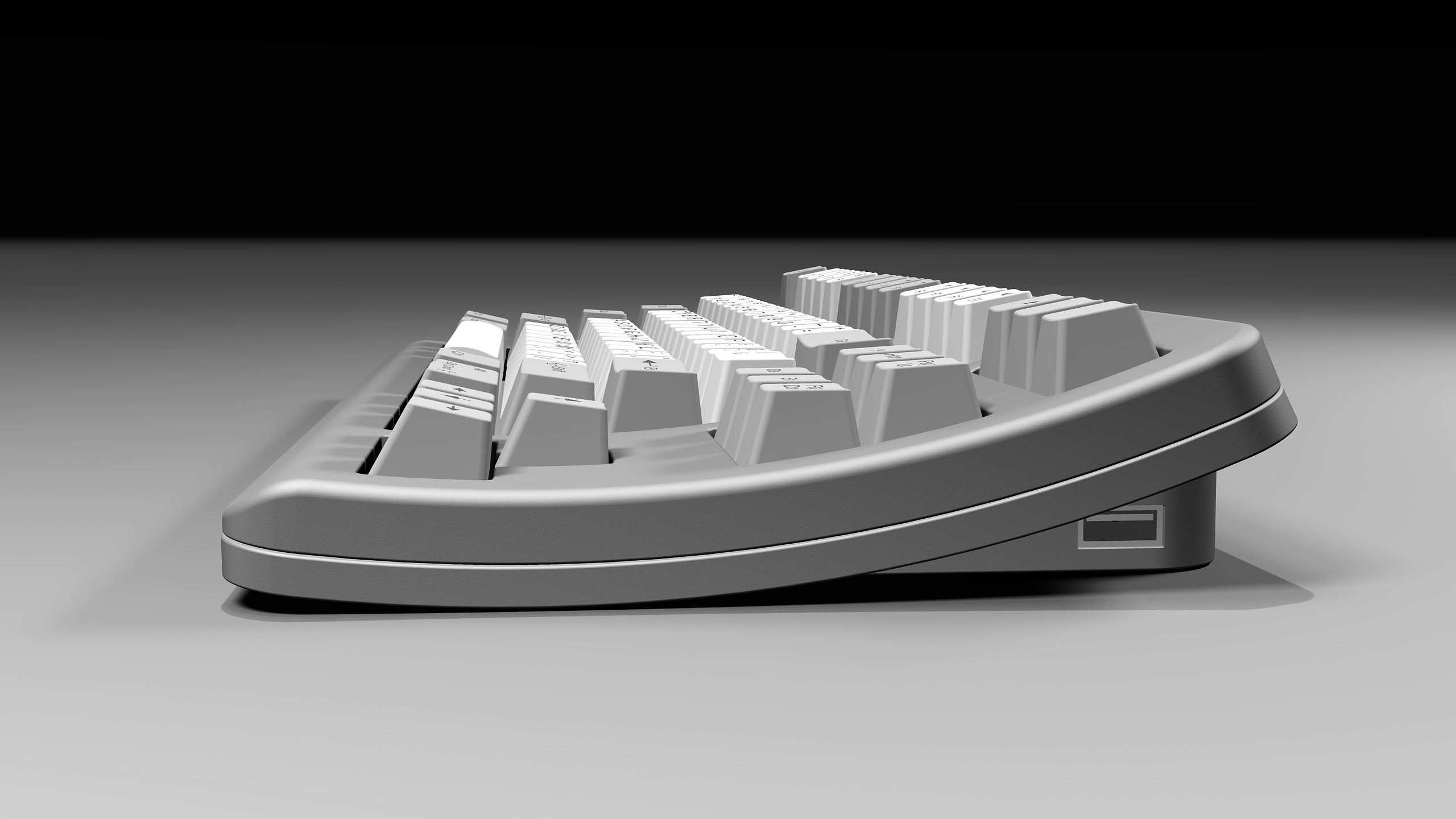

question for you; how deep is the base (where USB port is) recessed from the edge?
it looks like you might be able to plug a corded mouse in there and not really see the USB plug. i like that.

SDL? Why not mini (or micro) USB? SDL would only be an inconvenience this day and age, plus more costly to source than ubiquitous USB.
As for the LED: quite smart, but I suggest one alteration: instead of a steady "ON" state, make it flash for a few seconds when turned on, but then go dim. The state change is what we care about, and the less distracting status lights lit up on things the better. Blinking on low power makes sense too.
Of course, next you have Bluetooth pairing dynamics to contend with…

I kinda like the SDL plug actually
I agree it is not convenient nowadays though. Anyway I have plenty of usb/sdl cables
do no put flashing or pulsing LED, they are really distracting.

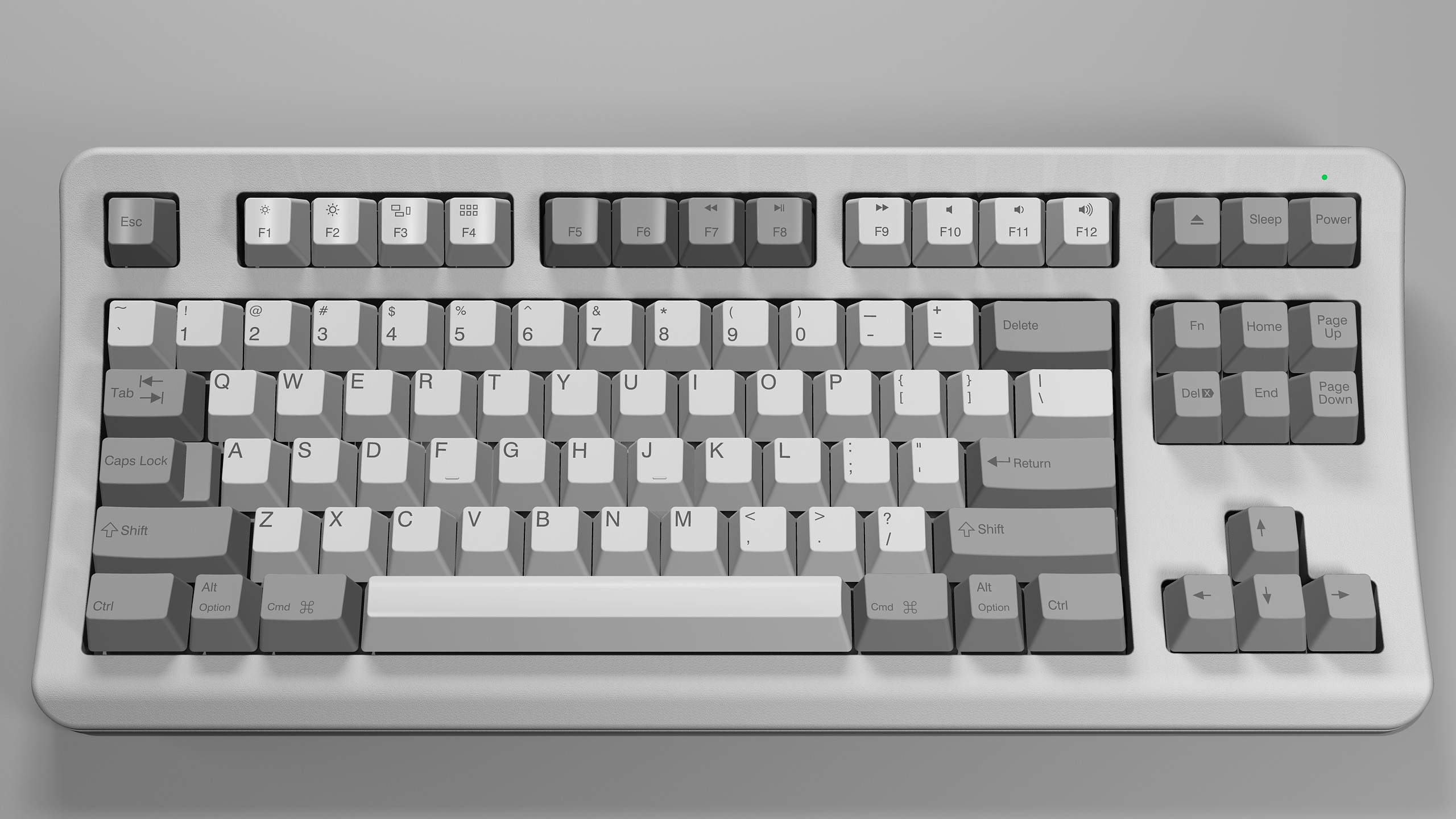

The current version looks very nice indeed! I like the pinhole style Bluetooth / power indicator. Green is a smart colour choice for that little guy, in keeping with most Bluetooth peripherals I use.
Not to keep giving you more work, but this round of suggestions!
- One well implemented light leads me to want more. (Light haters bear with me.) Modern Macs have glowing Caps Lock indicators, even Apple's own little battery powered desktop keyboard. I think a lack of Caps Lock light might be quite the stumbling block for many users. If you could make a matching row of small, separately coloured, status indicators, I think that would be ideal. No need to even label them, I think. The colours and order should be enough. Count me in for integrated Num Pad lock!
- The way I'd do a security function (and this is very much an optional, never heard of it elsewhere feature) would be to use the keyboard's keys, of course. How about a user definable chord: like Ctrl+Shift+O+K? Much more memorable and also quicker than pecking Morse like sequences.
- Flip the right hand set of Mac mods. They're symmetrical. Always Ctrl-Opt-Cmd-Space-Cmd-Opt-Ctrl.
