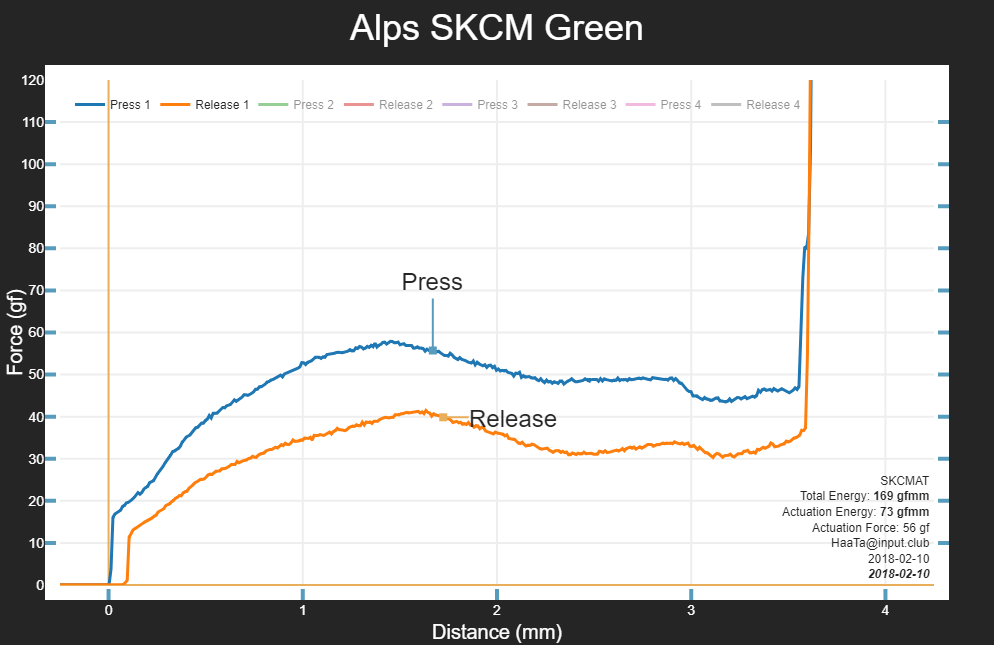

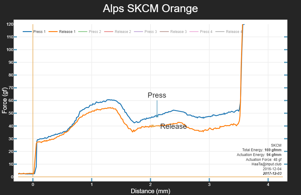

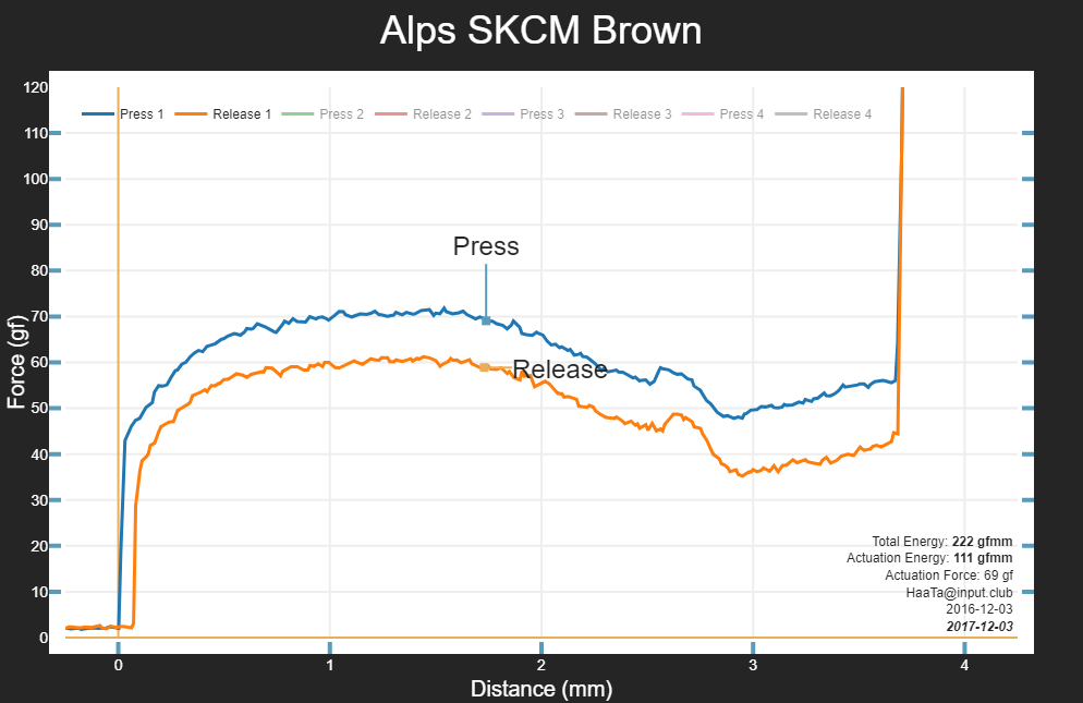

I am quite keen on force-displacement curves as a means of comparing keyboard switch characteristics and gaining partial insight into why one switch feels similar or different from another. HaaTa has done splendid work in this area. Here are his curves for SKCM Brown, Green, and Orange switches:
Alps SKCM Brown
Alps SKCM Green
Alps SKCM Orange
Note that the Green is the SKCM Green rather than the linear SKCL Green. The curves for the Brown and Green switches are similar to each other and rather different from the curve for the Orange switch.
I suspect that these switch characteristics are due in large part to the tactile switch plate/leaf design rather than the spring.

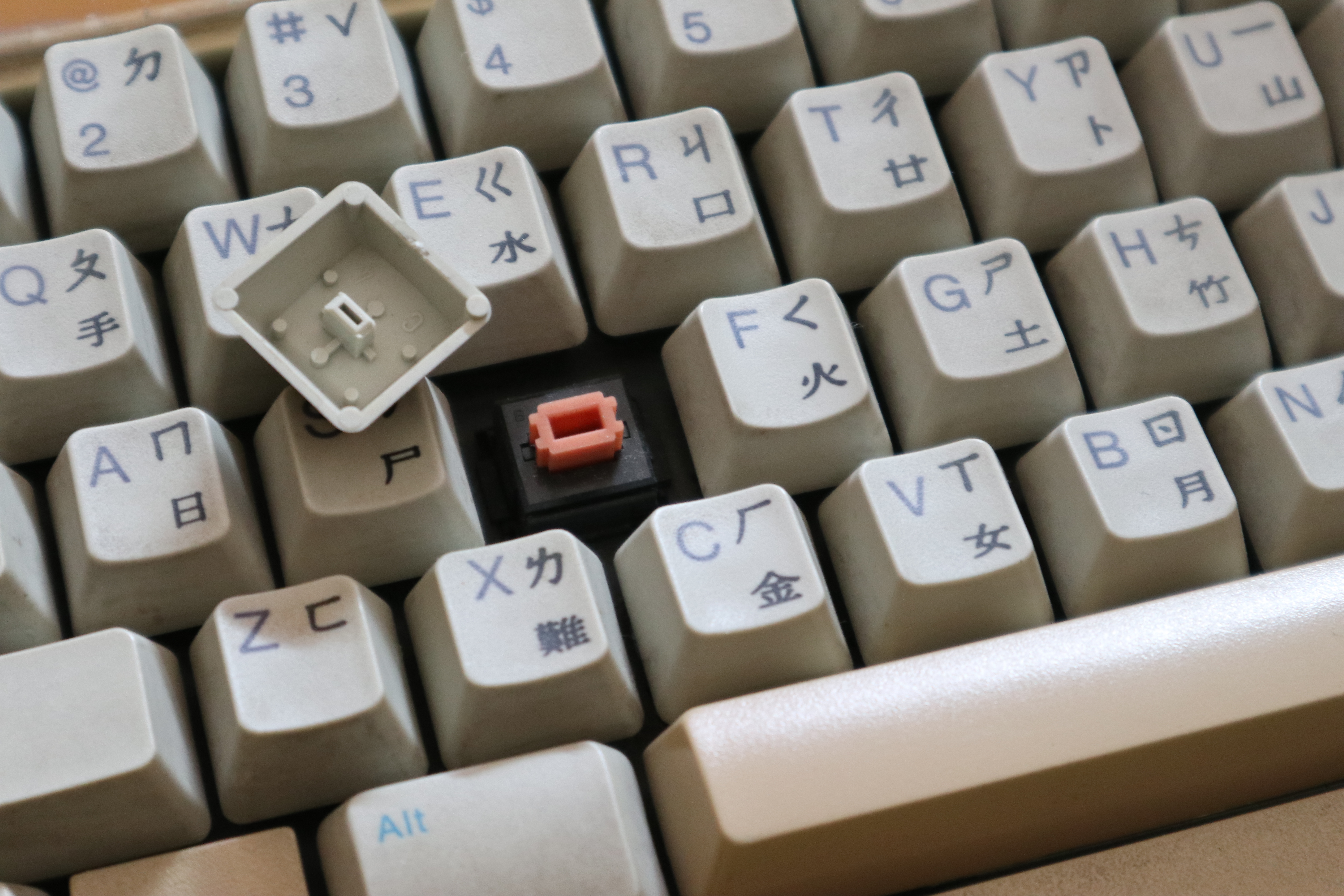

ImagePA170046 by Myoth, sur Flickr
Ever since I got this keyboard a few months ago, I wanted to try this mix of components. mike52787 was kind enough to give me one of those SGi without its caps (mostly because I was helping him get rid of stuff he didn't want anymore :lol:) but it turned teal with the yellowing. Fortunately for me, two SGi popped up recently on ebay.fr, I coped them both for cheap and the Granite was not yellowed, so it gave its case to this keyboard above. I'm pleased with how it looks, I like it a lot. It's a simple yet affective look. This was the SGI KBU-1971 :mrgreen:
