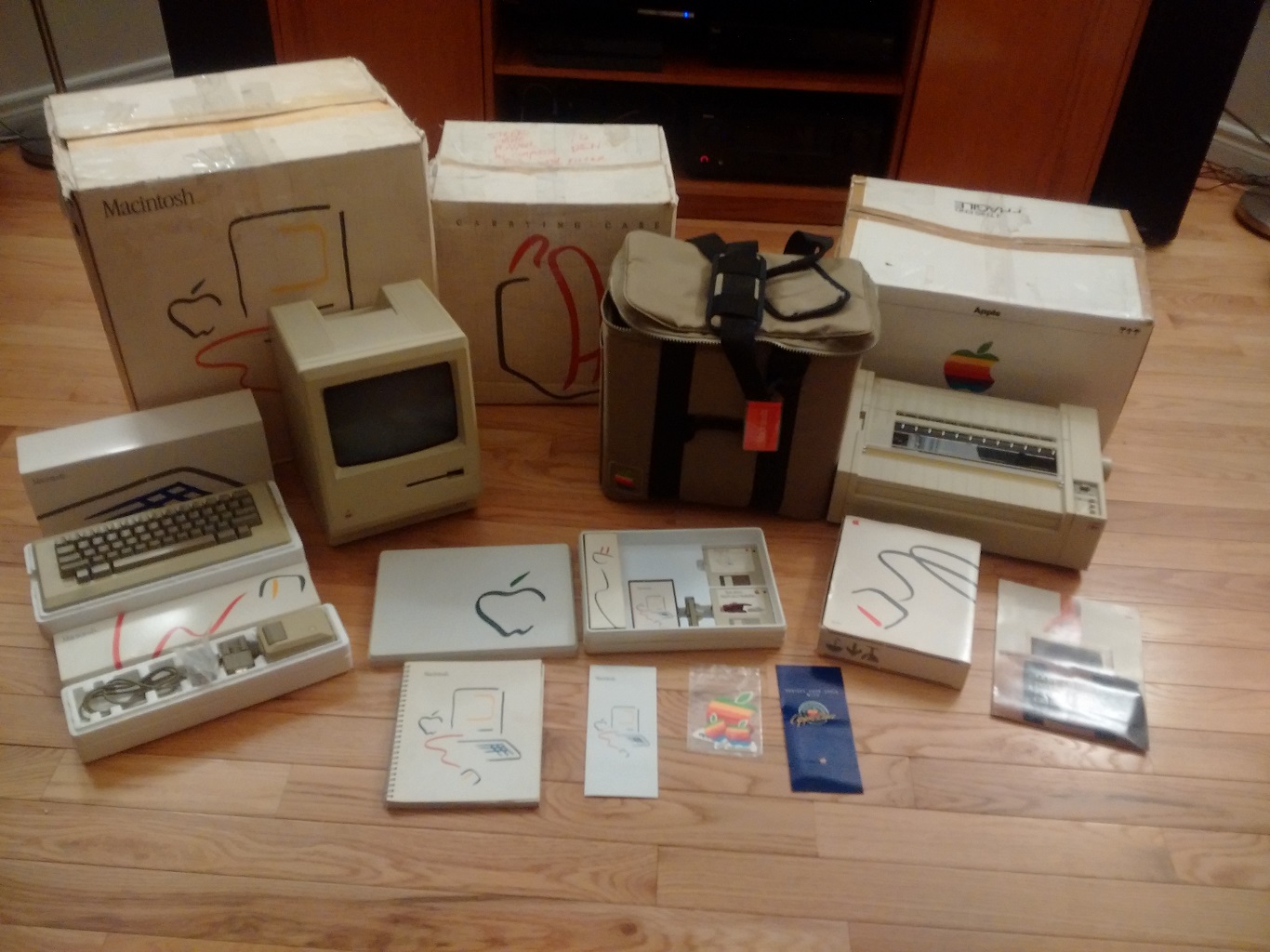

I didn't realize people like these keyboards. I have a few of these and I think I have one of these in the box but it came in the Macintosh 128k box. For Mac collectors, my box is cooler ;)
All joking aside, any original box is cool so thanks for digging up this thread. People convert these for use today? Interesting.
I did find a pic I posted elsewhere here:
Boxed Mac 128k.jpg (366.62 KiB) Viewed 5750 times

The box you have is for the M0110A keyboard that was in an upgrade kit (as it mentions). The part number threw me off but it was an offical part (the upgrade Kit) even though it was an M0110A keyboard. The difference between the M0110 and M0110A was the addition of a numeric keypad. Someone must have upgraded and therefore swapped keyboards because it looks like you have the M0110A styrofoam. You got the better keyboard (in my view).
From http://tech-insider.org/mac/research/1986/0116-a.html (text of a press release, I'm guessing?):
The Macintosh Plus Keyboard Kit (P/N M2519). Available in January, this kit includes a keyboard with standard alpha layout, cursor keys, and a numeric keypad for easy data entry. It requires no dealer installation.
