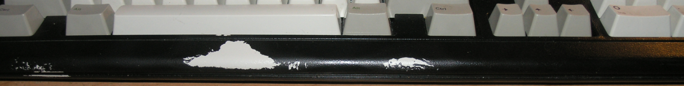

I tried Krylon fusion on my M, actually. It looked amazing when the paint was still fresh, but unfortunately it didn't take long at all before it started to wear and chip off - right where my wrist sits when I'm playing games. Ended up stripping it off with brake fluid. The cable didn't fare much better.
Now, that said, it's possible I fucked up, since the paint stayed sticky. But I followed the instructions to the letter, and gave it plenty of time to dry on a hot summer day, so I'm not entirely convinced of that.

Interesting. I have heard of plastic paint staying sticky when the paint was designed for hard plastic and used on soft plastic. Apparently, in that situation, the paint reacts with the plasticizer and it never dries properly.
Did you use any kind of pretreatment? If so, there might have been residual solvent that kept the paint from drying completely.
How long did you wait between painting and actually using the keyboard? Krylon takes 7 days to cure completely.
Crazy Canadian XXIV
14 Oct 2016, 21:39
No pretreatment. Just washed the case down a couple days prior, then straight to the painting. I did allow it a full week to dry on my coffee table before using it.
