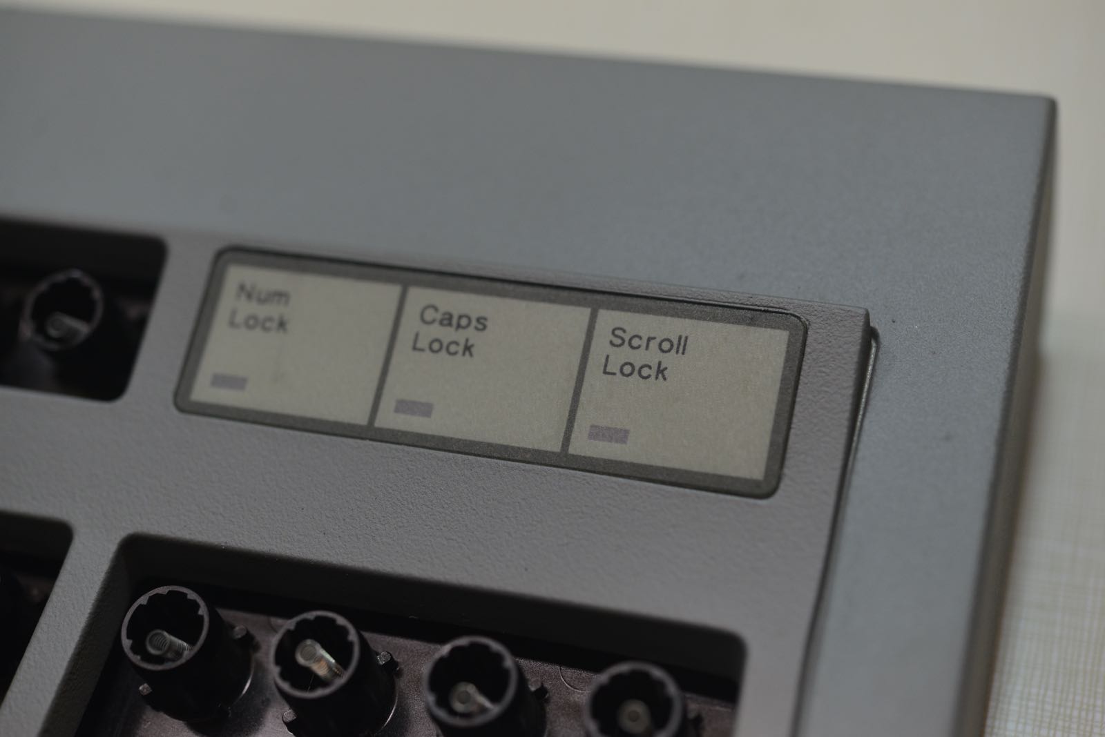

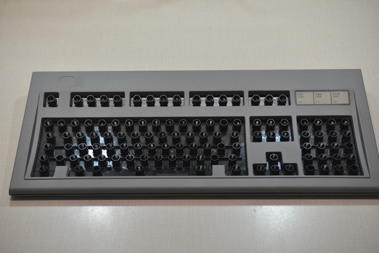

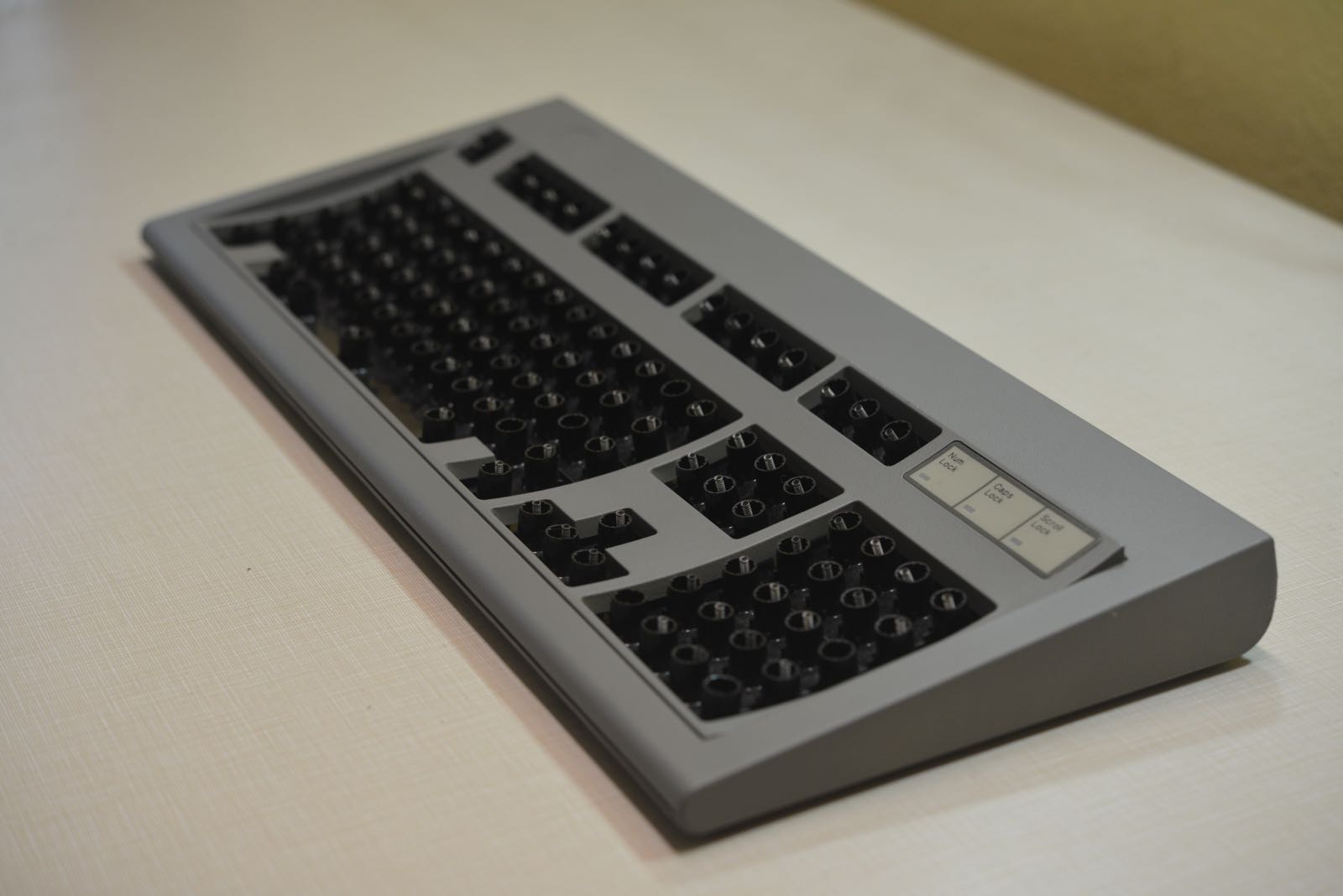

A neighbor of mine applies these coatings regularly. We chatted, I looked at the Web site, and I decided to give him a Model M keyboard as a sacrificial test. He applied the “H” product, in color code H-214Q, Smith’s Grey.
http://www.cerakoteguncoatings.com/fini ... iths-grey/

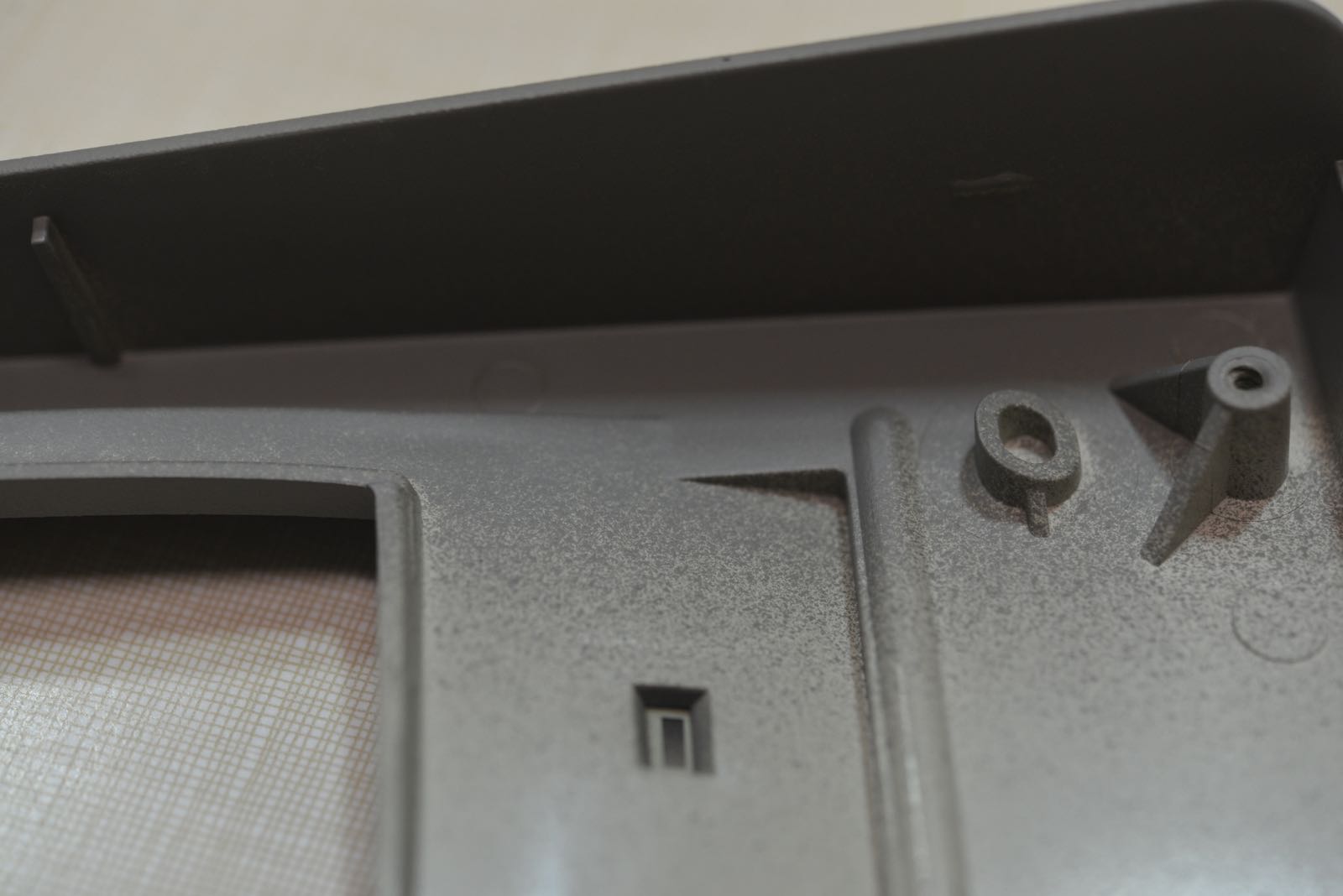

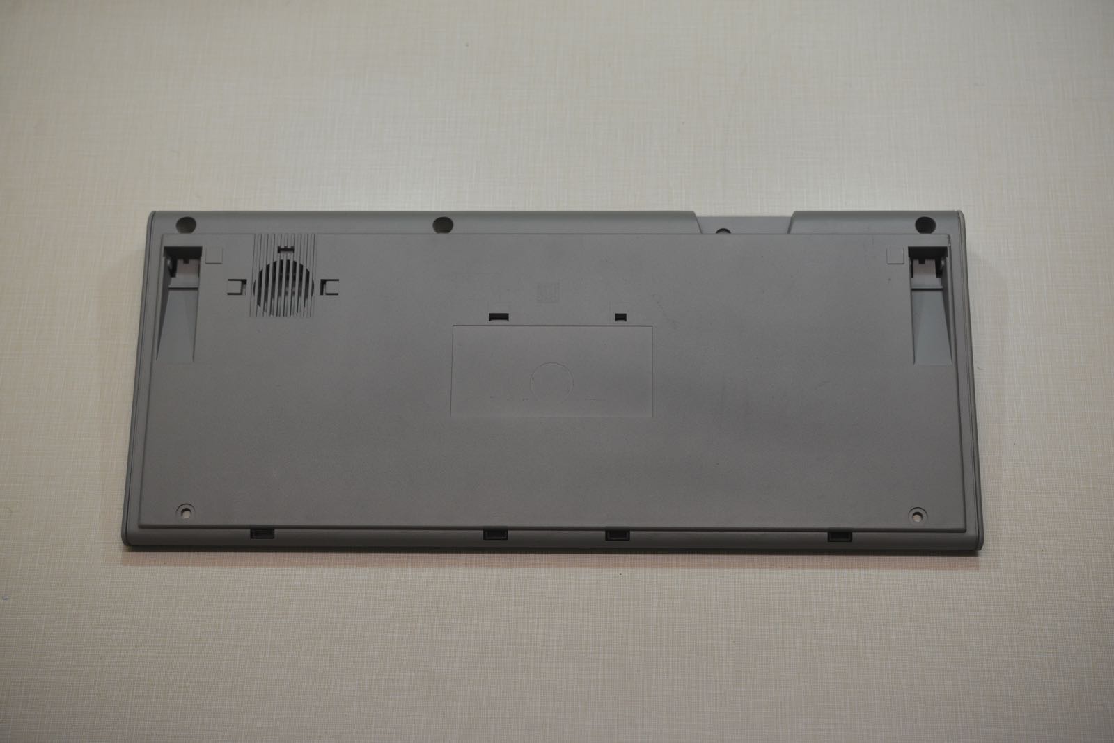

The neighbor had about 4oz of the product available. This was just enough to coat the outsides, but not the insides, of the keyboard shell. Next time we’ll pay more attention to cracks and gaps to do a slightly better job.

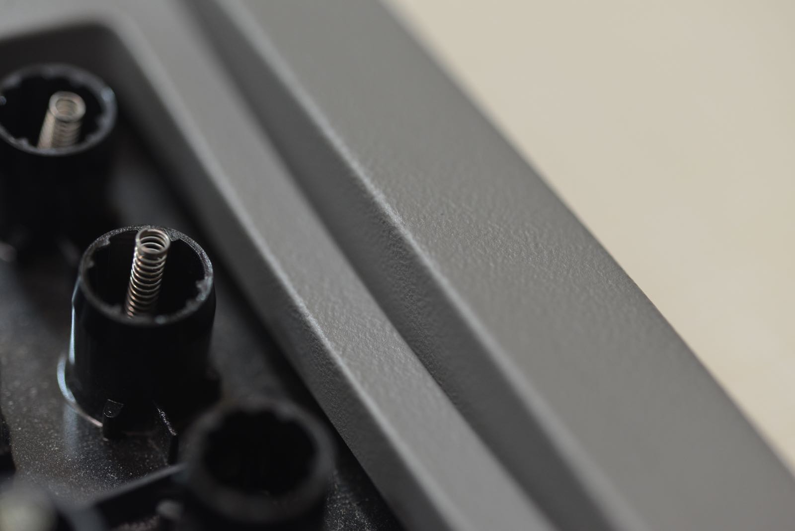

1. The coating is extremely thin, so, clearances are no problem. This is much thinner than powder coating.

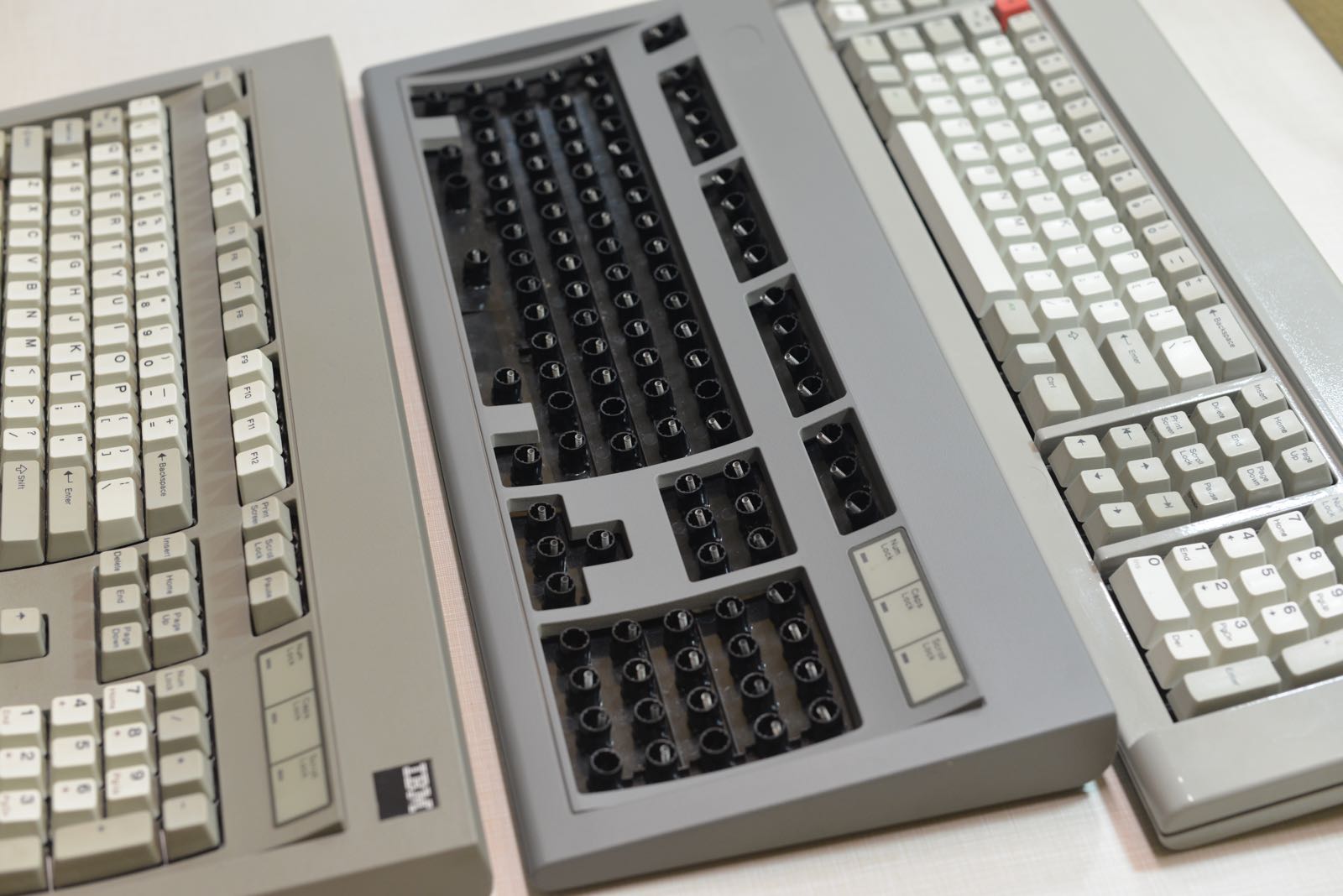

3. Smith’s Grey is a nice, dark gray, but is not even close to RAL 7030 powder coat or an authentic Industrial M. We are still working on color matching.

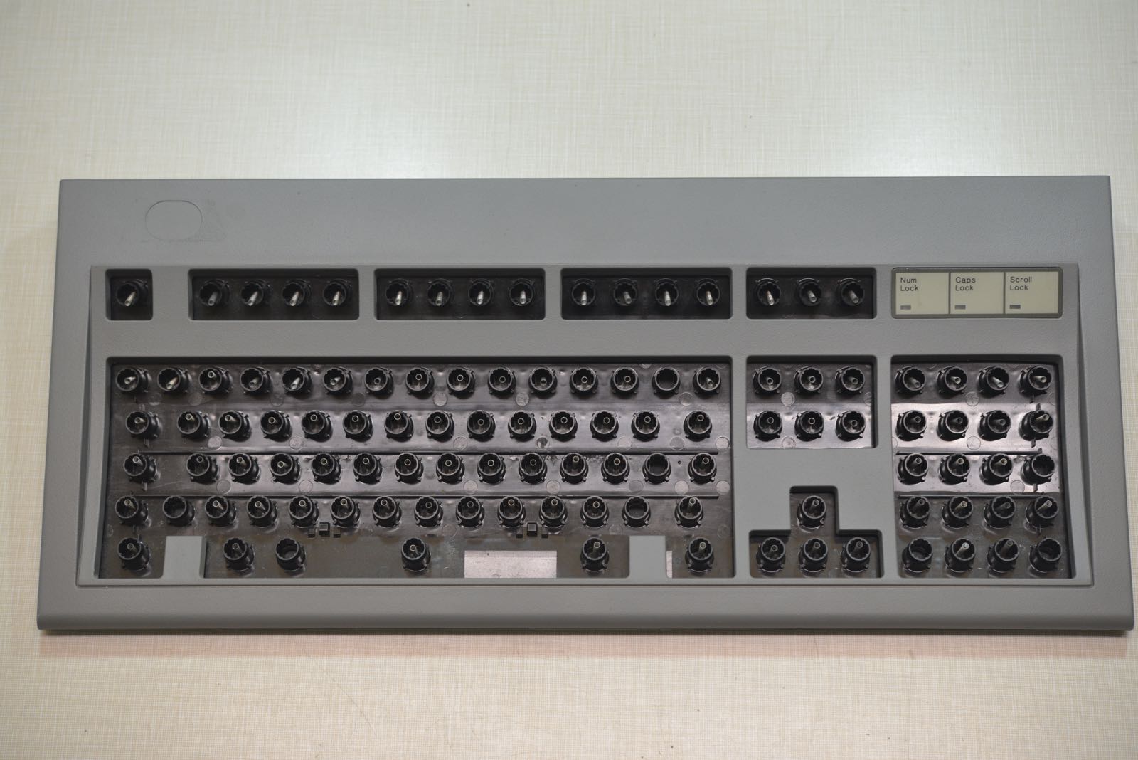

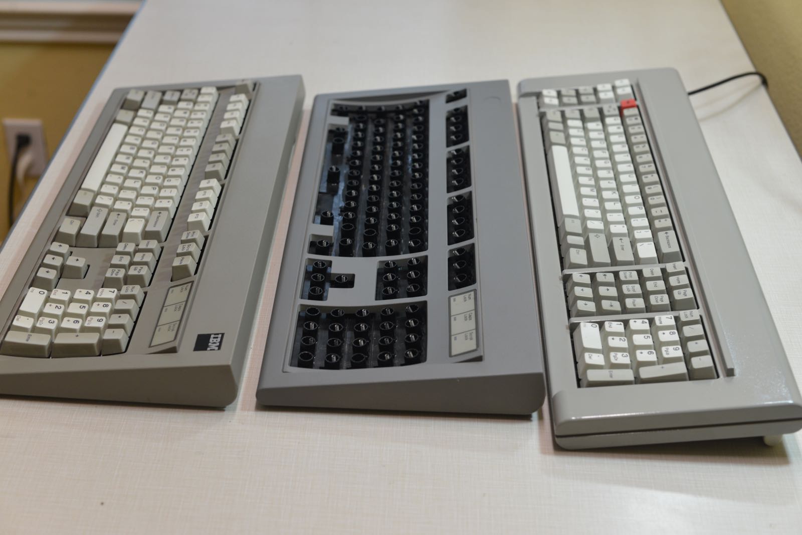

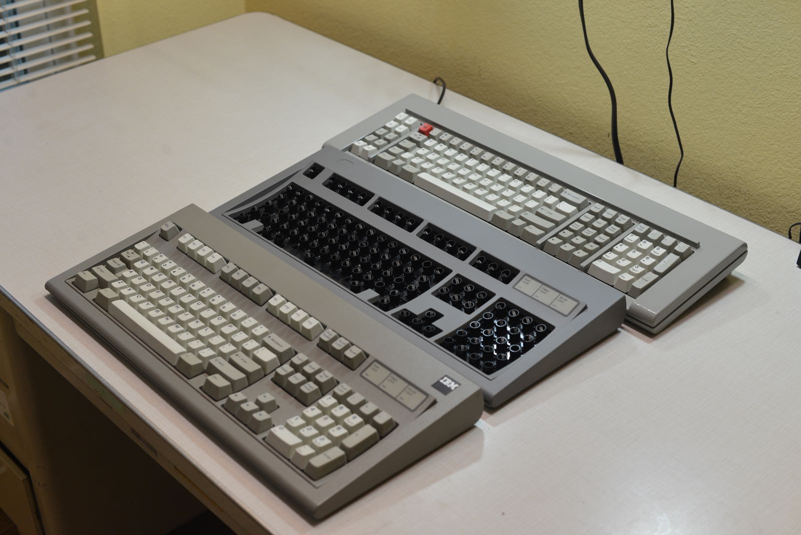

Now, for some photos. I compared the keyboard to both an authentic 1985 Industrial M, and to my 4704 terminal board powder coated in RAL 7030 gray.

I think that looks nice! I even like that darker grey color. That thing looks pretty mean.

Looks really nice! Does it retain surface texture and imperfections? How flexible is it? I guess it's not going to crack and flake...

chzel wrote: Looks really nice! Does it retain surface texture and imperfections? How flexible is it? I guess it's not going to crack and flake...
Hi chzel - yes, it does retain surface texture and imperfections as some of the macro shots show. The texture you see is the underlying texture of the molded keyboard casing. The Cerakote has a matte finish.
I have no idea how flexible it is. The product adheres quite well to the tight radius bends at the corners of the case.
Maybe if I get a chance I'll try scraping away an inside area with a knife to see how durable it is on this surface. This is designed to be a permanent coating.

Yeah, XMIT's grey looks more "industrial" than the IBM industrial to me. :)
16 Sep 2015, 01:37
IBM industrial gray has just that touch olive green in it which almost makes it look militaristic. Other grays just look... gray. Actually, this one looks blueish.
16 Sep 2015, 10:43
Any chance we can see it with caps on ?
I like all 3, i think the original IBM once matches the caps better but i prefer the Xmit Industrial M colour.

Pretty unfamiliar with this, but I assumed the coating, being touted as "matte," would give it a sandy feel. Looking at the pictures, that doesn't seem to be the case.
Does the keyboard case feel somewhat similar to how it was before?
[ XMIT ]
17 Sep 2015, 04:43
No, the feel is much dryer. Sandy and slick at the same time. Hard to describe.
