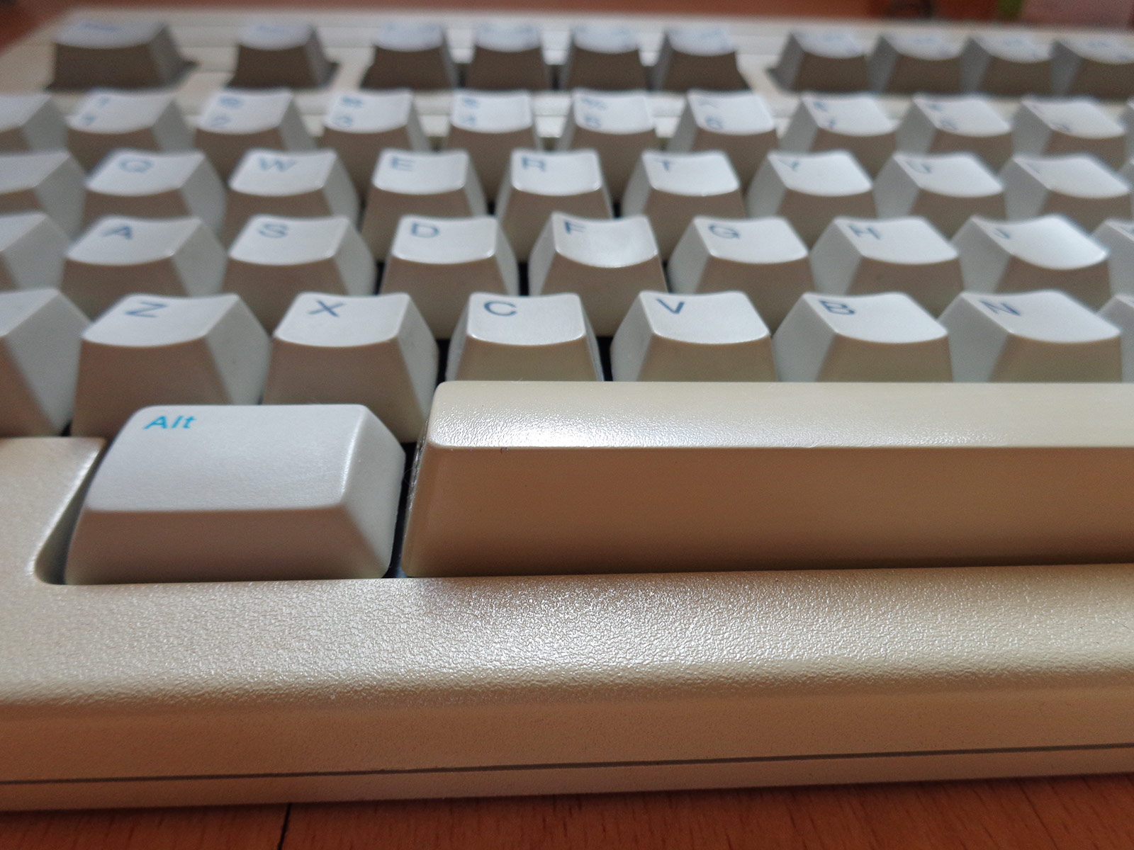

F&J deep dishing without bumps on this Wang 724 from 1989.

That Wang tickles my ####. What profile / row is that alt key ?

gogusrl wrote: That Wang tickles my ####. What profile / row is that alt key ?
Concave low-profile bottom modifiers. Cupped F and J keys. Yellowed space bar.

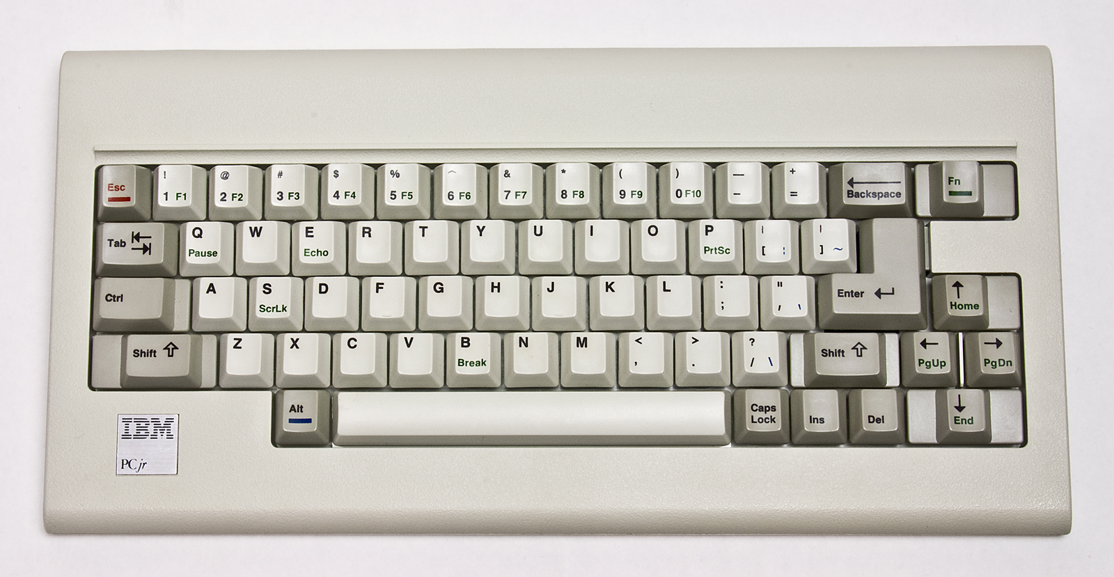

:o It seems like the second version of the IBM PCjr keyboard might have been the first IBM keyboard with bumps on the f and j keys. This announcement letter states that these keyboards were to start shipping by the end of November 1984 (pre Model M days). The PCjr was competing with the Apple IIc at the time.
