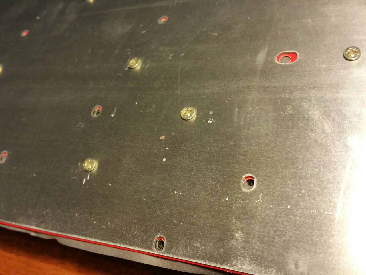

Thanks shreebles. Good to know. I took some time to sand the backplate this weekend, and polish the barrel frame cut, but nothing else. If I catch time, I'll check the fit today.
What did you use to drill that second hole?

alh84001 wrote: Thanks shreebles. Good to know. I took some time to sand the backplate this weekend, and polish the barrel frame cut, but nothing else. If I catch time, I'll check the fit today.
I used this
And two metal drill bits, and it was probably the easiest part of the whole mod.
I used a size 5 for the small hole on the right, but had to make the hole bigger afterwards with a metal file.
For the rectangular cutouts, I made two small holes next to each other with the size 5. Then I took a size 8 drill bit to make both holes big enough to match the size I needed. Then I sawed off the gap between them and took a file to make the cutout rectangular instead of round.

Thanks! I definitely need some new drill bits. I plan on using a dremel, then files for the cutouts.

alh84001 wrote: Thanks! I definitely need some new drill bits. I plan on using a dremel, then files for the cutouts.
Btw I used this to make the holes:
but I made the most with the file, including the cutouts, first I used a metal cutting shear and then the file.

Here are a couple of my pics from yesterday.
Test fitting the plate to the case. I widened the left hole to the right a bit.
Testing some keys.
Keys on the right seem to fit better than keys on the left. A bit confusing, but I guess a bit of a movement to the left is still needed. Also, the barrel frame obstructs the top case on the right a bit. Nothing major, I just need to press the case with hand for the last milimeter. I think that after screwmodding, that will not be an issue.

I have checked again your pictures and realised that you have painted the back plate. Are you sure that the metal is grounded ? You may need to scratch the paint to ensure that there is good contact.
If this is the problem, my recommendation is to test it. To do it, I would scratch the paint in a different place and check for continuity.

I scratched the plate at the point for the grounding screw, I will test what I can do if I have more time, maybe a bad flipper cause the problem.
