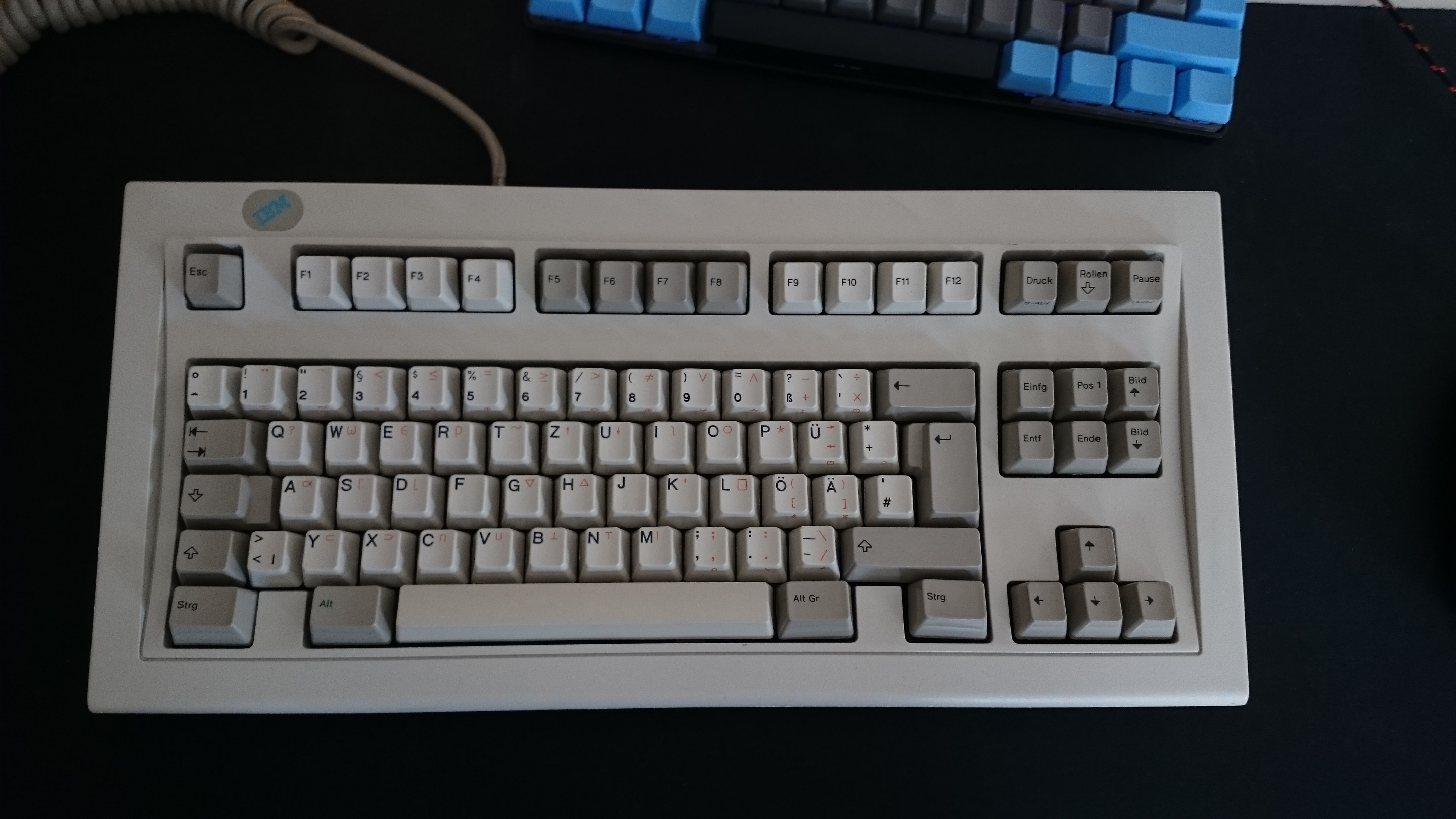

Here is a small guide for chopping a fullsize model m barrelframe and steel plate so that it will be fit in SSK case. This is part 1. Part 2 will be posted tomorrow and part 3 when I have received the FSSK pcb.
Things that you need:
A model m SSK and a model m barrelframe and steel plate.
Image Image
To do this mod, to do a screw-mod is necessary
My model m barrelframe has allready holes for screws in it:
Barrelframe and steel plate.
Inner assembly from my SSK.
The two steel plates have exact same height.
The model m plate need to be chopped in lenght.
Just hold the model m plate on the SSK plate and you see who much must be cutted away.
After bench saw.
Now its time to cut the barrelframe, just put it on plate and you will see how much you must cut away.
Some sanding.
There are some recesses and a missing hole on the right side that you have to add.
Some sanding is needed, but now it fits in the SSK case.
The next part will follow tomorrow, but the plate and barrelframe fit allready in the SSK case.
