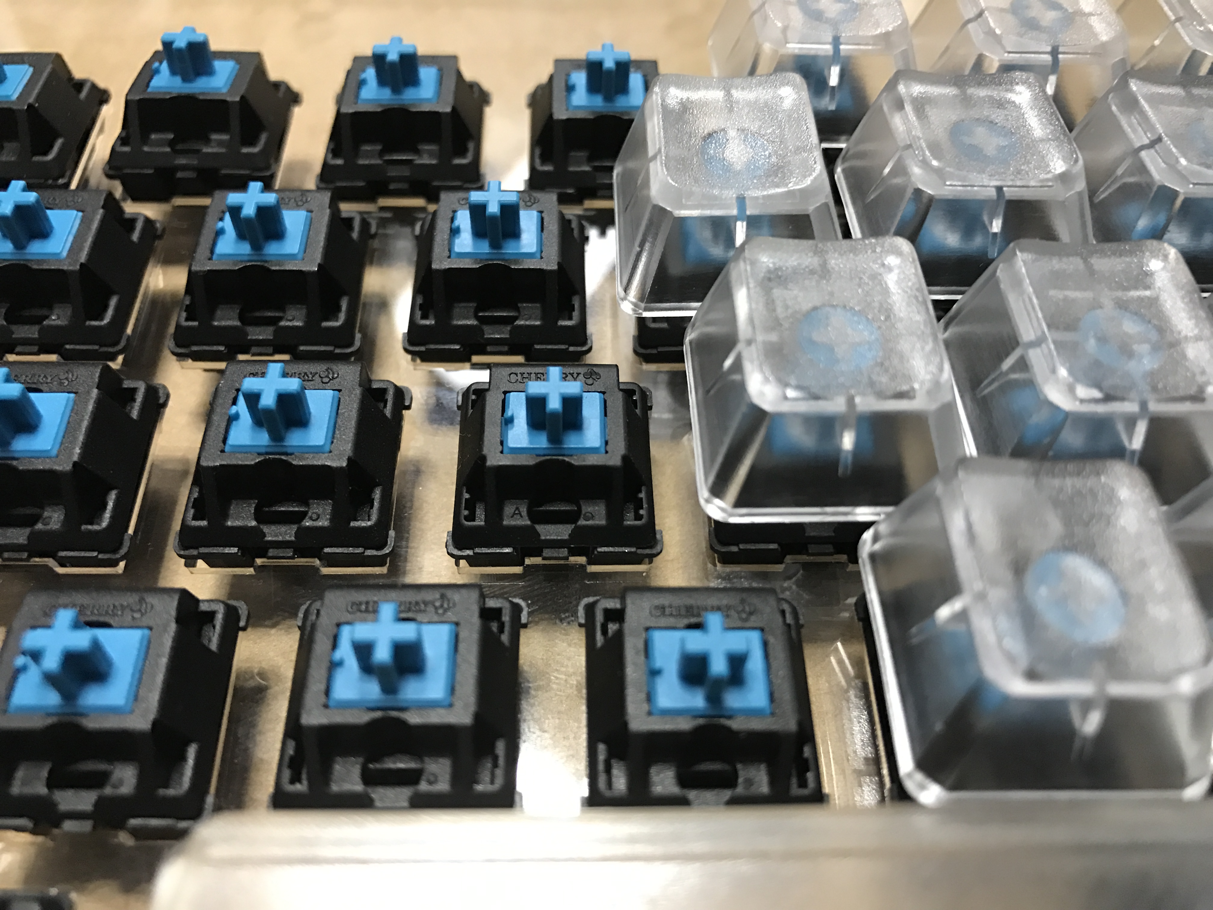

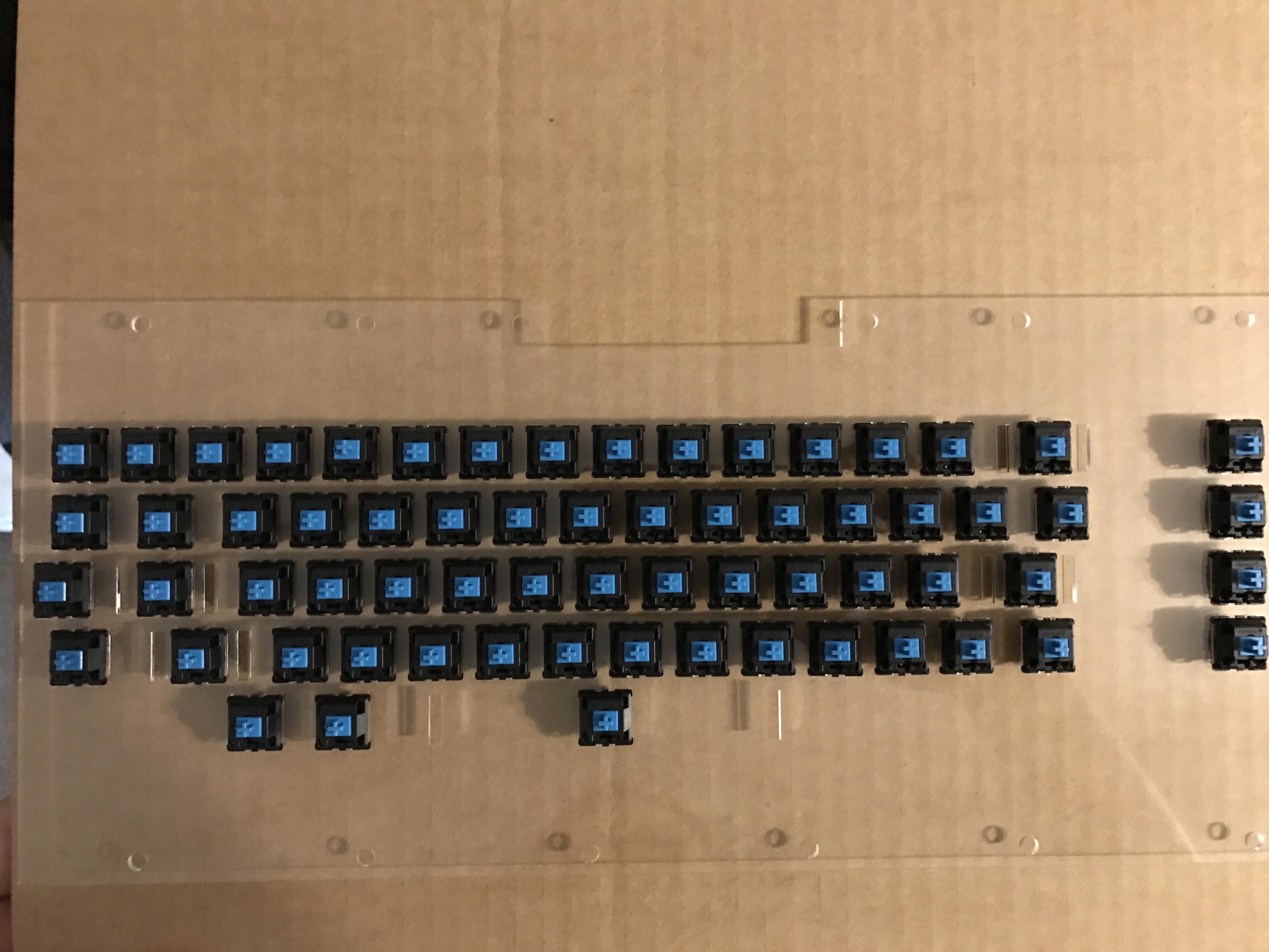

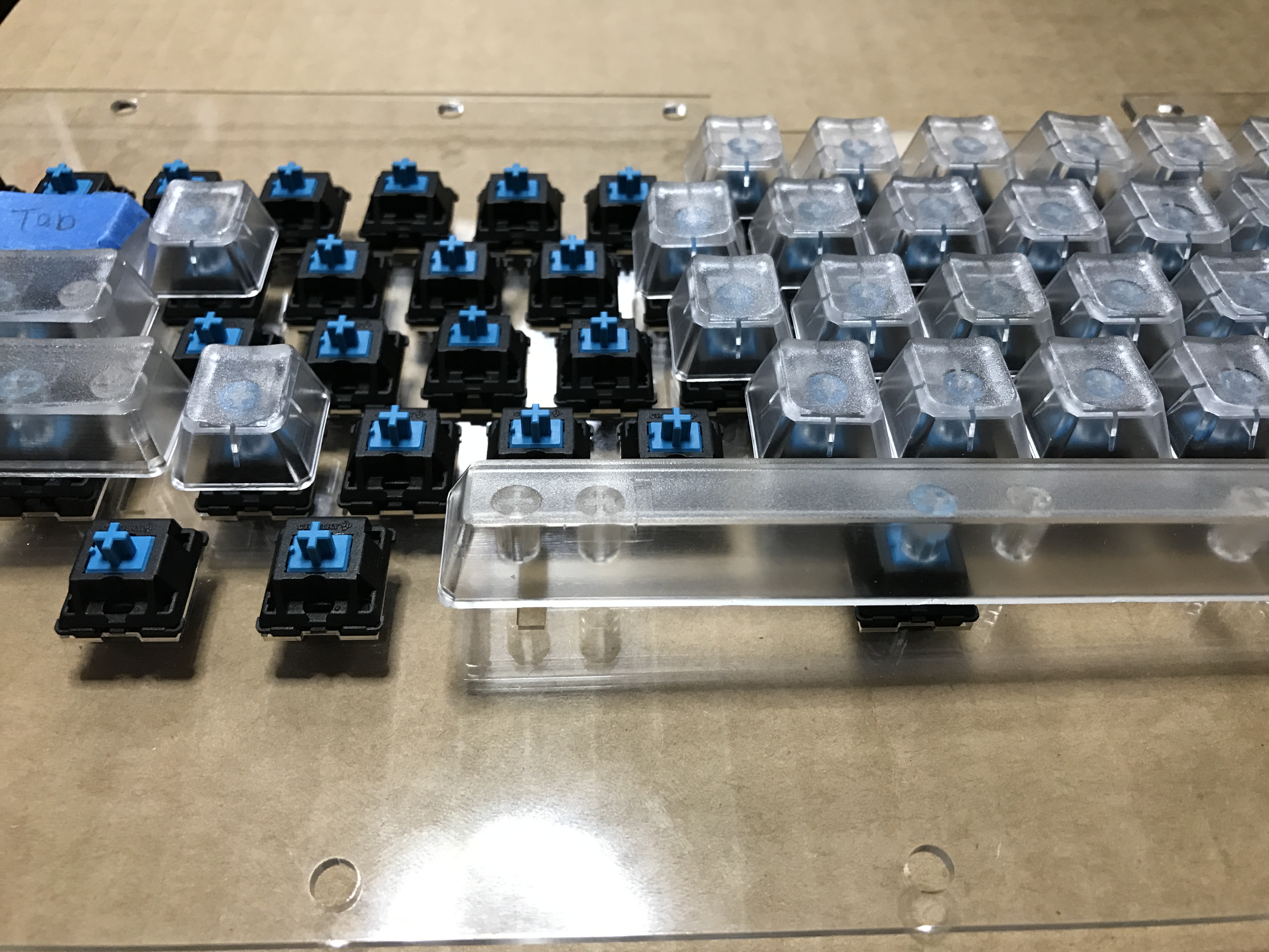

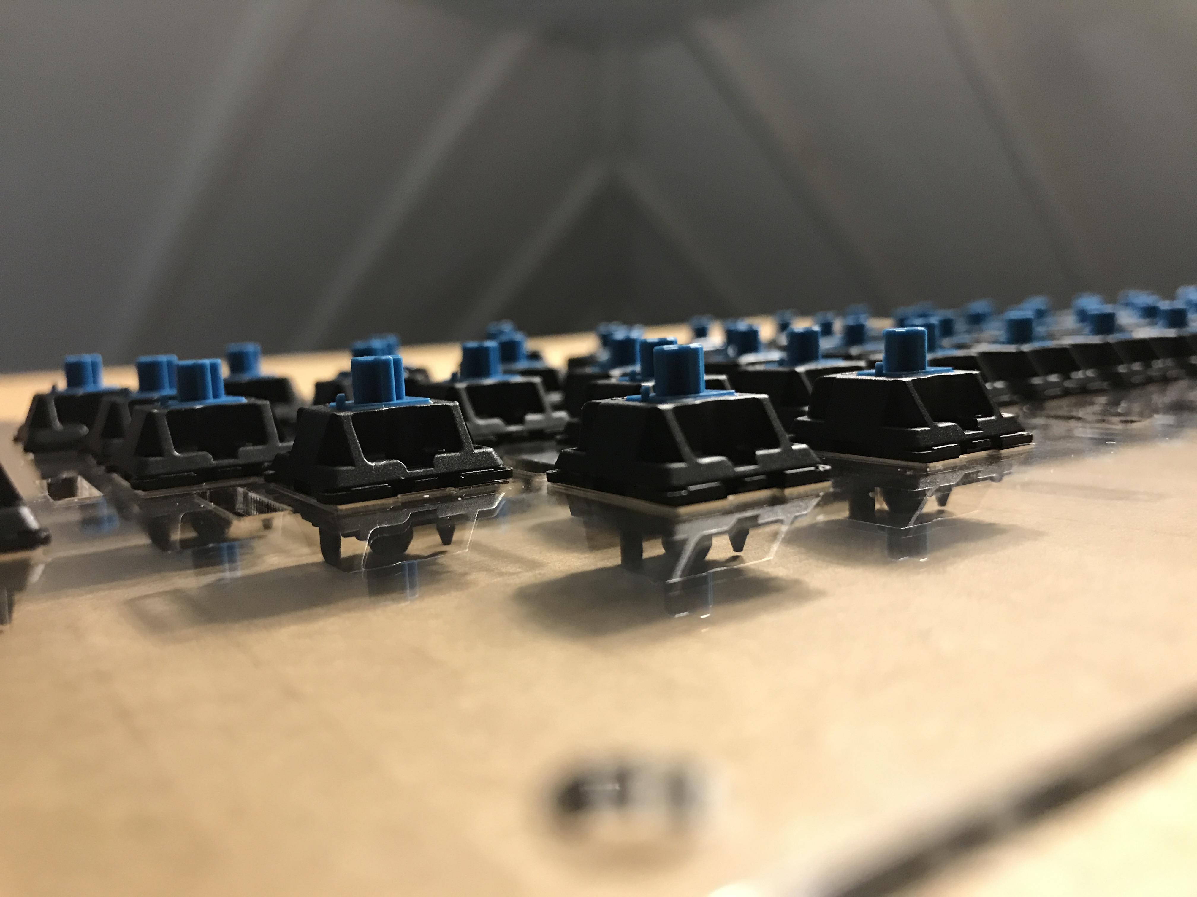

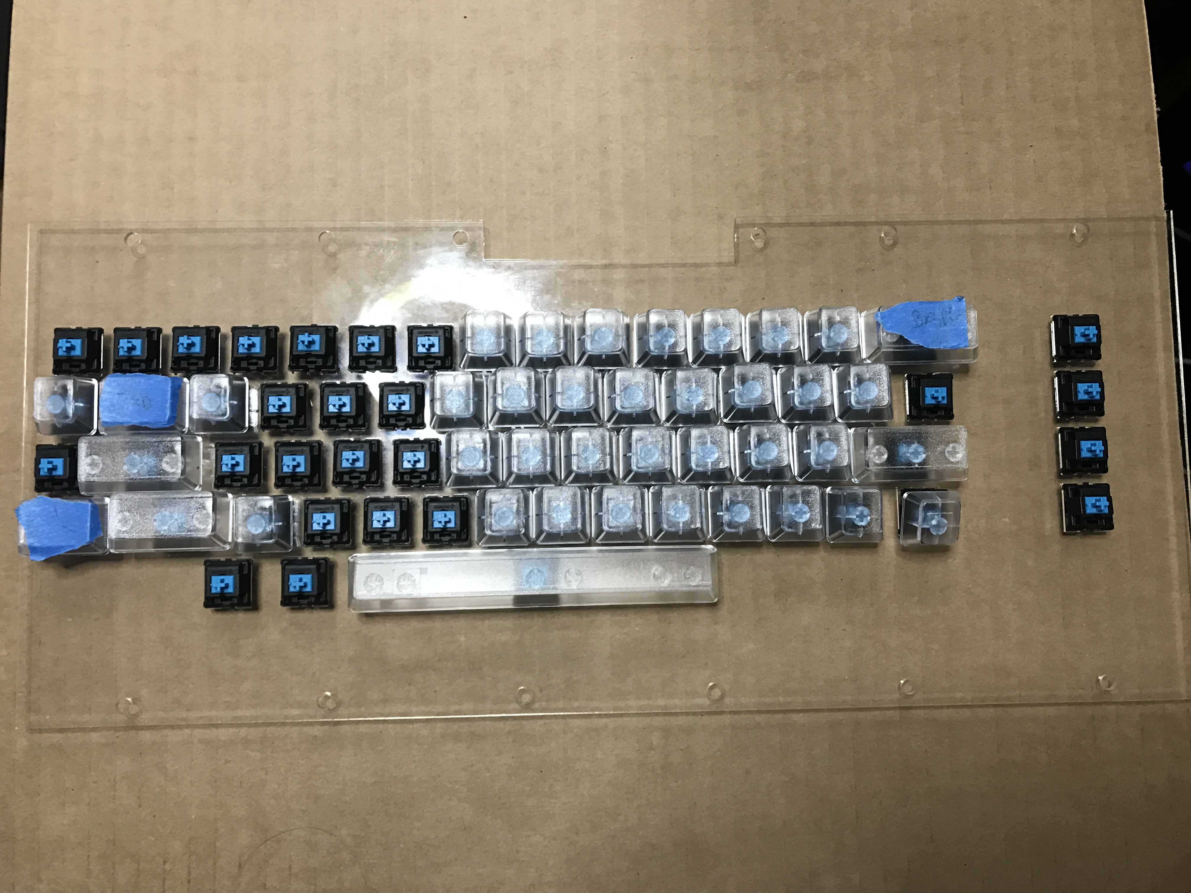

I received the acrylic prototype and I'm happy to say that all of the adjustments look and feel great. I've attached a few pictures of the plate with switches and switches+caps.
@iceberg, I'm def going to be choosing aluminum for my build. I'm waiting for my friend to get back from vacation so I can ask him to make me a few more. In the meantime, I'll search the net for a company like ponoko that can work with AL and possibly bend it for me as well.
Here are some pictures of the acrylic prototype with switches/key caps etc...

Yea, Acrylic isn't ideal because it doesn't bend well, and it flexes too much for typing.
