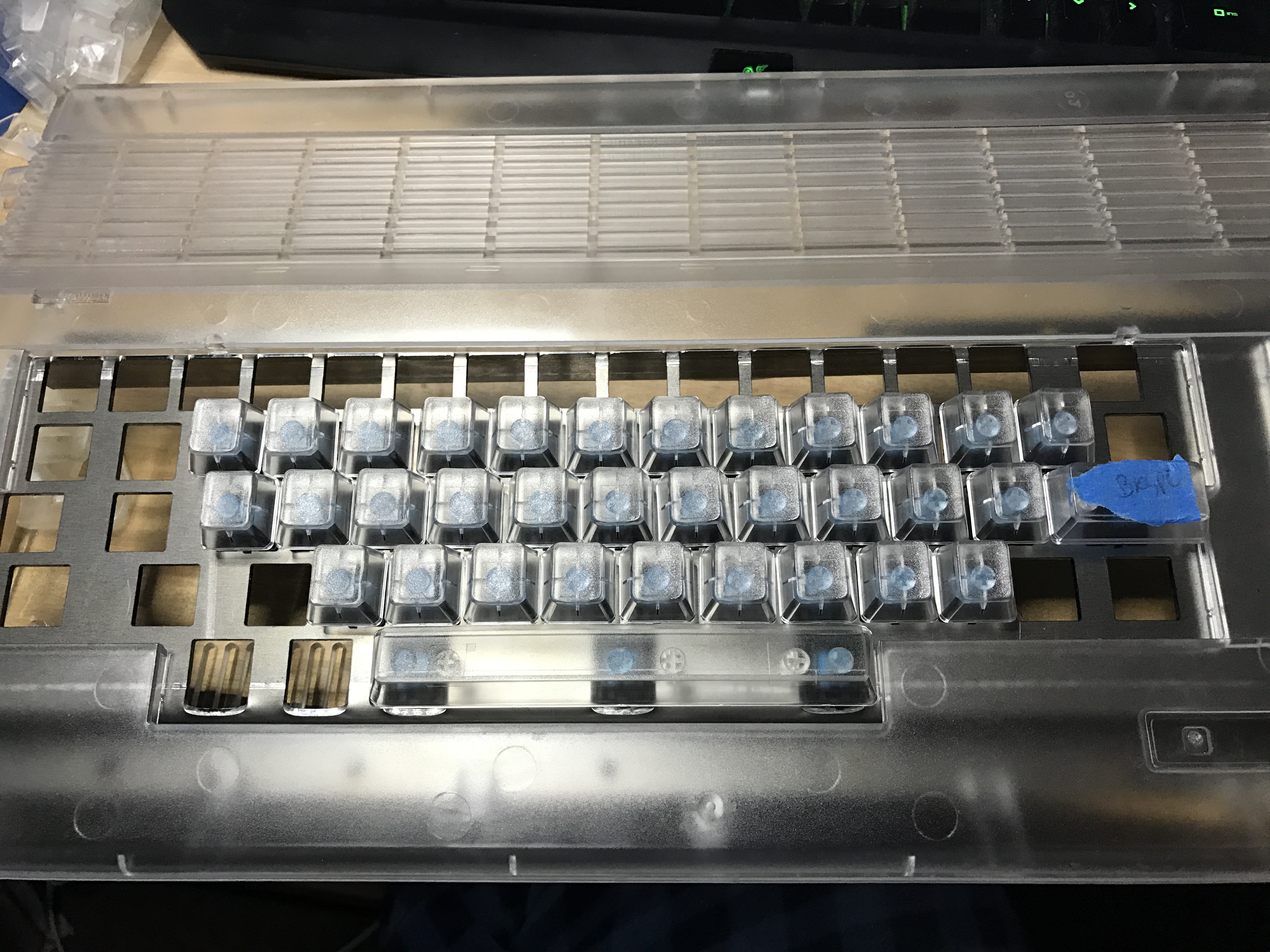

Thank you. Thinking about using that same set of translucent DCS key caps. Perhaps i'll switch them out for something else, but for the time being they go nicely with my clear case so I'll probably just stick to them.
I'm just about done revising my 2d drawing to compensate for the spacing issues and I've finished adding the keyhole notches I described.
In talks with my friend about the technical details behind bending aluminum. Should have another mount ready in a couple weeks.
I'll keep you all updated.
Here's a picture of the mount with more keys and case.
- image.jpg (2.51 MiB) Viewed 10829 times

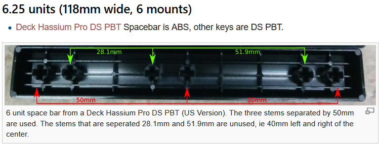

Why are you not using Cherry (or Costar) stabilisers for the space bar? Are those holes dimensioned for the original stabilisers in the C64?
riddleywalker
- Location: Nowhere
Great question Findecanor. Two reasons: I like the resistance that the key switches provide in that configuration. I also may shorten the width of the space bar and use the space on either side for two additional keys
The key holes are not laid out for the original C64 space bar. The space bar I use is about 1 inch (25.4mm) shorter.
The space bar I measured for is here:
- DeckHassiumPro_US_Spacebar_Info.png (233.05 KiB) Viewed 10806 times

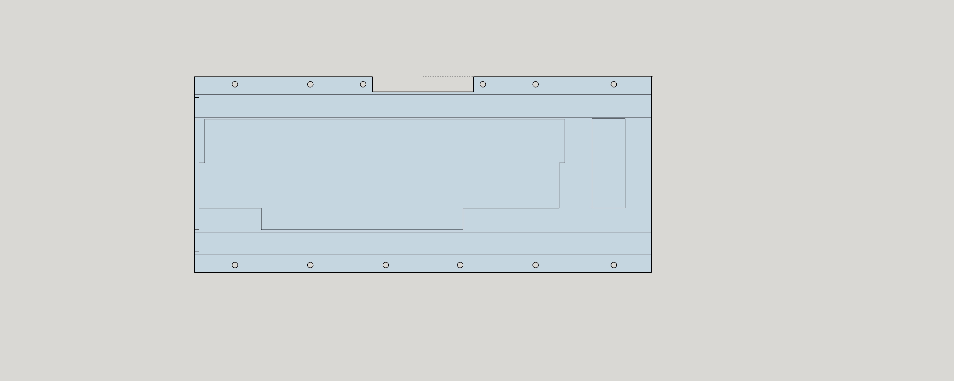

Hi iceberg,
Oh it absolutely is possible. As a matter of fact, the original key layout is what I used as a reference for how much space I would have to lay out the new keys. It all came down to everything fitting properly inside of the case cut outs if that makes sense. In other words, if you take the dimensions of the original C64 keyboard key layout, my keys fit the same area
The attached image shows the workable area that one has to layout whatever key hole configurations you want. This is accurate to about 100th of a millimeter.
- c64_keyboard_2d_custom_keyholes_final_AREA_ONLY.jpg (127.15 KiB) Viewed 10789 times
