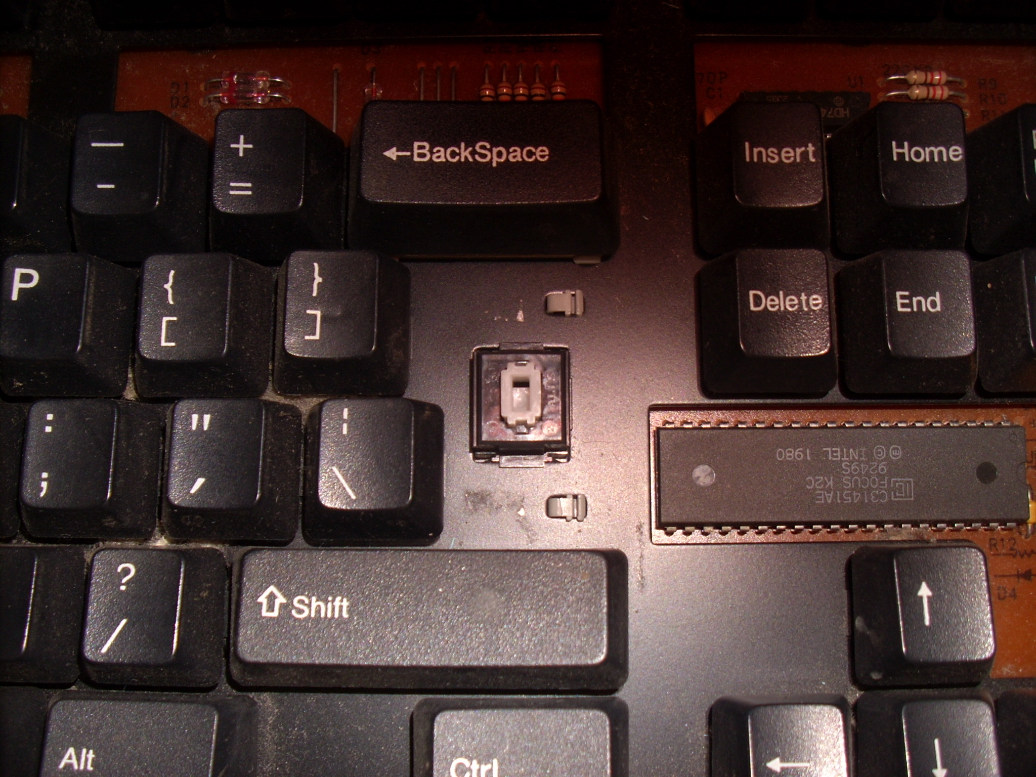

Looking good so far! You might want to check the spacing on the insert and delete for the Plus versions. Those two have the stems centered on the caps, so those switches should be centered at 3/4U and 2-1/4U, not 1U and 2U.

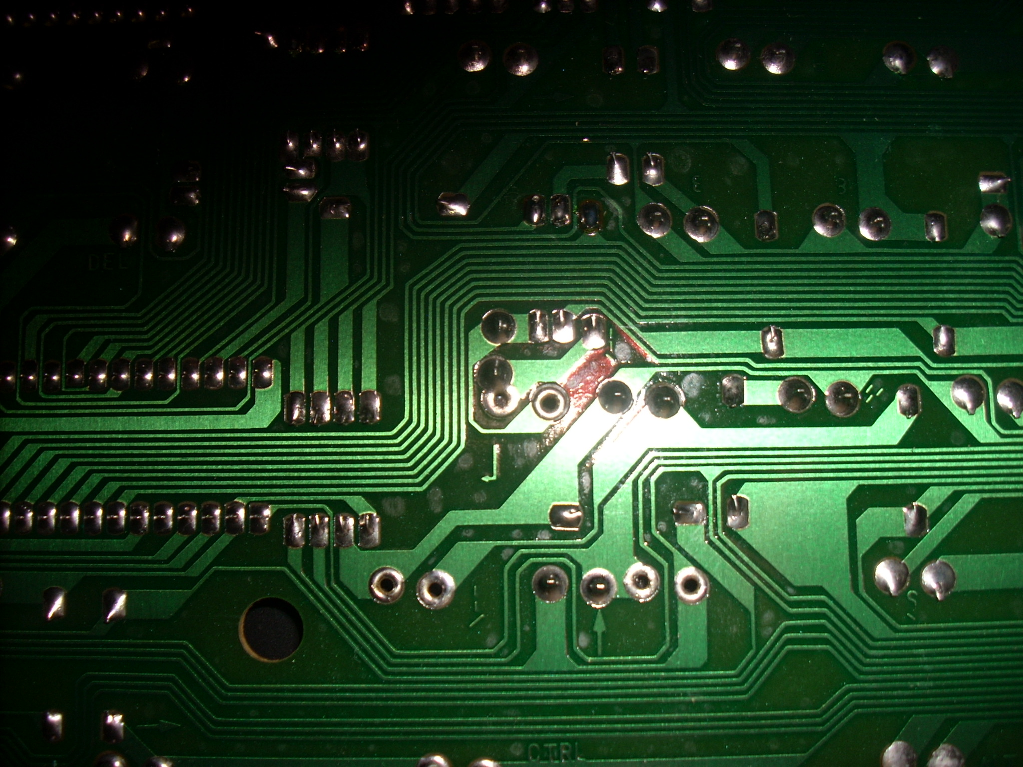

Here's a couple old photos of a bare Gen3 PC board that might be helpful:
keyboards-f2/just-picked-up-an-omnikey- ... ey#p342941
It's interesting to see the alternate switch locations marked "Europe". I've never seen a Northgate with a "European" layout, but it's possible that some were produced.

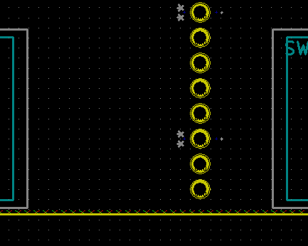

Polecat, quick question. How would you recommend doing the break-away section? Currently I just have 0.039 in holes spaced .078 in center to center along the entire height of the PCB. I have never done a break-away section before, and especially not one that needs to be somewhat strong on the break-away.
EDIT: Can you also measure the spacing between the numpad and nav cluster for the Gen1? I measured it on the gen3 and it is an odd 1.09375 inch spacing and wanted to see if by chance it is different on the older ones.
I at one point had long slots and the same holes separating the slots, but went to all holes to add more material between the PCB halves. Do you think this would be fine, too strong, or too weak? I found an article about sizing for break-away tabs, and the hole sizing is almost the same, just tighter spacing.
Finished routing everything and even found an error on the gen3 PCB where the LEDs are spaced incorrectly. The spacing on the opening on the top cover are equal but on the PCB they weren't and one of the LEDs is bent a tad to fit in the cutout. Kinda funny actually.
Also I was throwing the idea around of making a small break-away section above the left side function keys, and under the badge door for the boards that have it) to put the reset switch to program the teensy. Sound like a good idea or skip it?

You might look at how the GH-122 did it-- it was designed with breakaway parts.
https://geekhack.org/index.php?topic=80 ... msg2309842
BlindAssassin111
02 Mar 2018, 05:51
Hak Foo wrote: You might look at how the GH-122 did it-- it was designed with breakaway parts.
Hmm, so they only did holes at the at the ends of the cut...So I assume you would need to score the pcb and then snap it. I could do something similar.

BlindAssassin111 wrote: Polecat, quick question. How would you recommend doing the break-away section? Currently I just have 0.039 in holes spaced .078 in center to center along the entire height of the PCB. I have never done a break-away section before, and especially not one that needs to be somewhat strong on the break-away.
I measure 1-1/8 inch center to center between the right nav column and the left numpad column on Gen1, 2, and 3. All the same in any case.
My opinion is that the "breakaway" section should be cut with a fine toothed saw or shear. The original PC board material from the '80s was a phenolic material, but most modern PC boards are made from fiberglass and resin, which is much stronger and would probably not break cleanly, even with a row of holes or slots. Even after scoring the fiberglass material might not break where it's supposed to, and I would hate to see someone ruin a brand new board trying. I would suggest a printed line with no traces too close, and let folks cut the board if used for a 101 version. That would also make it stronger on non-101 models.

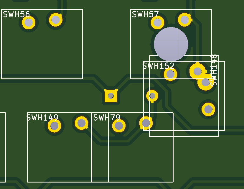

BlindAssassin111 wrote: I was never planning on doing ISO, as I have never seen an ISO omnikey. For ISO I would need two switches on backspace and the weird enter correct? I will give it a thought but idk...
Typically ISO has an extra 1U key next to the Enter, and a shorter left shift with an extra 1U key to the right of it. Sometimes called a "102" layout. Exact key designations depend on the country and specific layout. The plate would need to match, of course. I have an ISO Focus board I can check to see if the switch for the Enter would need to be relocated to use a Focus key cap for the Enter. It may vary depending on the Enter keycap being used. For the PC board the (smaller) left shift would need to move to the left and the two 1U switches added. Backspace is usually unchanged at 2U, but there may be exceptions. In summary, the PC board, plate, and keycaps would all need to match to make this work.
BlindAssassin111
04 Mar 2018, 02:31
Polecat wrote: Typically ISO has an extra 1U key next to the Enter, and a shorter left shift with an extra 1U key to the right of it. Sometimes called a "102" layout. Exact key designations depend on the country and specific layout. The plate would need to match, of course. I have an ISO Focus board I can check to see if the switch for the Enter would need to be relocated to use a Focus key cap for the Enter. It may vary depending on the Enter keycap being used. For the PC board the (smaller) left shift would need to move to the left and the two 1U switches added. Backspace is usually unchanged at 2U, but there may be exceptions. In summary, the PC board, plate, and keycaps would all need to match to make this work.
Yeah, the first thing that came to mind when I read ISO was the weird boards with the split backspace. I thought that was the standard, but apparently not.
Now something I need to figure out is what orientation for the ISO enter? rotated or non-rotated or both? Hard to know as SP alps caps are non-rotated, where as older sets generally are rotated, and supporting both would be hard for trace layout reasons.
EDIT: Managed to get both rotated and non-rotated ISO enter on the board, traces look kinda funky, but was much easier than I expected actually.
Updated the ISO enter again, was off a tad on placement, treated it as 1U instead of 1.25U like I should have.
Quick peek shows my Focus FK-2002 has the rotated switch. That's a likely key cap donor since (we think) Focus and Northgate were made by the same manufacturer. The PC board has pads for rotated and non-rotated, presumably for the BAE on the FK-2001 version. Note the extra pads for the small right shift key with the 1U switch next to it. The left shift is done the same way.
Edit - just saw your reply with the ISO Enter added, you managed that more quickly than I could take two photos. Must be getting old.
BlindAssassin111
04 Mar 2018, 06:01
Just want to throw this out there...The number of combinations for the setup of this board is ridiculous.
There are:
  • - With/Without Left function keys
    - BAE,ANSI, and ISO enters
    - 3 Different right side bottom rows (4 x 1U, 2 x 1.5U with 1U, and 2 x 1.5U with a gap)
    - Split and long right shift
    - Split numpad plus
    - T-nav, Ultra nav with bottom 2 x 1.5U, Ultra nav with bottom 3 x 1U
Totaling: 216 different layout combinations (288 if you replace the left, right and down arrow with 2 x 1.5U keys, if you really wanted to)
And because alps don't support multi-layout plates as nicely as cherry switches, there are a boat load of plate layouts...144 to be exact. So I am not sure what to do about designing the plates as there is no logical way to do this, and swillkb can't build to the weird cluster spacing these keyboards have.
EDIT: I even started to use keyboard-layout-editor to get the layouts started, then realized there are more than I originally thought, only managed to do 12 layouts before doing the above math, needless to say I gave up.
