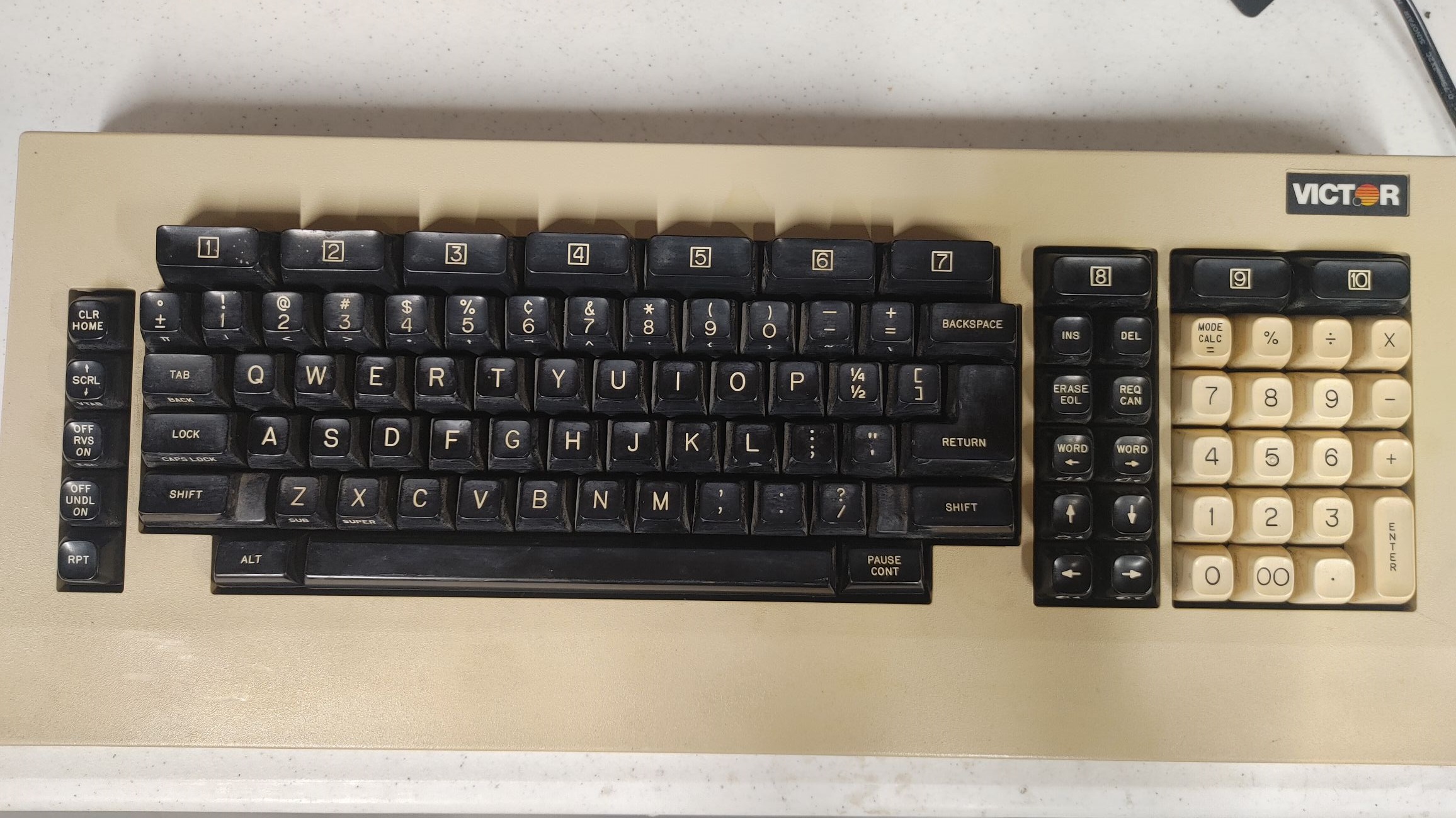

You used to be able to get these keyboards pretty cheap - without bidding wars because most people here hated foam & foil. I saw one for $20 once, buy it now (and I didn't get it because I already had 2). They're definitely more rare now.
I'm using a Victor 9000 keyboard to type this, with snacksthecat's converter (pictured above) and Texelec replacement pads.
Of the two Victor 9000 keyboards I have, one is an early 1982 version with white background "Victor" and no sun logo, made in Chicago. The other is from 1983, with white background "Victor" with sun, made in California. Both are the squared version with no wrist rest.
Beauty shot:
