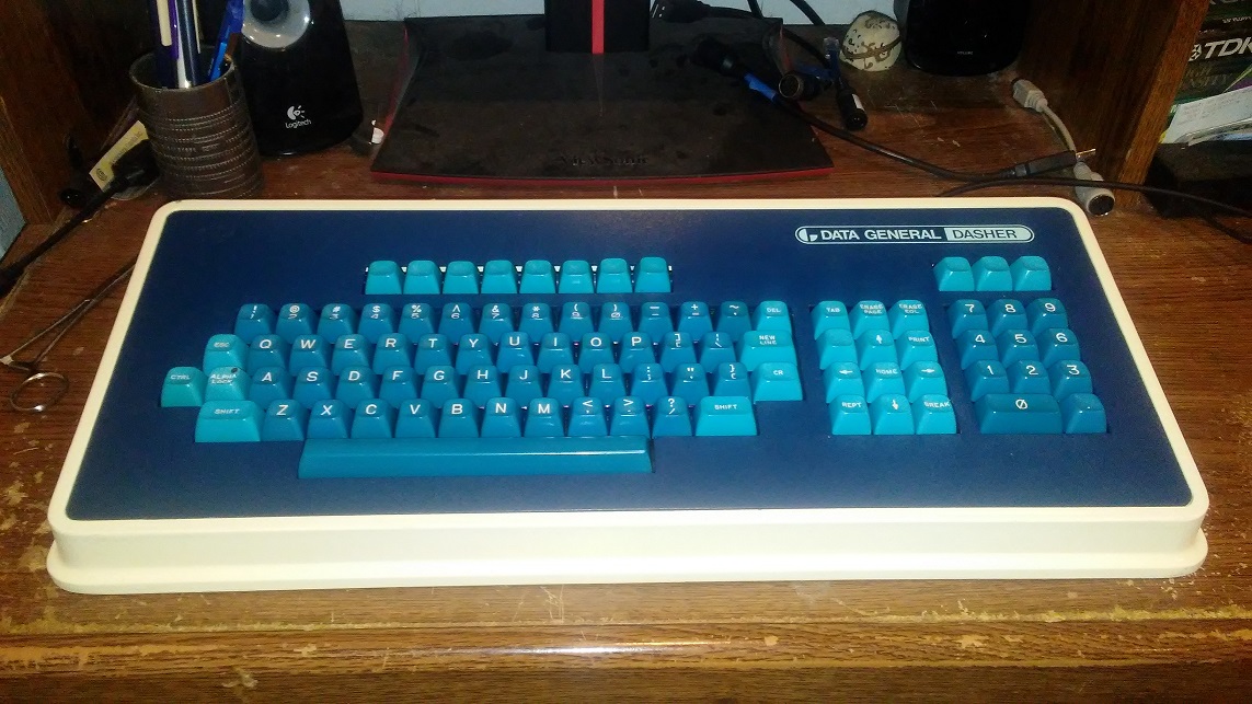

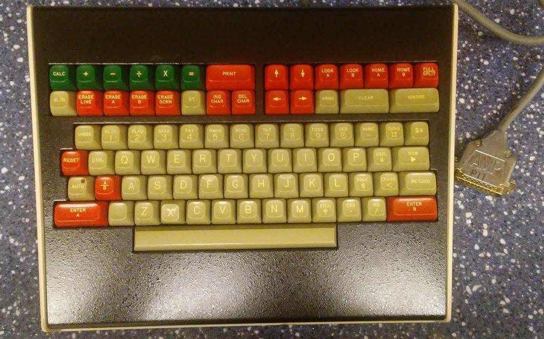

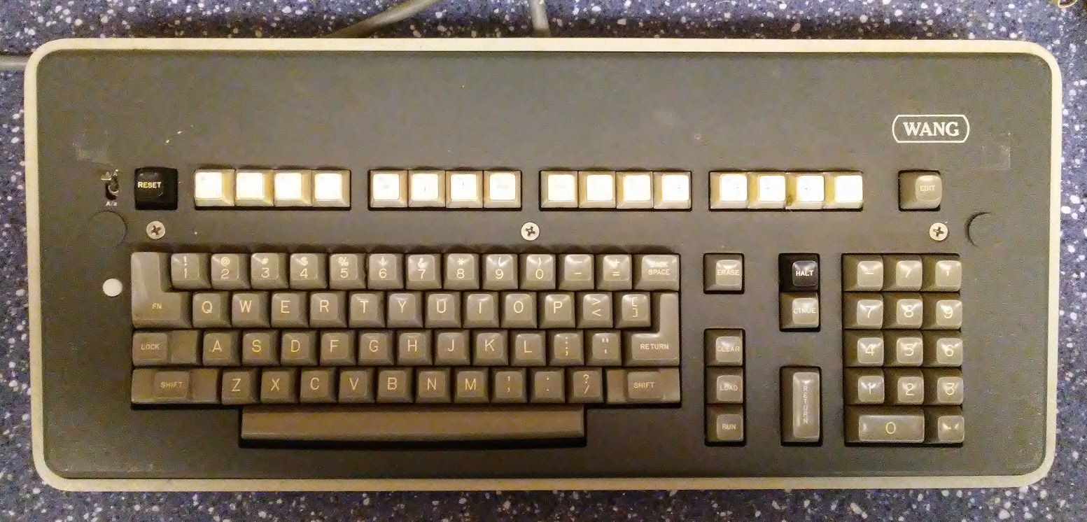

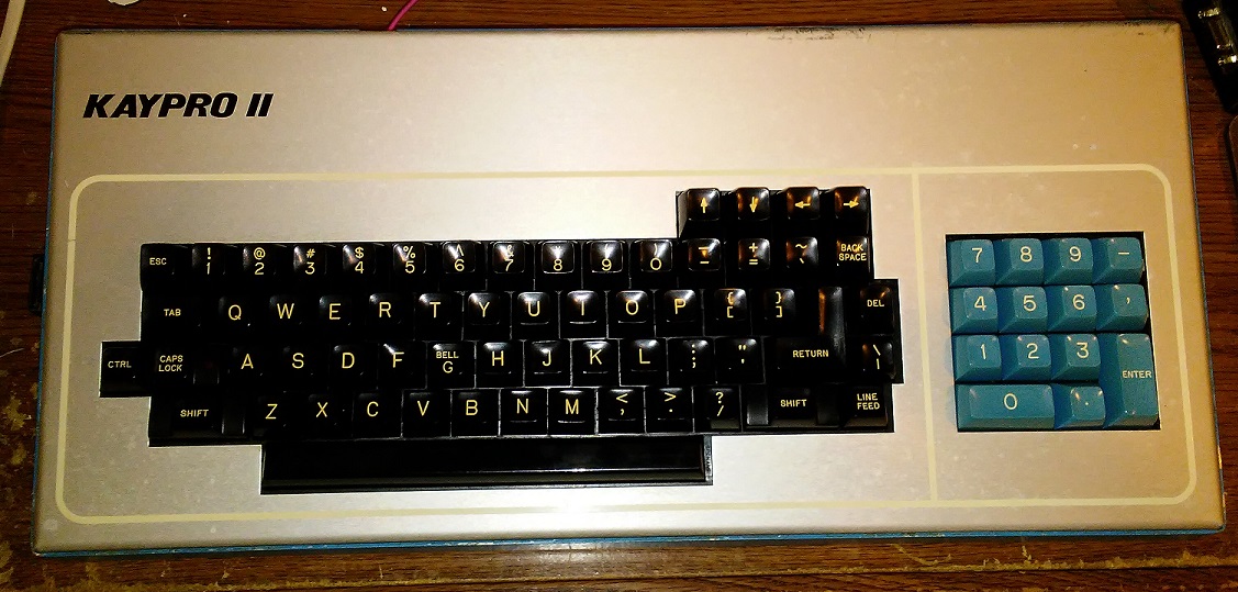

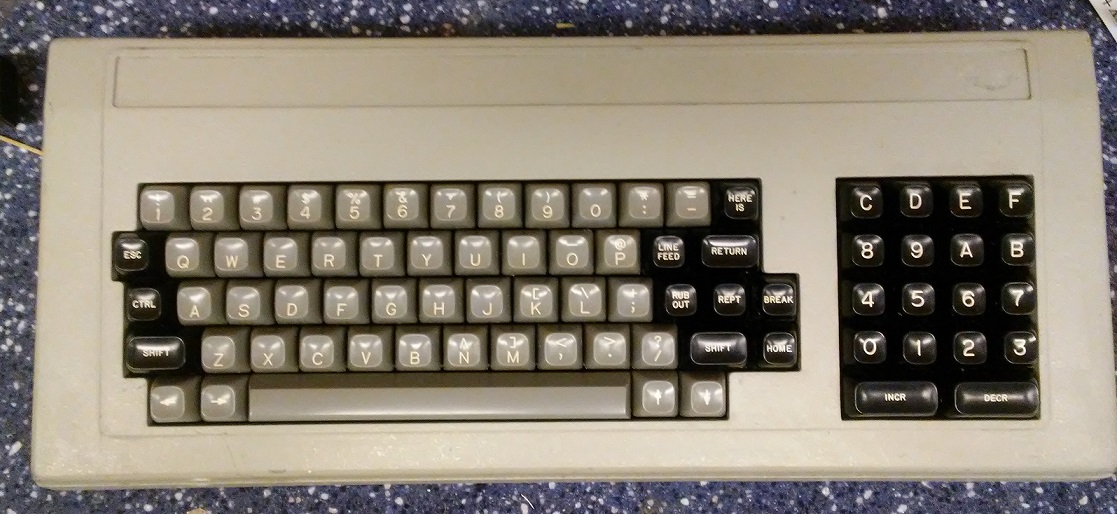

OldIsNew
18 Nov 2018, 03:35
I really like these switches actually. They almost always need replacement F&F but once done I think they're great boards, here are some I've done - and I like them all - worth the effort I think!
workshop-f7/westinghouse-w1642-keytroni ... ic#p384536
keyboards-f2/l3-communications-keyboard ... ic#p390190
keyboards-f2/wang-workstation-keyboard- ... ic#p396862
https://geekhack.org/index.php?topic=92 ... msg2505876
workshop-f7/data-general-dasher-and-xwh ... ic#p425864
I like your video of the remains of the F&F! The foam does seem to be practically dust most of the time, but once fixed I think they are really nice switches - it's the truly horrible short stem Key Tronic F&F switches that I think have ruined the reputation of F&F.
