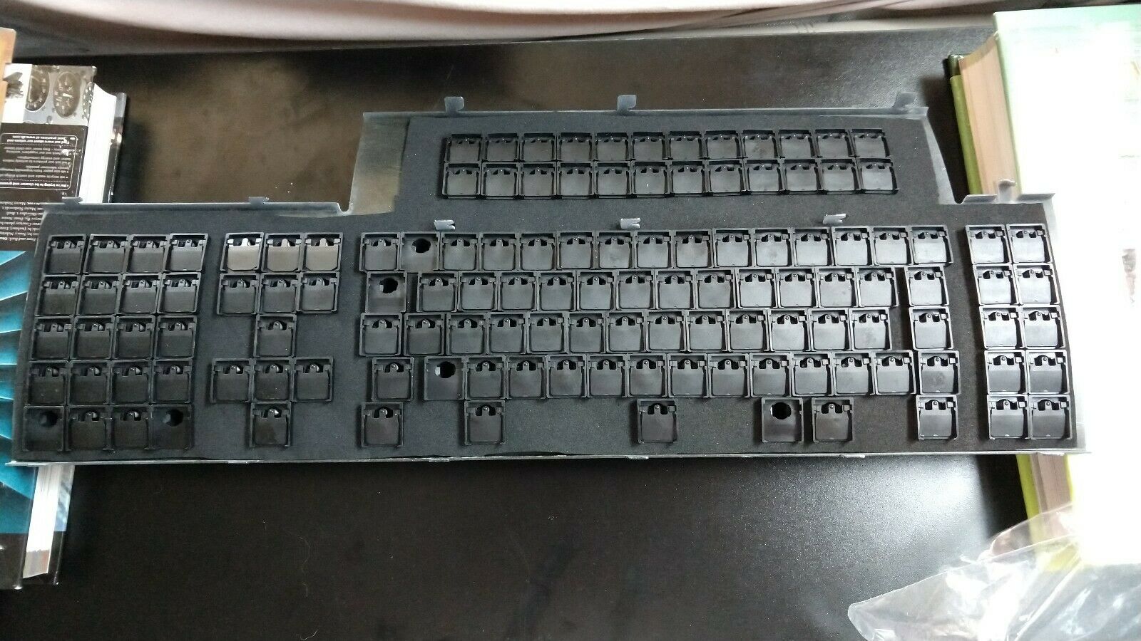

This is true. The F122 feels noticeably loose in the middle when you reassemble it with new foam with no screws. The FXT and FAT feel a lot crisper with new foam as they have much fewer rows and height to the whole module.
Even the XT, none of my foam replacements worked. The closest one was this relatively firm art foam (not the Michael's stuff everyone's banging on about), but the center row was noticeably mushier. It just never works, it's depressing.
in fact, the XT I tried to service recently failed miserably. i drilled holes through it to do a bolt mod as an experiment, with the hopes of removing them later once the plates have aligned. it is inconsistent and rubbish. I'll have to try again with the same 2mm neoprene I used in my F122.
Hi that sounds pretty unfortunate. Do you have an image of your foam? As well do you need to use clamps to get the tabs down far enough when you slide it together?
Clamps are absolutely necessary, but it's difficult to get anything close to the middle three tabs to compress the foam sufficiently. I have a nice neat mat cut out of 3mm foam for the F122, but I couldn't get it back together. Wasn't even close. The stuff I used is this: https://www.ebay.co.uk/itm/BLACK-NEOPRE ... 2749.l2649

Usually, it'll be the center row of keys that feels "spongier" than the rest. The click will be weaker and the bottom out sound will sound "thwackier", best way I can describe it. I've only had a problem with weak foam on UK Models F and that F122, as the UK models use the shitty, white skin-backed foam that always seems to degrade. Honestly, when it comes to foam, you really begin to appreciate how much simpler the Model M design is. I was considering doing a hybrid between a Model M and F 122, with an F PCB and flippers with an M backplate/barrel frame. I'd still like to do that, but I don't know if it would work yet.
Hi, that is good. For a picture I mean do you have a photo of the foam that you cut for this purpose? Like the foam on the steel plate where we can see it before the barrels are inserted.
