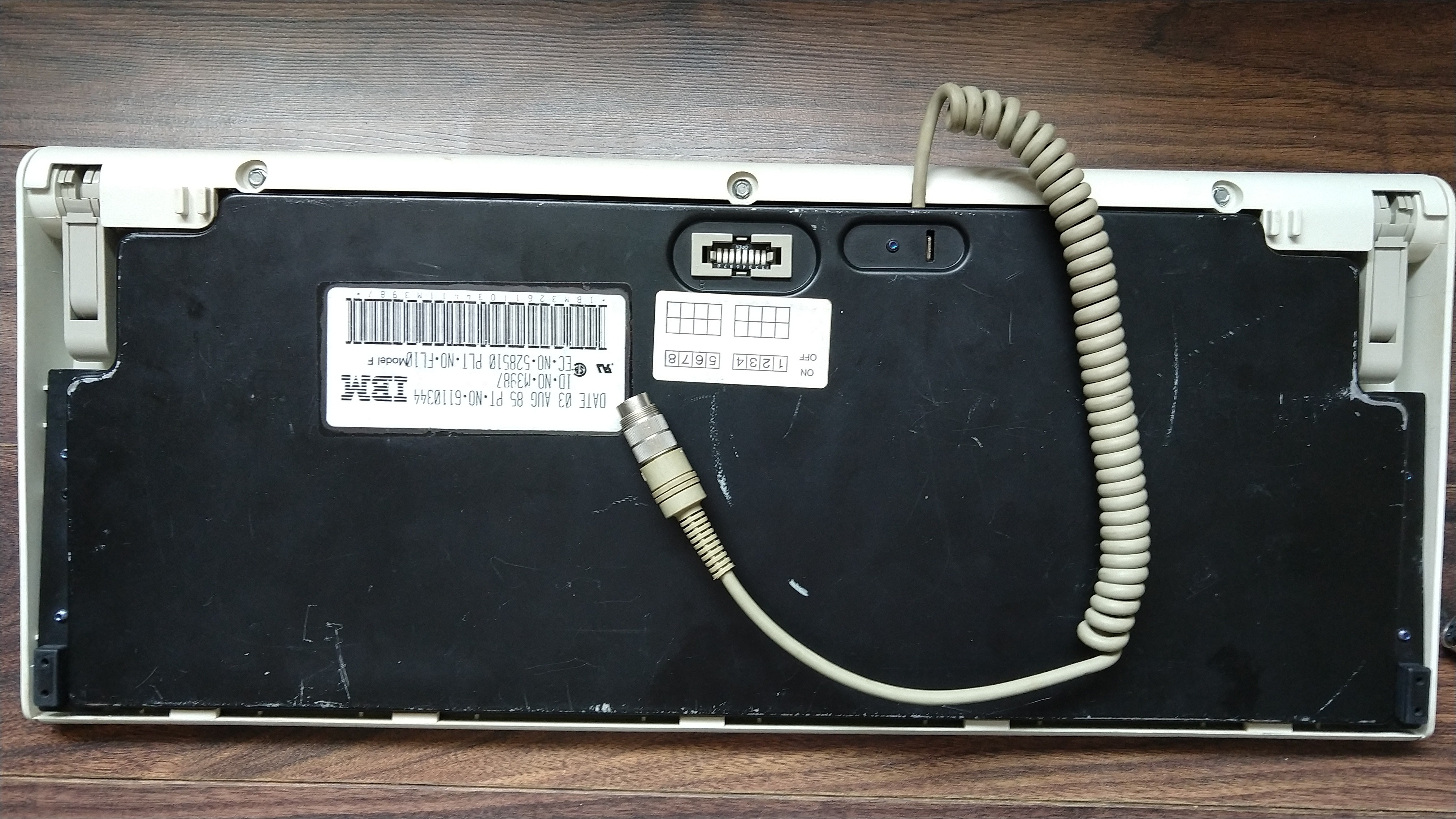

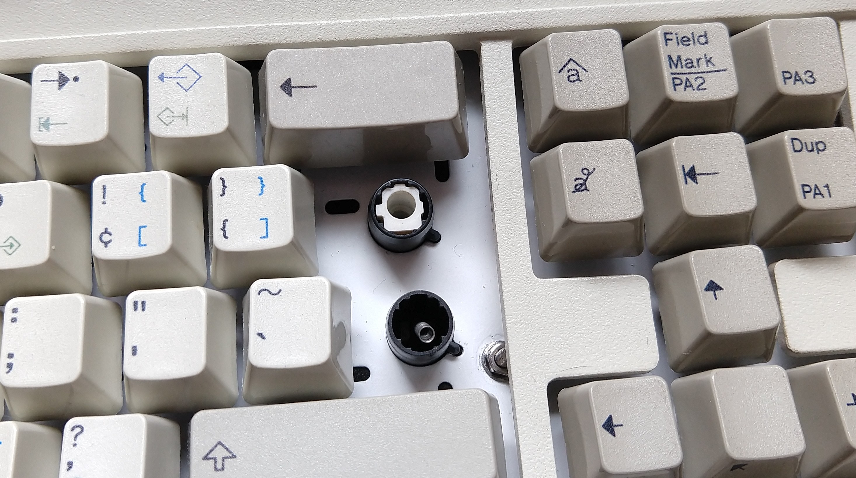

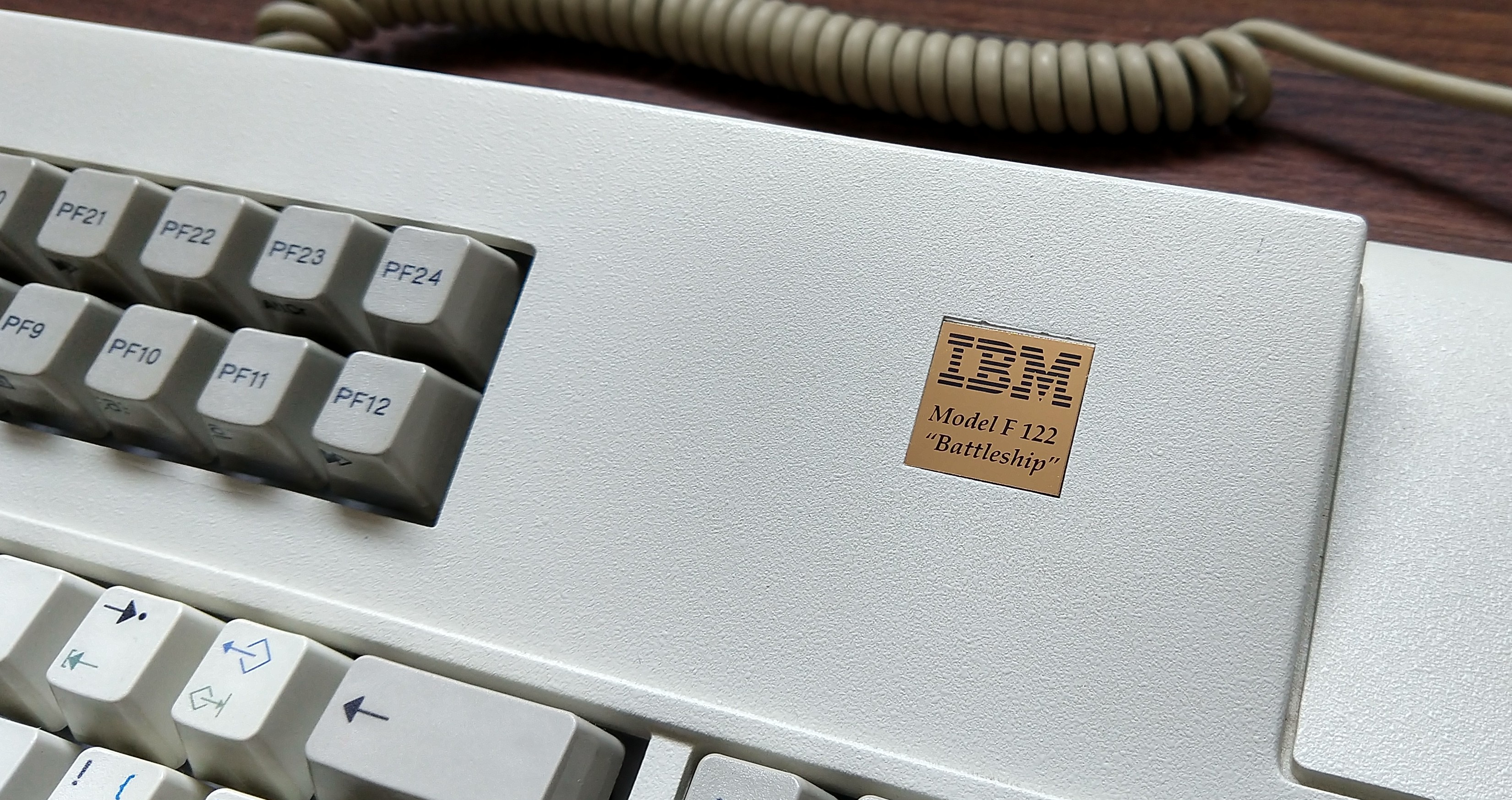

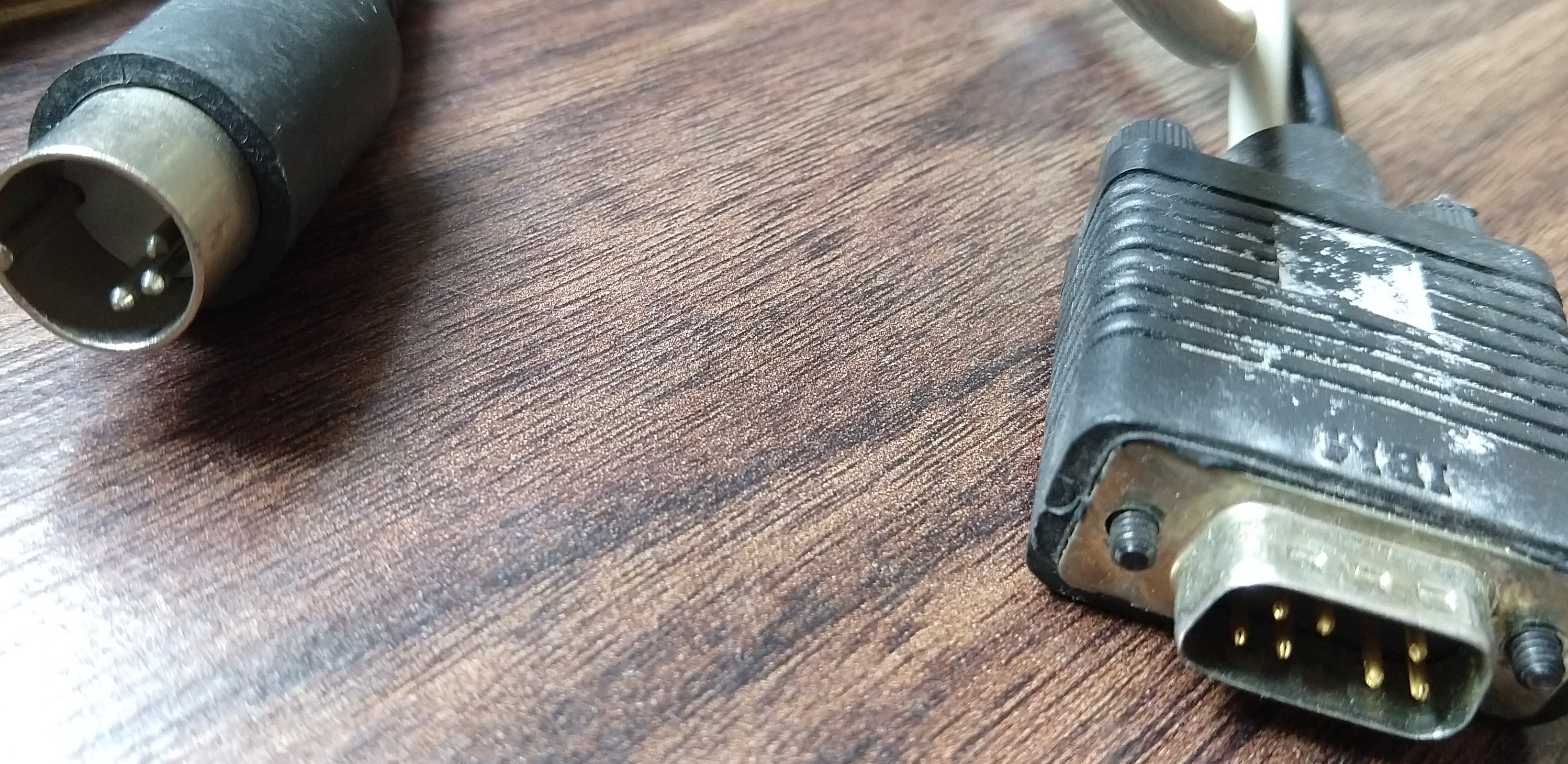

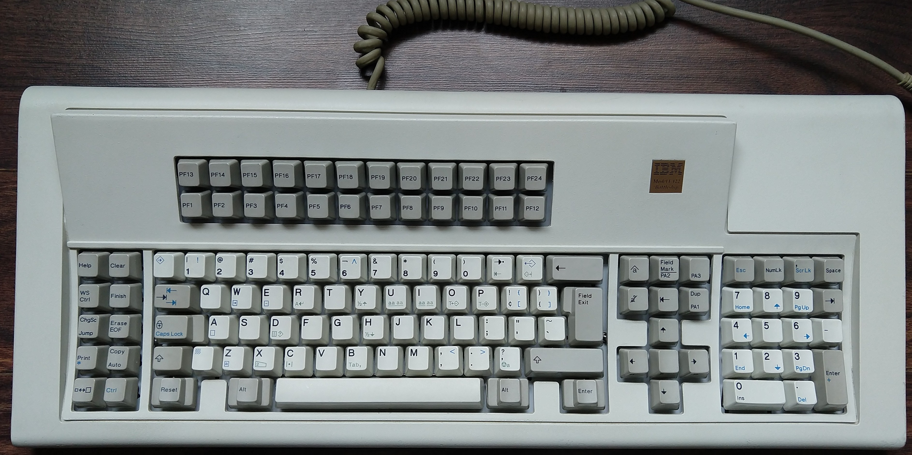

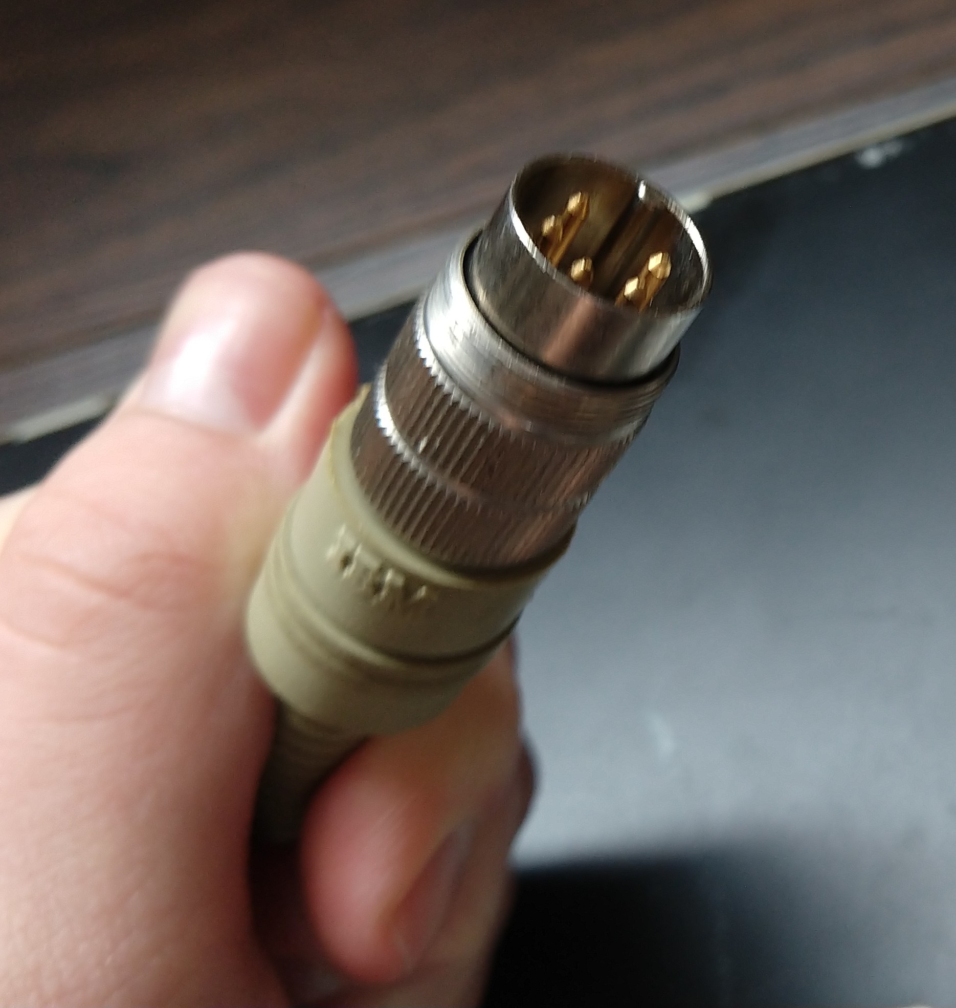

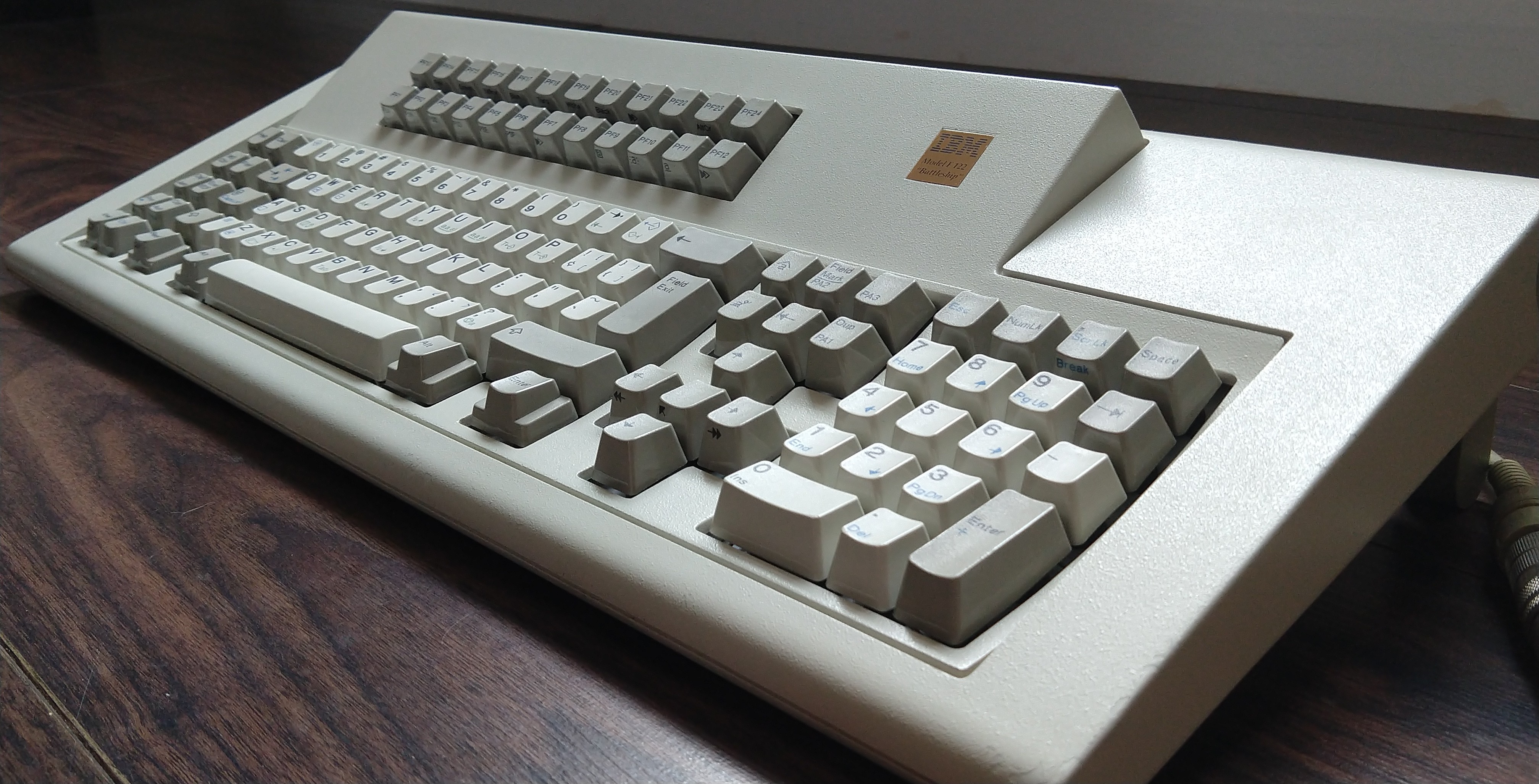

Just thought I'd share a few pictures of this fantastic board. The barrel frame was sanded and primed, but I didn't bother painting it as I think the greyish-white actually looks nice. I cleaned the case and keycaps thoroughly and changed the two-piece alphas to some Wheelwriter keycaps with nifty sublegends. I also had a custom metallic gold badge made by TCE Ltd. (http://www.tce.uk.com/)
I knew straight away when I got it a month ago that the foam was screwed. I enjoyed typing on it for the weekend before I committed to the job. I made four different mats until I could finally reassemble the keyboard. I used this 2mm neoprene: https://www.ebay.co.uk/itm/BLACK-NEOPRE ... 2749.l2649
I drilled through 6 clear of the clear PCB areas shown in Fohat's guide: https://geekhack.org/index.php?topic=48786.0 I then added M3 screws and nuts, tightening them right down initially. After 48 hours, I loosened all of them, especially the ones near the three latching tabs in the middle of the assembly. You don't want the screws to be too tight, as this deadens the key feel and sound from my experience. You want to pull the plates back into their natural curvature, or just tight enough so the barrels do not wobble.

Probably the nicest F122 I've ever seen. Very nice work, dude!

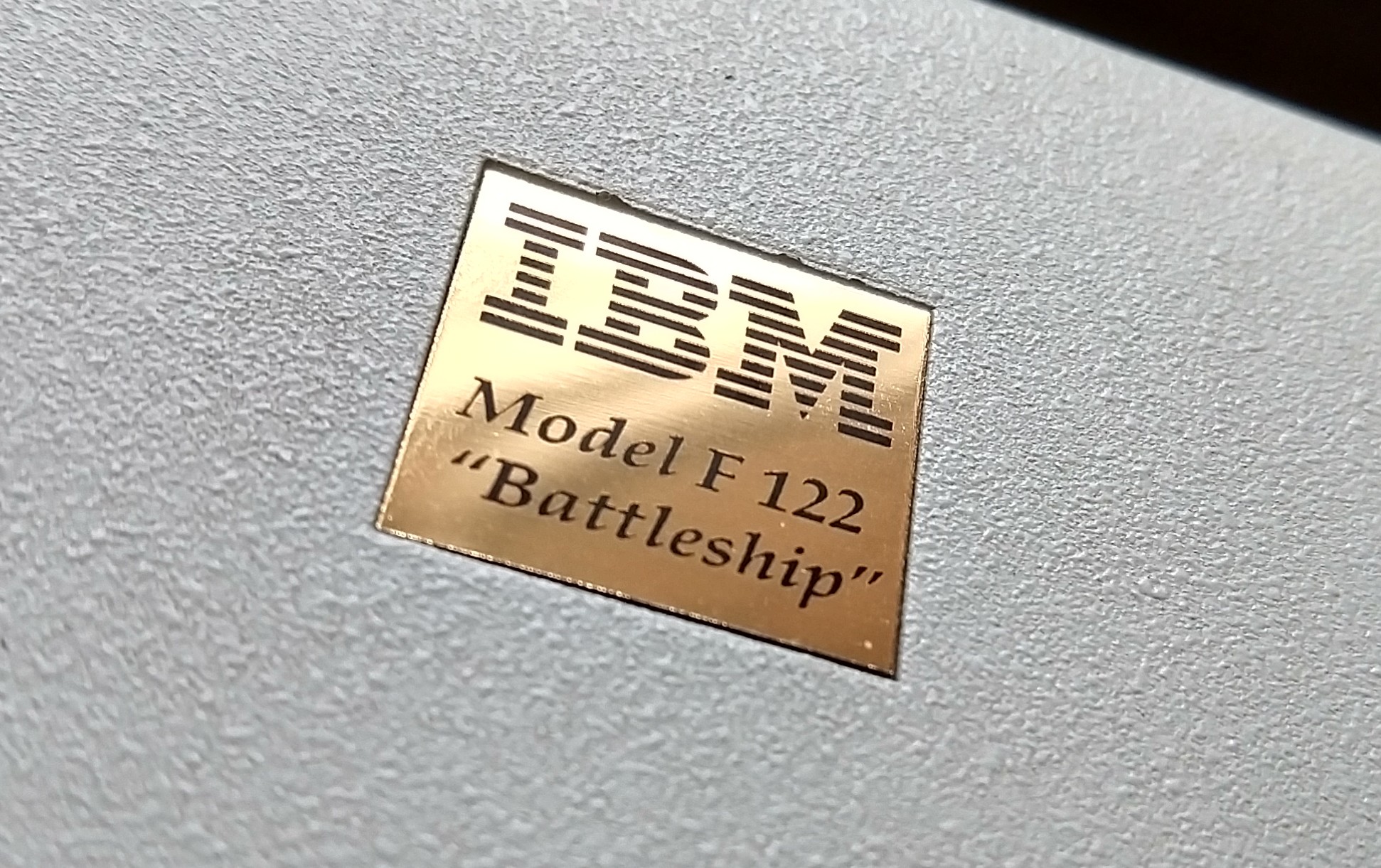

Dat badge... (I'd take the quotes out of «"Battleship"», though - YMWSV)

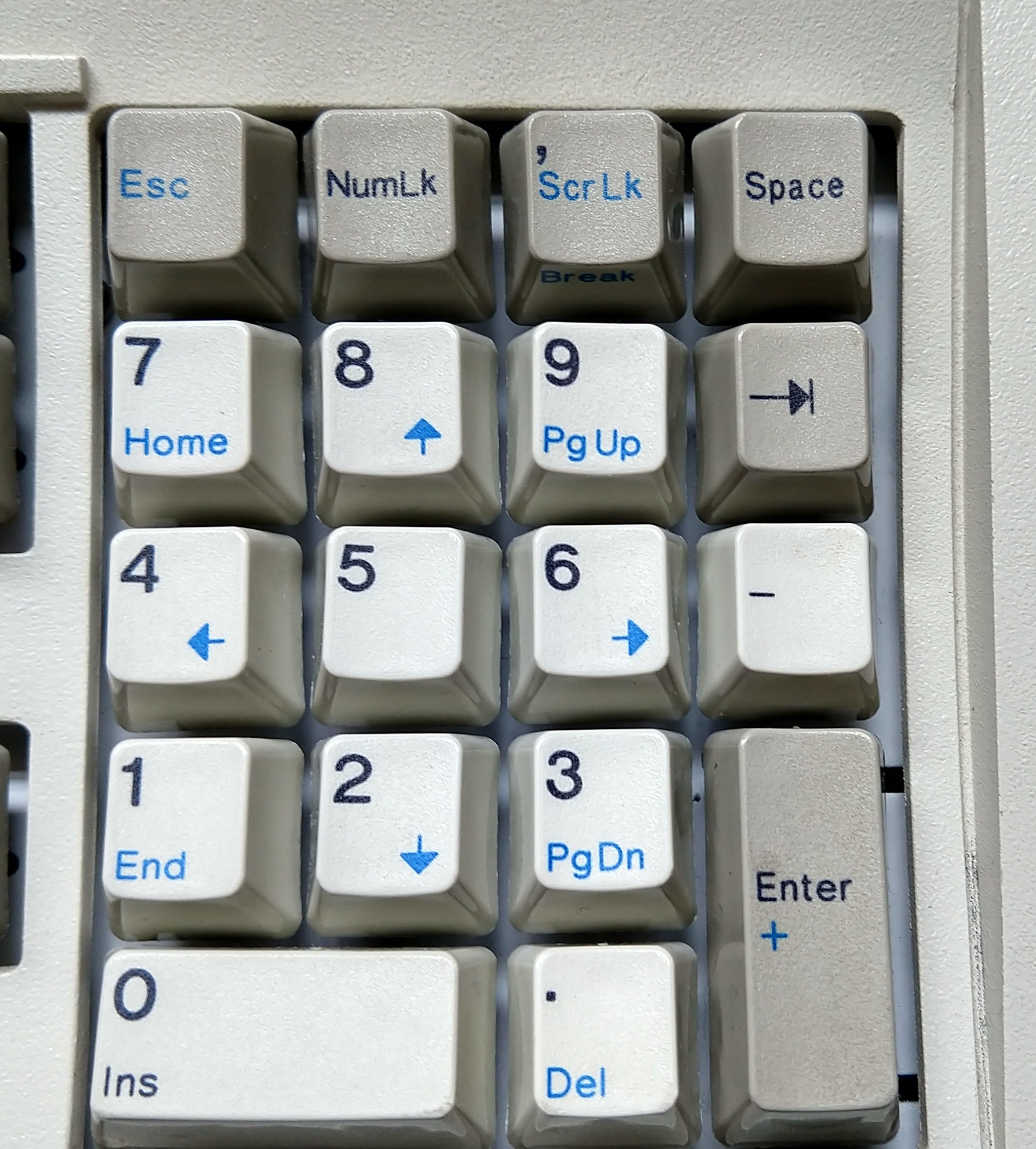

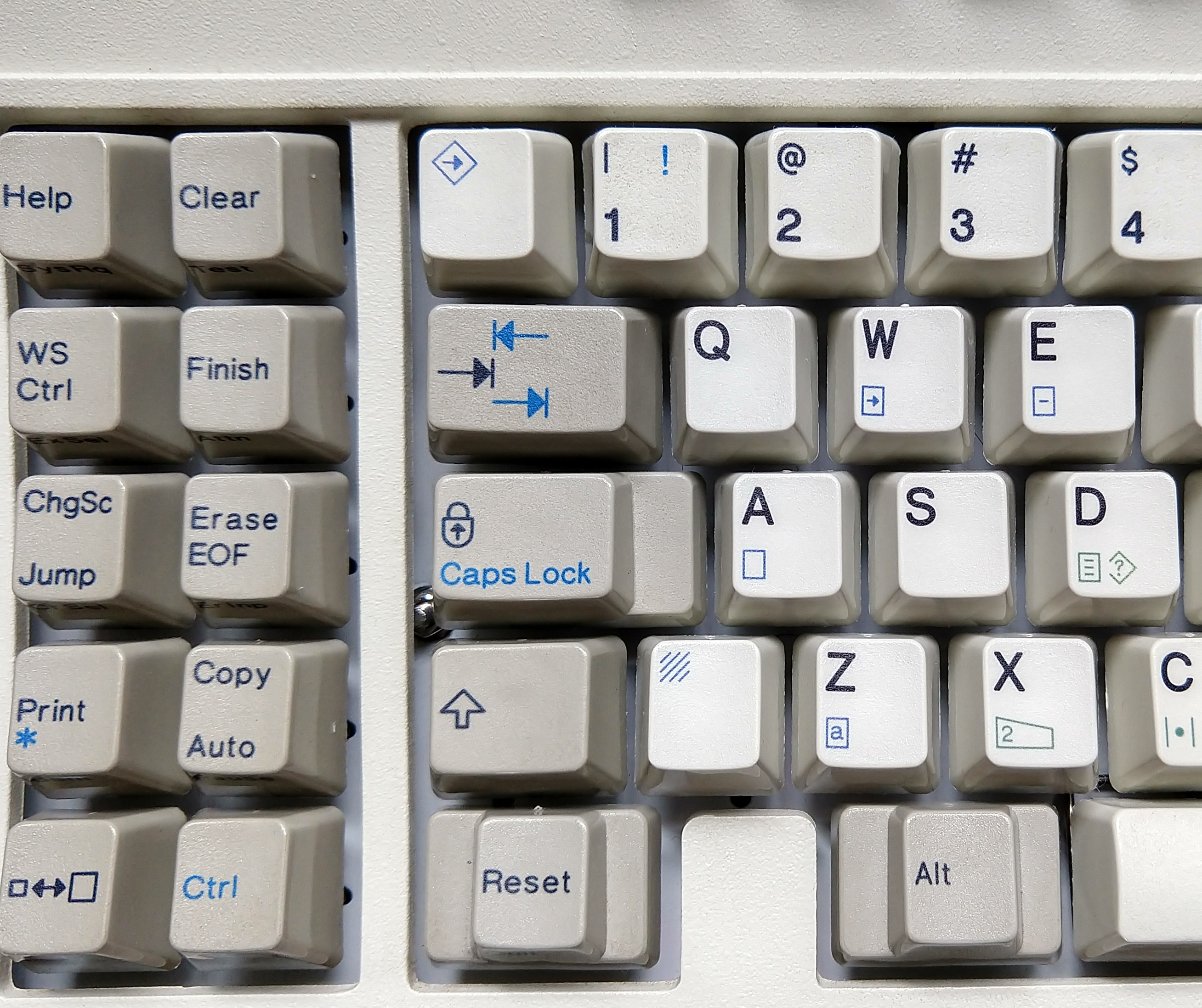

Hehe.. thanks again! I had a quick look at that link you sent me. Really digging the red sublegends. How rare are they? Never seen them on an M before.depletedvespene wrote: 05 Jun 2019, 21:30 Damn. My F122 doesn't look nearly as nice. I'm gonna give it a much needed cleaning before I rotate it back into the daily driver position. I think I'll compensate by putting a red Atari logo in the Esc position.

Those are the APL keycaps.

I don't have an issue with you selling it at all. I just wanna know where you found those blue lettered keys...Wazrach wrote: 13 Jun 2019, 20:35 I'm just wondering who else I can put in the Top 10 Friendliest Deskthority Users list. So far I've got Myoth, Anders...

I had a Wheelwriter with pretty much the same keycaps. Maybe this thing was adapted to be used with some kind hybrid between a typewriter and a computer.

I put them on myself, harvested from a dead Wheelwriter modulePlacaFromHell wrote: 14 Jun 2019, 02:55 I had a Wheelwriter with pretty much the same keycaps. Maybe this thing was adapted to be used with some kind hybrid between a typewriter and a computer.

Both the alpha keys with green sublegends (easy to come by) and the keys with blue sublegeds (never seen 'em before!)?Wazrach wrote: 14 Jun 2019, 15:59I put them on myself, harvested from a dead Wheelwriter modulePlacaFromHell wrote: 14 Jun 2019, 02:55 I had a Wheelwriter with pretty much the same keycaps. Maybe this thing was adapted to be used with some kind hybrid between a typewriter and a computer.

Why does one bolt-mod an F? Bolt-mod on an M is to replace failed heat staking, F has no heat stakes and operates on a different principle. What does it do?
- Wazrach
- Location: Tyne and Wear, United Kingdom
- Main mouse: Razer Viper 8KHz/ Viper Mini
- Favorite switch: Buckling springs
Because these fucking things never feel good after reassembling with new foam. Ever. I had no choice.Red_October wrote: 14 Jun 2019, 17:20 Why does one bolt-mod an F? Bolt-mod on an M is to replace failed heat staking, F has no heat stakes and operates on a different principle. What does it do?
- SneakyRobb
- THINK
- Location: Canada
- Main keyboard: KB-5161A, F122, Dc2014, Typeheaven, Beamspring FXT
- Main mouse: MX518 Legendary
- DT Pro Member: 0242
This is true. The F122 feels noticeably loose in the middle when you reassemble it with new foam with no screws. The FXT and FAT feel a lot crisper with new foam as they have much fewer rows and height to the whole module.Wazrach wrote: 14 Jun 2019, 21:24Because these fucking things never feel good after reassembling with new foam. Ever. I had no choice.Red_October wrote: 14 Jun 2019, 17:20 Why does one bolt-mod an F? Bolt-mod on an M is to replace failed heat staking, F has no heat stakes and operates on a different principle. What does it do?
- Wazrach
Even the XT, none of my foam replacements worked. The closest one was this relatively firm art foam (not the Michael's stuff everyone's banging on about), but the center row was noticeably mushier. It just never works, it's depressing.SneakyRobb wrote: 14 Jun 2019, 21:27This is true. The F122 feels noticeably loose in the middle when you reassemble it with new foam with no screws. The FXT and FAT feel a lot crisper with new foam as they have much fewer rows and height to the whole module.Wazrach wrote: 14 Jun 2019, 21:24Because these fucking things never feel good after reassembling with new foam. Ever. I had no choice.Red_October wrote: 14 Jun 2019, 17:20 Why does one bolt-mod an F? Bolt-mod on an M is to replace failed heat staking, F has no heat stakes and operates on a different principle. What does it do?
in fact, the XT I tried to service recently failed miserably. i drilled holes through it to do a bolt mod as an experiment, with the hopes of removing them later once the plates have aligned. it is inconsistent and rubbish. I'll have to try again with the same 2mm neoprene I used in my F122.
