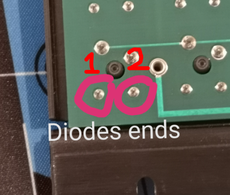

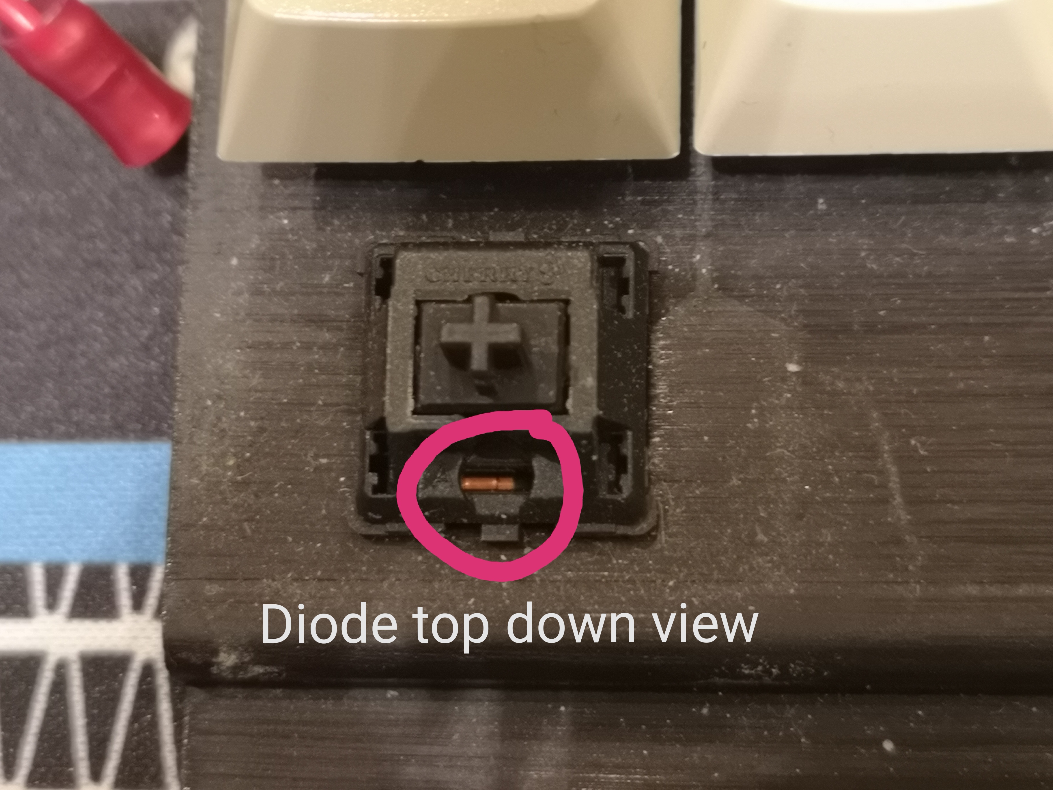

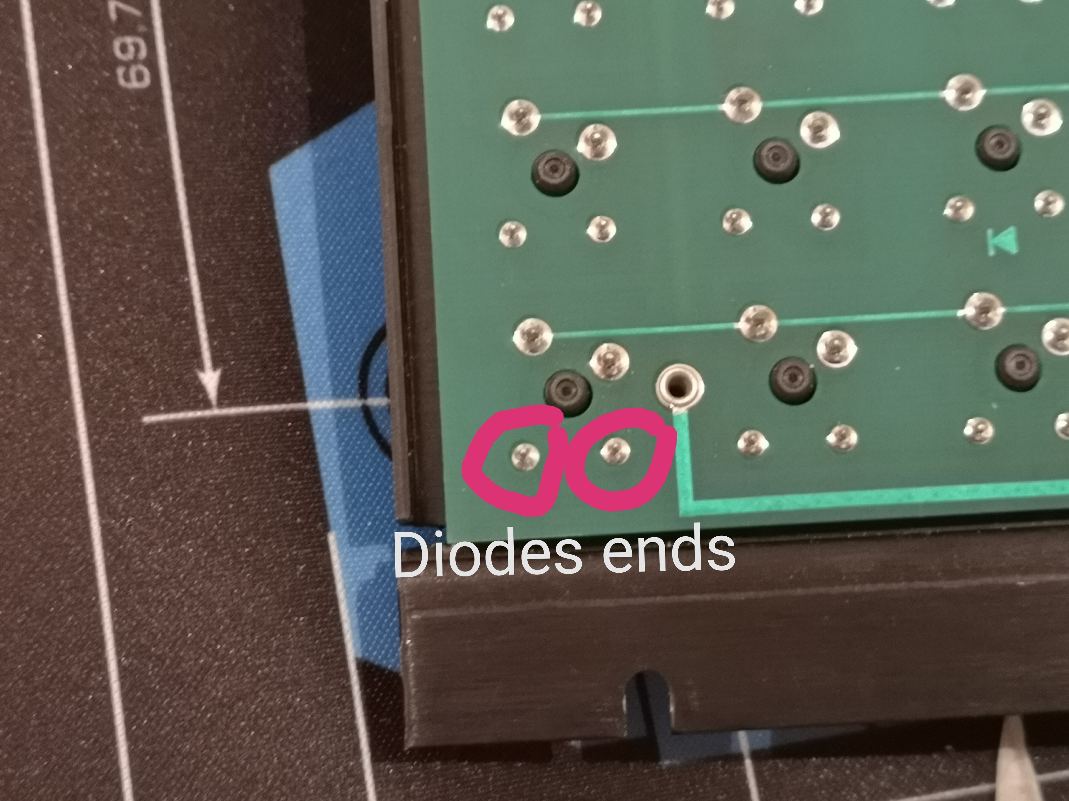

Here is an image of one of the diodes. Also a picture of where the two ends of the diodes are.
Hope that helps thanks for all the help guys.
Anakey
- Location: UK
- Main keyboard: Planck
- Main mouse: Cyborg Rat 7
- Favorite switch: Alps skcm white
measure with multimeter on continuity between the diode and the switch pin above it. Once you establish the side that is connected to the switch measure the other end of the diode to the shift register the same way as you did the switch pins.

I tried placing one of my multimeter probes to one of the diode pins and tried the other probe on every solder point on the board. When that did not show any connection I tried the other pin of the diode still nothing. I also checked the other switch pin and no connection to any of the solder points on the controller board. What does this mean have have I got dead traces?

OK I will try to get the other half of the matrix tonight just to confirm am I probing point 1 of the diode or point to 2 to the Controller solder points?
Below is a picture please let me know am I putting one probe on 1 or one probe on 2?
Anakey
- Location: UK
If what you said above is true for all diodes, then it is the other side (1) that connects to a chip its just a case of finding the correct pin.Fkazim wrote: 23 Sep 2019, 22:12 I tried getting the other half of the matrix but found that the other pins just connected to the diode pin below the image below shows what I mean. Sorry if my description is bad I am new to this sort of thing please let me know what I am doing wrong.

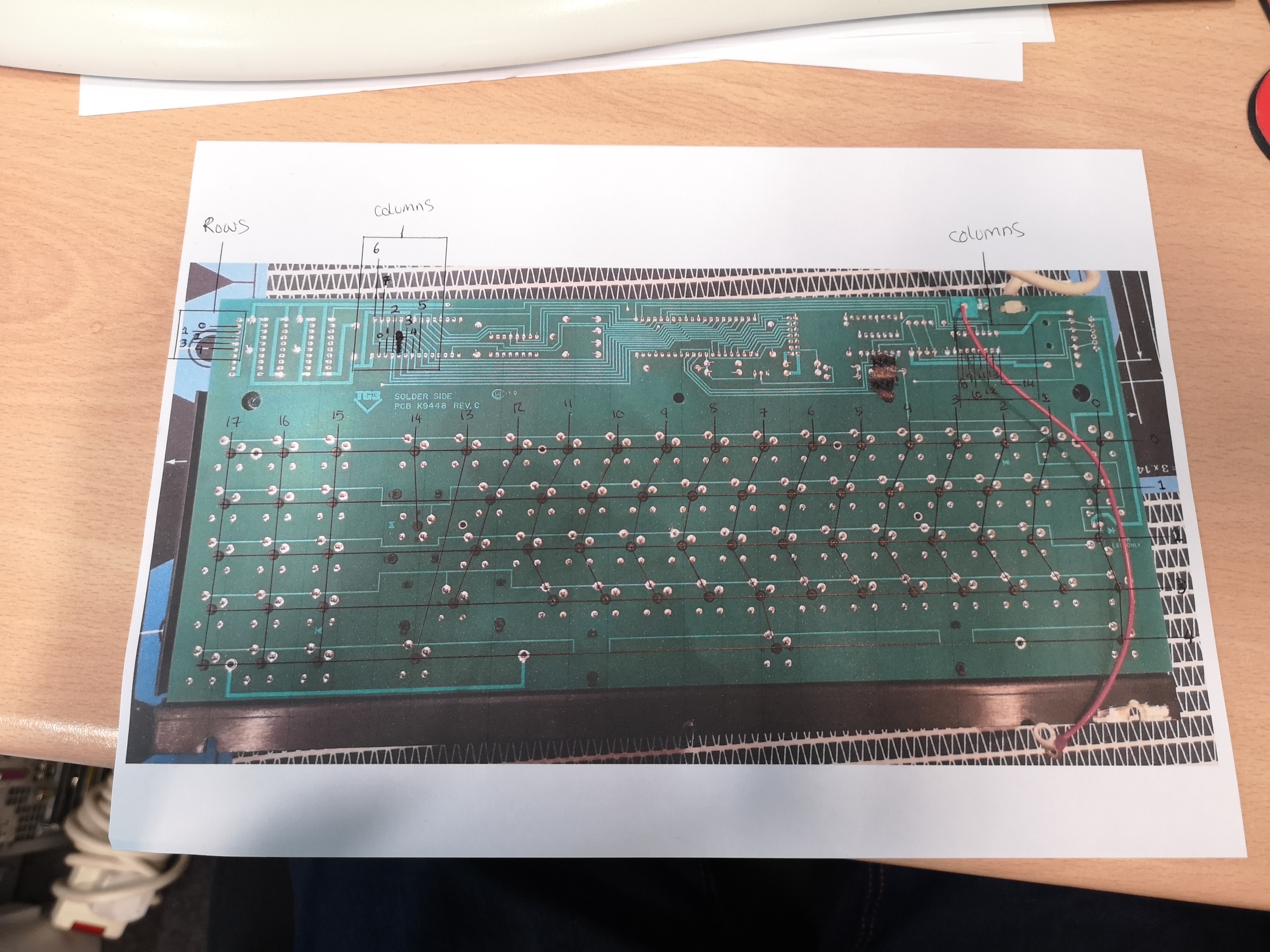

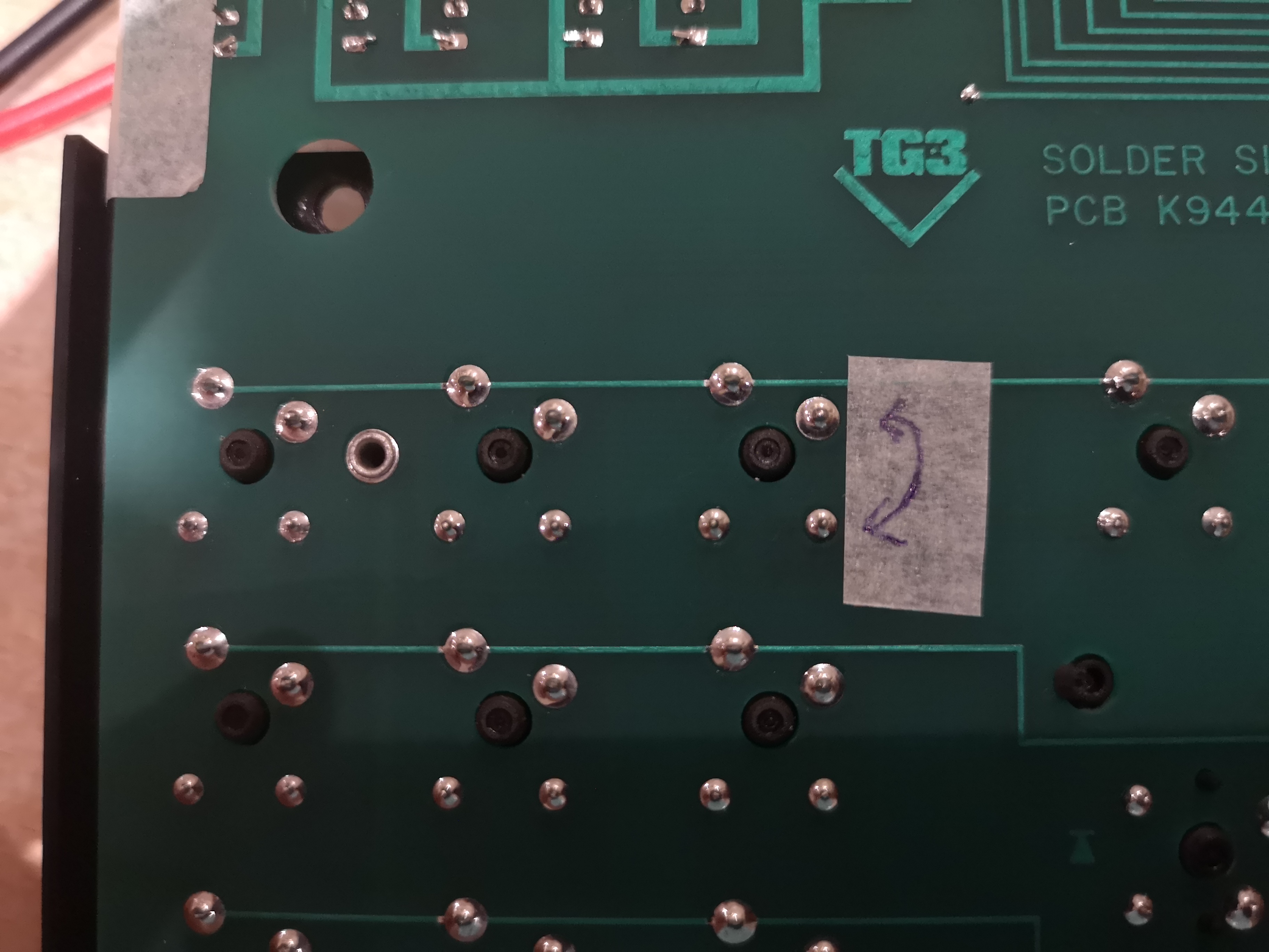

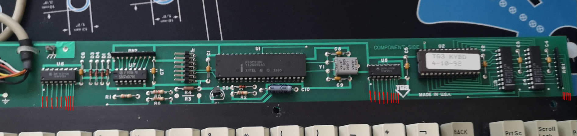

There is quite a lot of different traces leading under the PCB. I have marked them all in red the ones on the far right side are the ones that correspond to the first half of the matrix that I have already mapped. From what I can see nothing directly connects the matrix from the other side please let me know which pins/components I should probe tonight.
Thanks.
Thanks.
Anakey
- Location: UK
if you have established that the far right is for the rows, then the other 2 with traces going down will be for the columns so it is those pins that you would need to probe with the other end on side 1 of the diode

ok sorry if you know how a diode works but i am going to repeat it anyway. The diode is like a one way system, it allows current to flow in one direction only from + to -ve. Assuming you placed the probes of the multimeter in the correct polarity e.g. the -ve probe was soldered to position 2 and you were probing the chips with the +ve side then you were trying to make the current go through the diode the wrong way. If you had sodered to position 1 in the diode as i have been saying to do before then you could have used continuity as there would be no diode in the circuit.
Fkazim
- Location: United Kingdom
- Main keyboard: Modded IBM Model F AT
- Main mouse: Mionix Naos 8200
- Favorite switch: Capacitive Buckling Springs
Ok sorry I misunderstood before I know now side 1 of the diode will try that tonight after work.

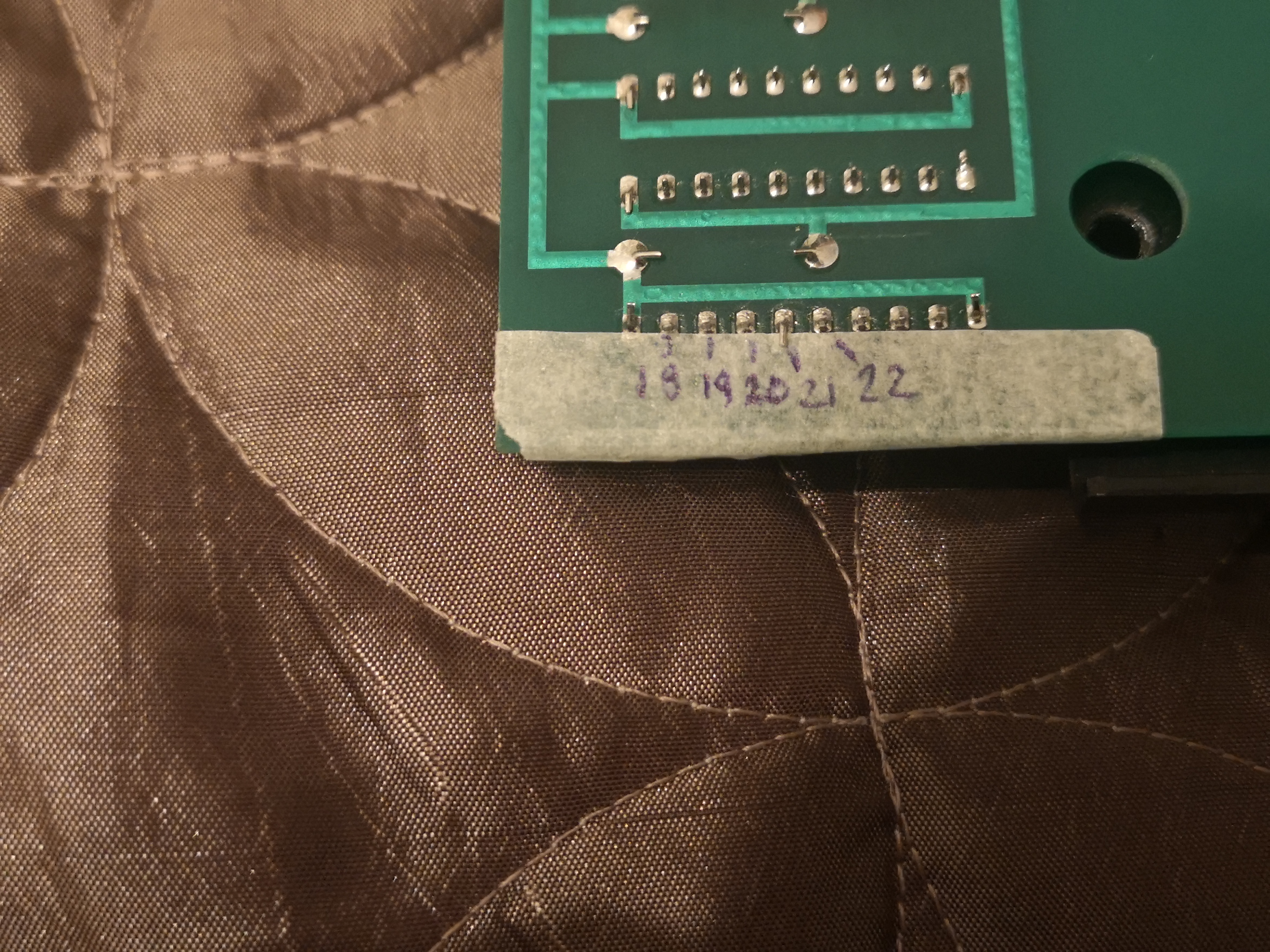

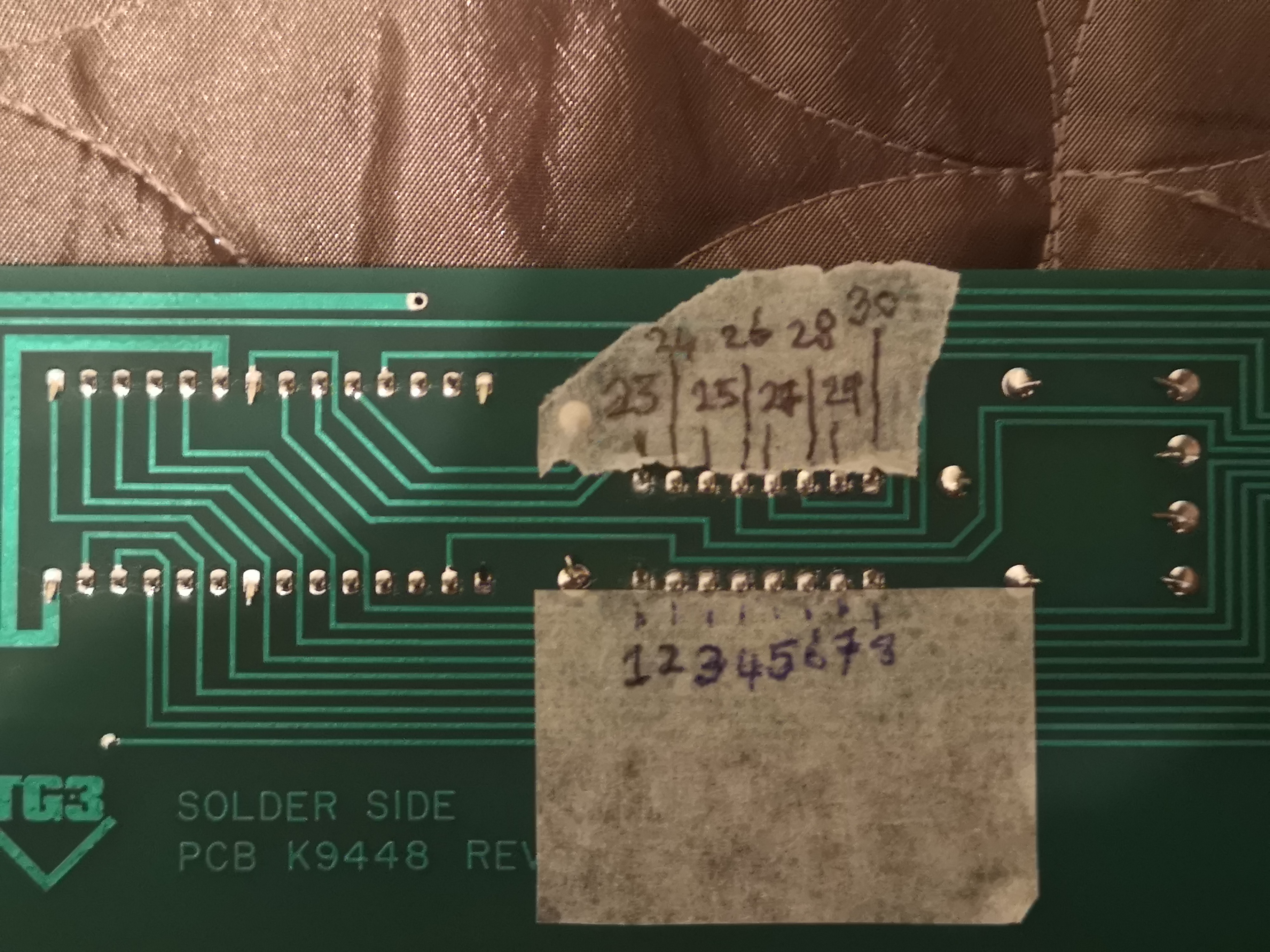

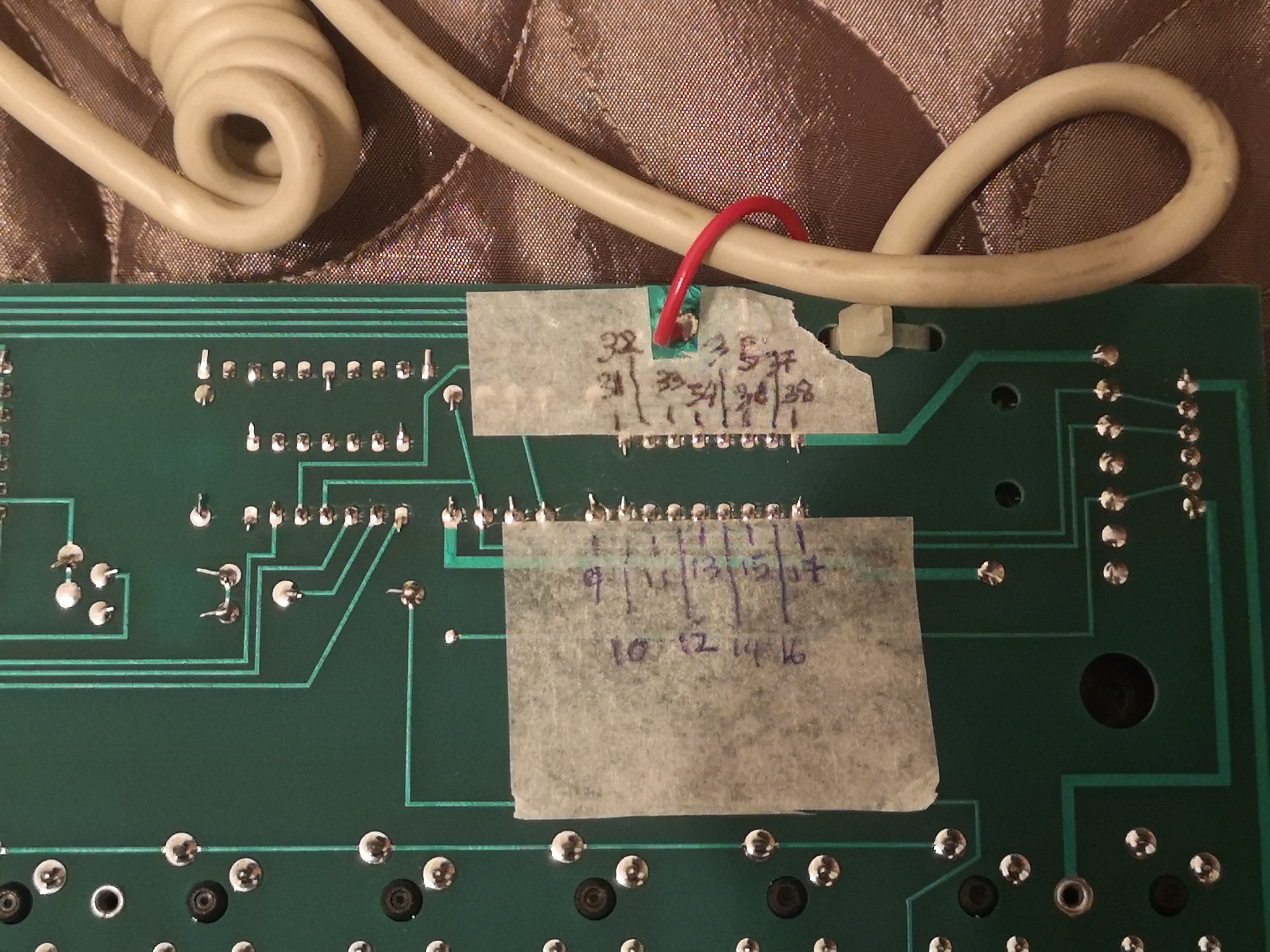

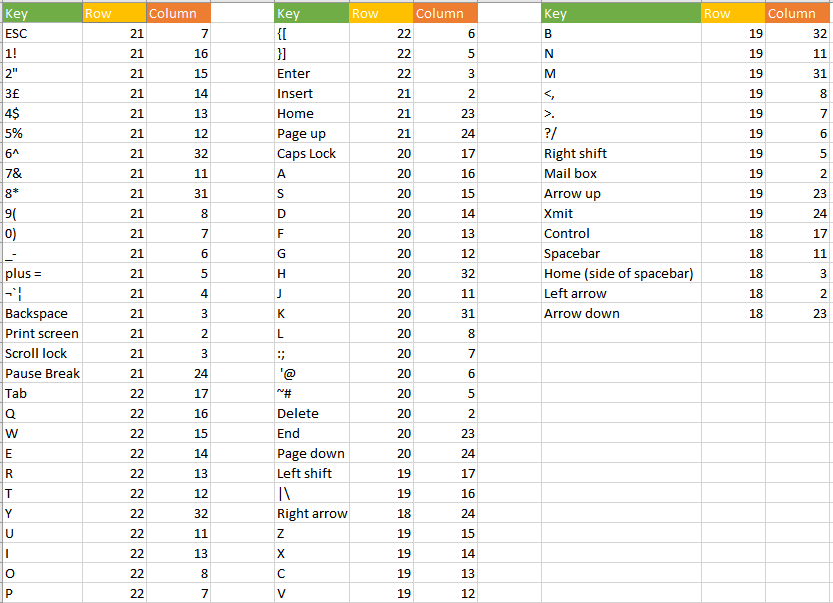

OK Keyboard Matrix fully mapped Below are the pictures showing the pins and also the keys they correspond to please let me know where to go from here I understand where I went wrong and know now for the future and learning a lot along the way. What do i don now get the pro micro solder wires?
Thanks for all the input and help.
- 15694515511784382473944773863700.jpg (2.17 MiB) Viewed 8712 times
- 15694514936315956774246705115407.jpg (2.28 MiB) Viewed 8712 times
Anakey
- Location: UK
Well done, it would be easier to now arrange the table by the order of the keys on the board and also convert the pin numbers to correspond to the physical row/column numbers starting from 0 e.g. Columns 0, 1, 2 etc so that Esc = Column 0, Row 0, F1 = Row 0, Column 1 etc. Before getting the conversion done you would need to first consider the number of pins that you will need. It looks like you will need more pins then the pro micro can provide. I do have a spare Teensy++ that I can send you as that will have enough pins. As for desoldering you would want to desolder the chips that the pins are on as you will be wiring the pins on the pcb to the controller. Sorry if it sounds confusing, it would probably be better if i could talk with you on discord about the conversion would be easier in real time. I am on both the MKUK and deskthority rooms if either of those would be acceptable.
