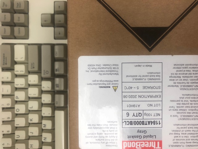

Ok I will post here if I am able to get 1855 in US. Non US market product probably will have long wait time.
What is strange, I just started using alps for the 1st time ever yesterday. I noticed uneven key feel and was disappointed. So I was thinking about trying to lubricate the switches then I run across this thread..
- Yasu0
- Location: hawaii
- Main keyboard: dull grey ibm selectric
- Main mouse: vertical ergonomic old man mouse
- Favorite switch: unicomp m, spring and rubber in perfect harmony.
Heads up on eta, if he can get these products it will likely take 1 to 4 months to arrive. Just to prove I am not an interweeb liar with no 3B dealings here is some trans seal from my last request.
- 3b stash.jpg (80.63 KiB) Viewed 14353 times
