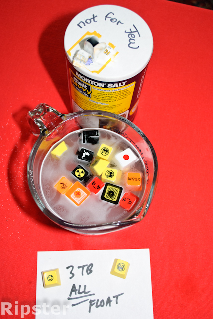

7bit wrote: I think the sink/not sing thing is because there are some little air bubbles on some keys, so they don't sink. When cleaning key caps I have this all the time. This should really be researched one day. When you come back, we might call you Dr. Ripster.

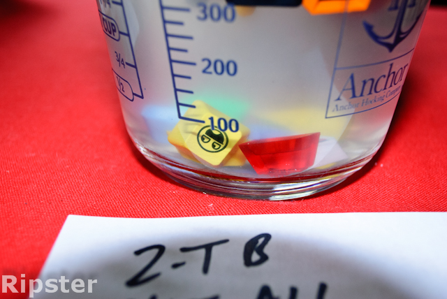

Correct!

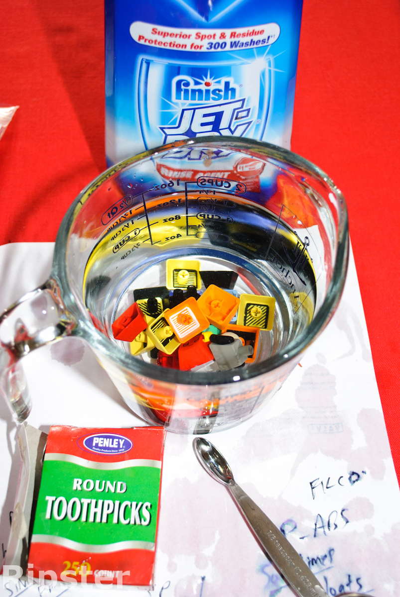

Toothpicks take out the stem air bubbles.
1/8 tsp RinseAid Surfactant takes out the surface tiny... bubbles (that one stumped me for a while I tell ya).

And to add SALT to your wounds I found the RIGHT amount of salt to add.
Will continue tomorrow.

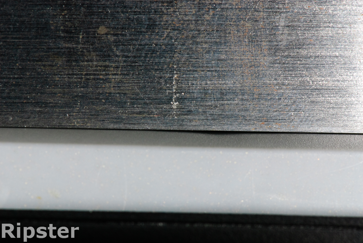

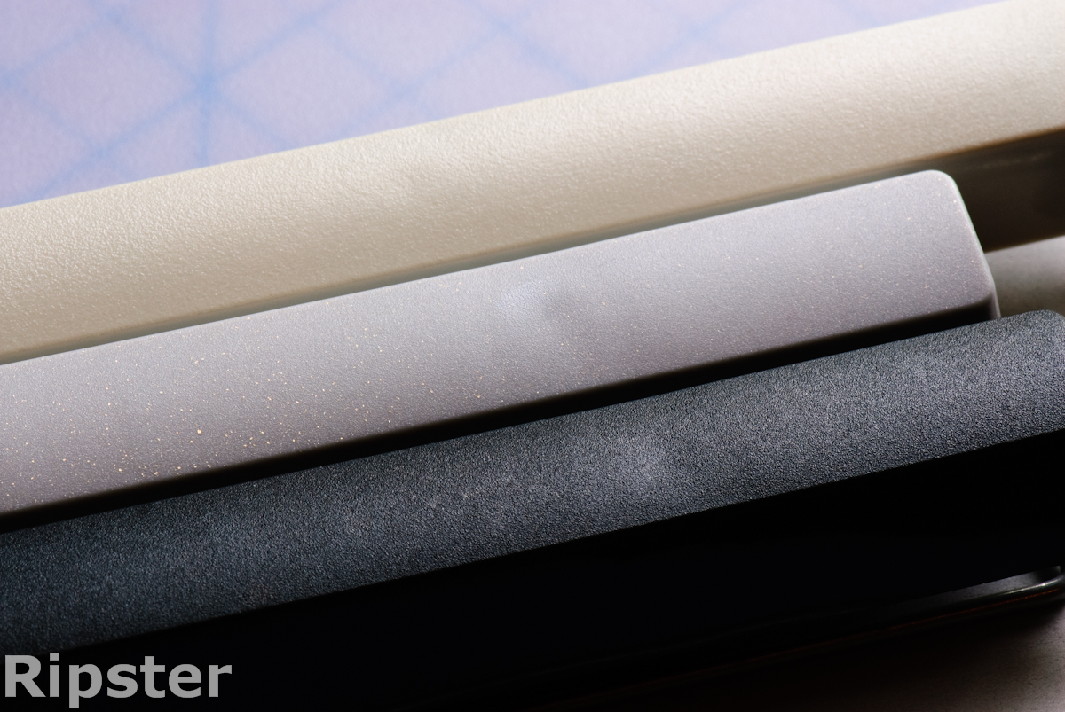

Alright, this is what I found regarding POM caps :
1. They have a dimple at the top center when viewed in proper lighting/angle ( but this was already known )
2. They all have 4 little circles in each corner on the backside of the keycap. I checked and could not find any other mx keycap with that same property.

Aren't they labeled POM on the inside?Mrinterface wrote:Alright, this is what I found regarding POM caps :

My POMs never had a POM Label on the inside.
I can only confirm the ones I currently own, a set of Raptor K1, 1502, 11900 - all three are black.
none of them labeled on the inside, all slippery. All have dimples, easy to see on bigger keys, harder on 1x1 keys. All of them are deformed on the side, some more, some less.
As for 2. - I'm not sure I understood correct what you meant. maybe the pic helps:
the flat circles that are even with the surface on the bottom, (red arrows) well all my POMs have them, but also some of the PBTs (also seemingly less often) PBTs are Compaq 11800 ALT and Cherry 1800 capsL.
As for the little stems on the cross (blue arrows) K1 tab has them, as well as 11900 Enter, but also the PBT space bar of the latter.
For me its still: slippery, no marking, dimples, deformed sides => most likely Cherry POM.

ripster wrote:Salty Water test?
Is that like the Muddy Waters test? Let's get my MOJO working!
How much salt do you use? And IIRC many plastics have widely varying specific gravity based on injection of air and additives. Like titanium dioxide for these new low wavelength lasered Filco Camo keys.

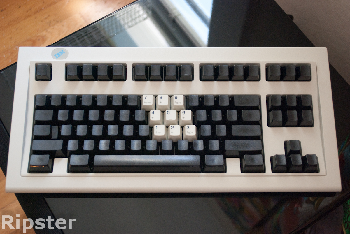

I'm telling you guys, look at a IBM spacebar closely and you can see a PBT dimple.
Not a good way of telling difference between PBT and POM.

As for POM: You have to feel it, I guess. Those dimples are Cherry specific, they don’t need to be there when the keys come from another mold. Or at least they don’t have to be similarly big.
Ps: No matter how close I look, I don’t have any PBT dimples on my IBM spacebar, just a bit of shine.

maybe you can read spot PBT because that's what it is - the PBT space bar from a Cherry 11900 POM keyset.7bit wrote:@kint: Please take a picture of the inside of the righ key kap. I can see something like >P?? inside!
If you still need a pic, I'll do.
and, maybe I need to rephrase that:
Cherry OEM caps:
slippery + no marking + dimples + deformed sides => most likely POM.

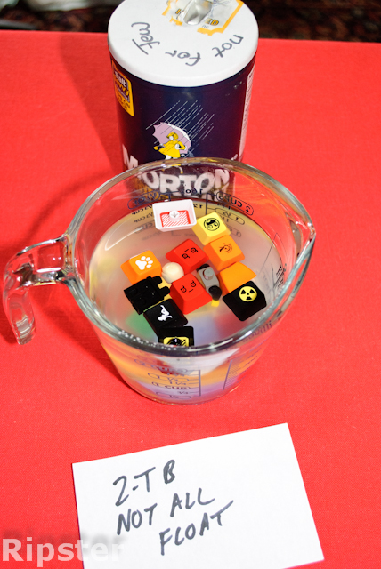

Damn ABS Awesome Key. Trolling me. 44.3602943 ml/3TB of normal table salt per 500ml/2cups of distilled water is enough for a 100% Accurate test. THIS is how Keyboard Science is DONE!
I still prefer the Acetone test. Quick. 100%. Your wife doesn't yell at you for doing it on the dining room table.
BUT to stay on Topic let's answer the OP.
29.5735296 ml/2TB of normal table salt per 500ml/2cups of distilled water is too little. Excuse the Salt Label. My son did that. He is a big Borat friend and can assure you likes Jewish people. Sense of humor - genetic or upbringing?ripster wrote:Salty Water test?

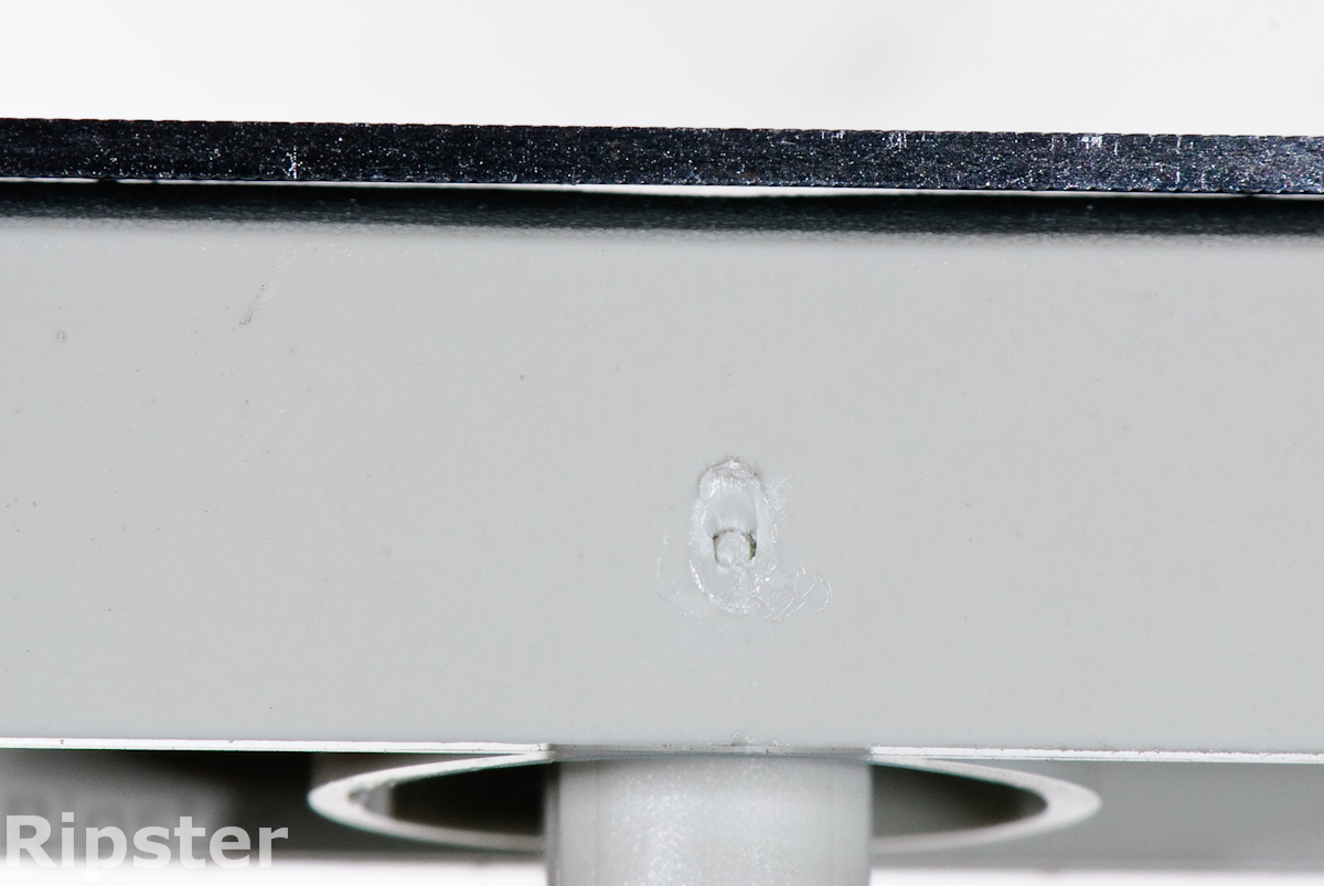

I'm not seeing the POM dimples on my Cherry SPOS.
Am seeing it all over my IBM PBT keys.
Now... how do I move these Attachments into the MediaWiki?
- DSC_2083.jpg (685.14 KiB) Viewed 7605 times
- FLA_6223.jpg (510.12 KiB) Viewed 7606 times
- FLA_9728.jpg (808.77 KiB) Viewed 7606 times
- FLA_9749.jpg (640.92 KiB) Viewed 7606 times
