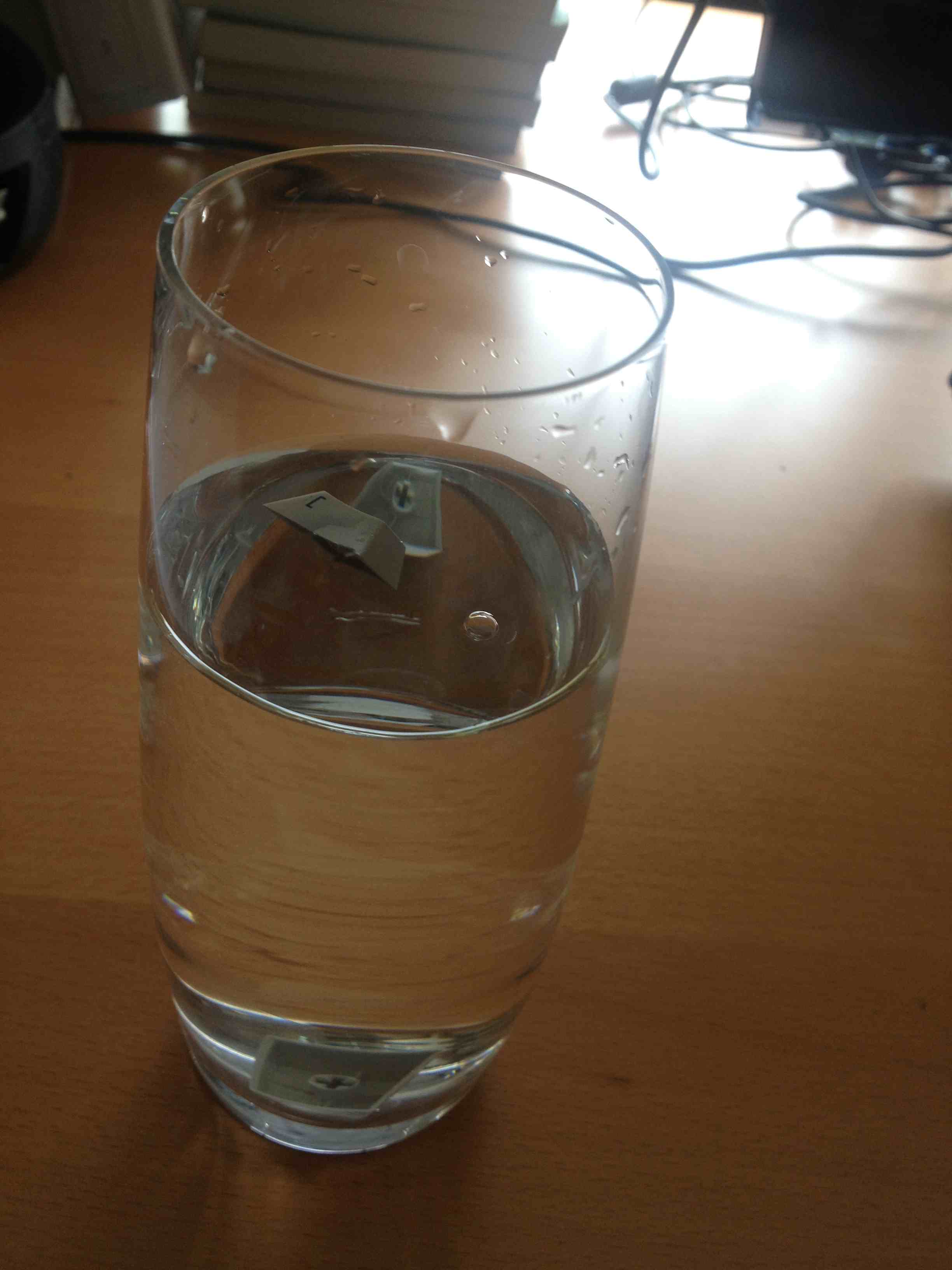

I just use a longdrink glass with lukewarm water and some salt.
The difference between ABS and PBT is really very clear, the PBT sinks to the bottom almost immediately. The ABS floats on top are hovers somewhere in the middle.
It's a pitty POM behaves the same as PBT. My 'pincer-tests' showed that ABS dents more than shatters. PBT and POM shatter. So now I don't have any test to show the difference between PBT and POM. :-(
EDIT : I made vids of me testing all the different keycap material. I even tried the hammertest, but those tests basically failed since I used too much force and the caps just shattered regardless of material. So I redid the tests with a pincer and then it clearly showed the denty behavior of ABS compared to PBT/POM.

I redid the test with water straight from the tap ( cold ) and NO salt. Results are the same. PBT rushed towards the bottom and ABS hovers.....
ABS floating, PBT bottom

Yes, that's the thing. ABS can even end up on the bottom. The trick is to measure the speed
. PBT and POM will rush towards the bottom, ABS will not. ABS sometimes reaches the bottom but it will take a while.....

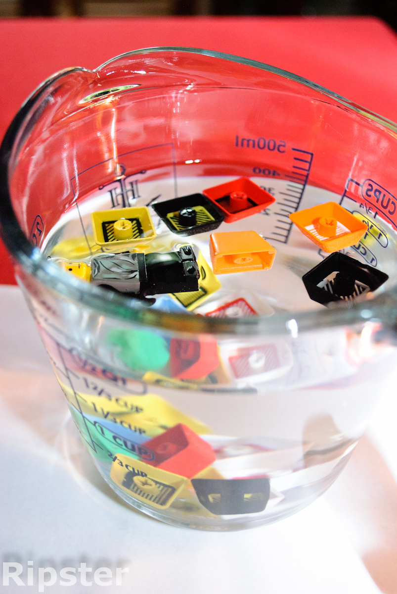

OK, HERE is where things get interesting.
SOME SP Doubleshots sink and some don't.
OK, it's GUESSING TIME!
Anybody know why?
In fact some ABS keys sink like a ROCK in my water.
Mrinterface
01 Jun 2012, 17:11
Give those top floating ones a little push down.....
Did the bottom ones sink like a brick?
Did you add salt?

ripster
01 Jun 2012, 17:57
ALL the SP doubleshots SHOULD float, yes. That's my point. It's an OK test but needs KEYBOARD SCIENCE to be a perfect test.
I think my water is better than Mrinterface's water. Mine is practically distilled water.
I will go shaking some salt now.

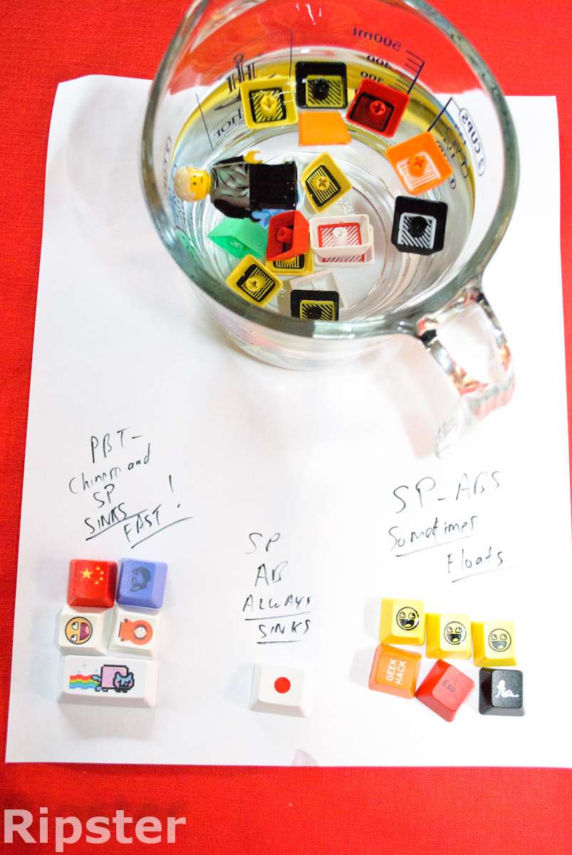

Actually the GAPS is key to this clue. I got MOST of them to sink to the bottom eventually.
GUESS HOW!
itlnstln
01 Jun 2012, 18:08
Soap.
ripster
01 Jun 2012, 18:21
You know I might try some of that dishwasher stuff but I'll take a pic showing what I did.
Clue: It's in the Sundries Aisle next to Straws usually. Might be a GAP.

ripster
01 Jun 2012, 19:47
PBT keys have those too. I call them PBT dimples.
No guesses why some ABS keys float some don't?
The ones that do and don't are identical.

I'm saying in the pic one Awesome key floats and the other identical one does not. At least I think they are identical. One may have a fat lip.
Why?

I think the sink/not sing thing is because there are some little air bubbles on some keys, so they don't sink. When cleaning key caps I have this all the time. This should really be researched one day. When you come back, we might call you Dr. Ripster.
