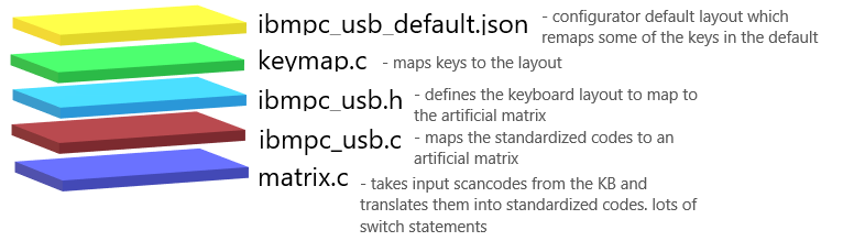

I was able to use marfrit's QMK port of the original IBMPC_USB firmware from hasu with VIA as a GIU configurator. (that was a mouthfull)
I was still only able to build the firmware for the at90usb1286 (Teensy 2.0++). It was too large for the atmega32u4 (Teensy 2.0 / promicro). Maybe there is a way to shrink it through settings, but I don't know how.
Let me know if you're interested and I can probably boil down some instructions to get you up and running with that.
Based on that exercise, I'm confident now that it would be possible to do the same with your Colossus board that uses at90usb1286 and again use VIA as a configurator. I can *probably* help with that work as well.
Or if you're not interested in either, I won't be offended. It was fun to learn some new things.
Here's a video of the live configurator in action. Don't make fun of my keyboard, it was the only one I could find.
Note: There's a caveat in marfrit's github fork that the port would need to be extended to support other code sets, but it seemed to work fine with my XT compatible Laser keyboard without any issues:
It supports PS/2 Scan Code Set 2 (as of now) and runs on USB AVR chips.

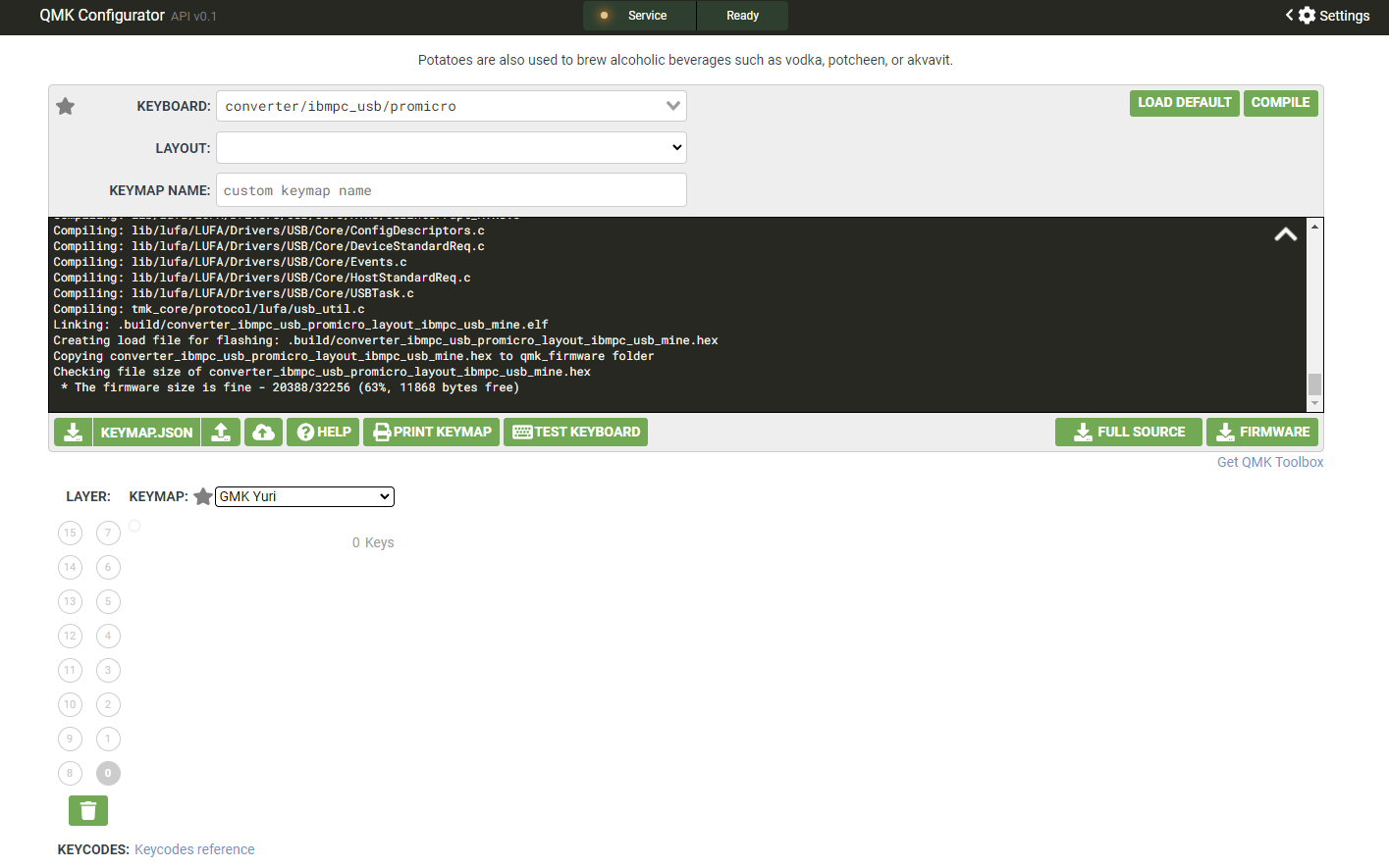

snacksthecat
19 Aug 2022, 05:28

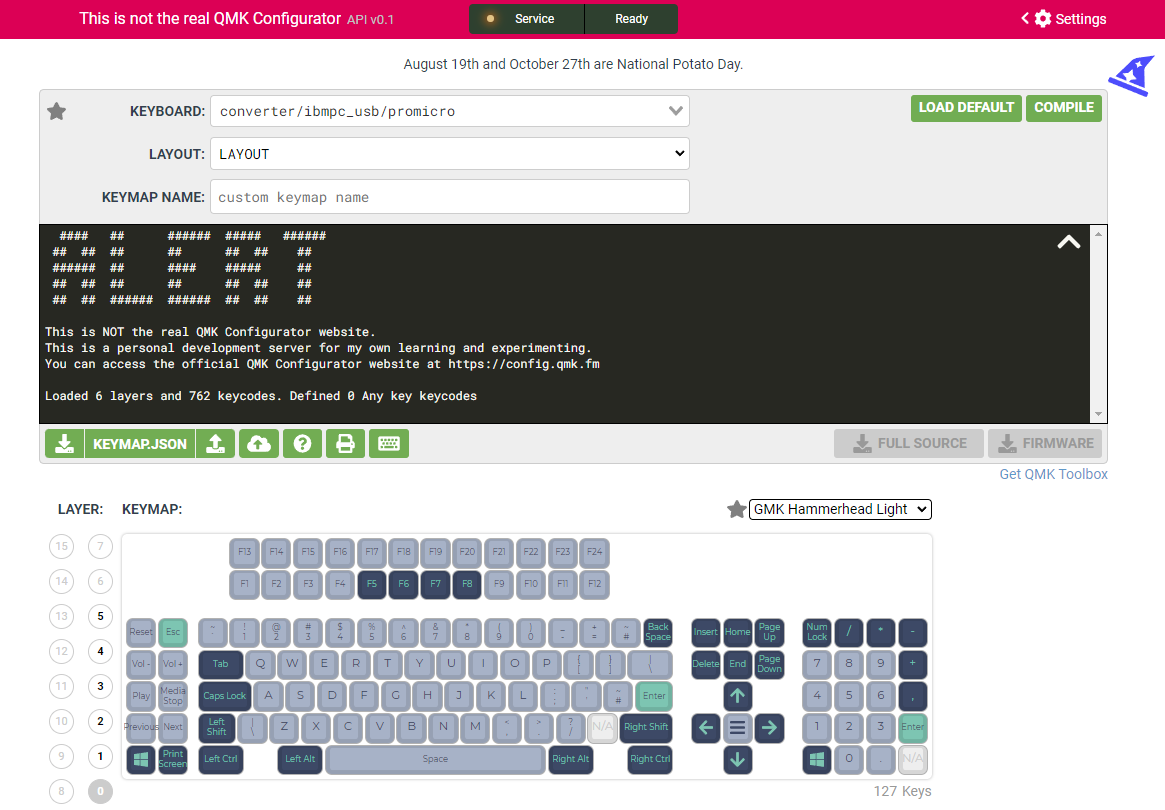

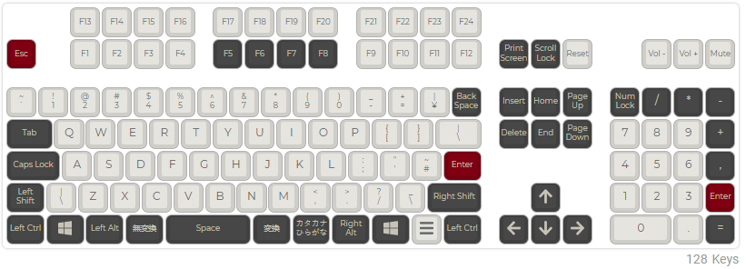

I'm happy to report that I finally got the layout to load in the configurator.
So in terms of checklist items we've:
[x] Brought a dev configurator instance online
[x] Added the ported converter to the list of keyboards
[x] Made it compile a hex successfully
[x] Added a default 127 key layout for the converter
[ ] Tested the hex on an actual keyboard
[ ] Identified which features it can/can't support
[ ] Confirm or add support for XT protocol (not sure if XT or terminal are needed since they're already covered separately)
[ ] Whatever legwork is involved in getting it added to the official configurator
Anyways, here's a screenshot of what it looks like in the configurator. I'm pretty sure there's a simple way of overriding the labels on the funky keys that didn't render ones. You've got no idea how much time I've sunk into getting this far and how happy I was to see it finally working end to end.

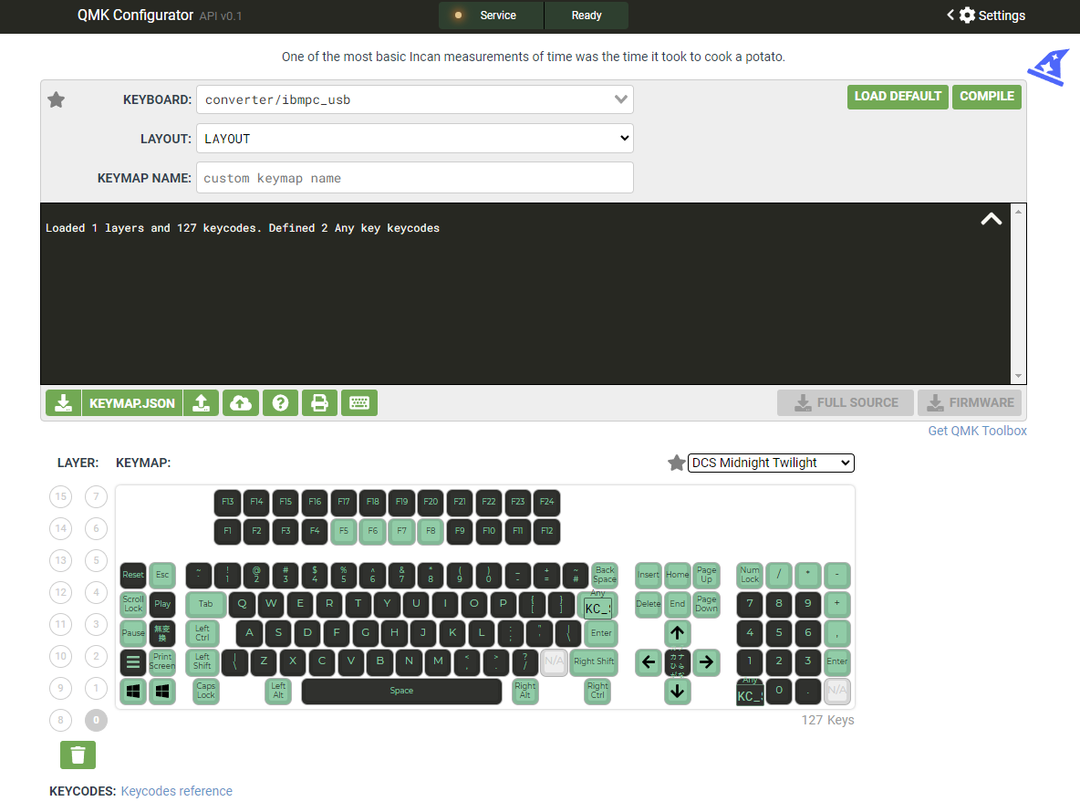

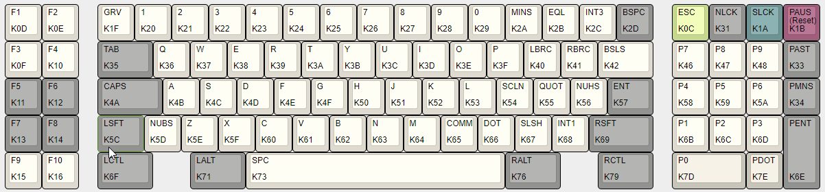

I revised a few things and think I've now got this in a place where I'm ready to share it out.
  • Added what I consider a sane default layout that should be a good starting place for remapping things
  • Setup for 6 layers (default keymap only has the 1st layer defined)
  • Added support for compiling for either teensy or promicro
  • Did some cursory testing on IBM Model F AT and XT keyboards as well as an AT Filco board
I'd be interested in getting some feedback and input if anyone out there is willing to do some testing. I threw some alerts on the page to make it clear that it's not the actual official configurator site. Any input would be appreciated, but in particular would be suggestions on preset layouts (including layers), reporting any issues, compatibility, etc.
A few notes:
  • The converter wiring is the same as Hasu's IBMPC_USB and Soarer's converters (Data: PD0, Clock: PD1)
  • Reset is PB6 or PB7 (though I'm not sure if it's supported). Only needed for certain XT boards.
  • When you click "download" you'll get a popup saying that you're navigating away from the site with unsaved changes. You can ignore this message as it doesn't actually take you away from the site, just downloads the file like you'd expect.
  • I'm not sure if the two unassigned keys can be mapped to anything or not. I don't have a keyboard to test those with.
So anyone who'd like to test it out, let me know what you think and your suggestions. I'll leave the site up and running for the next few days. Here's the link:
(Removed)
20 Aug 2022, 11:38
Okay, cool, feedback time. ;)
Giving your editor a whirl just now. Where is the Print + Scroll + Pause cluster? I'd seriously suggest throwing out the 122 key template for a standard regular full-size keyboard, certainly as the default. There's so many more boards out there like this NMB I'm typing on just now than 122s.
Also: it's vitally important to remember the Reset command (found in the Quantum tab) on every layout you ever flash to a keyboard, so you don't lock out DFU mode. Put it somewhere on the default layout. Pandrew has it, tucked away on layer 2, requiring Fn + Space + R to trigger the bootloader. That's why I want those back right corner keys: I noticed your layout doesn't have it, then I went to put Reset right on the base layer so I have an exit hatch!
Without the Reset key anywhere on the board, you're forced to open up the keyboard to reset the 32u4 to ever put another layout or firmware on it. The Teensy's little button is better than a Pro Micro, obviously, but vintage cases often need cramped placement and so even resetting this board is awkward. I've done just that a bunch recently as TMK's "Magic" keys never did work with it. 7 screws on the back, 2 on the plate, then get out a narrow screwdriver to go jabbing at that little button once again… Or just run scboot if it's on Soarer! :P
Don't rely on Shift + Shift + B or Pause/Break. They're unreliable on home built or repurposed Soarer converters, I find. (The only place I've found "Magic" to be reliable is Hasu's own hardware in my HHKBs. The irony being they have an easily pressed reset button on the back anyway.)
snacksthecat
20 Aug 2022, 17:59
Good suggestions. I think probably when this was made the original goal was to express all 127 keycodes to offer the most flexibility for remapping every key. I can see how having alternative layouts that more closely match a variety of keyboards would be useful.
In that regard, would it make sense to include F13-F24 in each of the layouts or would that be annoying? Similarly, would it make sense to keep "blending" ANSI/ISO layouts into one or create separate layouts for each?
Since it's a "converter" firmware that's not tied to any specific keyboard, it's a balancing act of giving people all the options without cluttering things with extra keys.
Are there any specific layouts that I should try to reproduce?
Where would be a good place to include a Reset key in the default keymap?
Edit: Now that I think about it, probably makes the most sense to stay true to the original and try to reproduse Hasu’s original layouts and keymaps.

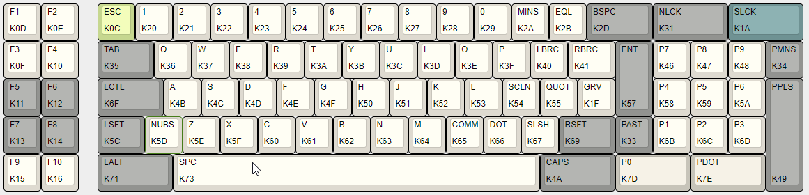

[ Full-key | 83-key XT | 84-key AT | 122-key Terminal ]
That ensures that the input scancodes are all supported and also serves as a good baseline in terms of layout variety.
His layout editor includes extra/repeated keys in other positions with instructions to ignore them if they don’t apply. Based on how QMK configurator works, I’ll probably have to take a more rigid approach, which may not be a terrible thing. So more like a variation on what he’s doing but in the spirit of it.

snacksthecat
21 Aug 2022, 02:09

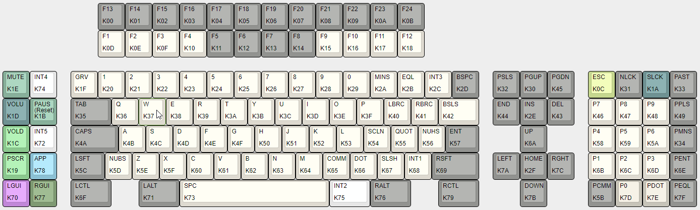

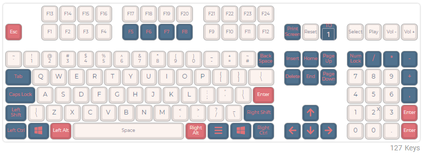

Eh, I hear what you're saying but I think it's worth having a "full" layout that has all or close to all of the possible keys.
I'm experimenting with this layout:
My thinking:
  • It makes sense to have a default layout with all of the ANSI/ISO key placements, since you can only have 1 default layout per keyboard. Any additional layouts beyond the default populate as all blank when selected. This was a disappointing discovery for me.
  • Similarly, I think the additional F row is good to have, even if it's just ignored. It doesn't hurt and can remove a significant limitation for the user. They can be ignored if not needed.
  • I agree that the 122 key layout is more of an edge case so doesn't make sense as the default.
  • Added a reset button where you suggested.
  • The media keys above the numpad are probably confusing on the default layout, since it's not clear what input scancodes those would map to. So I'll probably remove those from the default.
  • At this point it's also a bit unclear to me how to create a configurator-compatible layout that doesn't include all of the keys. Might just be missing something simple though.
21 Aug 2022, 11:40
That’s much more like it! A second function row to f24 isn’t going to confuse anyone.
I’d just flip around the right Windows and Menu keys, as they’re never that way around on the few modern boards I have with them.

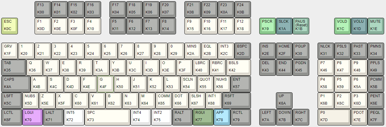

snacksthecat
22 Aug 2022, 00:46
Thanks again for the input, very helpful stuff.
I made some additional adjustments to the "standard" layout and I'm pretty happy with it. I have a few questions though.
What key is typically found next to the 1.75 right shift and in the bottom right corner of the numpad? Those were unassigned in the ported converter so I wasn't sure if they map to anything.
Also, would be interested in feedback if anyone wants to try mapping a layout and testing it on a keyboard. I've tested on an AT board and everything is working as expected, but I don't have a keyboard to test the circled keys on.
I'll drop the link again for anyone who's willing to help:
(Removed)

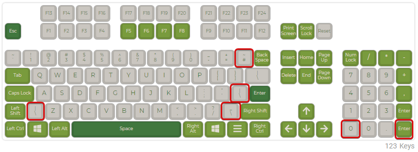

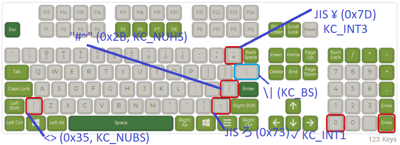

22 Aug 2022, 01:09
Those circled keys should Just Work™ but yes it’s always good to check. I’m embarrassingly short of ISO keyboards to test it myself, however, for someone who lives in that part of the world.
The reason for those split keys is of course the major national hardware layouts. Spot the splits:
ANSI:
ISO:
JIS:
Individual (non nutty modern custom) keyboards don’t have all those keys split out separately. But they must all be supported, as all three layouts live out there. Hasu supports this in Unimap by simply being repetitive in his default layouts, with the instruction to ignore keys you don’t have. That’s pretty much all you can do. Populate them but don’t be too picky, especially with that kana key I see you’ve put on JIS split Shift! Just leave it \ or some other placeholder. Brazil also splits that key out, as I recall, and maybe others.

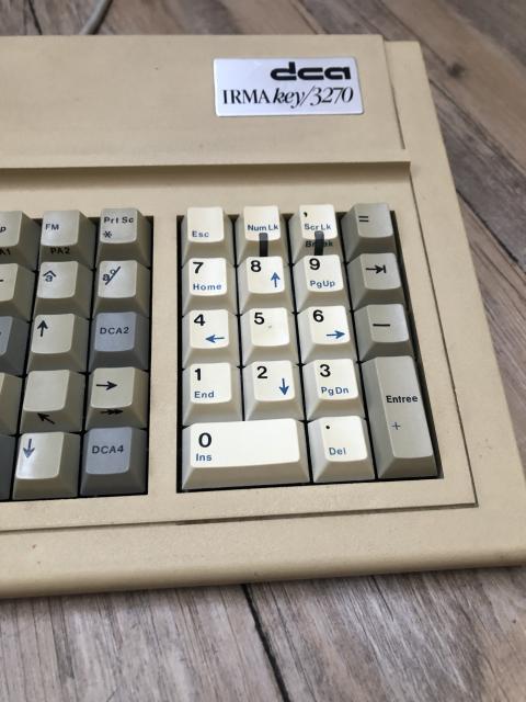

22 Aug 2022, 01:17

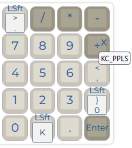

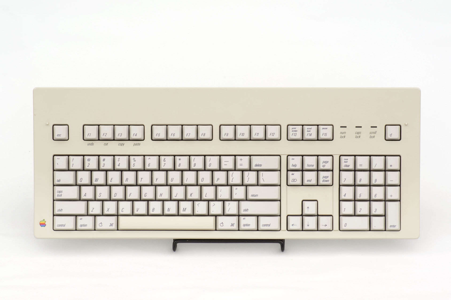

As for numpads, there’s plenty of silly buggers going on there on vintage keyboards.
Behold the Apple Extended Keyboard. On first glance its PC homage layout is quite unremarkable, right down to the Num and Scroll lock lights which DON’T EVEN WORK ON THE MAC WHAT WERE THEY THINKING. But then look at the numpad. Whut? They went to all that cloning effort but just couldn’t stop themselves from goofing around there!?
Even IBM wasn’t always quite sure what to do over there besides the numerics:
22 Aug 2022, 01:30
snacksthecat wrote: 22 Aug 2022, 00:46 Thanks again for the input, very helpful stuff.
If I may:
Some annotations.
Some annotations.
You got the key between /? and RShift right. The one between =+ and Backspace should be JIS ¥.
The one between LShift and Z should be correct (as long as you got the "correct" \| key: KC_NUBS, not KC_BS).
As for the extra keys in the numpad, I'm afraid there isn't really a consensus, and each user will have wildly different ideas. What I have on my F107 (with a 20 key numpad) is:
My numpad on the F107.
Note that I am not using P, and P= as Windows ignores them, and instead I must send the comma from the alpha block and Shift-0 (where the = character is in my national layout). Shift-. produces the colon, which goes where Num Lock normally goes. For the extra key produced by the split numpad0, I produce an uppercase K, which makes sense for my usage case (a C programmer dealing with lots of hex numbers could make it into a lowercase x instead).
I have a fullsize Model M which a 20-key numpad. Once I get a converter that can run TMK or QMK for it, I'll be happy to test this.
22 Aug 2022, 14:48
Re: whacky numpads, Cherry says hold my beer.
I quite like this one. Integrated lock lights are so much classier than a big dumb window, removed from their function. Num and Scroll Lock are both numpad specific modes, so really should be in there.
From a converter's perspective: there's a whole wee world of variety over in the numpad! :lol:
22 Aug 2022, 15:03
Muirium wrote: 22 Aug 2022, 14:48 Re: whacky numpads, Cherry says hold my beer.
Not that different from the assignments on an IBM numpad on a terminal keyboard.
That said, how to make a proper numpad designed for "modern sensibilities" is a subject worthy of its own thread. ;)

It's quite complicated what is happening with the firmware code. Here is an explanation of what each file is doing (as I understand it):
I think that Hasu's unimap concept simplifies things by creating a more streamlined abstraction between the bottom 3 layers, which is probably the point of it.
It's not jumping out at me where the breakdown is happening. Positions in the virtual matrix don't seem to match up with the codes that they should translate to. They obviously do, but it's not in a way that I can currently understand. I'll need to study both projects more until this makes sense to me, but for now some of those circled keys may not work. Everything else seems to function great, though.

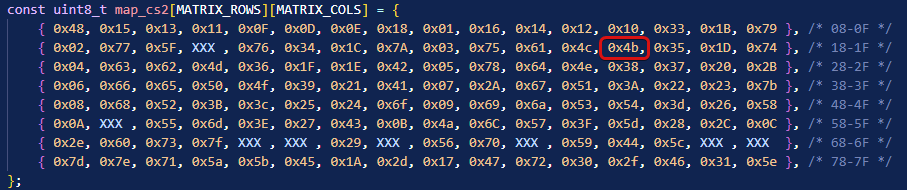

I originally posted the comment below asking what I see now is a very obvious question, but the answer slapped me across the face...
Maybe someone here is able to help me connect whatever dots I'm missing.
I added a line to the matrix.c file to print out some debug information when a key is pressed on the keyboard (code set 2).
As an example, when I press "a" on the keyboard, I get this output in the console:
> Code: 0x1C Row: 1 Col: 12 Map: 0x4B
0x1C is the code set 2 scan code for the "a" key. I understand that much.
row 1 and column 12 are positions on the artificial matrix defined in ibmpc_usb.c. Those are found by passing the code through these functions:
#define ROW(code)      ((code>>4)&0x07)
#define COL(code)      (code&0x0F)
Finally in the print is the code 0x4B that is found in that row/column combination in the artificial matrix. That is found through this function:
newcode = map_cs2[ROW(code)][COL(code)];

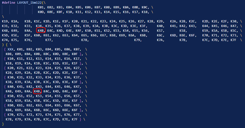

This is the artificial matrix itself:
And I'm not sure if it's relevant but here is the layout definition, where I've circled the "a" key:
So my question is: what is the meaning of 0x4B?
Duh, it's the corresponding key in the keymap. :lol:

Now that I understand how the firmware code works, I created a common layout that is very similar to in Hasu's. Since I completely remapped the matrix to cleanly align with this layout, XT and terminal protocols definitely will not work. I will repeat the same remapping exercise once I nail down AT/PS2. Let me know what you think of this layout. I think everything is where it should be.
25 Aug 2022, 22:57
I’d test it with ISO (which would expose the split left Shift) but no amount of rummaging will conjure forth my trusty old AT to PS/2 cable. Only got one lonesome ISO keyboard to try with this, and it’s the wrong plug!
Anyway, it looks good. :D

Update on progress I've made.
I mapped out the matrix for XT and Terminal, so that covers all 3 protocols that the original firmware supports.
After that I've been working on a few alternate layouts, since the default may not be practical for remapping certain keyboards. I was wondering if anyone could help by peer reviewing these. For each of them I can only have a max of 128 keys in the layout (size of matrix). As far as I can tell it's not possible to repeat a key in the layout to support keyboard variations where certain keys are found in different positions.
Full key - Link
This is what I've shown so far as a "universal" layout. Including just for reference.
IBM XT 83 key - Link
Uncertain about if some of those international keys actually appear on any of the keyboard variations and if any missing ones should be added. Numpad could use a review as well in the same way.
IBM AT 84 key - Link
Same questions as XT layout.
IBM Terminal 122 key - Link
This is somewhat of a mashup that I derived referencing Hasu's keymap editor and photos of keyboards. He supports the Cherry G80-2551 terminal keyboard in his editor by repeating some of the keys, but I'm not able to do the same thing in QMK configurator, so that would require a separate layout which is probably overkill and this one can be good enough for most cases.
Thanks again!
snacksthecat
27 Aug 2022, 19:32
Added these new layouts to my rogue configurator. As I mentioned earlier, one limitation of QMK configurator is that you can only have 1 default keymap per keyboard. So as soon as you switch off of the default, the new layout loads with all blank keys. Maybe there's a way to restructure the project so that these layouts each fall under separate "keyboards" that all depend on the same converter code but I'm not enough of a QMK ninja to know if that's possible. Anyways, now in the layouts dropdown you should see 4 options: fullkey, xt83, at84, and terminal.
I've attached the json files that can be uploaded to populate the non-default layout with the keymaps as their shown in the screenshots from my last post.
Still doesn't look like anyone's tried building a firmware outside of my own testing. Dropping the link again in hopes someone is willing to try out the firmware.
Link:
