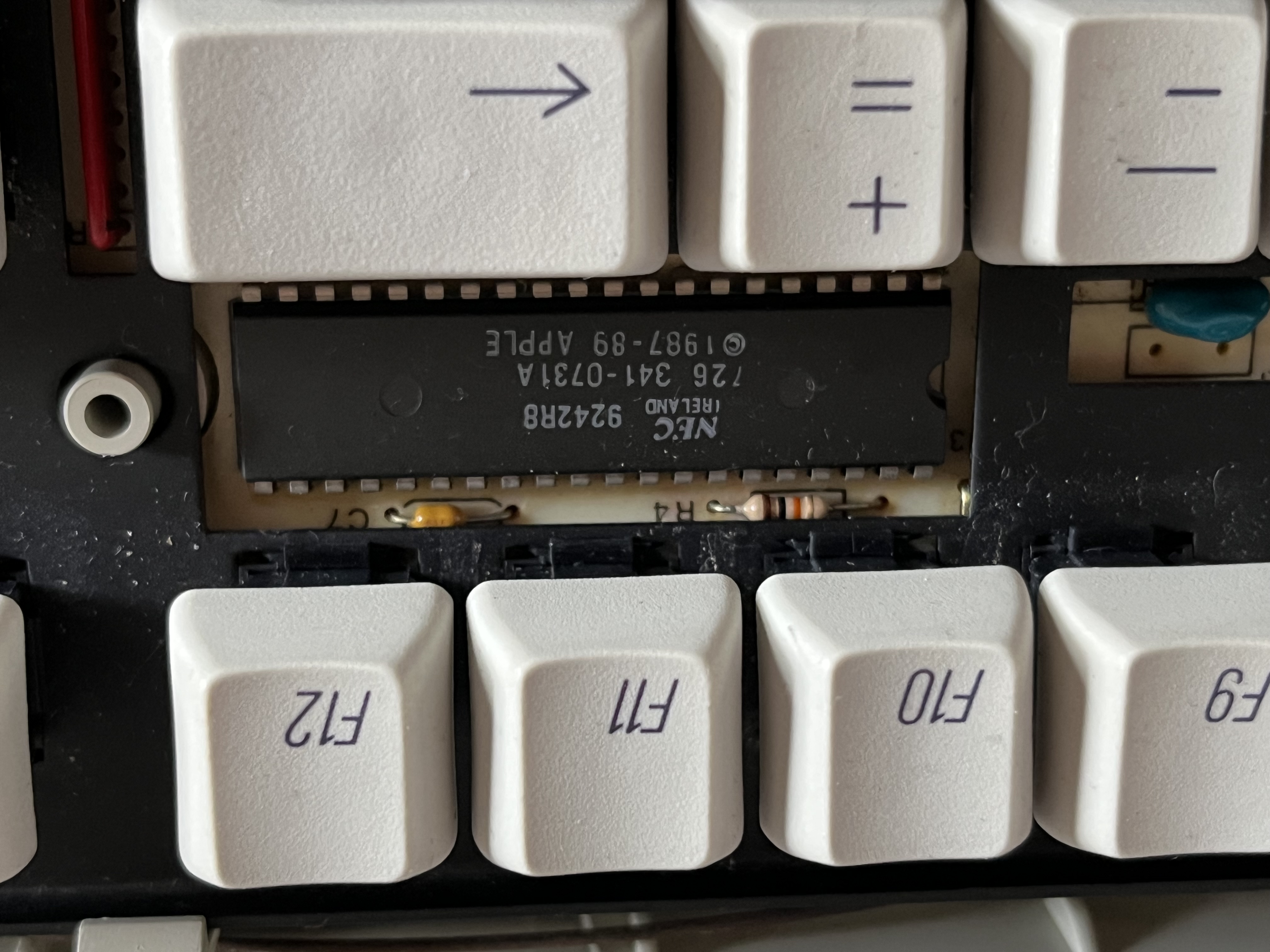

I'm not sure why you'd want to use a teensy, the 32u4 it has is quite slow and only has a measly 2.5k of ram. quite unfit for a keyboard controller! I suppose you could bit-bang a clock-divided (7/16ths) bus speed dual-duplex serial port on an stm32 though that could potentially bottleneck the internal ram channel. with optimized firmware it's very likely to be far more efficient than qmk (or, as I like to call it, "poo mk") and use less than 100 BITES of ram, or one "glizzy" as some modern compsci students have taken to calling it. I suggest downloading a recent textbook and giving it a read, it could provide some fascinating information!
kelvinhall05
24 Jul 2022, 14:38
by the way, you could also try rewriting the original firmware on the original controller. assembly is not that hard, you can just watch a 12 minute and 33 second youtube video and it'll tell you all you need to know. for reference, here's the instruction set for the intel 8051, a derivative of which is probably used in the aek:

The AEK II uses this NEC chip that appears to be custom for Apple, I imagine it's probably quite similar to other NEC keyboard controller chips though (which IIRC are based on Intel ones)

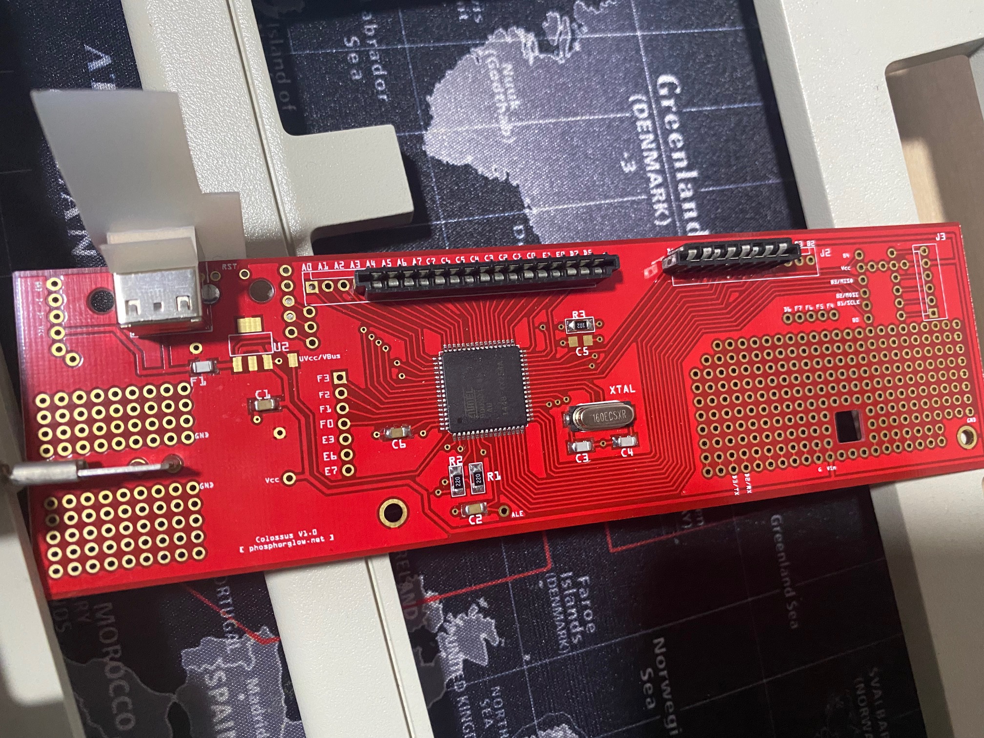

I shouldn’t have confused things with the AEK pic. I picked that photo for the line of Teensy converters I’d just made, lined up on top of it, but it’s gotten the topic crossed. :P
What I’m talking about is an AT / PS/2 converter for my many non-Apple keyboards. Straight up Soarer’s Converter equivalent in QMK?
The AEK is already a QMK target. That’s a solved problem. What I’m scratching my head about is where is the AT converter target for QMK configurator? Has no one tried something this obvious before? I hope so. Because if it lands on me to do it, I’ll fuck it up. :lol:

Thanks for your attempted assistance, Snacks. I know how you feel. This layer-cake upon layer-cake is a bit much for me, too. :lol:
snacksthecat wrote: 30 Jul 2022, 21:38 I know you already have an arsenal of teensy built converters so the idea of using a different dev board is probably a turn off for you.
Correct. But I do have another keyboard which may be better suited to your line of attack. How about running a QMK controller on one of these?
Not a Teensy but a Colossus by Phosphorglow. (A long unsupported and quite forgotten drop-in USB replacement controller for IBM Model Ms.) I have one in my good SSK, which I've been running Soarer's Controller on for many years. I believe it's an Atmel AT90USB1286 rather than the Teensy 2's 32u4. Soarer has firmwares for both.
As Colossus is a controller, it drives the Model M matrix directly. Phosphorglow has matrix maps (and pin assignments) on his website. The relevant one being this:
Now, I'm such a QMK rube (beyond Pandrew on Xwhatsit hardware) that I don't even know how to assign controller pins and such. Searching the supported keyboard list on QMK Configurator brings up this similar controller for Model Ms but it runs on the STM32 MCU which is completely different silicon as I understand. If you know your way around QMK well enough now, I'd like to run that (or comparable) on my Colossus! Bonus points if it's Configurator friendly! ;)
If there's already support for Colossus on mainline QMK Configurator, tell me all about it. That'd be ideal!
