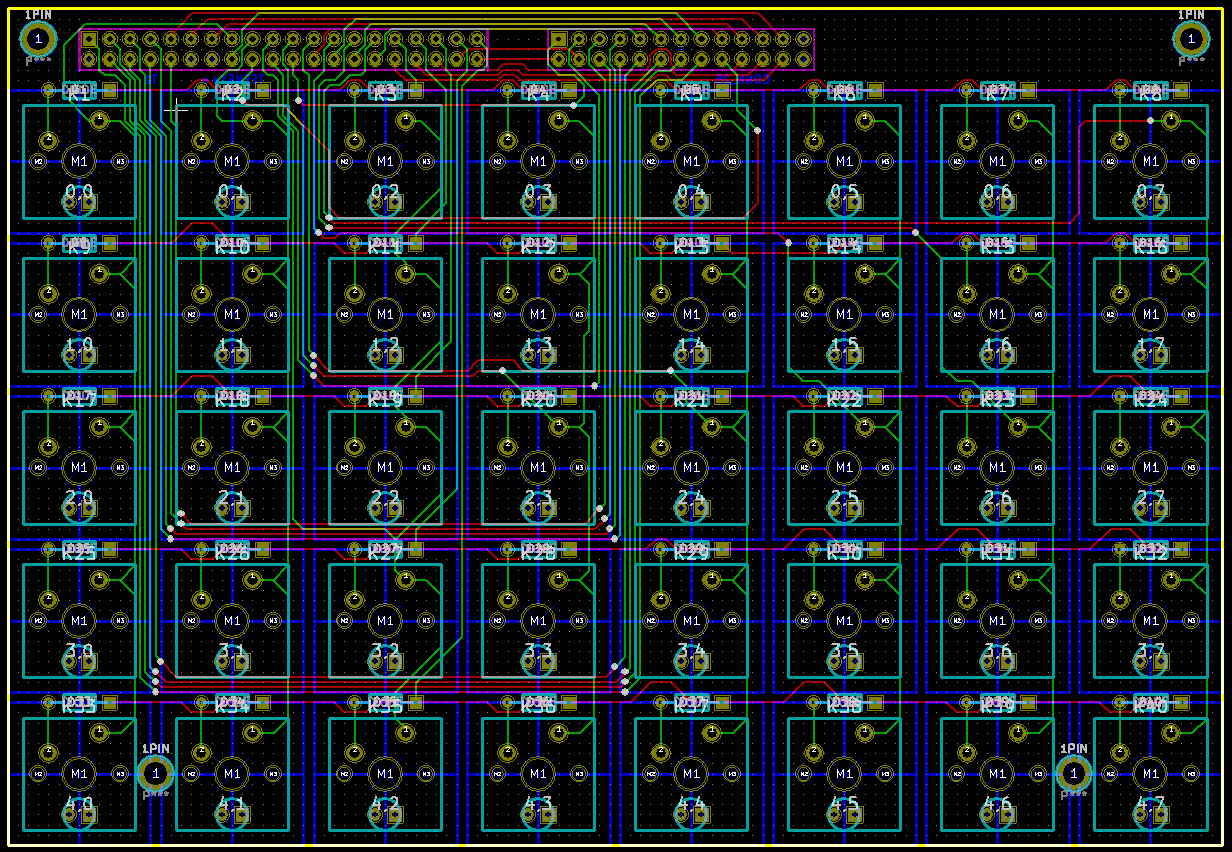

Minskleip
04 Oct 2011, 14:57
Bought PCBs :D Check first post.

Minskleip
04 Oct 2011, 17:26
$120 + shipping. Most of that was tooling actually. Not very much, but not that little either considering how simple the design is.
cactux
22 Oct 2011, 11:38
Minskleip
22 Oct 2011, 20:40
I think the PCB is 1.6 mm and the requirement is 1.52 +/- 0.152 mm ;)

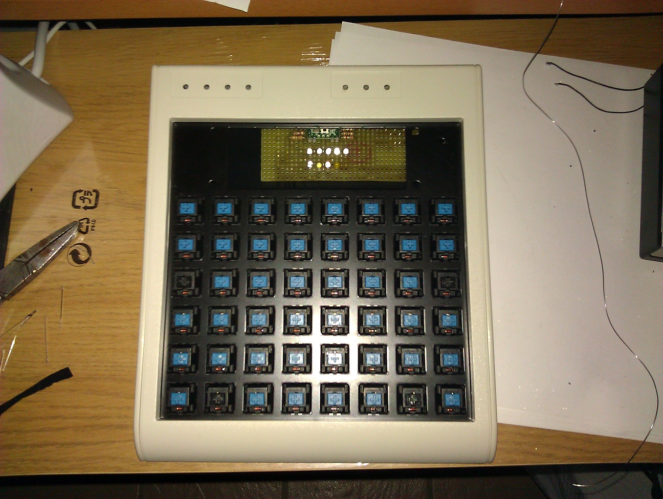

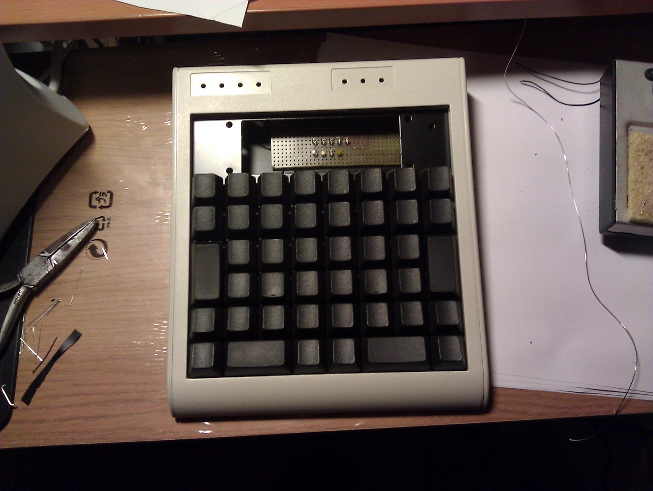

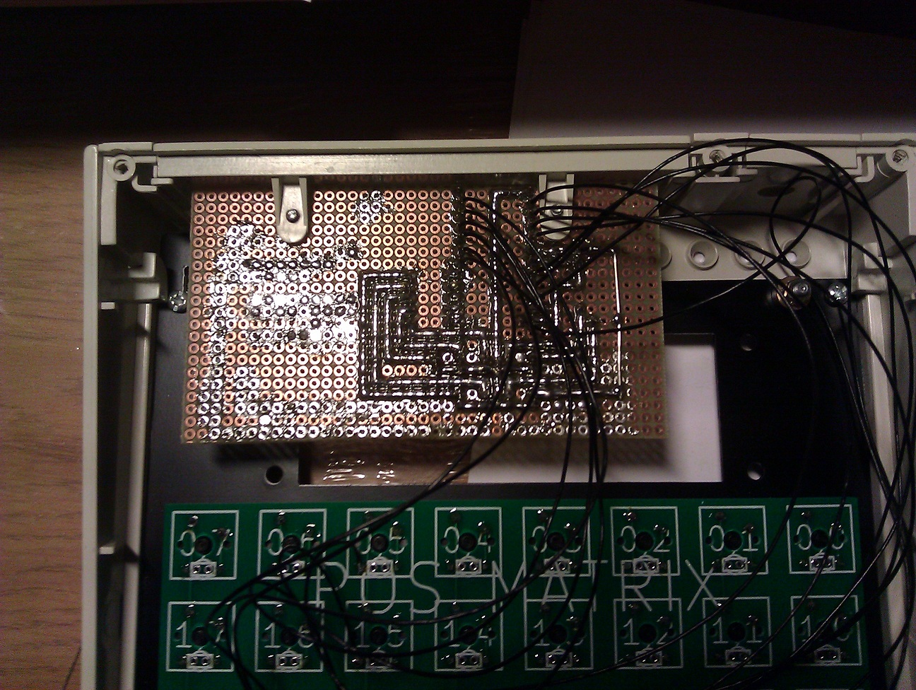

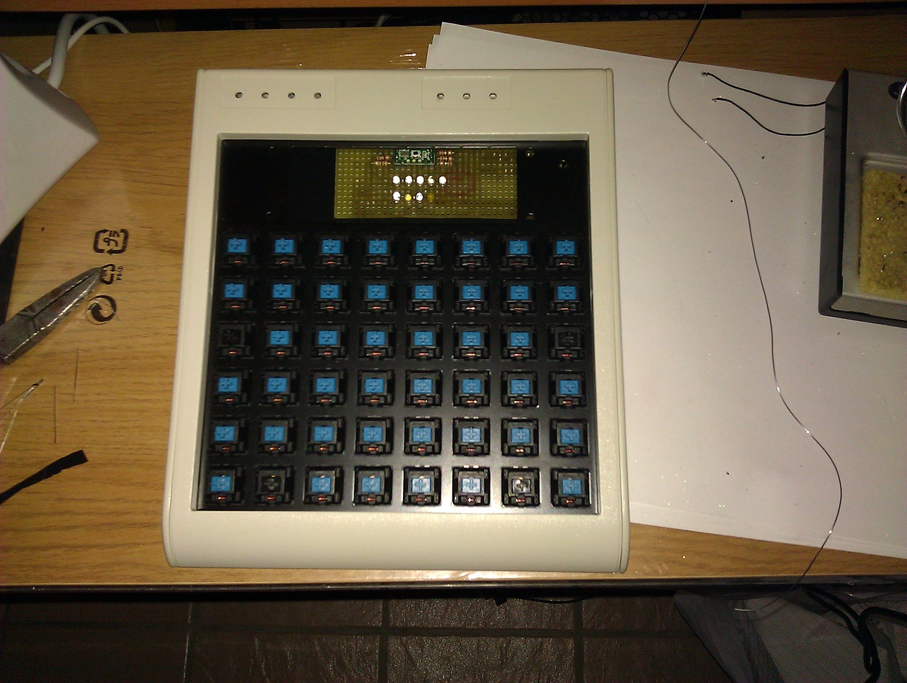

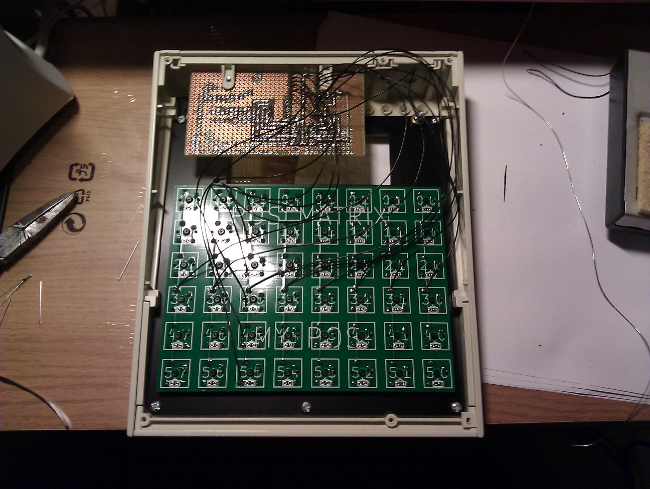

Update and update :oops: It's of course not cancelled because I have all these PCBs. I started soldering switches, LEDs and diodes and made a base for (on half) of the case, but it will look so crap (and the thought of soldering all those LEDs with wires is very off putting) I've put that part aside for now. I got two (twice the size!) Tipros from Ebay, and one smaller Tipro from here which I'll replace the internals of with my PCBs. It's a big job desoldering all the switches though, so I've started with the small Tipro. It's finished and have been laying here for a few months just waiting to be programmed... I'm about to start desoldering the larger Tipros.
One of the reasons for being so slow in addition to the interest going up and down is that I've got these awesome "black 122 key Tipros" from 7bit which are much better than regular keyboards.
Minskleip
09 Apr 2012, 23:16
Here are a few pictures of the small Tipro, with my PCBs! Blue stems, black springs. I intent to program it as a one-handed keyboard.

off
10 Apr 2012, 02:37
Yay update!
Blues with black springs? How's that feel to you? What I think I've heard is that it takes away quite a bit of the tactility; though faster return to top is ofc welcome..
.....Are you planning to put an lcd there?
Minskleip
10 Apr 2012, 11:14
I've only prodded them a bit, but I think they're still too tactile. Clear springs would be better.
The unit came with an LCD but I don't know how to use it with the Teensy so I'll just leave the space open (covered with acryl) and have status LEDs.
