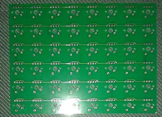

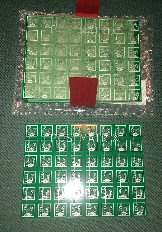

I redesigned it and made it even more minimal! Now the PCB is just a grid. The Teensy will be soldered to a perfboard which will be bolted to the PCB. The rows and columns will be connected to the perfboard with wires. This makes it possible to cut up a PCB to add additional rows or columns! (trick/hack for keeping the cost low and increasing the hackability).
And I've bought PCBs :D Got 10 in the mail this morning!
Top:
Bottom:
They got bumped in the mail and has a slight impurity in one of the corners, but otherwise perfect. The switches fit perfectly!

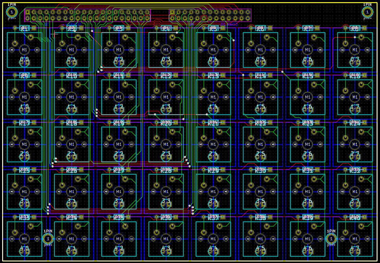

Made some progress with the PCB, and I've got the Teensy. Will do some cleanup and order a few copies of the PCB.
I simplified the layout so that the same PCB can be used for both hands. To do this the Teensy will be connected with wires, and the cable ports have to be connected to the PCB with wires too.

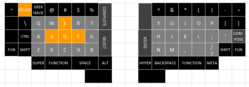

Layout
The physical layout will be something like the following. It's highly inspired by dwm's Humble Hacker Keyboard, but will only have single and double spaced keys. I'll try to use some of the top row double spaced keys in vertical position for enter etc, but I won't know if that works before I get the them or create key keyboard.
Some points:
  • Grid layout.
  • Split/hand separation.
  • PCB mounted switches.
  • Easily accessible function keys for selecting different layers.
  • Number row is the other way around ("shifted" by default)
  • Would be cool to have a Num key for easy numbering.
  • Backspace/del under right thumb.
  • Compose key (as far as it's possible under Windows).
  • COMPOSE is Alt Gr. Use http://allchars.zwolnet.com/ to make compose work.
  • COMPLETE is TAB or a shortcut for a "complete" task in Emacs or something
  • SELECT enables shift lock and virtual arrows and makes ENTER copy. ESC or SELECT terminates. (This is like entering Copy Mode in Tmux)
  • FUN + SHIFT is shift lock or caps lock?
  • Suggestions for the two bottom most keys? Macros perhaps.
Layout made in Excel:
Dark grey keys indicate that the profile is wrong the the row.

PCB
Next step is to design the PCB.
First revision!

sixty
Gasbag Guru
01 Feb 2011, 19:16
Interesting layout. The space would not work out for me, since I use both hands to hit space, depending on the words. Did you verify that you indeed only use your left hand for space? Or will you just try to learn to just use your left hand? I'm curious.
Minskleip
01 Feb 2011, 19:24
Yes, I've never used right thumb for space. It'll be a bit strange to use it for backspace in the beginning, but since it's already there in the position, I might as well use it.
I do use right shift depending on the words, but I've never used the right ctrl or windows keys.
sixty
Gasbag Guru
02 Feb 2011, 16:57
Also forgot entirely.. I still have a bunch of stabilizers left. How many do you need? If you keep your current design I think you will need 8.

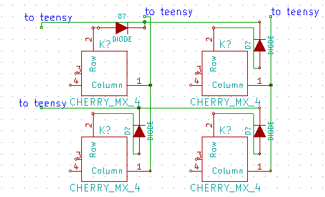

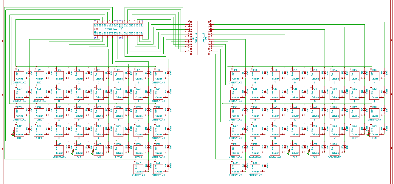

I've learned enough of Kicad that I've started designing the PCB.
Any suggestions or pointers? Are the diods the wrong way, traces too long, silly use of the Teensy for instance?

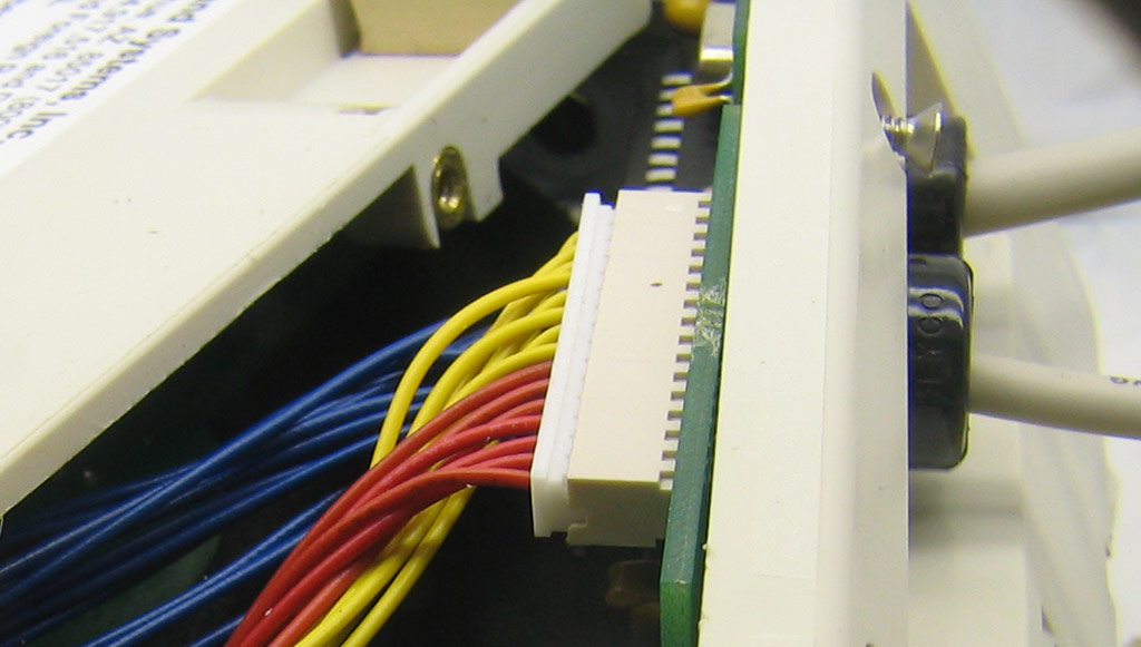

Thank you! I got inspired by μTRON too. Hopefully I don't have to include extra components to compensate for the length of the ribbon cable connecting the hands.
intealls
15 Feb 2011, 00:50
Looks great. I had some trouble getting D6 to work, it just made the LED on the Teensy act up. I don't know if the code is to blame or if I misconfigured something. In the end I just used a different pin. This was with dmw's HH firmware when hacking up an AEK II. Compiles beautifully (on Linux) and does pretty much everything one could want. Stable too, can't recommend it enough.
15 Feb 2011, 00:55
I'd convert that ribbon to a data cable when it comes out of the case. Ribbons break.

Webwit: do you mean to make it round?

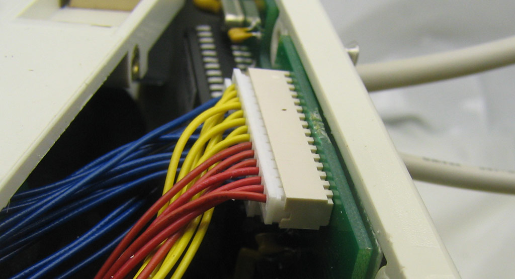

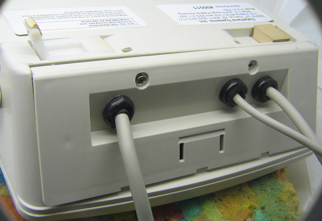

15 Feb 2011, 01:12
Yeah, like the DataHand keyboard as seen here goes to DB15. I actually had to buy an extension cable for in between when I chair mounted it, so I could lead the cable underneath the chair. Ideally it would have a DB15 connector here on the outside, it has that on the other hand (which connects to this hand with a detachable DB15 cable).
Ribbon cable reminds me of the Fingerworks Touchstream. There are two versions. The only below is fixed in its frame. The newer version you could take out of the metal frame, so you could place it over your laptop for example. Those had a lot of problems with broken ribbon cables.

noctua
15 Feb 2011, 21:46
Minskleip: you have to revise your pcb-layout, the connection in series of diodes is wrong!
Take a look at Keyboard Matrix Help, i'm sure you find quickly the solution how to fix this..
Minskleip
15 Feb 2011, 23:44
noctua wrote:Minskleip: you have to revise your pcb-layout, the connection in series of diodes is wrong!
Oh, yes, I can see that they're parallell now. I'll see if I can figure out the right way and update. I even looked at the webpage you link too before connecting them in series :oops:
Thanks for pointing it out!
Edit: I found a solution!
Now I have something to do tomorrow he he.
noctua
16 Feb 2011, 08:32
Yes, looks much better, this snippet will work (rows are low-driven, very well)!

kidchunks
17 Feb 2011, 17:57
Nice diagram Minskleip, I too had issues with were the diode should go despite reading the matrix documentation a few times. All solved now!
Question which diodes you plan on using? I figure the 1N4148, but I've seen a few with different current ratings and voltage ratings.
Minskleip
17 Feb 2011, 18:13
Thanks! I'm thinking 1N4148 too, but I haven't looked into that aspect yet. If the different diodes we could use have the same footprint, it's one of the last decisions to make :)
noctua
17 Feb 2011, 18:58
The 1N4148 diodes are quiet fast and cheap - overkill for an simple matrix - i use these
currently too.. don't forget to activate the internal pullup's
