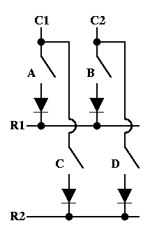

but how to connect a cable to each switch :cry:
Do you have a picture
Welcome to the matrix. Matteo's latest hand wired one.
Instead of separate wires for every key, you make an X-Y grid out of them. Then you only need enough pins on your controller for Rows + Columns instead of Rows * Columns. Makes a lot of difference when dealing with around a hundred switches.
What your controller then sees is something like this.
That's the one Alfa147x is working on for his Filco Minila mod. Filco was lazy and used more columns than necessary, so he's taking the opportunity to optimise his matrix properly!
The only downside to a matrix is that you need diodes to protect against ghosting and masking. You've heard of N key rollover? Diodes are how you achieve that.
Fortunately diodes are cheap and you can use them as some of the wires in the matrix.

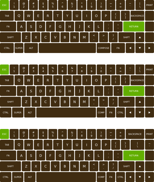

Okay I'm preparing the second episode in the series and I'm trying to find the right layout for the Brownfox (on which will be based the tutorial)
These are some experiments:
I'm really torn between the three (or various combinations of the three). In the last one I could place FN on \| key for example.
Ergonomically speaking the one I like the most is the first one. Aesthetically the third is probably better, but I prefer an usable keyboard to a pretty keyboard.
The three blanks to the right are TBD.
Ideas? Suggestions?
PS: before you ask, yes I need Print, Compose, Super and 2 FN keys (one left one right)

19 May 2013, 12:52
Needs ISO enter and short left shift :D
-[°_°]-
19 May 2013, 13:01
dirge wrote:Needs ISO enter and short left shift :D
miss appropriate caps for that :/

19 May 2013, 15:34
The first layout. Without a doubt. Maybe move right FN to above the right arrow, like HHKB.
Looks like a 6-unit spacebar. Can you buy those standard, or do you have to harvest from an old board?
Also, what's the use of a "compose" key?

19 May 2013, 15:48
prdlm2009 wrote:The first layout. Without a doubt. Maybe move right FN to above the right arrow, like HHKB.
I have 6u spacebars aplenty :) from DSA Retro group buy.
"compose key" is used on linux to make special characters (°ŭĸə¡♯×…), it's a kinda "alt gr"
19 May 2013, 16:46
It is modal like a dead key. http://en.wikipedia.org/wiki/Compose_key
