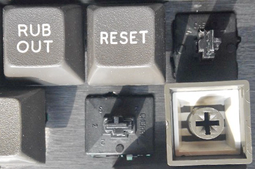

7bit wrote: Ta-Daaa!
Do you have any photos of exactly what came out of that box, especially disassembled?

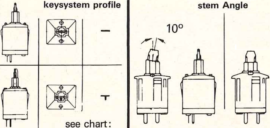

M51-0131 should be tee mount, not cross mount — if what you have definitely is the grey switches that various people have, then it would be fair to officially refer to them as M51-0131. The tee mount in the design drawing may refer to M51-0129, which is given as a previous part number on that sheet.
Oddly, Sandy's new-style switches (with modern branding) have the same hollow rectangular stationary contacts as the grey slider switches — it will take a real genius to figure out M5/6/7.

It seems like the T mount of Cherry M5(Series M7) on Cherry B70-4753 keyboard for Teletypewriter. Is it right?
Series M7 switch.png (294.62 KiB) Viewed 1492 times
