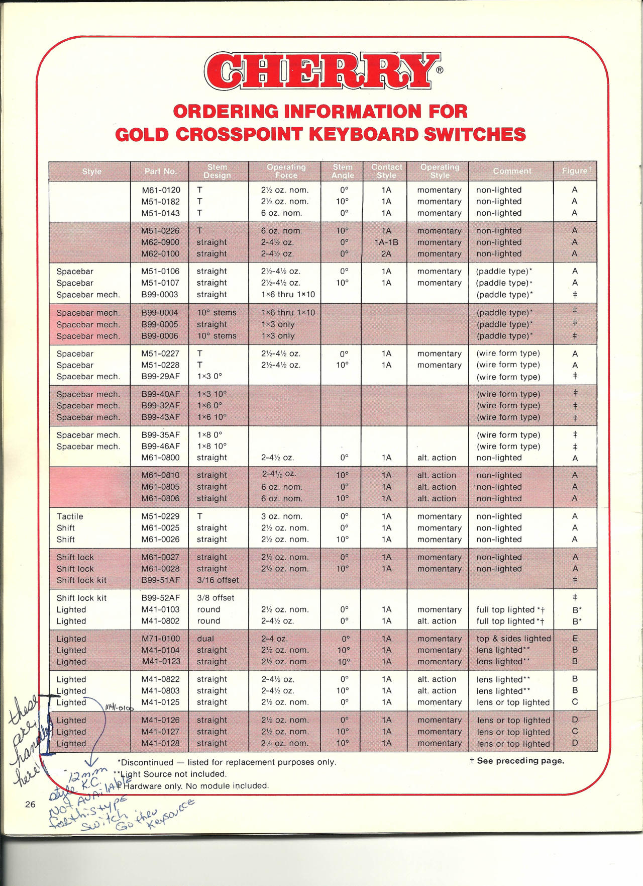

08 Apr 2014, 21:09
It gets worse.
This is from a 1982 catalogue (I don't know which) — apparently M5 is not mentioned anywhere else in that catalogue at all.
Note that now we have M4 as well.
Maybe we should call it the "Cherry M-3/-2/-1/0/1/2/3/4/5/6/7 Series" …
08 Apr 2014, 23:21
OK, so M51 is confirmed. I've added the Burroughs M51-0131 specification drawing to [wiki]Cherry M5[/wiki]. (Many thanks to Ed at ZF US for his digging!)
Ironically, it is also "T" mount: nothing anywhere accounts for the "+" mount of the ones we've ended up with.
I'm now confused about M1, too. The sheet Ed found marked "M11-0101" is dated 1979. However, in terms of part numbers, the introduction of MX saw a change of series ID from 9 to X, e.g. M9 → MX was M93A-11NN, to MX1A-11NN (for example). "M11-0101" should be M1, just as M61 is M6 series, and M71 is M7 series.

09 Apr 2014, 01:22
The picture above is the only page I got — M5 is apparently not mentioned anywhere else in whatever catalogue that is, so it's only able to confirm that the part numbers are officially classified as Cherry keyboard switches of some kind, and that they were on sale in 1982. We don't know why there are switches there that aren't in the Keyboards and Switches catalogue 1982. 1982 was M7/8/9, so this may be a list of products sold only for spare parts, which if true, would prove that M5/6 and M7 are different in some way, even if there is seemingly no evidence to support that.
Officially, M6 and earlier no longer exist, nor does M10 or M11 — this information is all gone from Cherry US and Germany; M7 is the oldest switch on record now in the US. What Ed is turning up seems to all be oddments of information in the US office that, mercifully, isn't lost. I don't know the specifics of the storage and organisation beyond that. That he found a sheet for the same switch you have may be something to do with this being the former Cherry US (Burroughs being American), while the catalogue may be from Germany; yet, it's not the same keycap mount ...
If you check the spec sheet for M51-0131, you'll see that it used to be M51-0129 at one stage. I don't understand enough about draughting to understand the details, which is why I've not cited a year for the specification: there are several, and I don't know which ones correspond to which part numbers, nor what is supposed to have occurred on these dates.
Dual appears to be two sliders straddling a centre LED: see M71 in the 1982 catalogue. (I don't see that design in 1972 or 1973)
It's nothing short of confusing.
