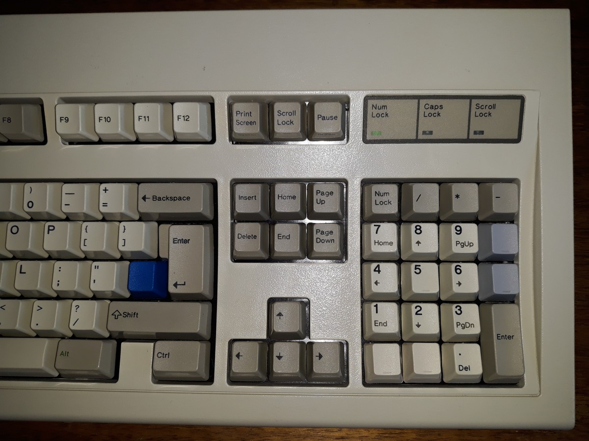

So a while ago, I got a Model M 1391401 keyboard from ClickyKeyboards. I asked him to make a couple modifications: convert it to ISO and expand the numpad to 19 keys, by replacing both numpad0 and numpad+ with two 1U keys on each. This is how it looks like now (the new caps are Unicomp blanks - I'll put better ones later):
Right side of the M104.

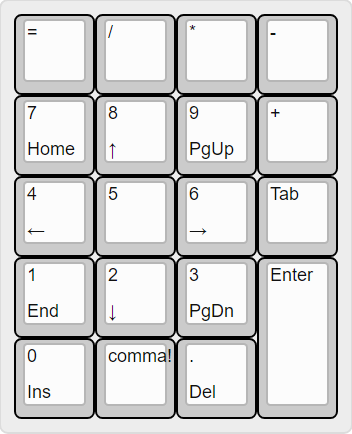

And this is the diagram of the layout I wanted it to have:
19-key numpad.
19-key numpad.
I replaced the regular SDL cable with a SDL-to-USB Soarer's Converter, and this is the .sc file I loaded on it:
# Soarer Converter's configuration for an IBM Model M P/N 1391401 keyboard,
# where the numpad has been made into into a 19-key pad (only the Enter key
# remains 2U).
# Author: Depleted Vespene.
# Date: 20190105.
# Version: 1.0.
##### BEGIN ########
macroblock
  # The MUTE function is too useful to not have readily available.
  macro CAPS_LOCK ctrl
    PUSH_META CLEAR_META ctrl
    PRESS MEDIA_MUTE
    POP_META
  endmacro
  # Num Lock needs to be available, but doesn't deserve an assignment in
  # the base layer.
  macro SCROLL_LOCK ctrl
    PRESS NUM_LOCK
    POP_META
  endmacro
  # On my national layout, Shift-0 produces the '=' character. Adjust this
  # as needed for others.
  macro PAD_EQUALS
    PUSH_META CLEAR_META all
    MAKE LSHIFT
    PRESS 0
    BREAK LSHIFT
    POP_ALL_META
  endmacro
endblock
remapblock
  NUM_LOCK      PAD_EQUALS  # See above.
  PAD_COMMA     TAB         # Former lower half of the 2U numpad+ key; the upper half remains PAD_PLUS.
  EXTRA_INSERT  PAD_0       # Former LEFT  half of the 2U numpad0 key.
  PAD_0         COMMA       # Former RIGHT half of the 2U numpad0 key.
# Bonus: on my national layout, Shift-, produces the ';' character. With
# the direct remapping above, pressing Shift-(left-side)PAD_0 has the same
# effect. Replace with a macro if needed.
endblock
##### END ##########
Note how few remappings needed to be made.
Num Lock needs to be present, but I think it's wasteful to keep it in the base layer, so it goes off to Ctrl-Scroll Lock.
Bonus track: Ctrl-Caps Lock mutes and unmutes the computer's volume.

# 4 keys along the top of the numpad
	ESC		NUM_LOCK	# Num lock 'Jump'
	NUM_LOCK	PAD_SLASH	# numpad / 'Blank key'
	SCROLL_LOCK	PAD_ASTERIX	# numpad * 'Send Line'
	EXTRA_SYSRQ	PAD_EQUALS	# Extra key. Use as '='   Top-right corner, front-printed with 'Setup'
# The 3 buttons along the right side of the numpad
	PAD_ASTERIX	PAD_MINUS	# Minus
	PAD_MINUS 	PAD_PLUS	# Plus     Has '|_ symbols
	PAD_PLUS 	PAD_ENTER	# Numpad Enter
endblock

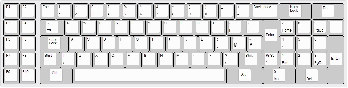

Here's another example for an IBM XT
remapblock
BACKSLASH EUROPE_2
BACK_QUOTE BACKSLASH
PAD_PLUS PAD_ENTER
SCROLL_LOCK DELETE
LCTRL CAPS_LOCK
CAPS_LOCK LALT
LALT RCTRL
endblock
and that produces this layout:

        # Number Pad
        # Mimic standard num pad except with telephone number layout
        ESC             NUM_LOCK
        NUM_LOCK        PAD_SLASH
        PAD_7           PAD_1
        PAD_8           PAD_2
        PAD_9           PAD_3
        PAD_MINUS       PAD_PLUS
        PAD_1           PAD_7
        PAD_2           PAD_8
        PAD_3           PAD_9
        PAD_PLUS        PAD_ENTER
