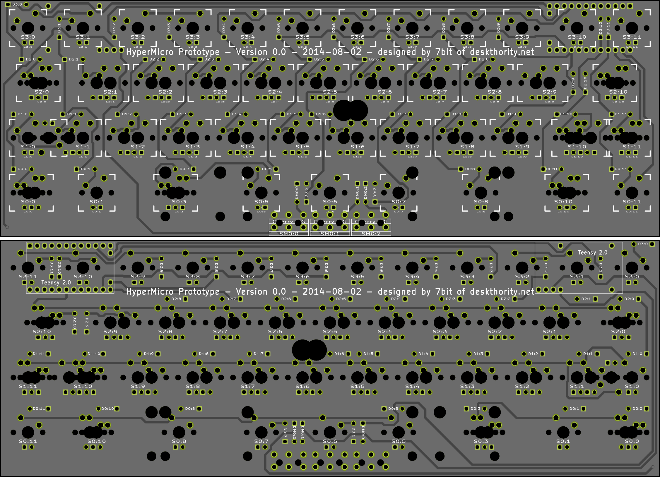

02 Aug 2014, 21:35
I've finalised the PCB, except connections for some LEDs.

Well it's much cheaper than a Teensy 2.0 and has enough pins for small boards. It seems like a natural fit to me.
I think I see an error - on the bottom PCB, you have "Teensy 2.0" on both the left and right sides, but on the upper one the Teensy pins are unmarked. Should the "Teensy 2.0" text be on the upper diagram?

02 Aug 2014, 22:08
scottc wrote: Well it's much cheaper than a Teensy 2.0 and has enough pins for small boards. It seems like a natural fit to me.
Both controllers are on the bottom. Viewed from top, the right one is for the keyboard, the left is for the mouse buttons.
Indeed, the Pro Micro controller could be used for the mouse-botton PCB.
I use 17 pins, but the Pro Micro seems only to have 16 usable pins.
03 Aug 2014, 03:52
I didn't realise that the Pro Micro had so few usable pins. It looks like it has more on the first glance, but most of them are useless. It also seems to have 3 GND pins, which makes no sense to me... disappointing :x

7bit wrote: Indeed, the Pro Micro controller could be used for the mouse-botton PCB.
There are 18 usable pins. TX/RX are PD3/PD2. The only ones that are not usable are VCC/RAW/RST/GNDs.
03 Aug 2014, 09:33
Thanks, but I'm not sure I want to change anything. I'm working an the LEDs now and want to make sure that at least the switches at the edges can be connected through the PCB.
03 Aug 2014, 19:03
Does anybody know if I need to connect the VCC-pin to anything on the keyboard?
:o
I've seen it on the Phantom and the ErgoDox, but I'm not sure if it is really necessary.
Igthorn
03 Aug 2014, 19:32
Only if something needs power like an led or another chip like the io expander on the ergodox.
03 Aug 2014, 19:52
Thanks, but I'm still not sure.
At the Phantom it is connected to just the keyboard PCB, like GND.
