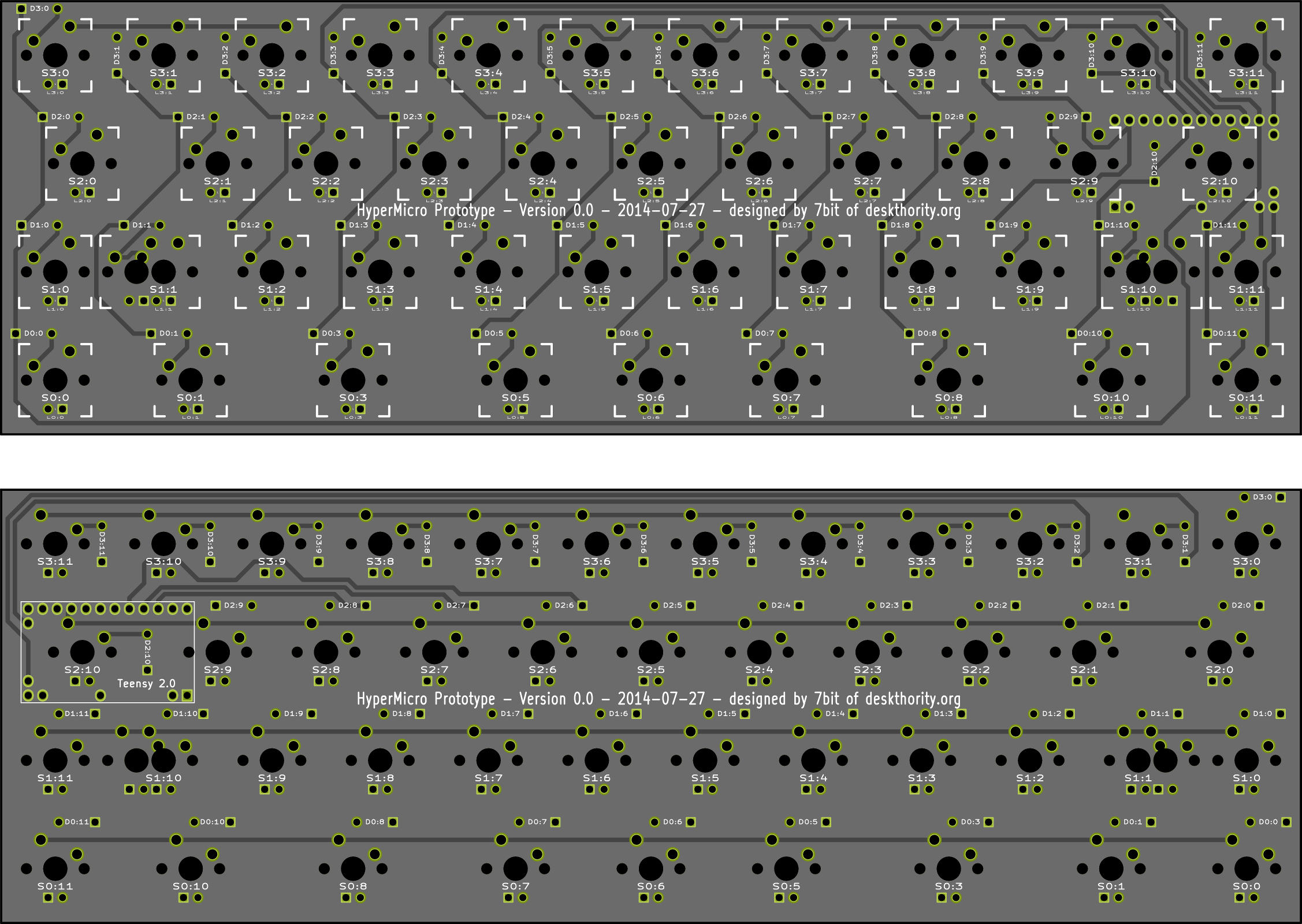

Looks good to me.
Mounting provisions? or is going to "hang" from the plate?

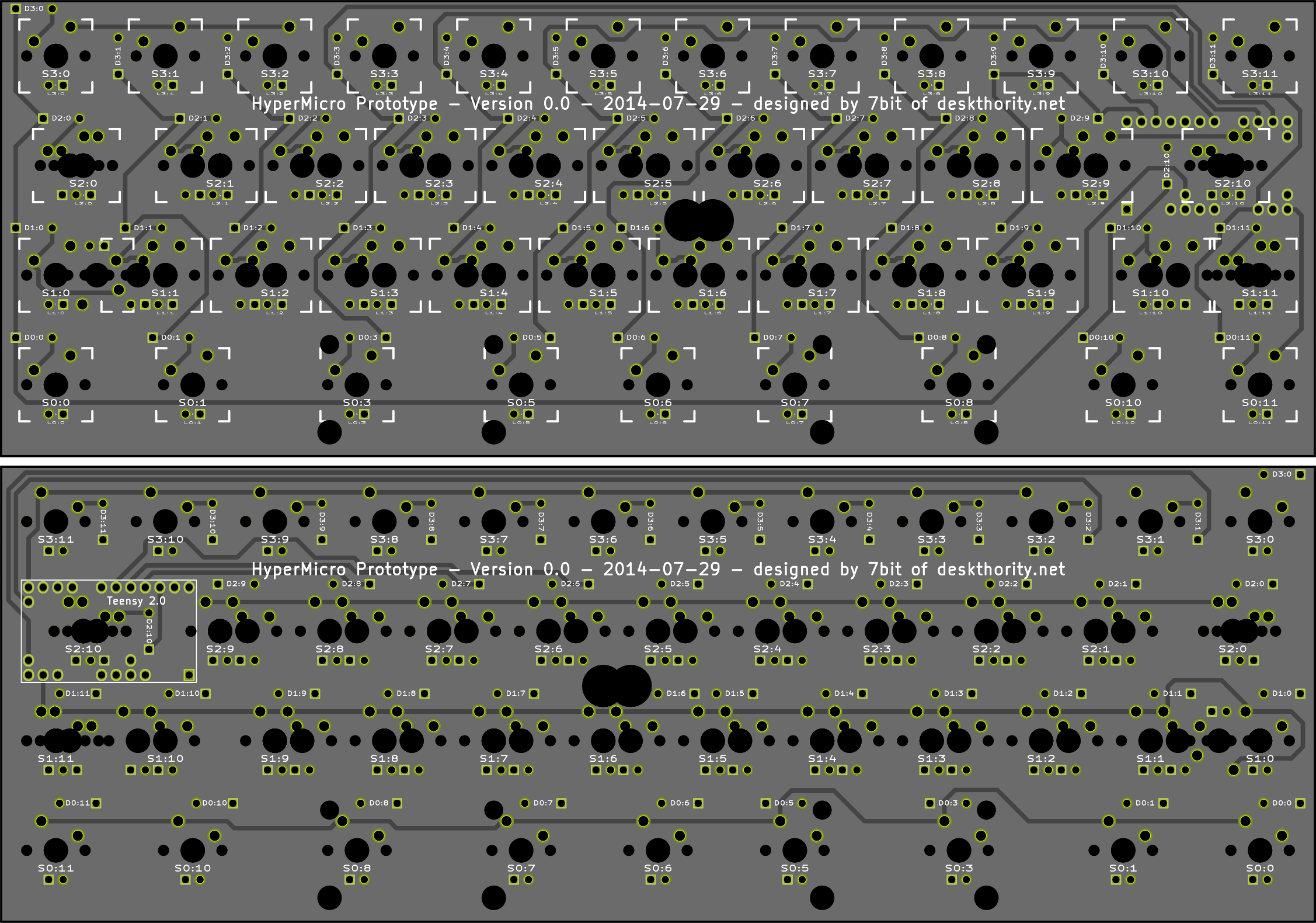

I think I should add some holes. At least one for a pointing stick.
:o
Plate designs come later ...
Other Hyper models will follow, but the smallest is the easiest for testing and cheapest for prototyping.
27 Jul 2014, 21:28
That's a very good idea. I've got a trackpoint module from an IBM Space Saver waiting for this! I'm just worried that the TP controller will be longer than the HyperMicro PCB. :D

Option to have usb connector on main pcb?
How about some indicator leds?
Some teensys come with both rows of pins presoldered - add pads for these even though they are not used.
PCB stab holes for shifts, but it might conflict with existing keys.

This is the prototype so it is supposed to have bugs.
:o
BTW: I will add support for 4 and 7 units space bars (both plate or PCB mounted) and will make 2 PCBs for symmetric and traditional staggering.

BTW:
Is 7mm diameter enough for a trackpopint-hole?

7bit wrote: BTW:
I have a Trackpoint module from an IBM Space Saver, I can check dimensions later tonight.

30 Jul 2014, 00:50
:o
30 Jul 2014, 01:09
Looks good… to my untrained eye.
30 Jul 2014, 01:44
It would be thick with the Teensy there. Why not have it one row up?
30 Jul 2014, 09:02
There isn't enough space.
The JD40 even has it in the bottom row!
:shock:
30 Jul 2014, 09:16
OK, I had a thought about it:
Teensy must be turned 180 degrees and moved a bit towards the center (by a pad or so).
Then, 2 columns can be connected directly inside, 4 via the space on top and at least 4 through the space between row 3 and 2. It is possible to connect 2 columns through the bottom rows.
Row 3 and 2 are trivial, but row 1 and 0 should also be easy ...
OK, let's give it a try ...
