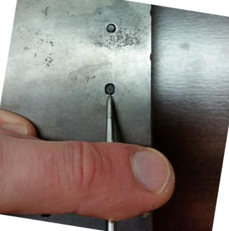

Let's back up a second...
Before I even considered offering my services, I wanted to come up with a method to consistently drill holes...:
- perpendicular to the barrel frame
- parallel in relation to the other holes in the same row
- within the confines of the original stud's circumference, biased lower (not higher)
- centered in relation to the holes in the steel plate (NOT dead center on each one; there's a gradual shift from center to sides)
The first two are primarily because I'm a little bit of a perfectionist. The third one is important for the integrity of the plastic (there's a happy 'meaty" zone). The fourth is quite important when using flat head screws with a conical shaped underside, which makes getting a finely tensioned and tuned M so much easier.
So! The divot I agree is incredibly important. What I'm not happy with is the size and location of the divot when a soldering iron is used (and ruining a good soldering iron tip!). A finer point to dial down the drill location in relation to the hole in the steel plate is what I want to stress about this subject. Such as the point of a nail, or this great cheap Harbor Freight special:
2016-03-21 23.01.34.jpg (59.89 KiB) Viewed 20892 times
Sort of difficult to take this picture, but that's pretty much exactly where I want that hole in relation to the plate. Drilling that hole accurately will be significantly easier with a proper work jig.

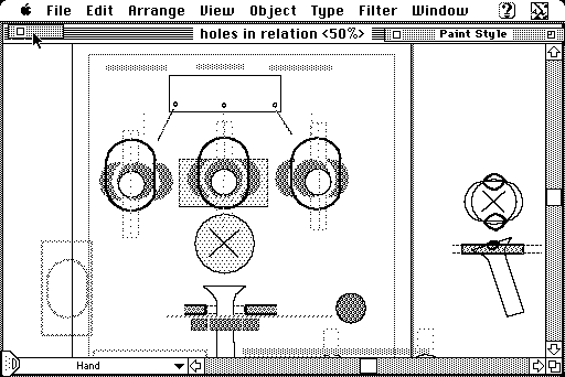

2016-03-21 23.09.00.jpg (52.27 KiB) Viewed 20892 times
As for that jig, I'm working on a printable PDF plan with instructions to build one like I posted in the FSSK thread. I've built three of them from my current "plans" and they're getting easier and more refined. Soon everyone can make their own! :)

Hah! It's only 4.7KB - I don't have to feel guilty about using up deskthority bandwidth. Mhuhahahah.
Anyways, most of that should be self explanatory. At least that's the goal. I'm working on it.
(The screw diagram on the right at an angle is to show the merits of the minimal amount of contact area when flat head conical bottom screws are used. I actually took a few shapshots to turn into a gif. I'm having fun with this...)

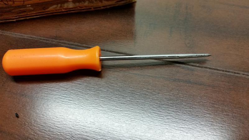

Wow, this is fantastic. So you use a pick to make your divots? I might have to try that next time. I also did not consider making the divots relative to the holes on the steel plate itself.

Yup, a pick or awl - whatever you want to call it. Though, my method up until now has been to mark two lines with a pen, relative to the hole in the plate and drill in between those two. I have a magnifying glass on my drill press, which dials me in even closer. But with an awl/pick I just made my life one step easier by not having to use a paint pen on each location so the pen marks are visible. Heheheh.

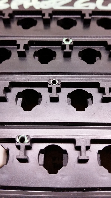

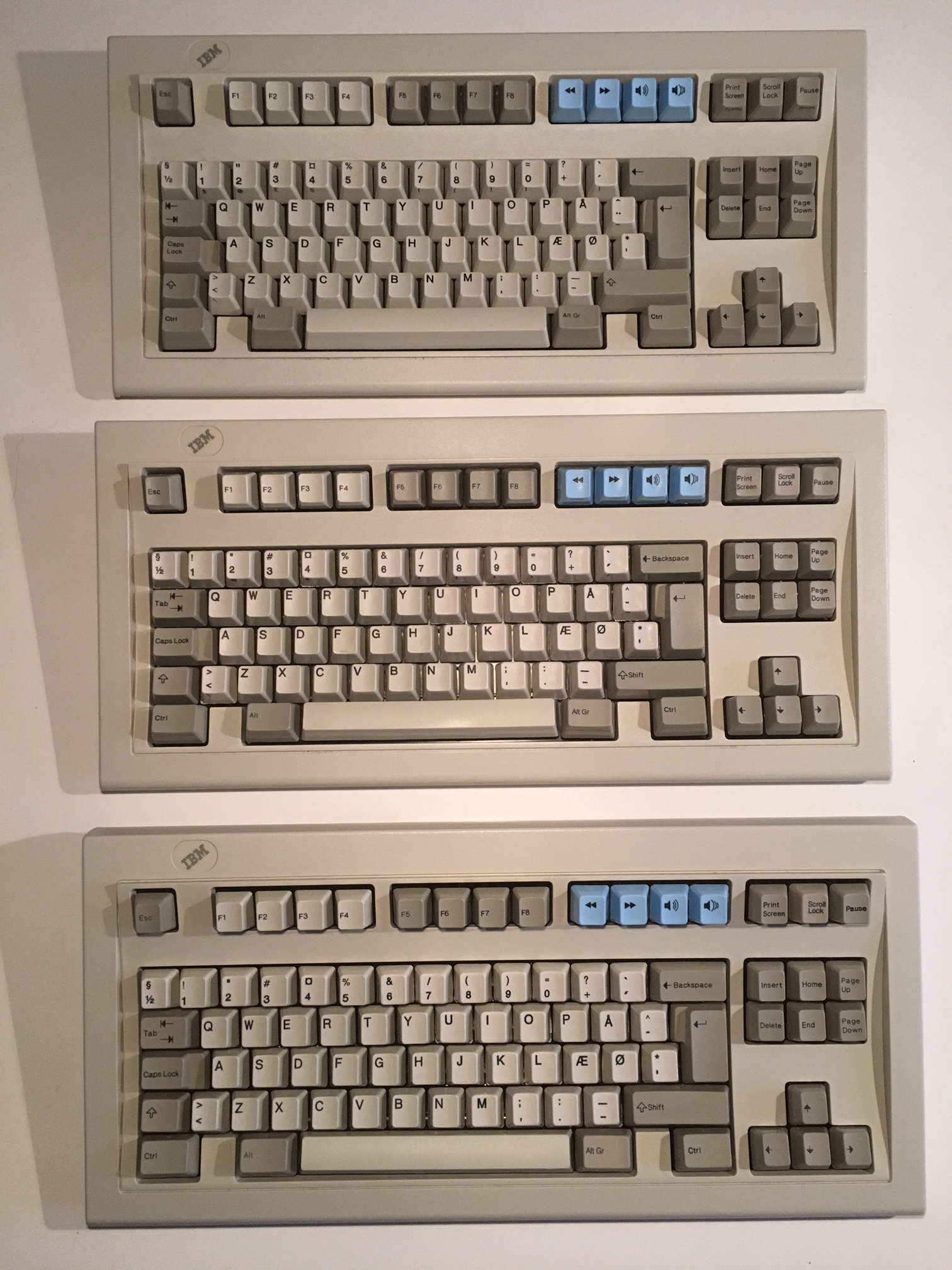

First of all I want to thank you guys for doing the tutorials on how to bolt mod and screw mod the IBM Model M. I rarely contribute much on DT, but visits quite often to see what’s happening.
Now to my mod: A few years ago a seller on eBay had a load of SSK’s for sale. I bought 3, one ISO French/Canadian and 2 ANSI – all made from between july and September 1987 and in very good condition. The ISO SSK has been my daily driver since – and I have quite often thought about having the 2 other ANSI converted by a skilled person. Sending them to Fohat or Phosphor Glow seemed a bit costly, since I live in Denmark. And I don’t know others that do it nearby. So I finally decided to do it myself. Got hand of a cheap vertical drill, Einhell BT-BD 401 for approx. 70 USD on Amazon and the other tools needed.
The first screw mod went according to plan, nice holes in the plastic plate thanks to a slow pace, and the final assembly went almost without any issues. Then I discovered that I has misplaced a spring, damn it. Open again and reassemble. The test afterwards showed, that 5-6 keys didn’t react. A time consuming and frustrating fine tuning went on with the screws (different pressure on the plates and membranes) and solved the problem 99 percent. But I wasn’t happy with the project over all. In my world things work 100 percent or don’t. So I almost gave up on modding the second SSK. Especially after I opened the case and noticed, that only 1 rivet had broken. A practically new keyboard specimen. Anyway, I started and learned from my first mistake, so it only took about 4 hours from start to finish. The test: All keys worked perfectly, and crisp and sharp key feel (Which the first modded SSK also had).

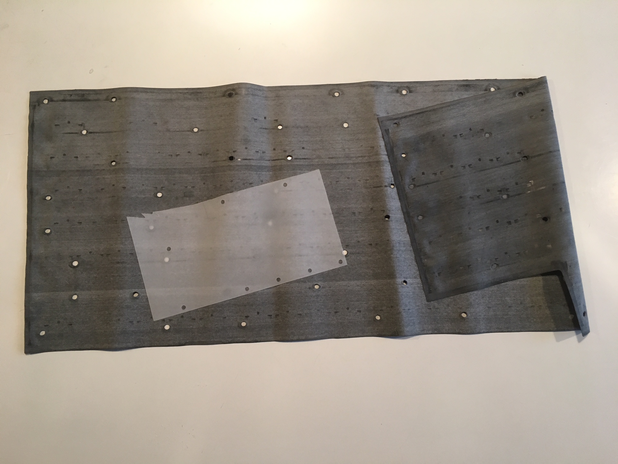

I wondered, why was the first SSK so screw pressure sensitive compared to the second?. I knew I had been very careful with the tightness. Suddenly I might have the explanation. On the first SSK I reused the original black rubber like blanket – on the second I used a new white silicone replacement blanket from Unicomp. I decided that had to try to use a new blanket on number one. And that did the trick. All keys responded perfectly afterwards.
ssk blanket.JPG (663.39 KiB) Viewed 20427 times
Lesson learned, for me at least. It is not that difficult to do a screw mod with the right tools. And do spend 10 USD on a new blanket from the very helpful people at Unicomp. When I talked to them, I also ordered some media keys – in light blue, which is not possible on their website but doable. (And thanks to Orihalcon for the mapping adapter)
Regarding the benefits of a screw mod in itself… The difference is not that big to my fingers, I would say 8 to 10 percent more precision in key feel compared to the almost new ANSI. If the keyboard is well used, and serves the owner on a daily basis, I would do the mod. I can’t judge on how to choose between a bolt mod and a screw mod, but the screw mod should be less time comsuming, and I’m pretty demanding and perfectly happy with my results.

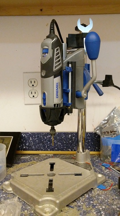

If you have a Dremel that fits it, I would suggest considering the Dremel 220-01 Rotary Tool Drill Press Work Station:
I paid $32 for mine, though I think it's going for about $10 more at most places now. It's NOT a high precision drill press, but overall it works well. I'm not an expert on screw mods but I've done five, including two M122s, with this and it really made quick work of the drilling with very good results. I've also used it for a lot of other things as a stand for the Dremel since it can be rotated 90 degrees. I've had mine for a year now and use it on a frequent basis and it hasn't broken yet (lots of plastic parts so don't crank on it). Again, if your Dremel fits it and you can get one for a reasonable price I'd recommend it.
13 Nov 2017, 19:00
That looks to be a nice little kit. I already have that same Dremel.
