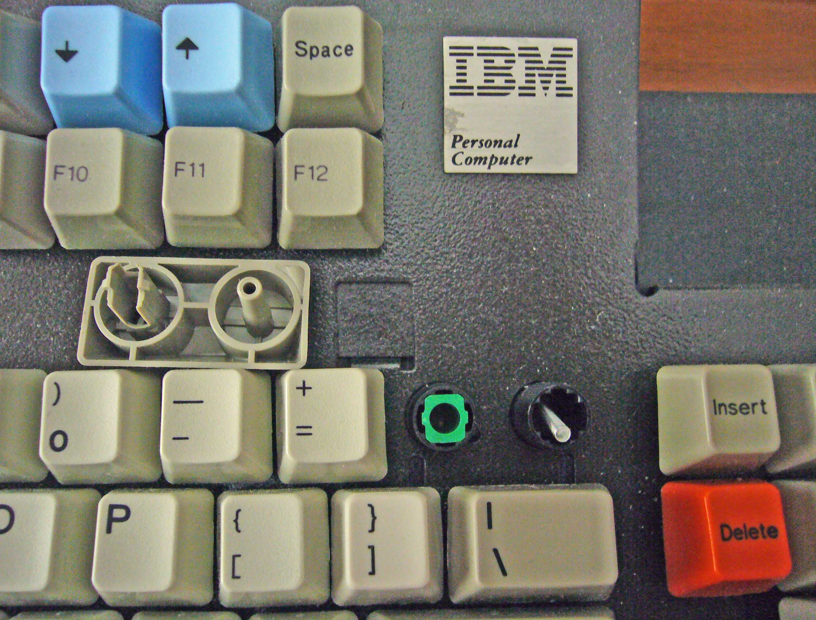

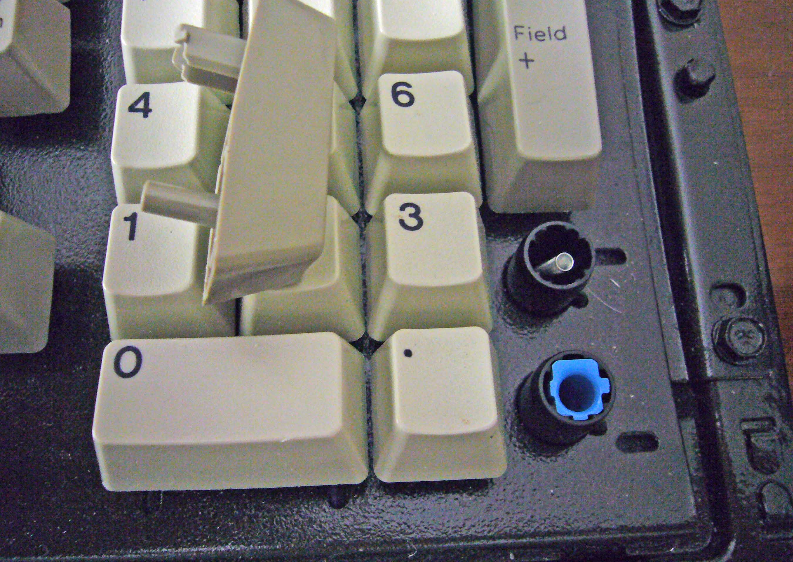

Inserts come in two varieties: horizontal and vertical. Your SSK only needs horizontal inserts (there is no numpad Enter key or ISO Return). And horizontal inserts have the hole symmetrically placed in the centre. Vertical inserts are off-centre when you look down them.
The colours, well, I'm sure they meant something at the time! But I've seen more variety than is sensible to rely on.

I believe that Unicomp sells the centered ones in white and the off-center ones in black.
Horizontal long keys require the "centered" type. Be sure that they are oriented vertically with the "elbow-room" on each side.

Here is the alignment you need to use:
- barrel-insert-vertical.JPG (400.22 KiB) Viewed 4700 times
- barrel-insert-horizontal.JPG (410.62 KiB) Viewed 4700 times
