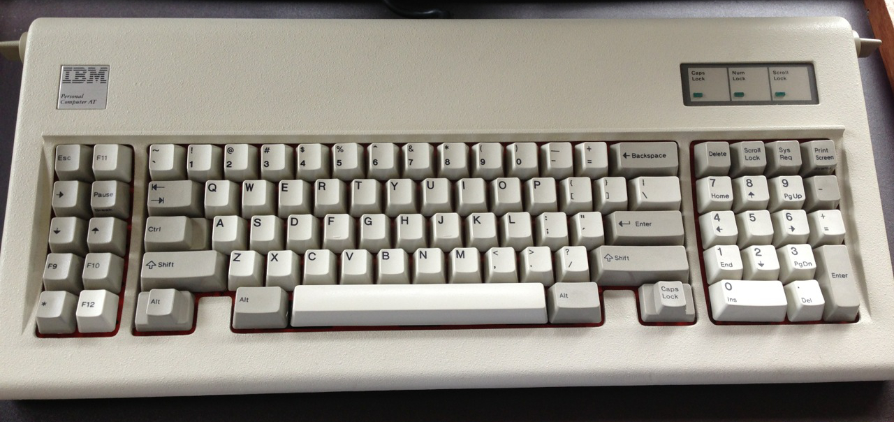

IBM has been quite accommodating with its placement of active pads and uniform-profile keycaps, but it's unfortunate that they couldn't have extended this courtesy to the Right Shift in the AT. Dividing it properly by putting an extra 1x pad on the right side would have been nice, so that we could have a 1.75x Right Shift and adjacent Fn key. In any event, when I have some time and warm weather this summer for working in my unheated garage, I am considering giving my AT the full treatment, including conversion to ANSI, model M spacebar, and extra bottom-row mods as described in the thread over on GH:
https://geekhack.org/index.php?topic=48288.0
12 Feb 2015, 15:12
That'll be informative! The part that puts me off is the need to cut the plate, precisely too. There's already horizontal slots in the area where the extra pair of barrels should go. Looks an awkward task, and I haven't the tools for it.
Mind, I'll need to cut my own plate for the XTant. If a few of us have similar needs, we could team up.
As for IBM's way of splitting right Shift: bear in mind their need to support Japanese JIS layout and (whatever the abbreviation is for) Brazilian.
Brazilian:
JIS:
Both of those layouts trim a unit off the inside edge of the right Shift key, like ISO does to left Shift. The idea of inserting an extra mod to the outside edge of Shift may well be Prof. Wada's invention. But squeezing in extra alphas on the other side preceded him.

Hypersphere wrote: IBM has been quite accommodating with its placement of active pads and uniform-profile keycaps, but it's unfortunate that they couldn't have extended this courtesy to the Right Shift in the AT. Dividing it properly by putting an extra 1x pad on the right side would have been nice, so that we could have a 1.75x Right Shift and adjacent Fn key. In any event, when I have some time and warm weather this summer for working in my unheated garage, I am considering giving my AT the full treatment, including conversion to ANSI, model M spacebar, and extra bottom-row mods as described in the thread over on GH:
hmm just saw this for the first time now, for me it's at least as tempting as Mu's AT numblock mod.
0_3_AT F after hardware modding.jpg (570.54 KiB) Viewed 11026 times
12 Feb 2015, 15:50
Yeah, I'd like to do it too. Much more work required, but could be worth it. They're both possible on the same board, of course.
Mind, you wouldn't catch me mixing F and M style mods like that if I can help it! Either go all M or all F.
