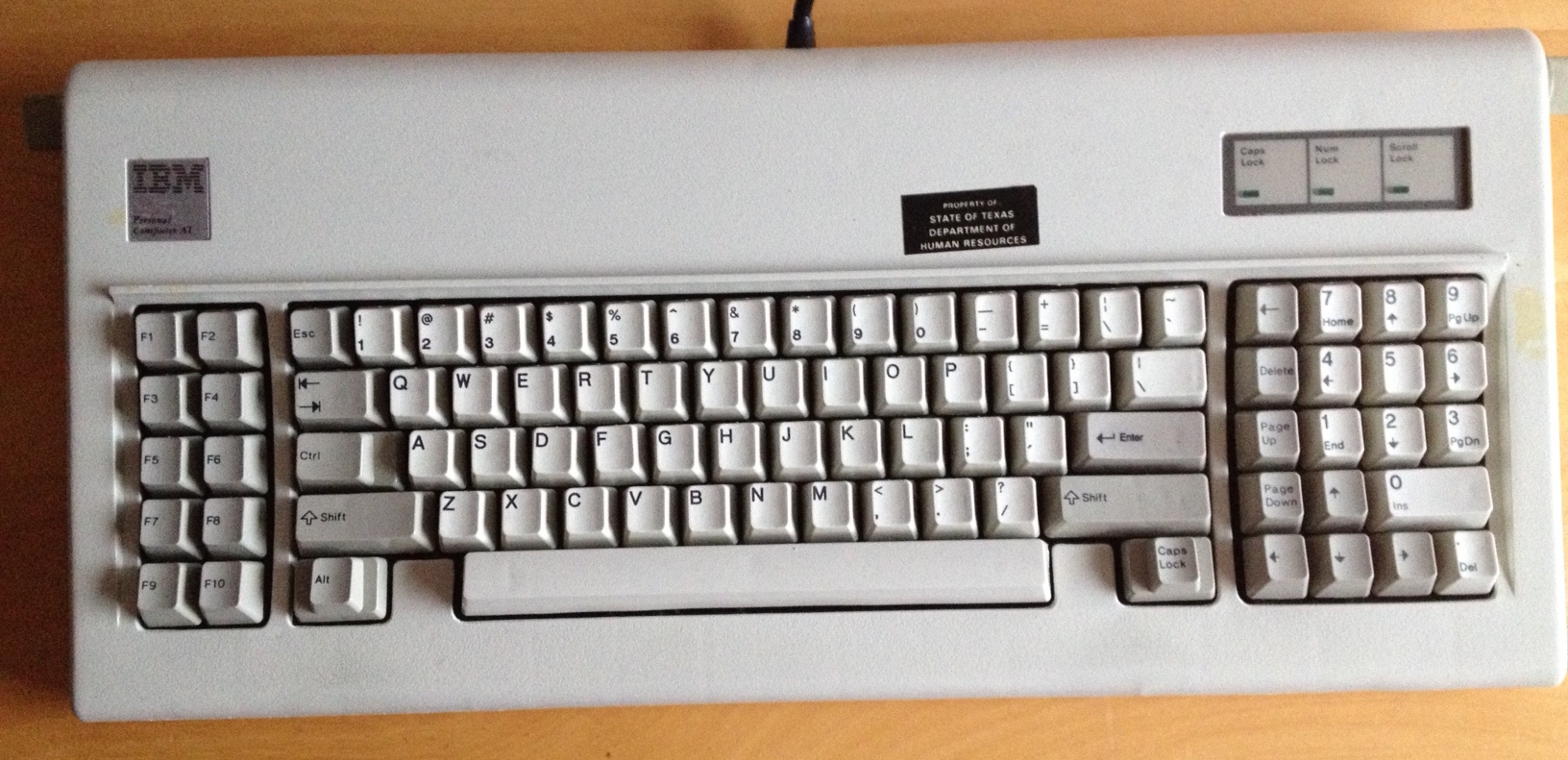

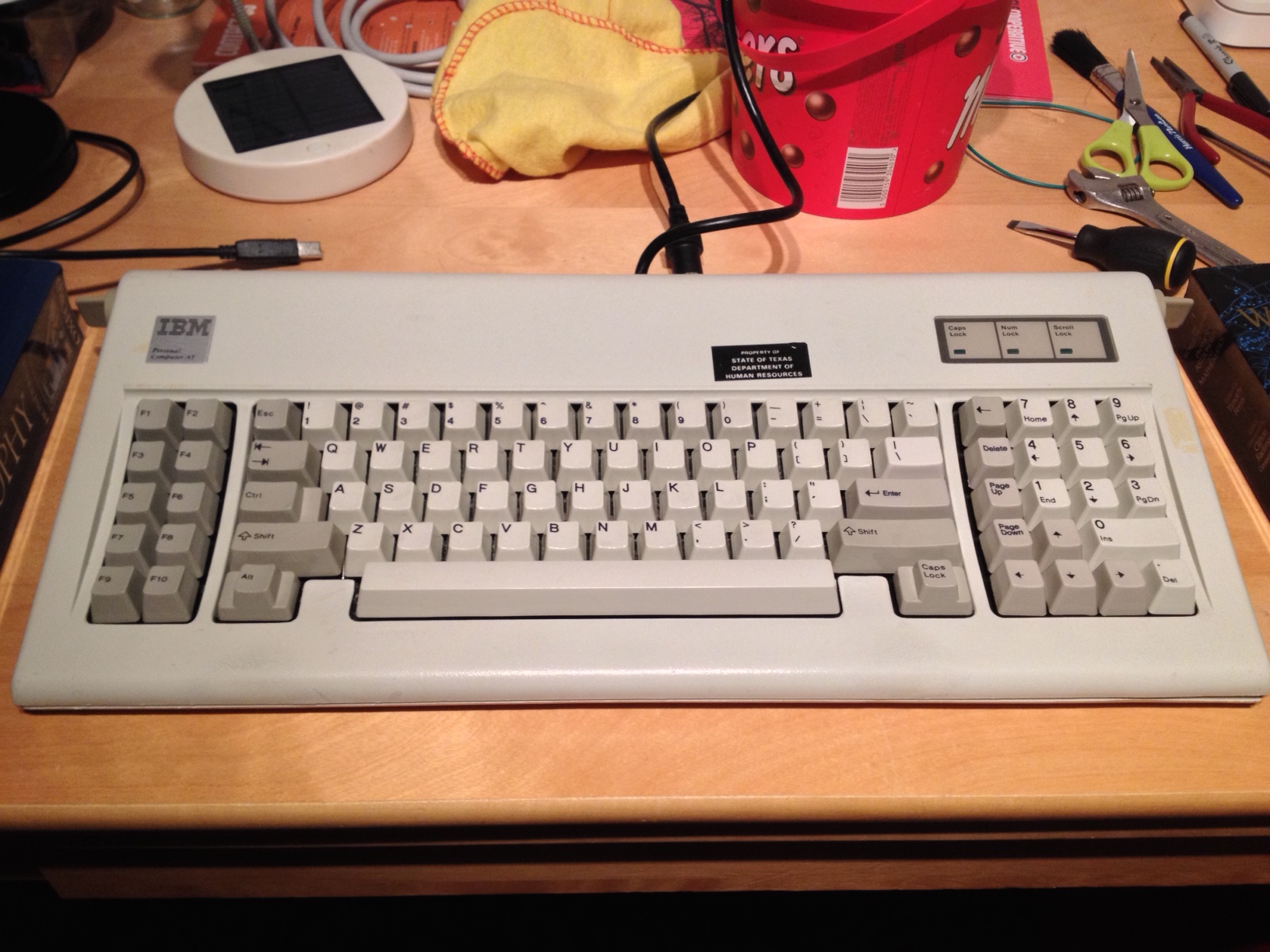

Unfortunately "AT" doesn't exactly make a good unique search term! So I'll ask an obvious question, hoping for a not so apparent answer. How do I open this here Model F AT?
Looks pretty regular right?

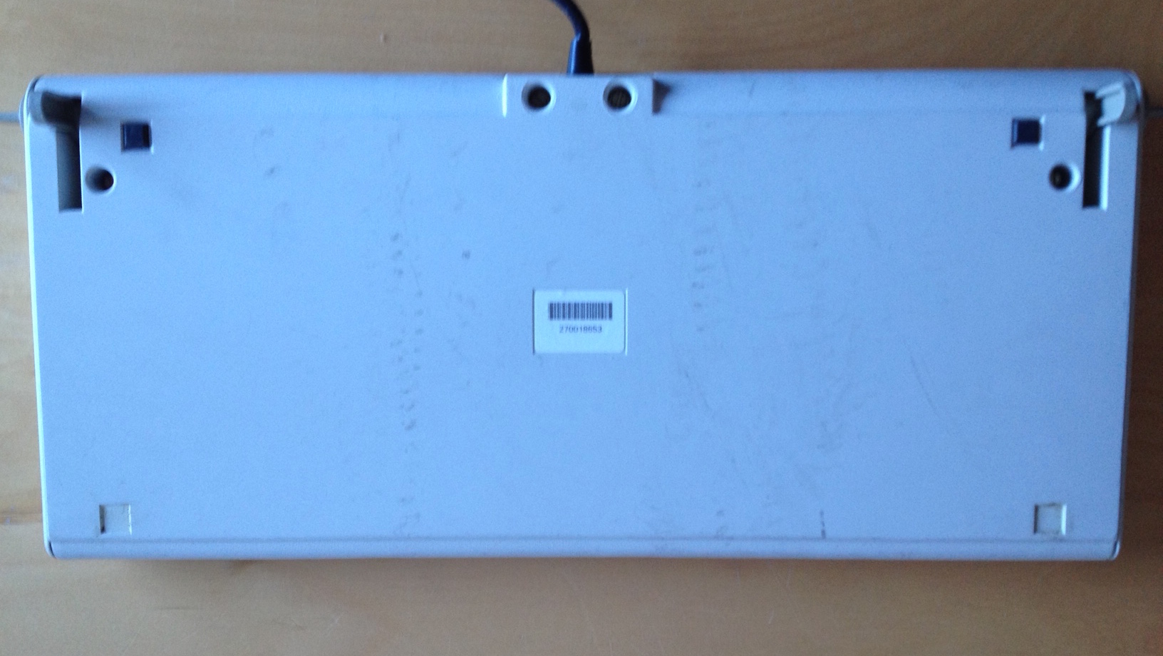

But (excuse the horribly shitty borrowed iPhone picture) the plastic underside has no screws along the front edge:
I've undone the screws along the top, and wiggled around quite a bit, but what I presume are tabs in there down front just aren't giving. I really don't want to snap anything. Anyone experienced got the trick?
I've also got a space bar that's half attached, as I was surprised to find a stabilsing wire beneath the barrel frame (what I thought was the XT style) instead of on top like all the other keys and spacebars I've dealt with. Hmm. I haven't snapped anything yet, fortunately!

if I remember correctly decline the feet and the top (where the cable is) should drop down. Careful! No scottish brute force on this. Don´t try to open the bottom. I think it hinges there. I can get mine and take a look if you want.
Push the knobs of the feet inward while tilting the back away from the cable and the back will drop!

30 Jan 2015, 19:21
I do want! I've got the top edge open just fine, but the front is adamant that it wants to stay put. Damnit, I prefer screws to hidden bits.
30 Jan 2015, 19:23
its just catches as far as i remember , just need something to slowly separate them. you ever opened an older mac mini ? its like that

30 Jan 2015, 19:27
could the back be stuck somehow on the feet mechanism? There is nothing else necessary to open the AT!
30 Jan 2015, 19:31
no you dont but if its stubborn a thin bit of plastic against the join may help
once you get inside you will see the crazy quality of the AT plastic its IBM's best ever plastic :)

It's a stubborn sunnuvabitch this one. Texan, see!
seebart wrote: could the back be stuck somehow on the feet mechanism? There is nothing else necessary to open the AT!
The feet are well out the way, my good Sith Lord. This is all happening in a single seam down the front edge of the board.

The case is indeed just hinged on the front, just pull it apart gently. You will hear some horrible screaking, but you will not damage your AT. I've opened my AT several times now and the screaking still scares me.
30 Jan 2015, 21:09
Thanks Nuum. That gave me the confidence to keep going, and finally I'm in. The technique? "Gie it laldy, son!" Translation: with great force.

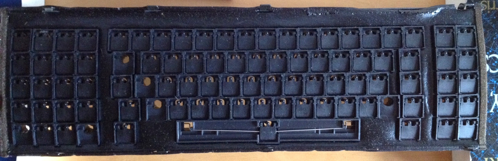

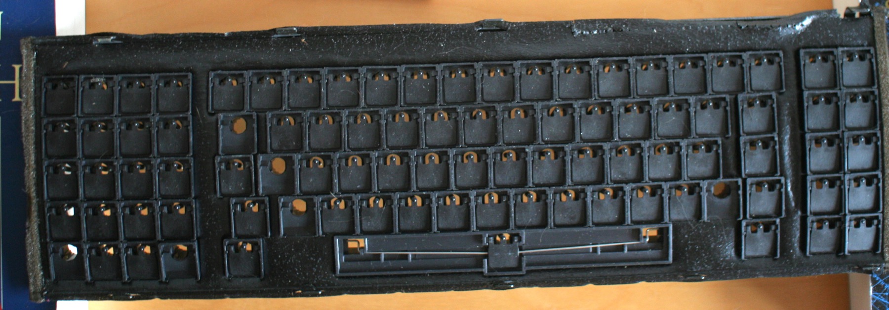

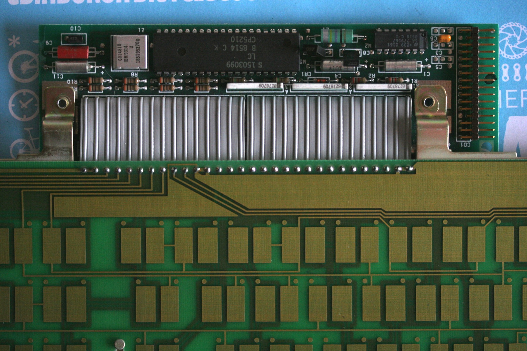

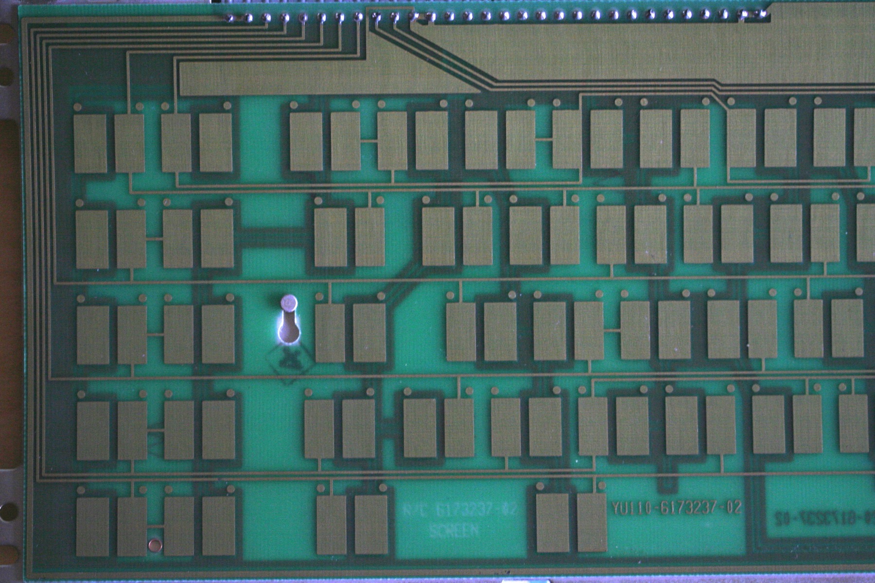

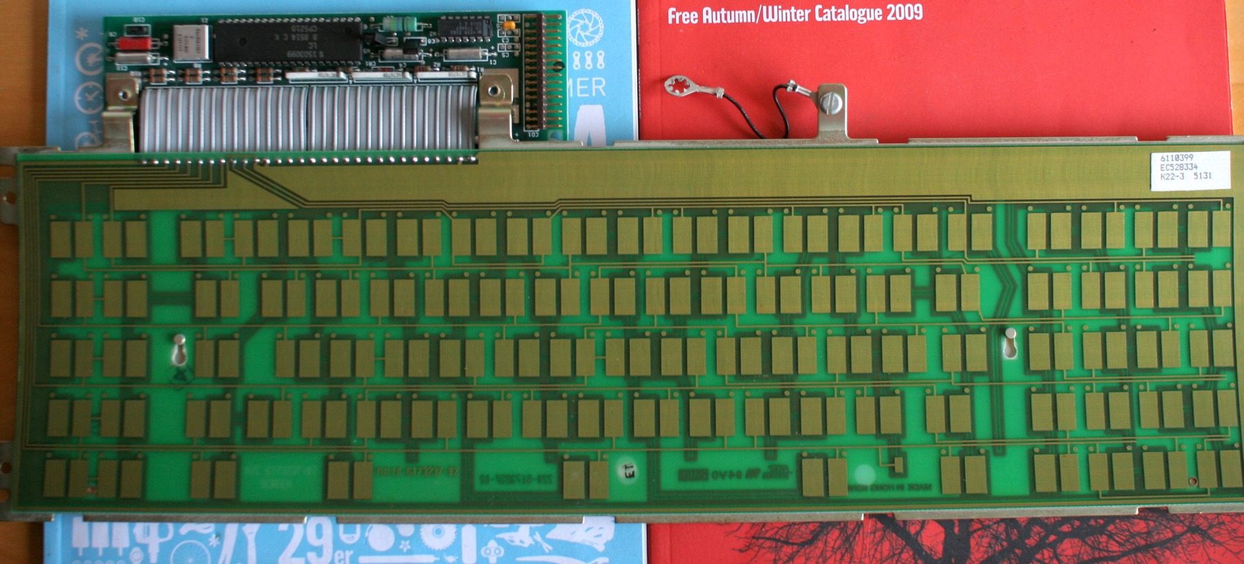

Okay, here I am inside the AT now. The spacebar stab is just as annoying as everyone says — boy am I glad this is a Model F so it's pretty trivial to open up the insides once the damn case is off — and now I have the PCB exposed I see there are indeed extra pads for another pair of mods.
They look connected, too.
Who's used these for a Model M spacebar + mods, uh, mod? Naturally, there's work required on the other layers:
Two different cameras, two crappy pictures. Way to go Scottish winter cloudlight!
Anyway, my immediate plan is to simply install an extra flipper for the backslash key so I can use an ANSI Return and ditch Mr. Big Ass. Should have one around here somewhere. I removed the little black stab insert from underneath Return before taking these pictures. Guess I should pop in a few of the Model M ones in the right places wherever I put on new caps.

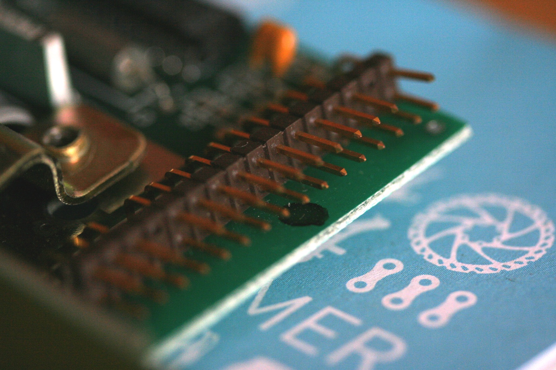

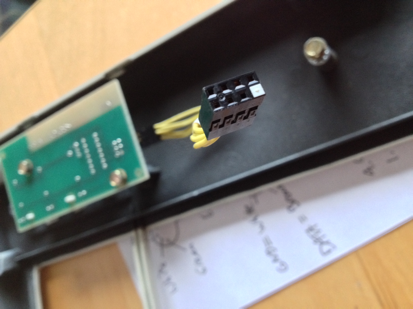

One more thing, the controller:

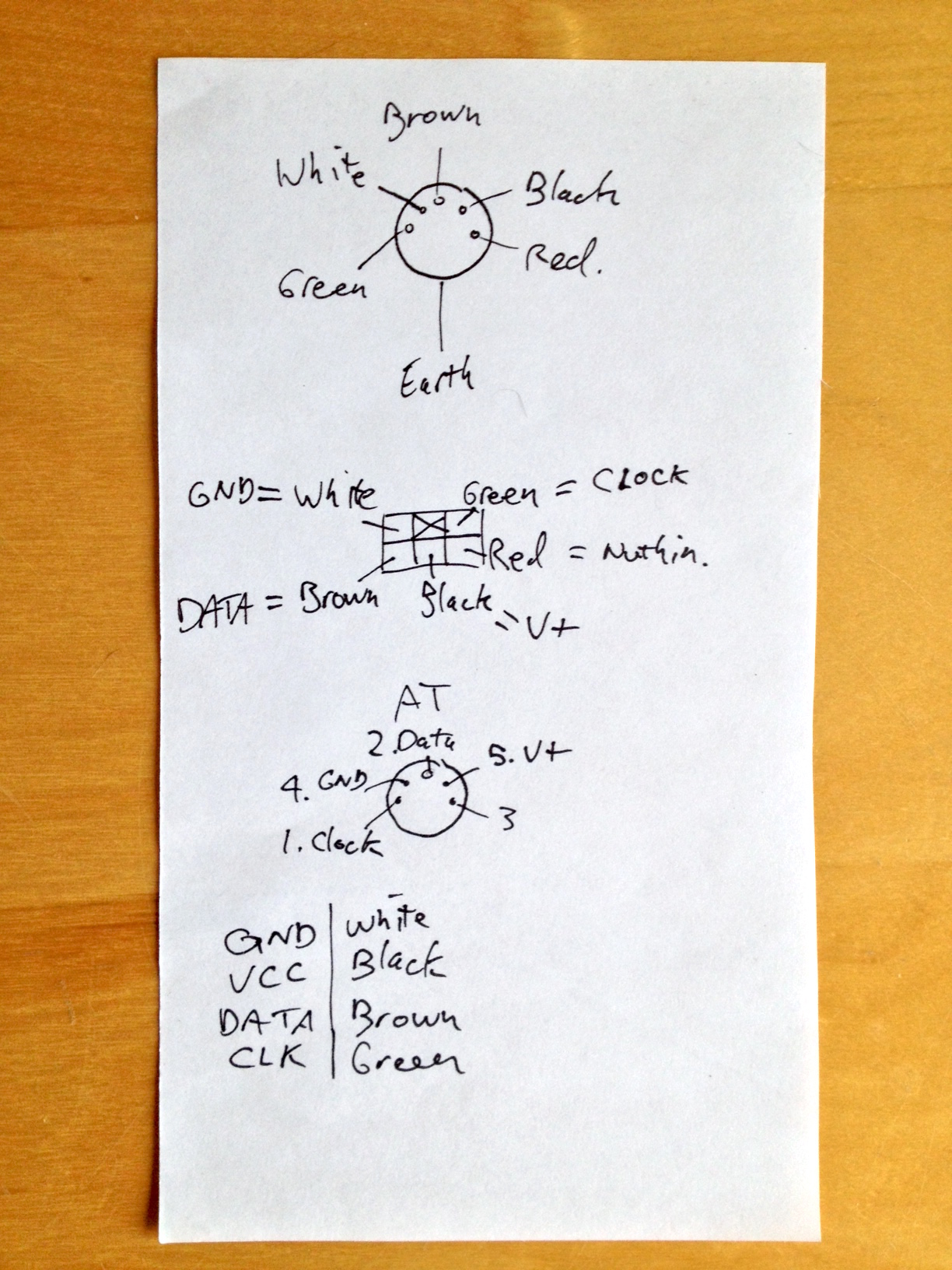

I pulled the cables out for the AT cable and LED daughter board. I'm guessing they simply align at the far ends of this header, with the blanked pins. LED connector toward the front:
And the AT at the back:
The AT cable is still a bit gummy even after cleaning, so I'm going to do an internal Soarer's converter job on this board and replace it with a USB cable or socket. Here's the pinout:
WRONG! I eventually figured out I had VCC and GND reversed. Don't do that!
Should be an ideal job for my one and only Pro Micro, actually.

I will save the picture with the pinout of the cable. Useful, Indeed.

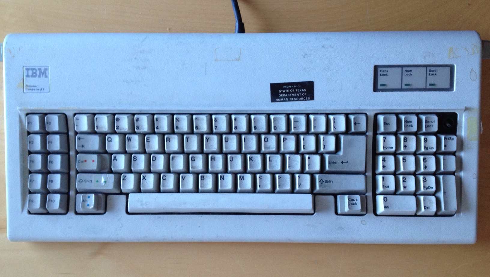

I'm just throwing my pictures into this thread for my own convenience. Feel free to duplicate them in your own thread if you like, i$, as I always do that with everyone else's stuff! Use [img] tags and they don't get duped on the server.
Anyway, here's where I'm at:
No Teensy yet. I'm still using the gummy wire. And the fiddly-to-reassemble spacebar isn't registering. Argh! It clicks just fine though, so that confuses me. I made sure to hold the flipper in position while closing the layers, too. Bugger.
Anyway, I took the opportunity to try my layout. Every other key works just fine, via my external Soarer box, and I've got them reassigned to match those new legends. You can likely guess where the Unicomp caps have gone just by the colour of them, plus the legends. Needless to say, I really prefer this HHKB layout to the AT's big ass enter. And that numpad / navigation block seems to work pretty good too. I don't use a numpad much anyway (so few of my boards have them) but the arrow keys: bonus!
I just needed to drop in two Model M stabiliser inserts, and two extra Model F flippers. Good and adaptable these old IBMs!

No need to re-route traces or anything fancy on this board. It's a Model F, everything is there and ready by default! The capsense pads that were previously obscured by large keys all still send signals through the controller, which Soarer's Converter intercepts and I can then remap. So my "backslash" key above ANSI Return (previously obscured by Big Ass Enter) is now a fully functional Backspace key, HHKB style. That explains why I didn't put a traditional Backspace up on the top row: I'm going HHKB with the main block. All of those work just like on the HHKB as well. The only thing I was missing was the artfully placed Fn key, which I've typically placed where Control is on the AT; normally the Caps Lock key.
