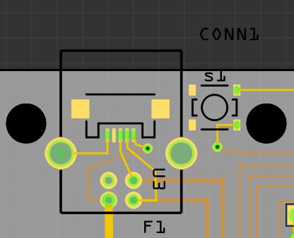

I would also add holds for direct soldering of the cable to the pcb. I have many cables with the wrong connector at one side that I would not mind to cut

Thanks Phospor! (i$, you got ninja'd!)phosphorglow wrote:Can and will do!Muirium wrote: Could you leave a set of through holes for the 4 USB lines, for those of us who like to string up our own socket on the keyboard chassis? That'd be mighty convenient! If so, labels please!
The standard names and numbering are here:
http://pinouts.ws/usb-pinout.html
Going to need this little provision for terminal boards anyhoo.

Micro provision.
I don't know if I'm too hip to the idea of only having two solder pads for mounting, but it fits!

Direct wiring! Many of us like to install our own sockets in the case, for a nice finished look. When dealing with a Teensy (or anything else with integrated sockets that will lie deep inside the shell) we wind up having to hack apart an appropriate USB cable. One end plugs into that socket, and the other end gets spliced onto our own panel mount socket on the case. It's a fiddly, dirty job I'd rather avoid with helpful through-holes for easy access to the 4 lines which make up USB.

Okie dokie! Gotcha. Plenty of room on the bottom for some extra through-holes. I'll add 'em in.Muirium wrote: Direct wiring! Many of us like to install our own sockets in the case, for a nice finished look. When dealing with a Teensy (or anything else with integrated sockets that will lie deep inside the shell) we wind up having to hack apart an appropriate USB cable. One end plugs into that socket, and the other end gets spliced onto our own panel mount socket on the case. It's a fiddly, dirty job I'd rather avoid with helpful through-holes for easy access to the 4 lines which make up USB.

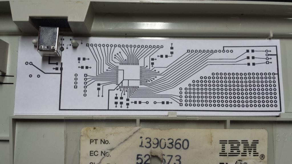

The USB area is going to bug me. I'm almost thinking 3D printed panel slot doodad. But my original idea was so much simpler - fabricate a nice little mylar cover that I can churn out on my electric cutter.
Need to find a much smaller right angle button and another with a long button stem, perhaps.
I really don't want to abandon the big honkin' USB-B connector. It seems appropriate since the SDL was so hardcore.
Otay. Now that I'm thinking out loud, Micro USB in bluetooth applications, with a smaller PCB that can be stacked over top with buttons/LED(s)/power switch. Smidgin bit more complicated, but less complicated than other alternatives I suppose. It'll look nicer and that will make me happy. Plus they'd be super cheap to have manufactured.
Looks like the ezkey modules are out of stock so I'll have to wait to buy one to fiddle with. I suppose elegant support will be in version 2.
Picture: Help! I can't get the firmware to load on paper! :X
- 2015-02-05 22.18.38.jpg (85.97 KiB) Viewed 10223 times

Aha!
Stupid me, I didn't realise that was the placement you were going for with the PCB. Superb! I'm too used to Teensies and Xwhatsit's controllers where the socket is arbitrarily placed and it's down to you how you route it to the outside world. Given that all (non 122-key) Model Ms have similar case geometry, your idea is artful genius!
USB-B (for beastly) makes sense in that position. Although I do generally prefer the smaller connectors like Mini and Micro USB which actually have higher rated connect/disconnect lifetimes; there is something to be said for a big brute succeeding from SDL! I'm still in favour of a backup through-hole footprint so we can jimmy up our own connectors, in any case.
I'd wait (or ask around) for an EZkey before going further on this, though, as Bluetooth is far and away the most appealing thing about this controller. Well, unless you can make the USB-only version about the same price as a Teensy of course! It's already looking more elegant for this job.
