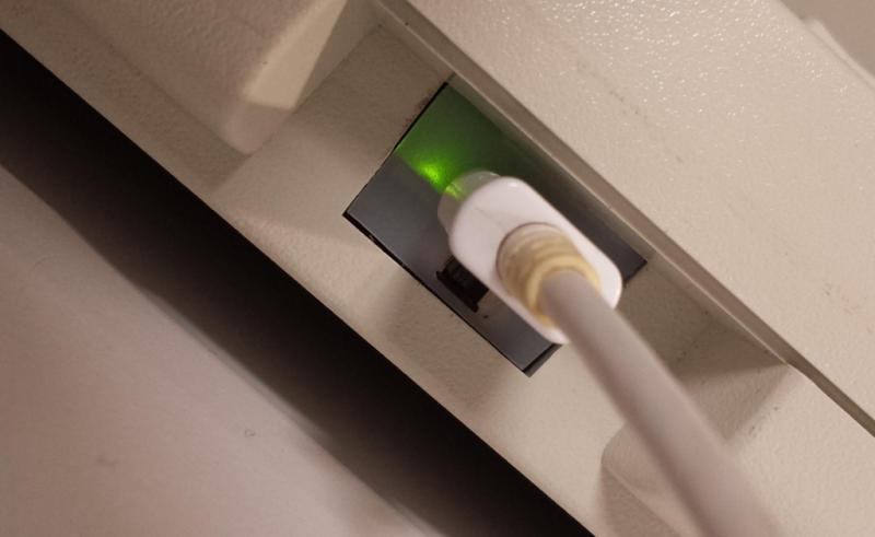

Here's a video update/excuse to play with a GoPro that I borrowed. I had to re-do this because I accidentally deleted the first file before it was done uploading, and since I was frustrated I accidentally hit crtl/alt/backspace which kills the X server... Amusing after the fact. Volume is low since the GoPro is in an enclosed case.
(Also forgot to mention that I've tested it from about 20' away with good results. And forgot that I need to change the design for the next round of sub-boards to move the through-holes for the JST battery connector so it doesn't interfere with the mounting stud, eliminating the jumper wire coming off of it.)
Picture of the battery charged indicator:
2015-07-09 21.49.07.jpg (36.63 KiB) Viewed 7683 times
