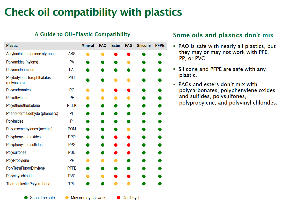

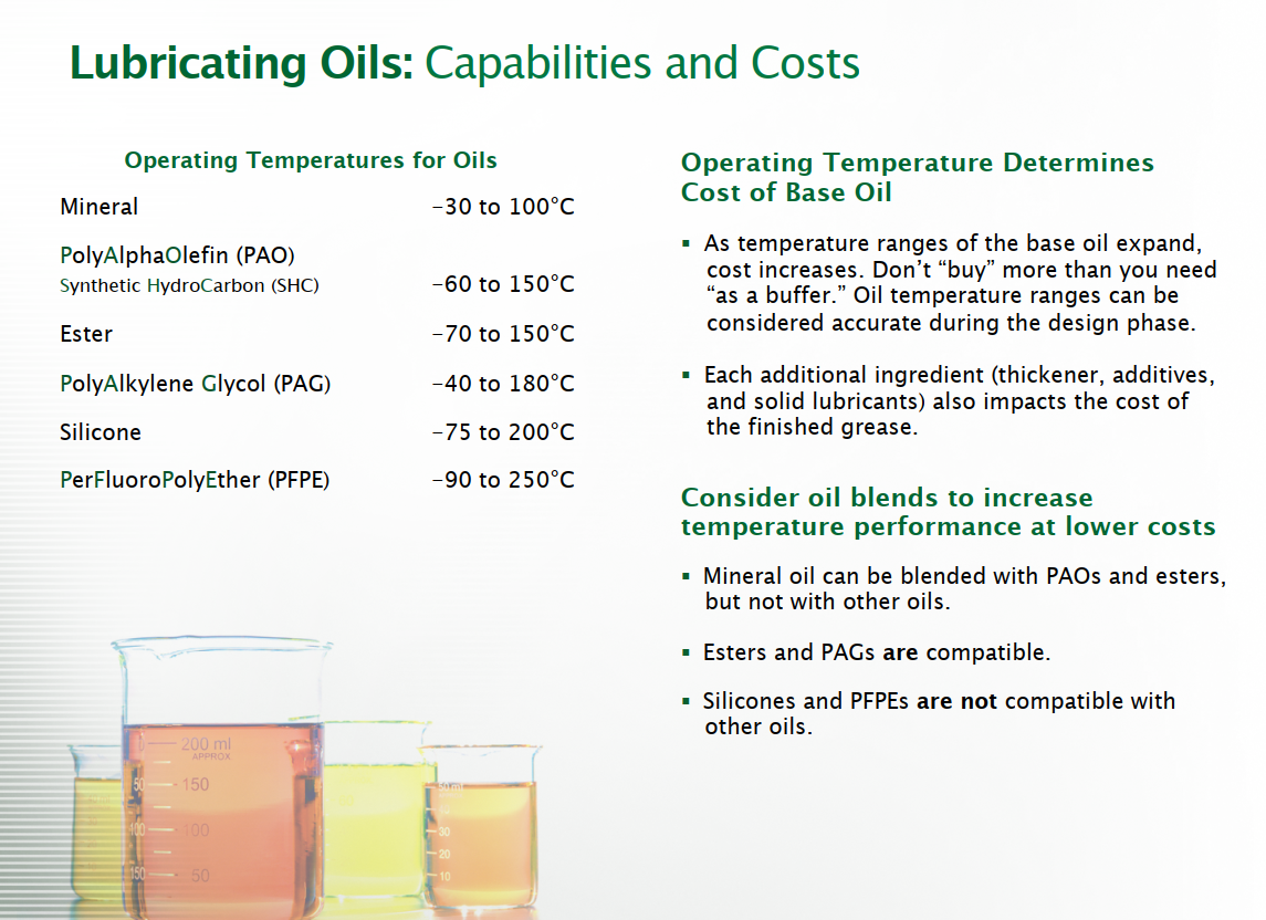

For those looking for alternatives, here's a little cheat sheet that might be helpful:
general_engineering_chart__nye_lubricants_.pdf
(1.93 MiB) Downloaded 224 times
Also these:
Captura de pantalla 2021-04-29 134339.png (169.55 KiB) Viewed 8752 times

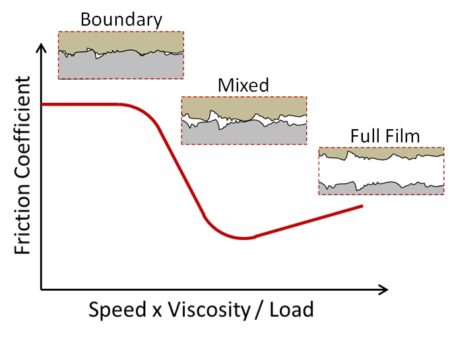

Maybe related with this
When the lube is way too thick it creates a separation between the two objects creating a layer of higher friction. Maybe we have now an idea of how much viscosity is too much and we should work on the thickener of the base oil to reduce friction. I was thinking of looking for lubes with PTFE thickener since PTFE is the plastic with the lowest coefficient of friction, hence why I proposed testing Superluber grease. Nye Lubricants have some PTFE thickened products in their portfolio, I'll revisit those TDS and come back. Remember that we are looking for lubricant based on Synthetic hydrocarbons or Silicone, other base oils are not so friendly with plastics.
We're all learning in this, research must go on :D
