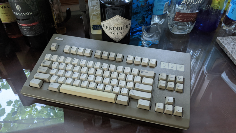

09 Sep 2022, 22:51
My baby :o
The product of many months of work and searching. NCR80, SKCM Amber, custom PCB and plate, 5140 and Dell PBT caps.

darkcruix
10 Sep 2022, 09:46
headphone_jack wrote: 09 Sep 2022, 22:51 unknown.png
My baby :o
Wow - that is an awesome result. Especially the decision for Amber is great. I have a bunch of different switches that still search for a project. I wish it would be as easy as a few years ago, when you could just buy an Alps based keyboard kit and solder your TKL with the switches of your choice.
Very well done ...

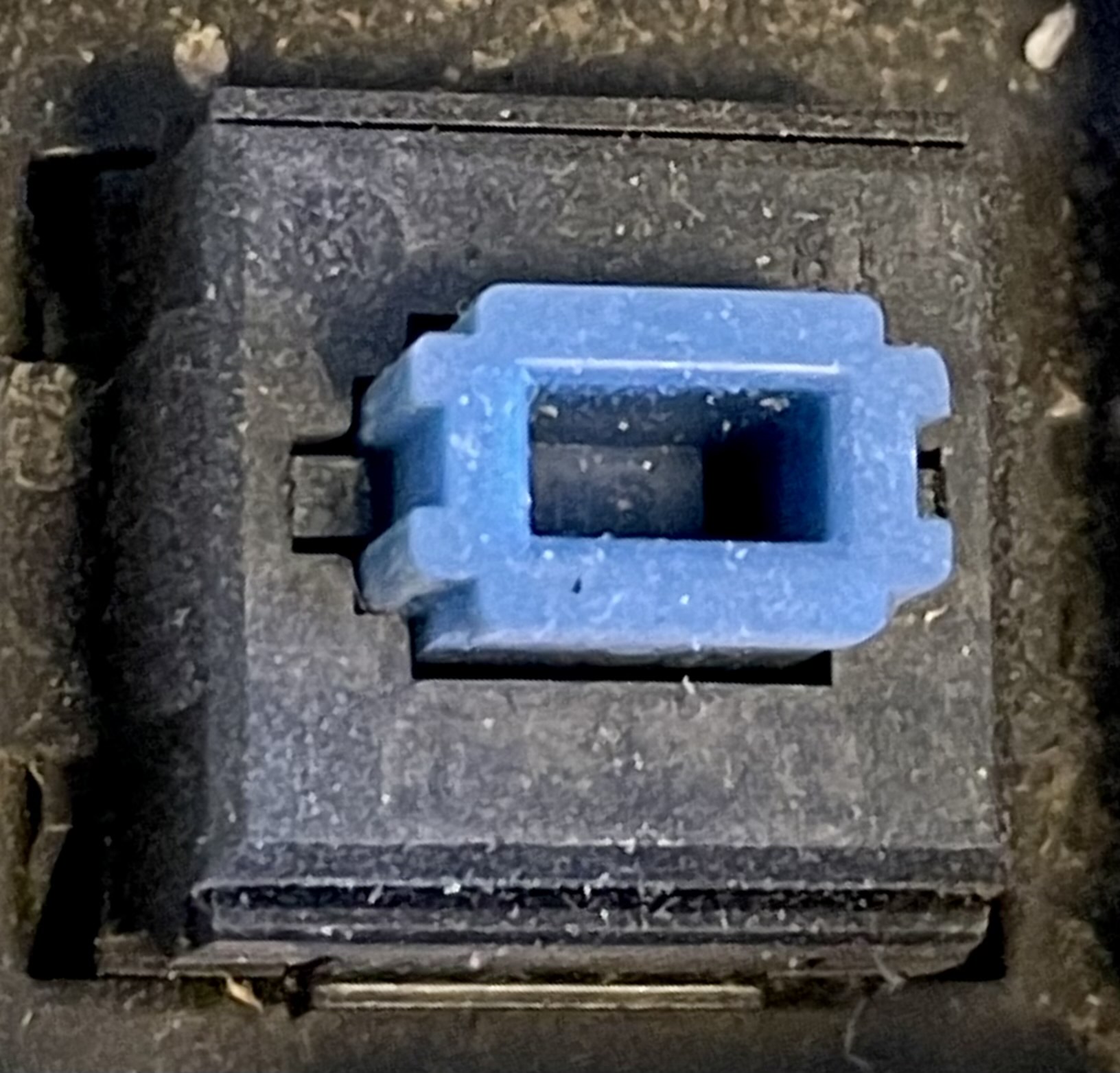

thefarside
11 Sep 2022, 17:13
My advice would be to ask about the condition of the switches if possible. Loose switches are hard to tell if there’s binding, but the wax mod seems to rectify most issues. To give you an idea the picture below is a super dirty blue Alps board I purchased and it will clean up very nice but it will still have binding and feel terrible without some kind of lubrication :(
My dirty blue alps:

amigastar23
11 Sep 2022, 21:00
thefarside wrote: 11 Sep 2022, 17:13 My advice would be to ask about the condition of the switches if possible. Loose switches are hard to tell if there’s binding, but the wax mod seems to rectify most issues. To give you an idea the picture below is a super dirty blue Alps board I purchased and it will clean up very nice but it will still have binding and feel terrible without some kind of lubrication :(
My dirty blue alps:
