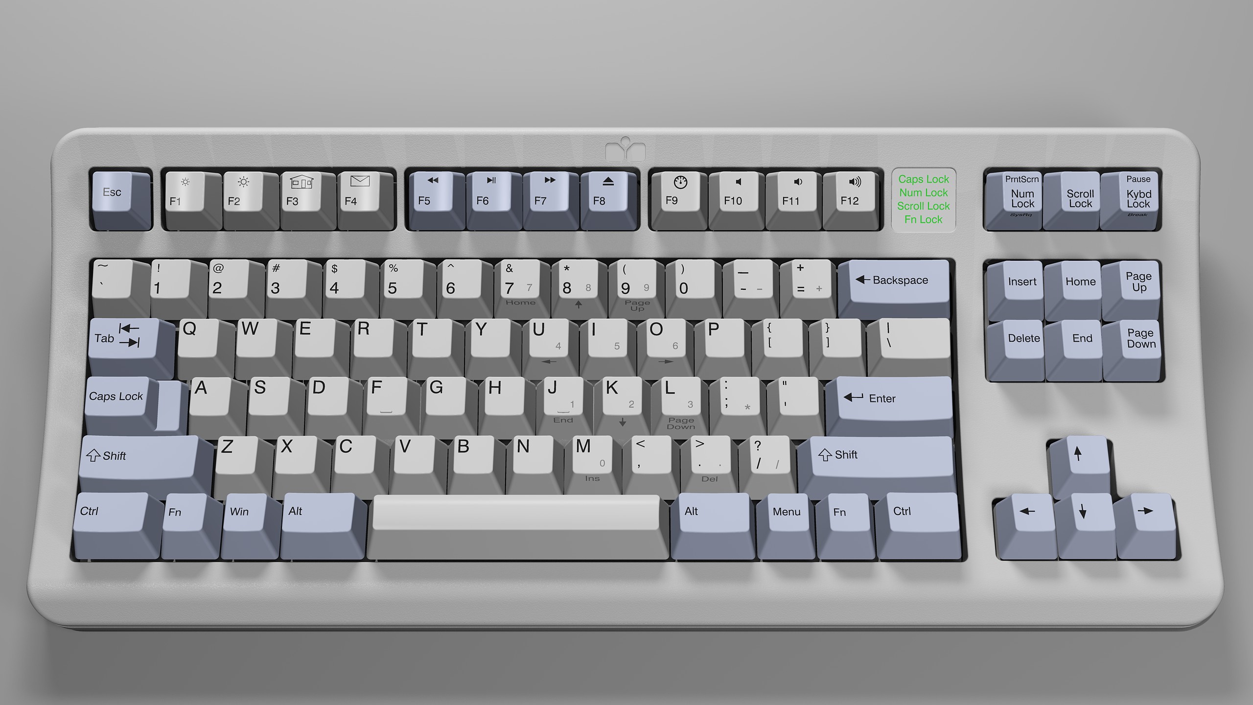

The other thing is a diagonal approach, maybe.
Something along the lines of this?
Obviously that's a little simpler than yours, but that's more an idea of a direction to take things.
And it acts as a nod to the orientation of the ThinkPad badge.

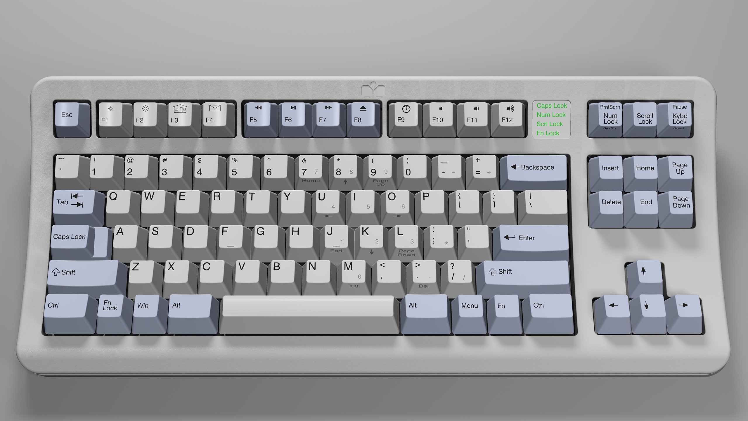

What about LFn+RFn to get Fn lock?

If not two Fn keys to get Fn lock, how about the Fn Lock on the right side? That's a bit more standard on almost every modern laptop, something most will be more used to using.

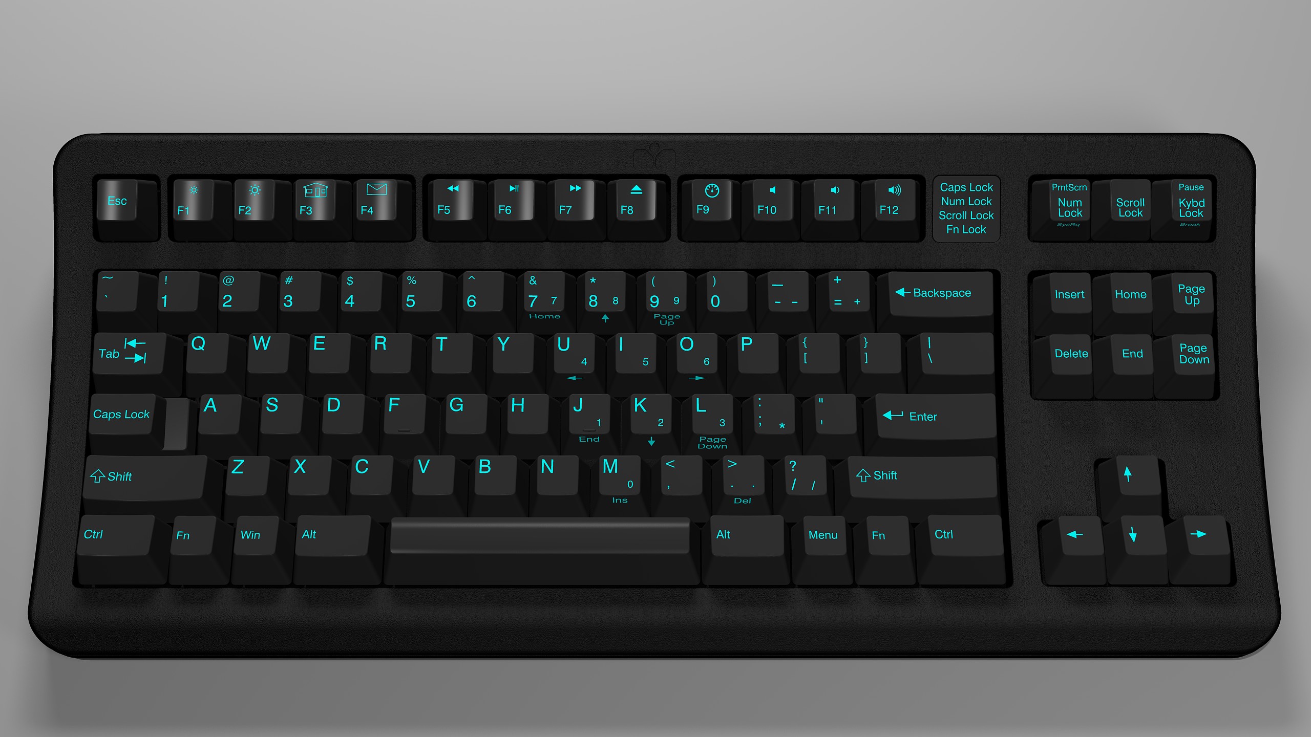

Pretty cool concept, I'd prefer the version that has no LED or indicator.
How about multi port including USB, and the SDL port? I always think SDL cable looks pretty rugged and solid compared to fragile USB cable.

I would not mind to spend more than $800 for keyboard with all the features listed there. Just to let Unicomp knows that there is still a lot of demands for high end buckling spring keyboard

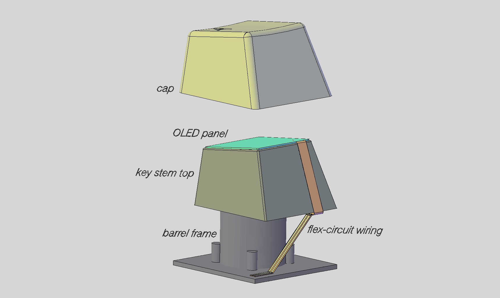

BTW, I like the OLED idea. Make them little displays as the Optimus Maximus has.
:ugeek:

I think it is more of a habit than anything else. I think that if you are used to a stepped Caps Lock, then a full-size Caps Lock will be pressed more often by mistake. Some people even use the step as a "homing" feature to find the A key.
M'er Forever wrote:the latest iteration of the Fn, FnLock, and Lock indicators
I think the text labels are too close together for causal reading.
You forgot to have each lock light in a different colour.
