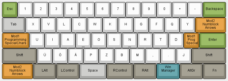

I made this hypothetical layout, drawing inspiration from the kishsaver and poker layouts as well as my own ideas. What do you think?
05 Apr 2014, 22:44
Interesting idea, moving the alphas one unit to the right. I've always been annoyed how homerow isn't dead centre in a 60%. I like what you've done to balance this up.
Not sure how practical the arrow keys would be, however. I find I frequently press left then right and up then down. Those would be much more difficult with this arrangement.
Also I wonder where you'll get caps to match the numrow. That is unless you're thinking of blanks.

ullr
06 Apr 2014, 01:29
Hadn't put much thought into actually producing it. When I was making the layout, one of my biggest concerns was keeping a standard 6.25 unit space bar. I would probably use mostly if not all blanks.
Also, I think that you're right about the arrow keys. They probably would be more intuitive with left and right on the left side and up and down on the right side.
I had an older, similar layout mocked up in a regular image editor with a complete function layer - one of the ideas I had was FN + A bracket key (<,>; [,]; (,); {,}) or a quote would insert two quotes and then a left key press, in most cases putting the cursor between the brackets or quotes - this always seemed like an intuitive feature that was "missing" from common layouts.
I was never sure if the function keys would be best served all on the top row on the function layer with F1 on the zero or if I should offset them one place and have F12 lower down. I always thought that zero should go before one as well, I'm not sure why it ended up the way that it is.

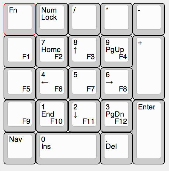

Random idea on the "modular" side... what about using layers to combine functions on the numpad? Something like this:
You could use Fn, Nav or Num Lock to sticky-select a layer or you could have a dominant one (set by a hardware switch?) and use the others via chording.

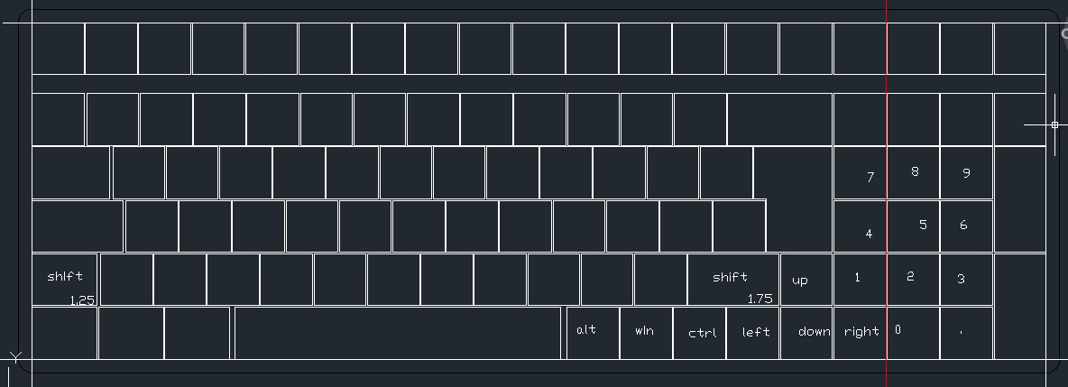

well, i'm looking for somethinglike this actually (quick 5 minutes sketch).
probably just the left side to keep it smaller sized

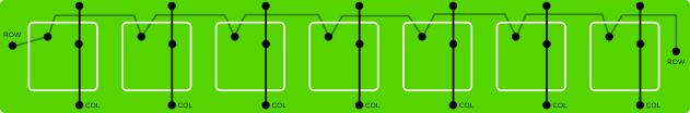

Okay crazy idea.
Create a series of mini-PCBs where you solder the switch directly. The PCBs are all easily connectable one another in rows/cols.
The PCBs would come in different sizes: 1 switch, 2sw, 3sw, 4sw, 5sw. You just need to connect them together and get whatever layout you want. Staggered or symmetric. Minimal, 60%, 75%, full. With or without function row. Etc...

matt3o wrote:Okay crazy idea.
Not sure if you've seen it, but something similar has been made over at Geekhack. Quite a nice idea, actually :
http://geekhack.org/index.php?topic=557 ... msg1254460
JBert
16 Apr 2014, 10:21
The idea sounds good, but the PCB can't be too tall / wide or you can't stack your rows close enough together. Maybe you can stuff the solder points into the corner between Cherry switches?
At any rate it would be a great and cleaner way to get your diodes connected, and it's pretty much freeform.
The Geekhack idea of single switch PCBs sounds like it does lose the mechanical stability of 5 switches stuck together.
16 Apr 2014, 10:24
Intriguing. I could use a version of this for my planned M84 and Matias builds. Or custom PCBs entirely.
But where are the diodes?
-[°_°]-
16 Apr 2014, 10:24
oh gosh everything has already been done...
well anyway it means that it can be actually done.
My idea was a bit more complex than that btw. First of all, you should try to grab the biggest chunks and use the 1 and 2 units only where really needed.
Secondly, I'd like to mount the modules over a sort of specifically crafted breadboard, so soldering is really reduced to the minimum.
Of course diodes have to be added, the picture is just to give you an idea. We could also add leds.

A nice idea Matt,
The PCB can handle Alps too but for a column staggered layout like ergodox, leds for MX will be on a side, not on top or bottom. And for the same layout with Alps, a legended set will have to be 90° turned too :(
I already thought about a modular mounting plate with some screw holes to fix them together : the 90° led issue will be fixed but Alps and MX haven't the same hole size. :( And it requires a lot of bolt to make a board, like a Meccano assembly :o
-[°_°]-
17 Apr 2014, 08:38
I believe you need a different PCB design for vertical aligned keyboards
Vierax
17 Apr 2014, 20:59
As I said, it depends what you plan to do with it, a vertical kb with MX and without backlit is feasible with your design. :)
